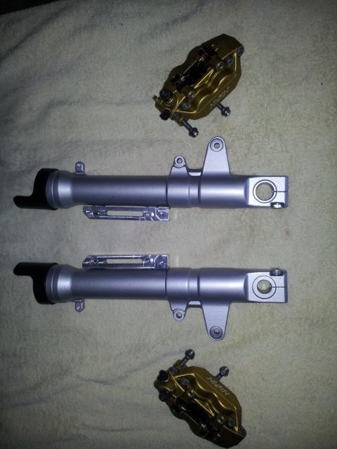

Member Contributer Daniel Paul Posted February 2, 2014 Member Contributer Posted February 2, 2014 Yeah, I wasnt clear - VTR triples are narrower in stance than the 5th gen triples, so the SH fender wont fit. The 5th gen fits only with some kind of adaptor bracket. Here's a pic of the CNC design that I used. Any desire to make another set? Quote
mello dude Posted February 3, 2014 Posted February 3, 2014 Yeah, I wasnt clear - VTR triples are narrower in stance than the 5th gen triples, so the SH fender wont fit. The 5th gen fits only with some kind of adaptor bracket. Here's a pic of the CNC design that I used. Any desire to make another set? I am working on making another batch. Quote
Member Contributer Daniel Paul Posted February 3, 2014 Member Contributer Posted February 3, 2014 Awesome! Would it be possible to PM when they're ready? Quote

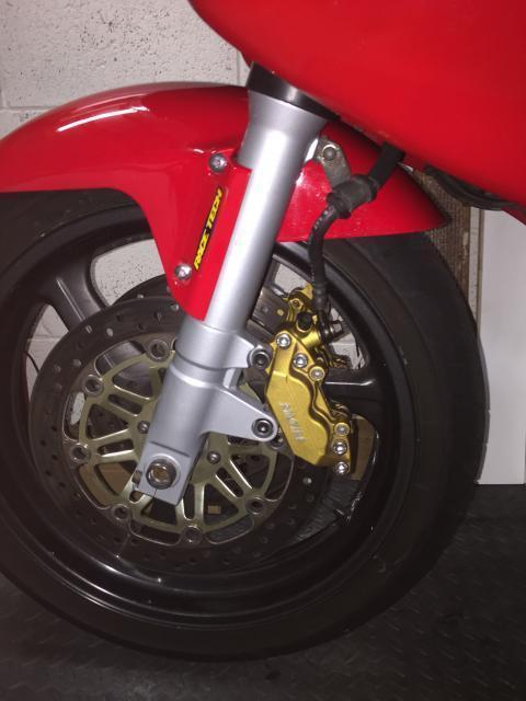

Mikesmini080877 Posted February 3, 2014 Posted February 3, 2014 I just finished doing this swap today on my 5th gen. Vtr bottoms with my vfr tubes, mello dudes fender adapters cbr954rr calipers, cbr600f4i rear master and I took the easy way and just used the existing 2 rear brake lines and the factory double banjo bolt at the rear. Cbr600f4 5/8 bore master instead of the 11/16 bore it should really use but it still works perfectly well. I used venhill brake lines as they are like a modular system where you buy the desired line length needed and the screw on fittings separate so you get the correct angled fittings and when fitted there is no chance of the lines not being crimped in the right position and the brake lines kinked/coiled up a bit. Setup looks factory fresh and works a treat. Do it dude Quote
mello dude Posted February 3, 2014 Posted February 3, 2014 Awesome! Would it be possible to PM when they're ready? Sure, no problem Quote
Mikesmini080877 Posted February 3, 2014 Posted February 3, 2014 thanks mello dude for your adapters. quality Quote
mello dude Posted February 3, 2014 Posted February 3, 2014 thanks mello dude for your adapters. quality Thanks ---- I was curious, did you have to do minor grinding to get the caliper to bolt up? I did on the RC51 units. Quote
mello dude Posted March 9, 2014 Posted March 9, 2014 Yeah, I wasnt clear - VTR triples are narrower in stance than the 5th gen triples, so the SH fender wont fit. The 5th gen fits only with some kind of adaptor bracket. Here's a pic of the CNC design that I used. Any desire to make another set? Bumping the thread --- got a new batch of brackets in. -- I did some very minor tweeks. (One set goes on my bike) PM if interested. Quote

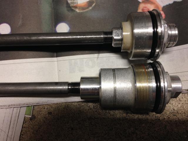

VfrViddy Posted June 23, 2015 Posted June 23, 2015 I have Wilbers springs in my stock vfr -98 forks now, but there I have no rebound damping what so ever.The fork oil that came with it was SAE 5.I beleive the lower case is worn out. Bike run over 100.000 kmThere are some vibration when light brakeing and I have change everything exept forks.So..My wilbers springs do not fit the VTR 1000 forks, and still wondering what to do.Looking around for som VFR lower pipes at the moment, in good shape.Anyone? Quote
Member Contributer Terry Posted June 24, 2015 Member Contributer Posted June 24, 2015 I can't think of any reason why the Wilbers VFR800 springs won't fit into VTR forks; they have the same internal diameter, the only difference will be the length of any spacers that you may need. From memory the VTR fork cap preload adjuster is about 20 or 25mm longer than the equivalent on the VFR, so the spacer needs to be shortened by that amount. I have VTR fork caps and adjustable rebound damping components installed in my standard VFR fork tubes. Quote
Member Contributer CornerCarver Posted June 24, 2015 Member Contributer Posted June 24, 2015 Your VFR800 springs will fit in the VTR forks. If you want a set of VFR800 fork lowers in 41mm diameter I have several laying about. Yours for shipping. You may be better off purchasing from someone in Norway than having me ship them though. Quote

Member Contributer CornerCarver Posted June 24, 2015 Member Contributer Posted June 24, 2015 Terry, If you are utilizing the VTR front assembly as a unit (forks, triples and wheels) you can easily just bolt on a VTR front fender. A common Superhawk/VTR upgrade is to use the RC51 calipers on the VTR fork lowers and we have this set up on a 4th gen VFR. You may need to add a little clearance on the fork mounting attachment for the calipers, we had to on one side but not the other. I cannot comment on whether de-linking alone improved the ride quality in the front as the forks were sent out with VTR lowers and CBR600F3 fork internals to be revalved and resprung at Traxxion Dynamics for the VFR and rider weight. Quote

VfrViddy Posted June 25, 2015 Posted June 25, 2015 Anyone who can compare the vtr spring with the vfr spring? A litle confusing as to how much the spacer needs to be cut. I would like my vfr as close to original as possible. But had my first track day last weekend and damn, I need som front forks That can be adjusted. If CornerCarver have some lower forks, maybe someone else have the VTR upper forks I need? Its not a common mod here in norway and I Dont think any members of the vfr-club Norway with 5th gen vfr have done the swap. Quote
