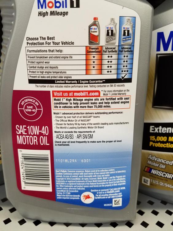

I understand that on the back of the oil container, in the little round service service designation tatoo, you want SN or SM....   Newer SN designated oils are backwards compatible with type SM...
and No "energy conserving" designation in the bottom of the rocker, as it works better w/ the wet clutches..
All the rest of the bs is marketing hyperbole.
Simple !
Negative... SN are not backwards compatible with SM... SN is new and improved over SM...
SM - Introduced November 2004, improved oxidation resistance, deposit
protection and wear protection, also better low temperature
performance over the life of the oil compared to previous categories.
SN - Introduced in October 2010 for 2011 and older vehicles, designed to
provide improved high temperature deposit protection for pistons, more
stringent sludge control, and seal compatibility.
Energy Conserving is not additive... its an API test that this "oil
may result is an overall saving of fuel in the vehicle fleet as a
whole"...
