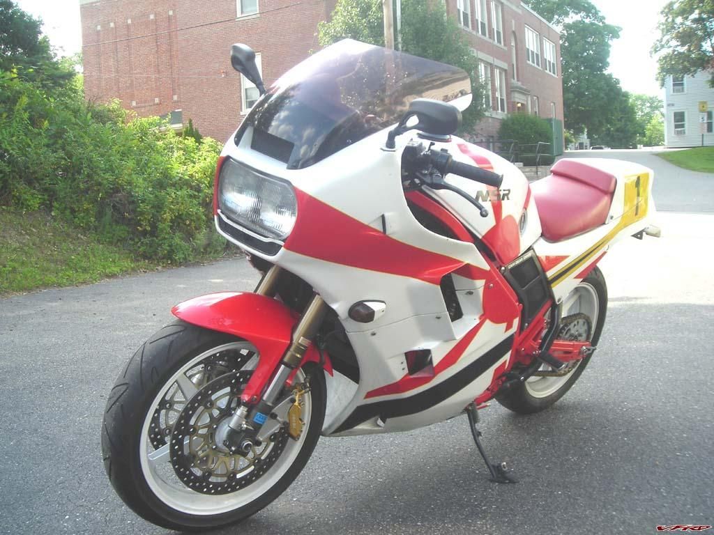

Member Contributer vfrcapn Posted July 30, 2008 Author Member Contributer Posted July 30, 2008 Anyone else making any progress? Well, it's slowly coming together... Quote
SEBSPEED Posted July 30, 2008 Posted July 30, 2008 Anyone else making any progress? Well, it's slowly coming together... Awesome! You can punch me later, but I think that bike looks ready for VF750F tail, side panels, tank, and a brushed aluminum VTX headlight... bruiser style... :cool: yep, I was serious... :ph34r: Quote

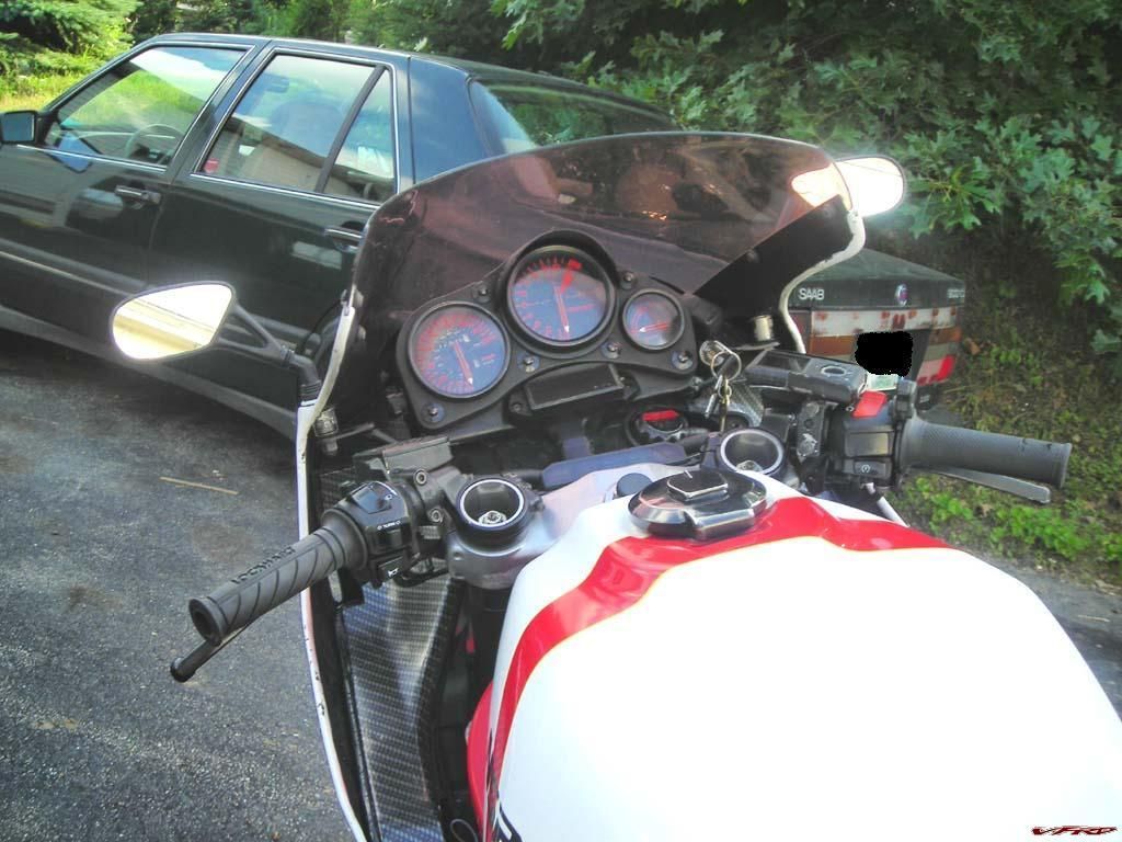

Member Contributer Kel Posted July 30, 2008 Member Contributer Posted July 30, 2008 (edited) Anyone else making any progress? All I've done is add some new mirrors. I never liked the stock ones. These are smaller but come up and out just a tad more so I can see past my arm a little better. Plus they look cooler. New mirrors New mirrors Edited July 30, 2008 by Kel Quote
SEBSPEED Posted July 30, 2008 Posted July 30, 2008 All you've done?? Did I miss the post where you finished the front end and gave a ride report? :cool: J/K, looks good! :ph34r: I like the new headlight too. Quote
Member Contributer Kel Posted July 30, 2008 Member Contributer Posted July 30, 2008 All you've done?? Did I miss the post where you finished the front end and gave a ride report? :cool: J/K, looks good! :ph34r: I like the new headlight too. You miss a post...is that even possible? Ok, I didn't give a ride report. I still have to play with the settings as it's a tad stiff now. Not sure what the offset difference in the triples does to trail but it does turn differently, kind of slow at first then really turns in. Not as smooth at very slow speeds as my stocker but that could be partly due to the 16 incher. I've relocated my ignition. You can just see it in the second pic. It's to the right of the temp gauge. Easy to get to and the keys don't scratch the triple. The 51 bars are at a different angle than stock. They are upside down so the angle is more upright. Took a little getting use to for my wrist but it's actually higher than stock so no complaints on long rides. I'm still waiting on 51 masters for brake and clutch. They are much narrower than the stock ones and will let me slide everything up so I can put on my bar ends. I'm sure the 51 master will make it stop as intended but it still out brakes stock by tons. I actually like the feel it has now. You can really modulate the front easier with a slightly longer lever travel before dead stop. It's not grabby at all but will brake hard when asked to. I've tried to make time to work on my other set of panels but I can't seem to find any. I'd really like to have it repainted by the Indy GP but that's coming up fast. Did you get your front axle? How's it coming? Quote

Member Contributer VF1000RS Posted July 31, 2008 Member Contributer Posted July 31, 2008 Well, it's slowly coming together... Looking stealthy...I like it. Quote

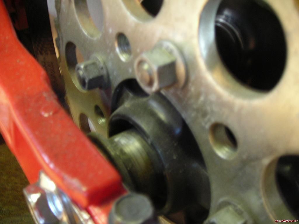

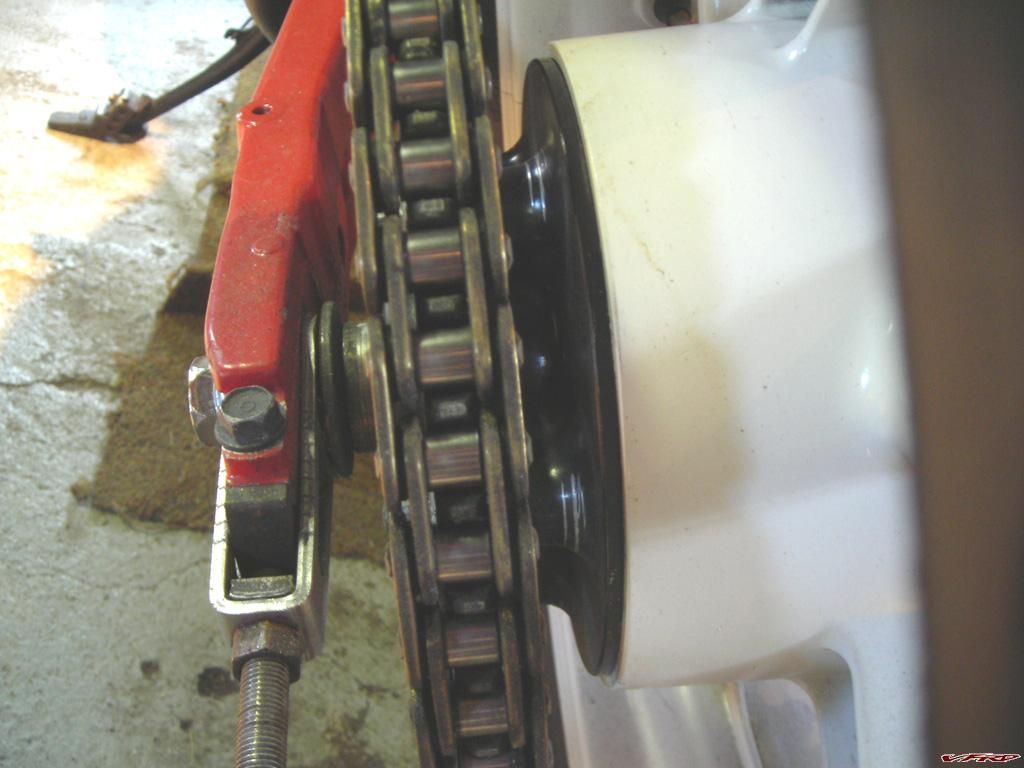

Member Contributer Kel Posted October 19, 2008 Member Contributer Posted October 19, 2008 Then mess with the wheels and make sure they're lined up, also try out the VF500 hub I have to see if the rumors are true... might toss that 900rr wheel that I mentioned in there too for giggles. It's no rumor. I have probably 5k hard miles on mine with no problems. Others have as well. You won't/can't out torque this hub, especially with a 750. The studs are smaller but I was lucky, my kR sprocket had 2 different hole sizes. Bingo! 500 cushdrive 500 cushdrive2 Quote
SEBSPEED Posted October 20, 2008 Posted October 20, 2008 Kel, is that the F2 wheel you're using with that hub? (160 rear?) Quote
Beck Posted October 20, 2008 Posted October 20, 2008 Anyone else making any progress? New mirrors Just wondering, those clipons look like they're barely clamped on to the fork tubes. Shouldn't you worry that they could come off while ridind your bike? Beck 95 VFR Quote
Member Contributer vfrcapn Posted October 20, 2008 Author Member Contributer Posted October 20, 2008 Mike, how're you making out? Not much progress, been focused on summer house projects for the past few months and now I've been forced in to job hunting mode so the bike is pretty much on hold. What's that saying, 'Life is what happens when you're busy making other plans..'? I'm still trying to sell the F but if it won't sell I am considering rebuilding the motor with the replacement cases I've found. The question I have is what are the basic parts I'd need to tear down and rebuild in the new cases? I see gasket kits are available, I assume new crank and rod bearings - are they available? (Jamie?) Should I have the cylinders honed and use new rings or can I get by reusing them? The idea is only to change out the motor case, no internal parts that aren't necessary. I want to keep the cost to a minimum but I'm worried I'll need some repalcement part that is no longer available. Quote
SEBSPEED Posted October 20, 2008 Posted October 20, 2008 Just wondering, those clipons look like they're barely clamped on to the fork tubes. Shouldn't you worry that they could come off while ridind your bike?Beck 95 VFR Beck, you'll need to go back a page or two and read what Kel's done. He actually has plenty of clamp area, but it's easier for you to read than for me to re-type... Quote
Member Contributer JamieDaugherty Posted October 20, 2008 Member Contributer Posted October 20, 2008 Kel, is that the F2 wheel you're using with that hub? (160 rear?) The VF500F sprocket carrier with an F2 wheel will line up the chain correctly on a VF700/750/1000F. For most guys it's easier to find an F2 part (or better yet, get an F2 wheel with the carrier) than it is to find a VF500 part. Combine that with the fact that CBR sprockets are more redily available. Those are the reason I've chosen to use the F2 carrier for my wheel swap kits. The cost for me to modify it is neglidable compared to the cost of the caliper bracket. Plus I think it looks better on there than the VF500 part. Quote
