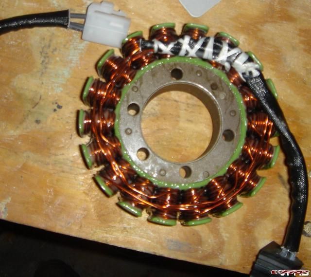

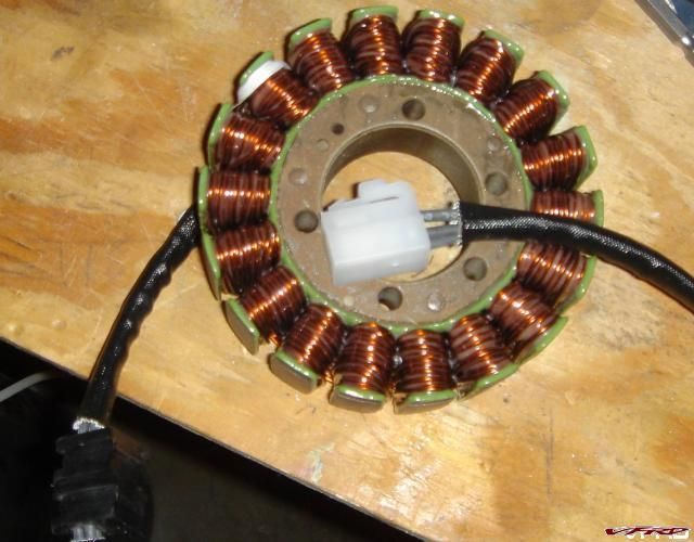

Member Contributer chris2992 Posted February 17, 2007 Author Member Contributer Posted February 17, 2007 Stator Re-wound by Ricks Motorsport Electric. A+++++ Quality Stator Re-wound by Ricks Motorsport Electric. A+++++ Quality There is the rewind job. Looks great!! Stay tuned for a result post. Quote
KanadianKen Posted February 17, 2007 Posted February 17, 2007 SO - how much of the "Brown" in the original post - was oil? Stator Re-wound by Ricks Motorsport Electric. A+++++ Quality Stator Re-wound by Ricks Motorsport Electric. A+++++ Quality There is the rewind job. Looks great!! Stay tuned for a result post. Looks like a damn fine job! :thumbsup: Quote
Member Contributer chris2992 Posted February 17, 2007 Author Member Contributer Posted February 17, 2007 None, It may have been burn't on oil, but after I cleaned it off in the sink (won't be doing that again, got yelled at) it still looked the same. Quote
