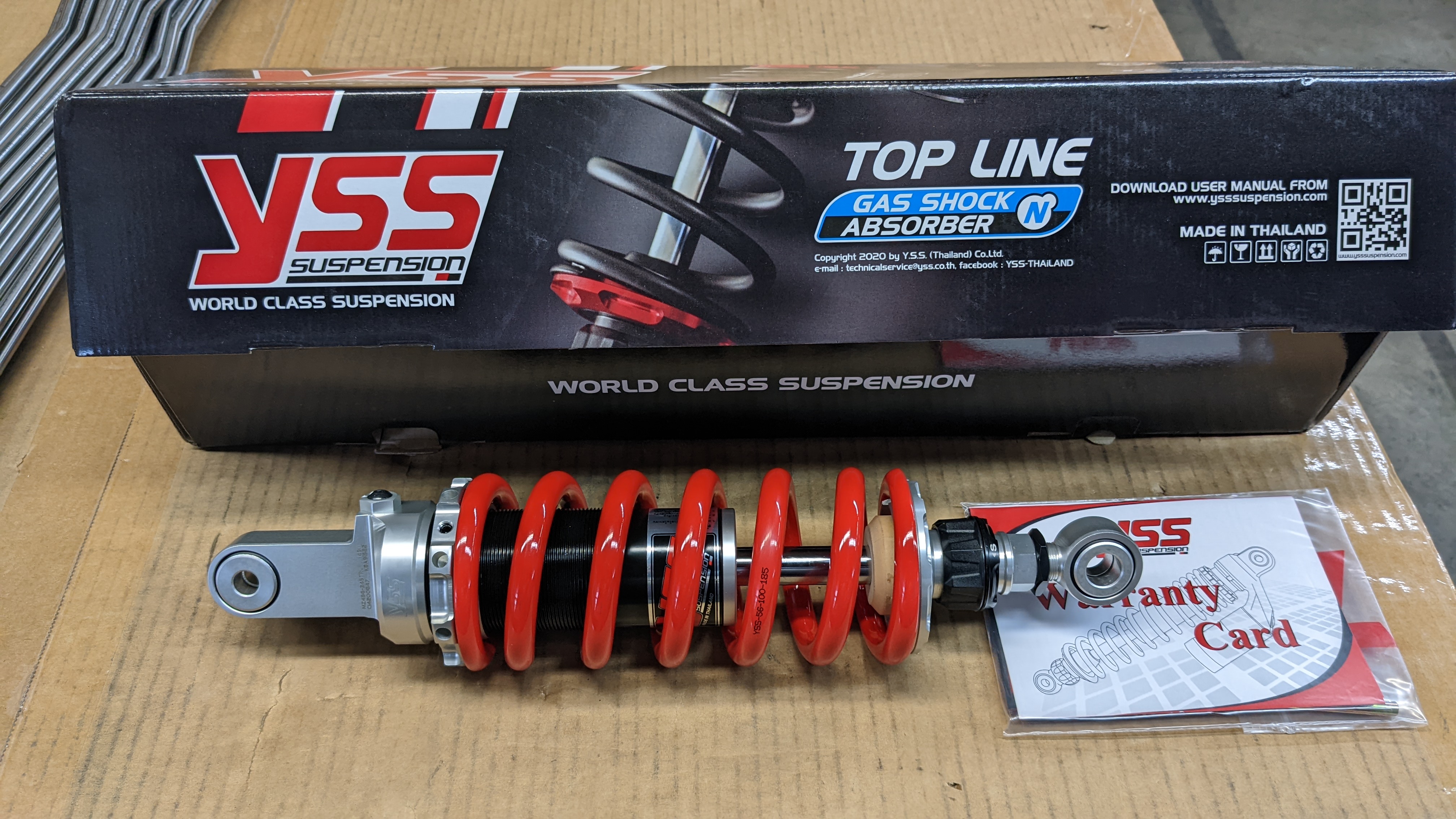

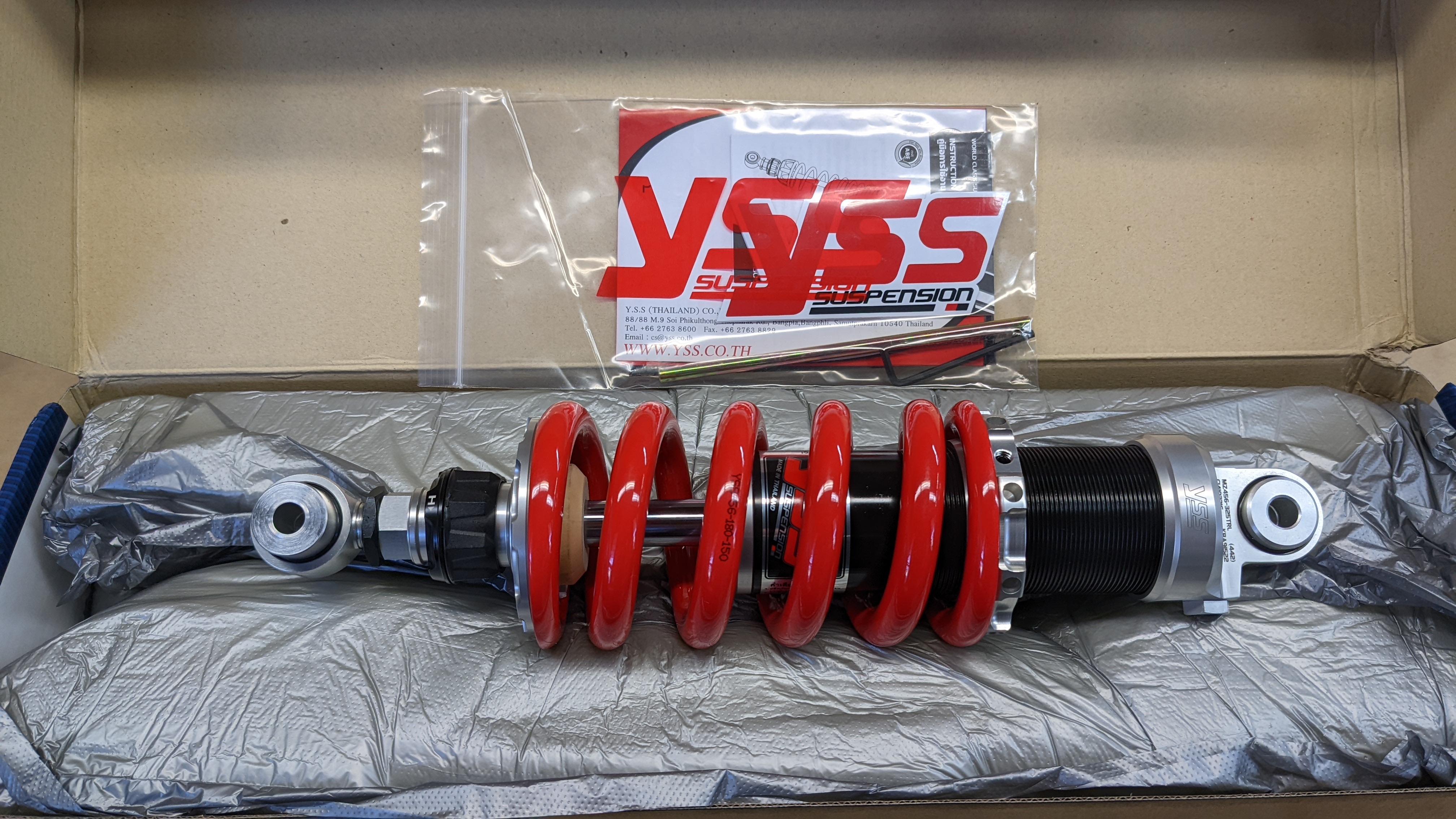

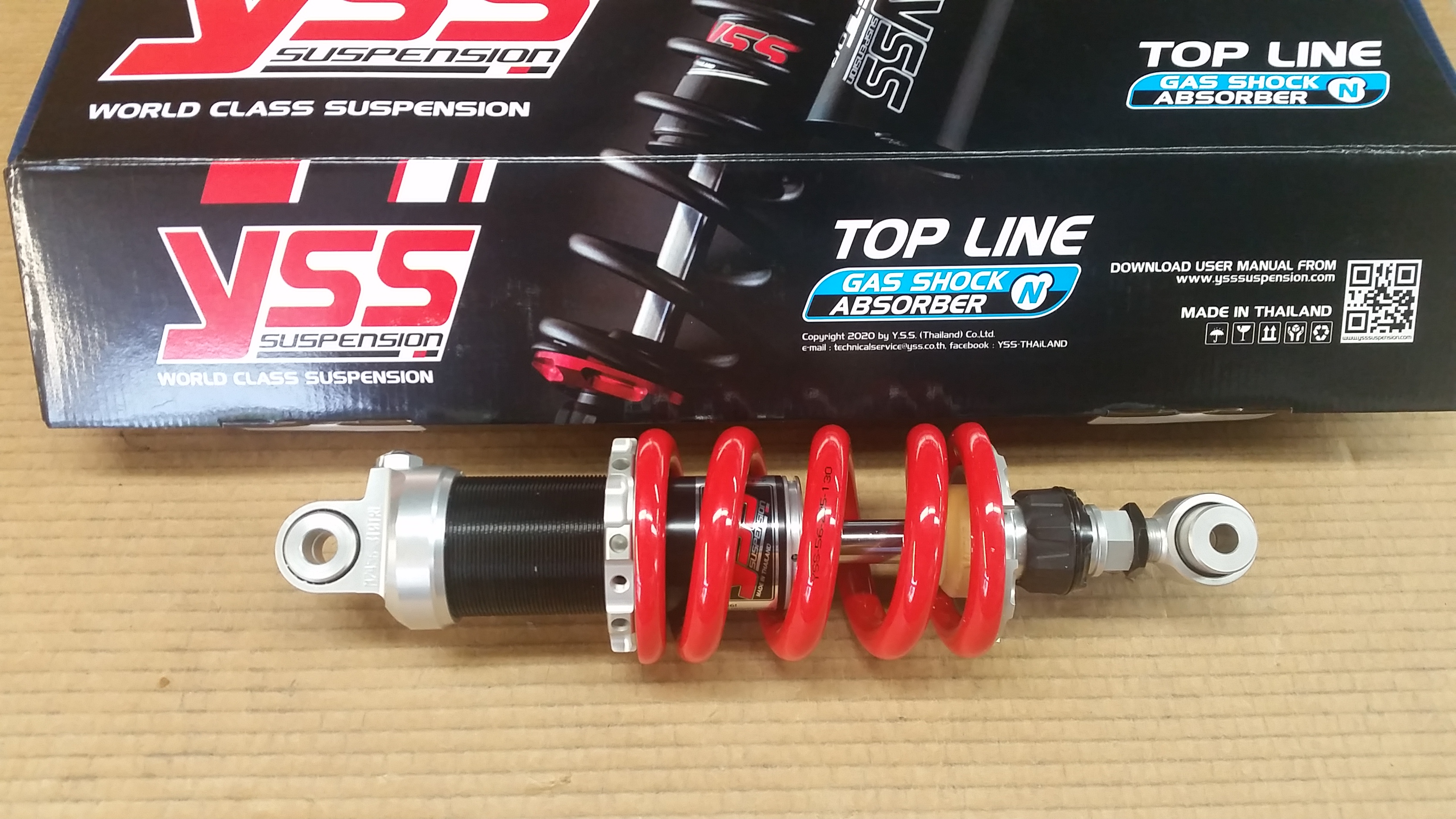

Member Contributer Captain 80s Posted October 13, 2022 Member Contributer Posted October 13, 2022 42 minutes ago, bmart said: I've never heard of YSS. What are they similar to and can they be purchsed set up properly for the rider's weight before they're shipped? The most available models have rebound damping adjustment, spring preload and separate ride height adjustment (+/-5mm). If you buy from the UK YSS Research and Development Center, Firefox Racing, they will fit the shock with a spring rate of your choice for an additional charge. I think it's like 40 bucks or so. I find their spring choice a little on the firm side (which I prefer), I am about 180 lbs without gear. I have never felt the need to change it when ordering after my first one (VF1000F). Hawk GT 1995 VFR750F ST1100 I think I'm on my 5th or 6th. I am very pleased with them. 3 Quote

CornPoweredV4 Posted October 14, 2022 Posted October 14, 2022 I haven't upgraded my VFR suspension yet, but for the record I put a new YSS shock on the back of my 07 SV650 two years ago and I've been loving it. I researched for weeks and found they were the best value for getting a brand new shock that's great for aggressive street riding, has a good range of adjustability, and is fully serviceable at the end of its life. For me, it beat out the prospect of going with some old, used shock from a different bike or trying to hunt down a Penske or Ohlins that would probably be overkill for what I'm doing anyway. I never even adjusted the shock after mounting it on my bike, it felt pretty good as is. They are made in Thailand so the English on their website is not the best, but the payment and delivery process was very professional and quick. Just throwin my two cents out there since I saw it being mentioned. 1 Quote
