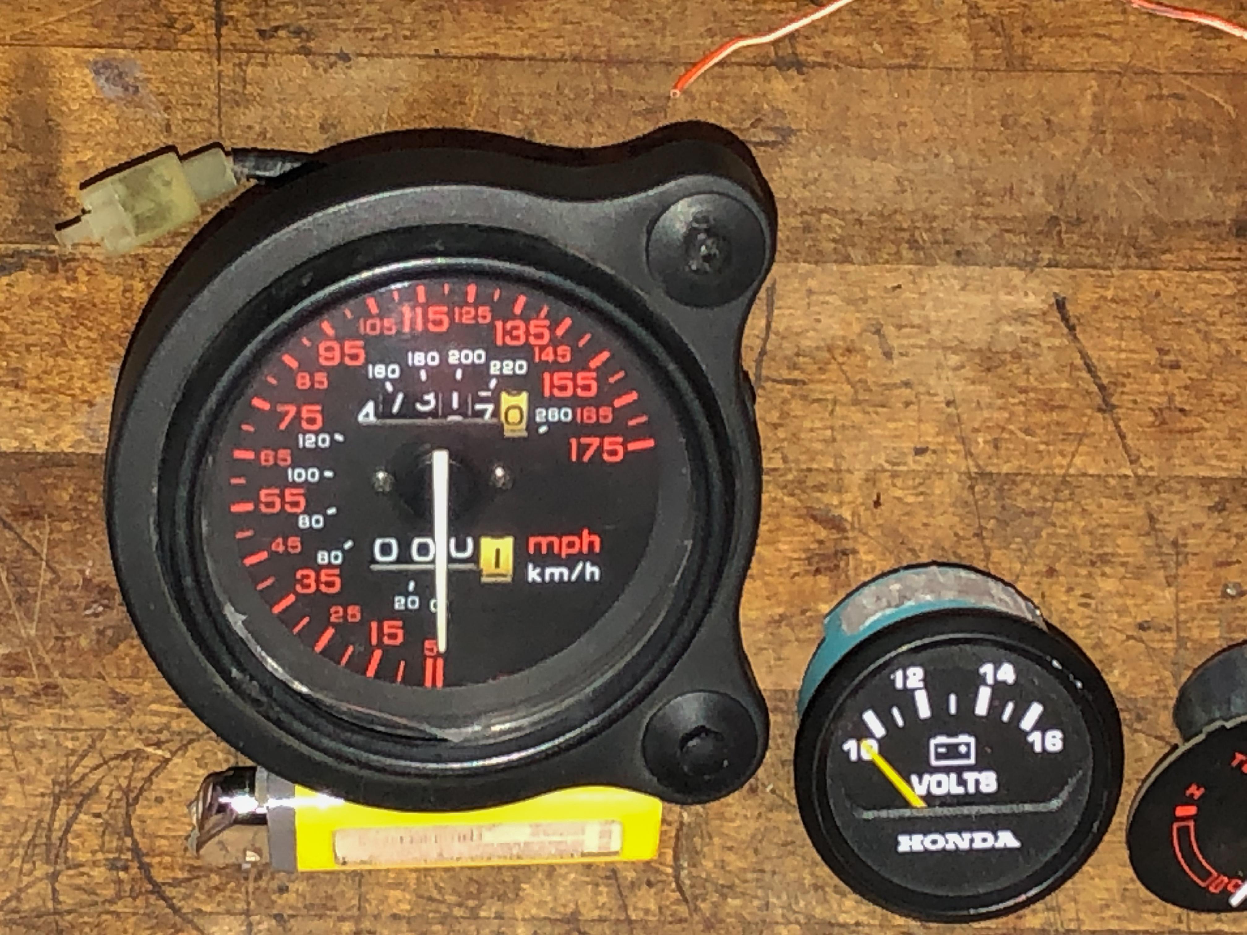

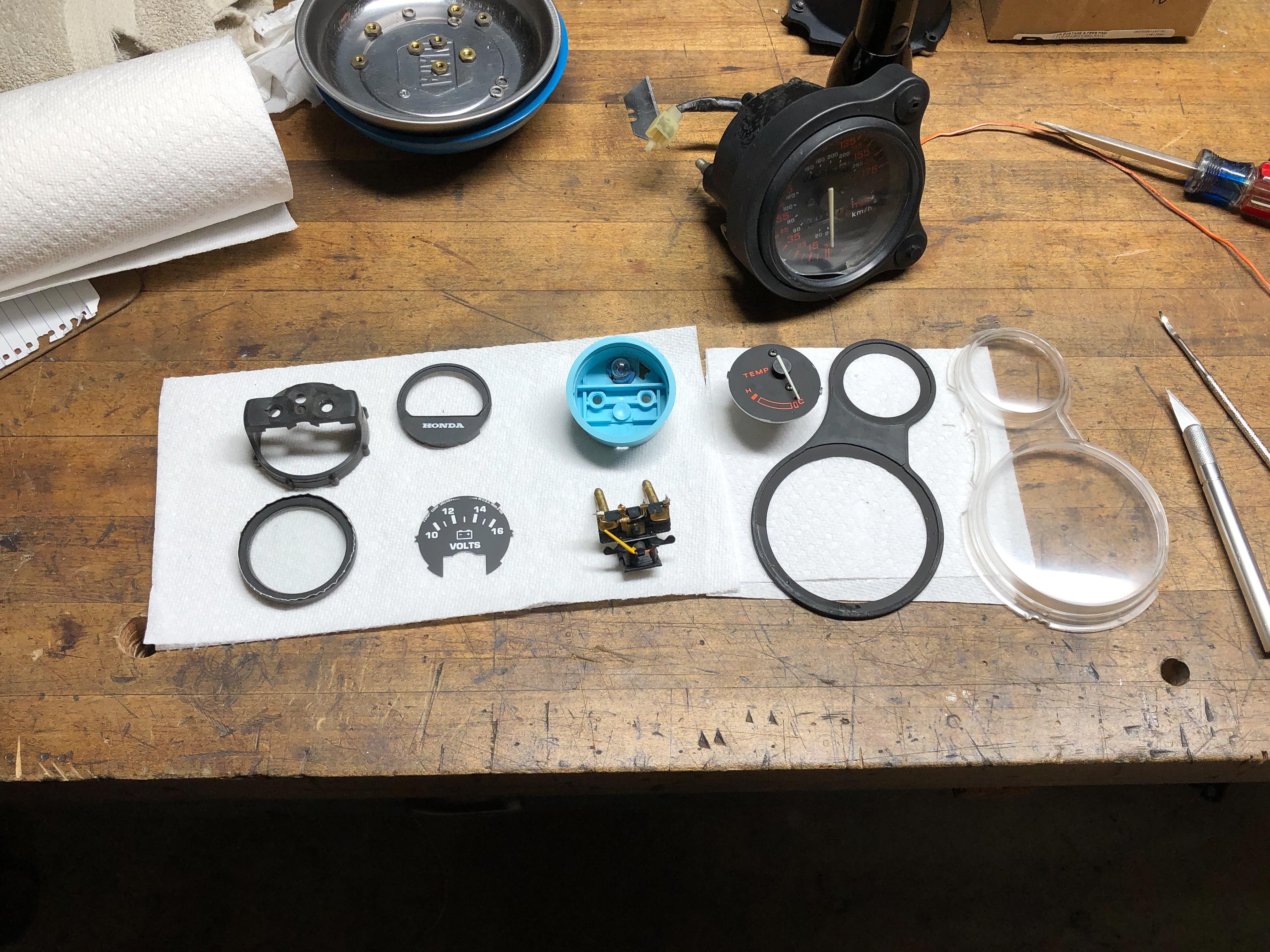

Member Contributer tsmitty Posted February 28, 2024 Author Member Contributer Posted February 28, 2024 Waiting for a couple terminals to come to make up the wire harness. Yup...not quite done, just in thinking mode. I'm a retired old man...I don't need something to do, I need a problem to solve. How do I make my volt meter face match the stock gauge set????? The Honda Marine gauge has a alum. face with black then white paint applied. The VFR gauges have clear plastic with a layer of white, then the orange lettering and slashes applied in separate blocks then the black is allied all on one side of the plastic. How do I get those needles off the gauge mechanism and back on and timed correctly?
Member Contributer Captain 80s Posted February 28, 2024 Member Contributer Posted February 28, 2024 Find a miniatures enthusiast, you know the ones that paint faces and eyelashes on their Civil War or Railroad figurines, and have them paint over the graphics in orange. Seriously is the ONLY thing I can think of for this particular scenario. 1
Member Contributer Terry Posted February 28, 2024 Member Contributer Posted February 28, 2024 Can you take the gauge faces that you have removed from the VM and scan them and send the scans to a label maker to print off in black/orange? There's also a number of suppliers of alternate gauge faces on the internet that might do the same work.
Member Contributer tsmitty Posted February 28, 2024 Author Member Contributer Posted February 28, 2024 40 minutes ago, Terry said: Can you take the gauge faces that you have removed from the VM and scan them and send the scans to a label maker to print off in black/orange? Thanks Terry, excellent idea. I will look into that. I was just checking out little paint brushes too as the Captain suggested Do they make a see thru masking tape...lay the tape down, cut out with a fine knife and spray???
Member Contributer tsmitty Posted February 28, 2024 Author Member Contributer Posted February 28, 2024 or someone with a vinyl machine make the black overlay...
Member Contributer Captain 80s Posted February 28, 2024 Member Contributer Posted February 28, 2024 I would just look for one out of the GL1100 Gold Wing
Member Contributer tsmitty Posted February 28, 2024 Author Member Contributer Posted February 28, 2024 I would still want to change the lettering color to orange.

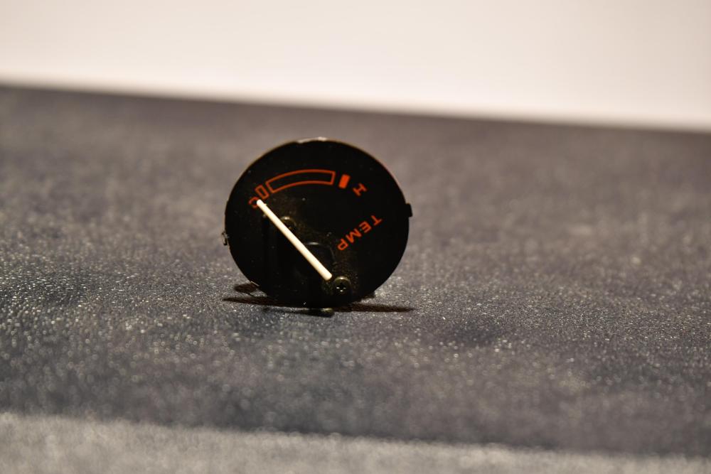

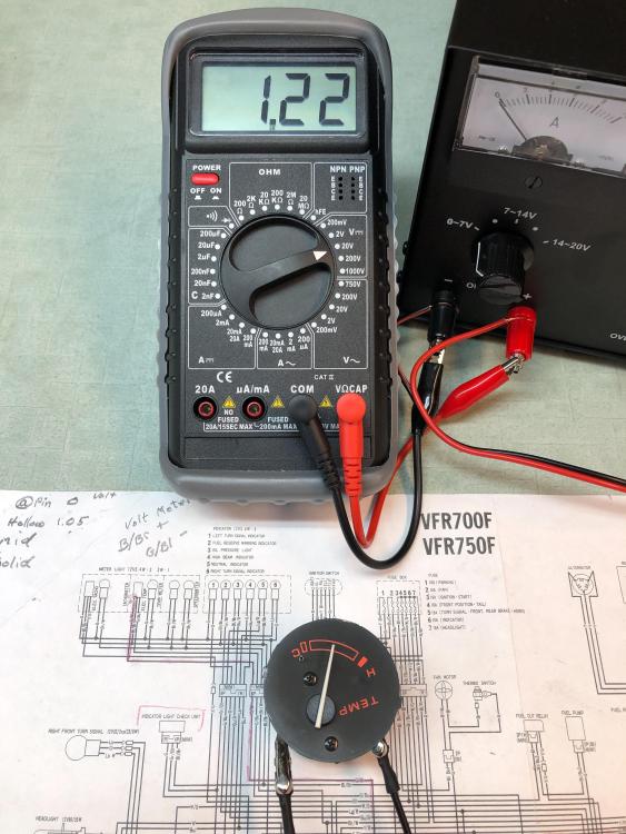

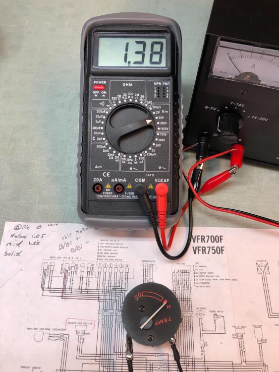

Member Contributer tsmitty Posted February 29, 2024 Author Member Contributer Posted February 29, 2024 Or... Can I turn this into a volt meter? @Grum Black out the "Temp" color fill the danger zones and reassemble with original lens. escutcheon ring.
SEBSPEED Posted February 29, 2024 Posted February 29, 2024 We have a member here that goes by Throttlepimp. His name is Kevin Sigler, he does graphic design and has been creating and fabbing gauge faces and decals for a long time. He's supplied all my decal and gauge face mods for my business and bike projects for almost 15yrs. Countless transactions with nothing but good results - including a set of gauge faces for a second gen VFR like yours to replace sun faded ones. He's not on here much, so shoot him an email at throttlepimp@gmail.com. Tell him you are a VFRD member, and that I sent you. He already has files and color match for your gauges saved from my project. Customizing a face for your voltmeter will be very easy for him. 2 1
Member Contributer tsmitty Posted February 29, 2024 Author Member Contributer Posted February 29, 2024 1 hour ago, SEBSPEED said: We have a member here that goes by Throttlepimp. His name is Kevin Sigler, he does graphic design and has been creating and fabbing gauge faces and decals for a long time. He's supplied all my decal and gauge face mods for my business and bike projects for almost 15yrs. Countless transactions with nothing but good results - including a set of gauge faces for a second gen VFR like yours to replace sun faded ones. He's not on here much, so shoot him an email at throttlepimp@gmail.com. Tell him you are a VFRD member, and that I sent you. He already has files and color match for your gauges saved from my project. Customizing a face for your voltmeter will be very easy for him. SEBSPEED thank you so much! I am on it! Whats the secret for removing the gauge hands?

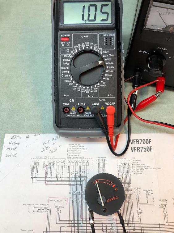

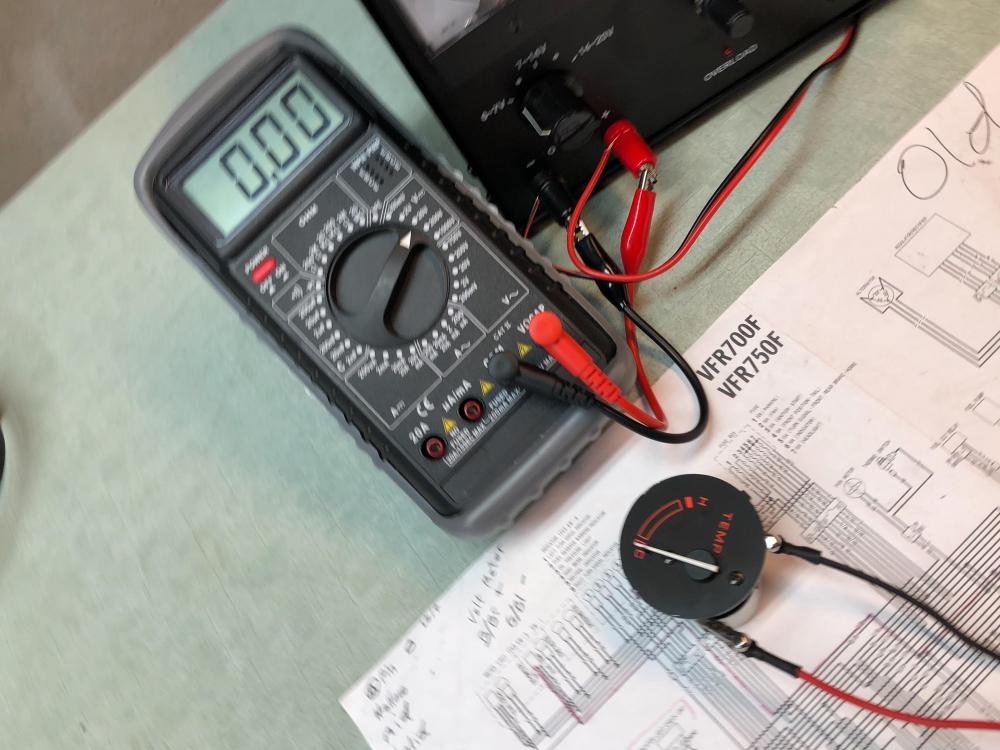

Member Contributer tsmitty Posted February 29, 2024 Author Member Contributer Posted February 29, 2024 This is what happens when I apply voltage to the Stock "Temp" meter.
