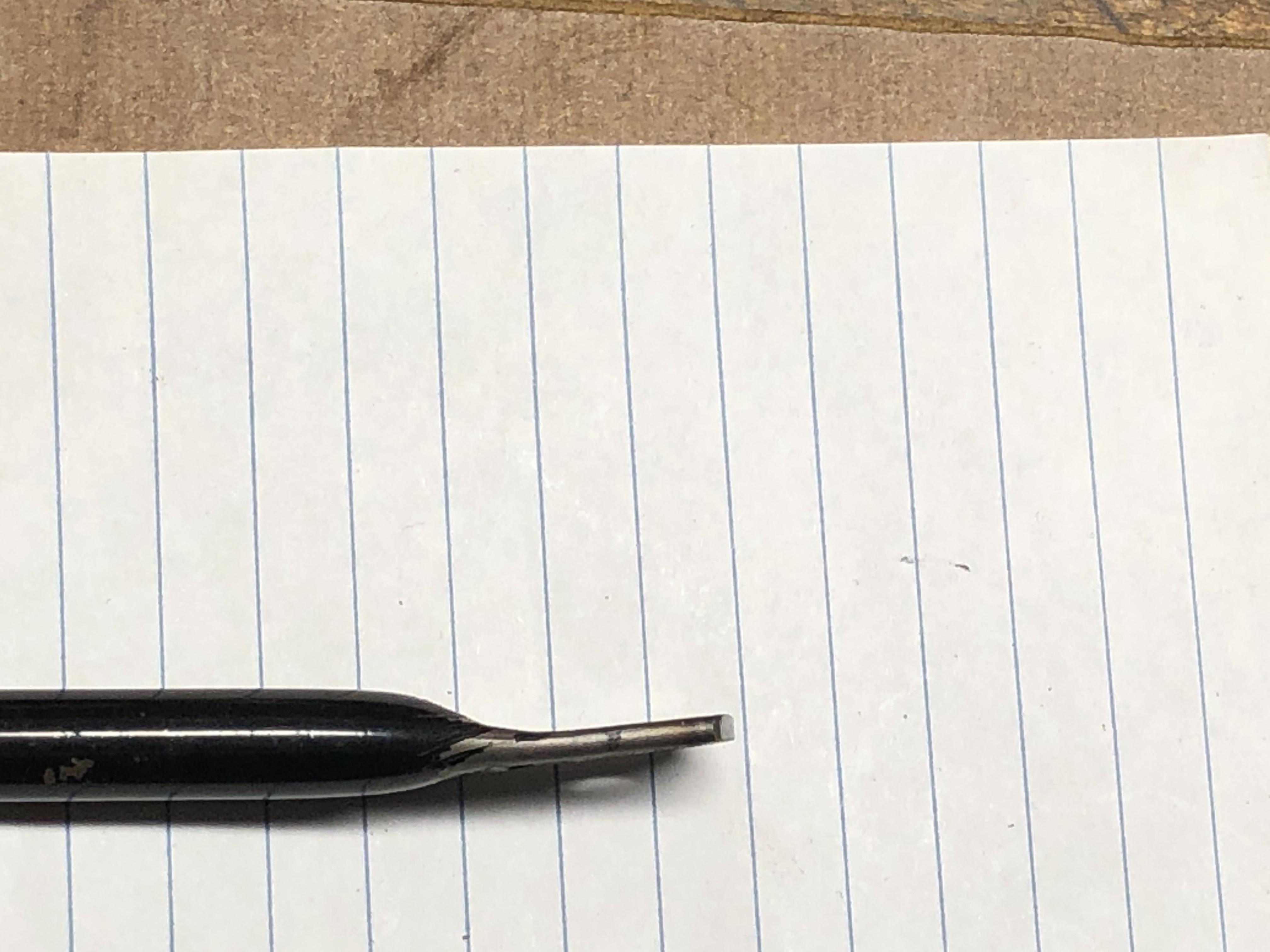

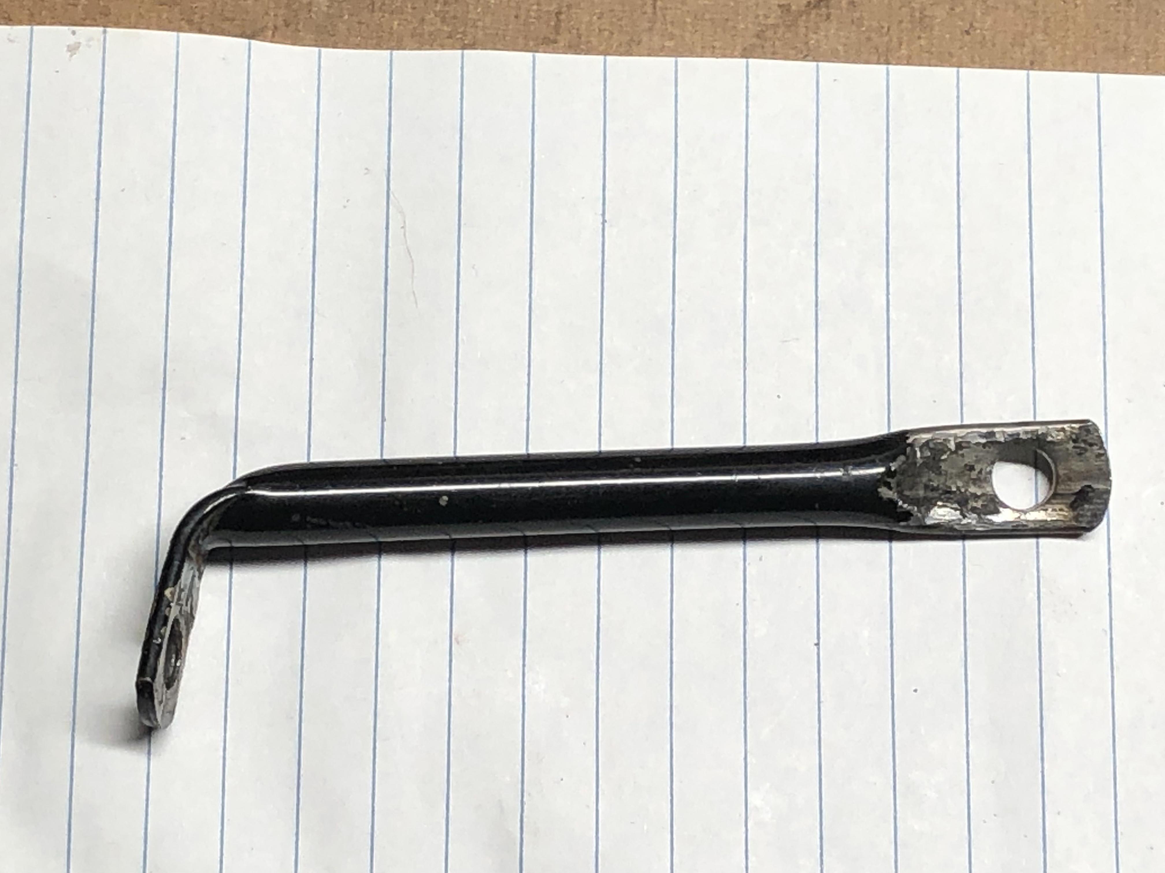

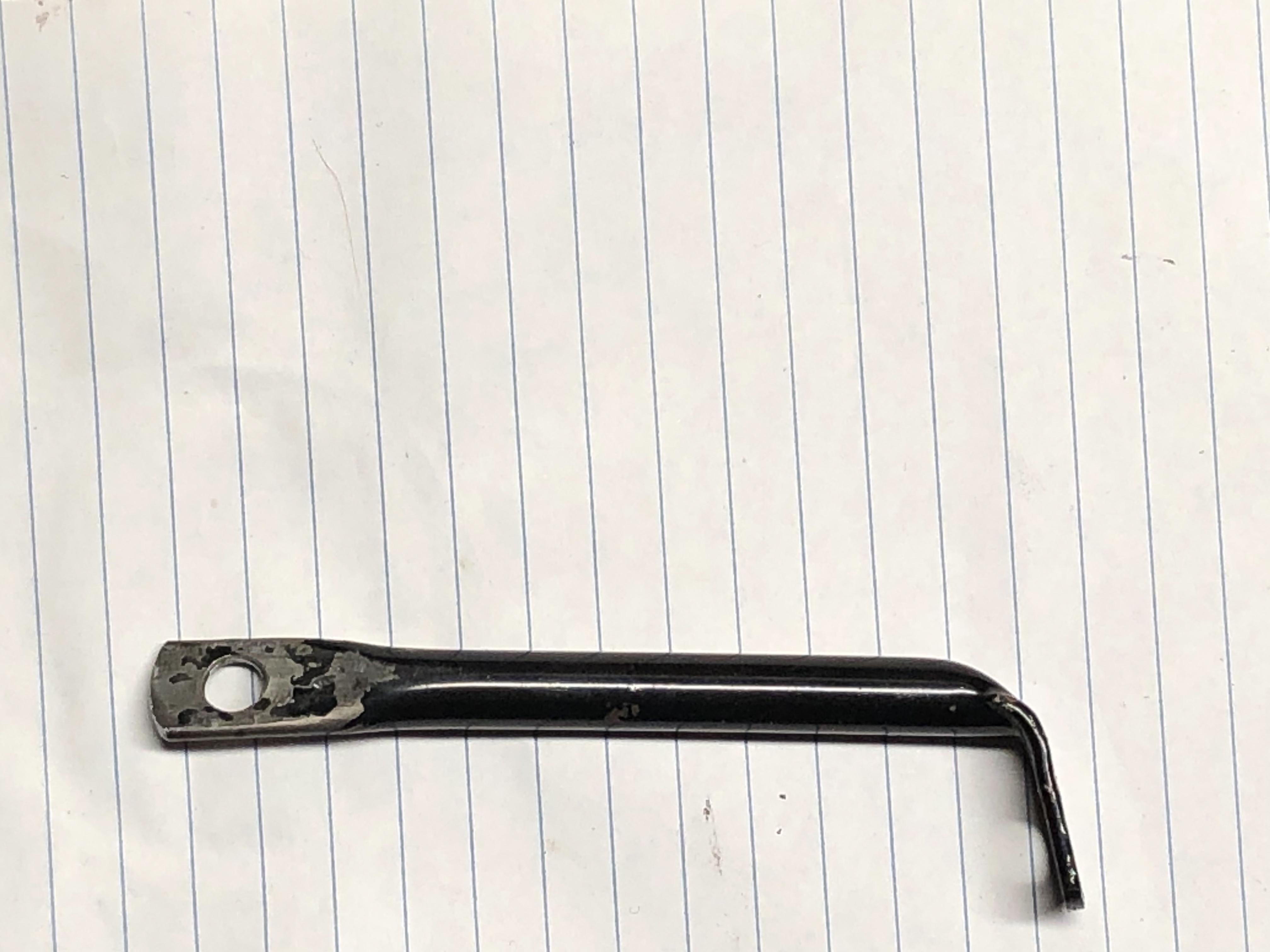

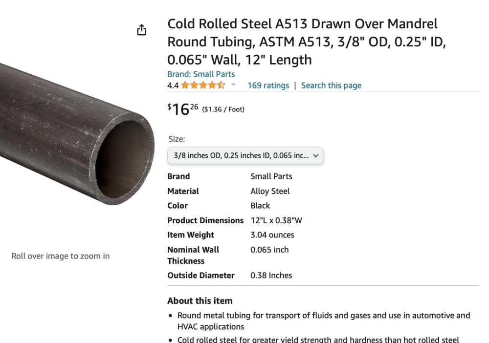

Member Contributer tsmitty Posted February 25, 2024 Author Member Contributer Posted February 25, 2024 Does the smush naturally follow the center of the tube? anyways... I just got back from our local Tractor Supply, the smallest tube they carry is 1/2x1/16 I think that is too large. The big A has this I'll get a stick next weekend and practice. Plenty to do in the meantime. The 3M idea and the fairing stay may be a winner as well; the "nesting" surfaces i stuck in the bezel will hold the tape perfect. Thanks Cap., as always your input is invaluable...you should charge by the word...extra for pics...well, except for me.
Member Contributer Captain 80s Posted February 25, 2024 Member Contributer Posted February 25, 2024 If the dies are mirrored, it self centers. If you need a "flat" side, like for up against bodywork at a shallow angle just stagger the dies as needed.
Member Contributer tsmitty Posted February 25, 2024 Author Member Contributer Posted February 25, 2024 4 minutes ago, Captain 80s said: If you need a "flat" side, like for up against bodywork at a shallow angle just stagger the dies as needed. I was going to ask, the side at the bezel...would be desirable. All I have is a vise, cast iron surface plate (ok for common sence beating and filtering) and a bernzomatic torch. My team and I got this...

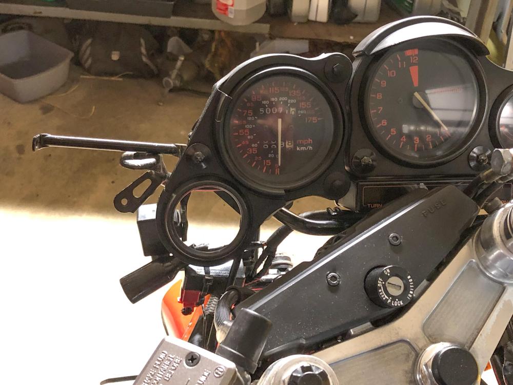

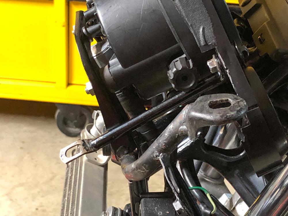

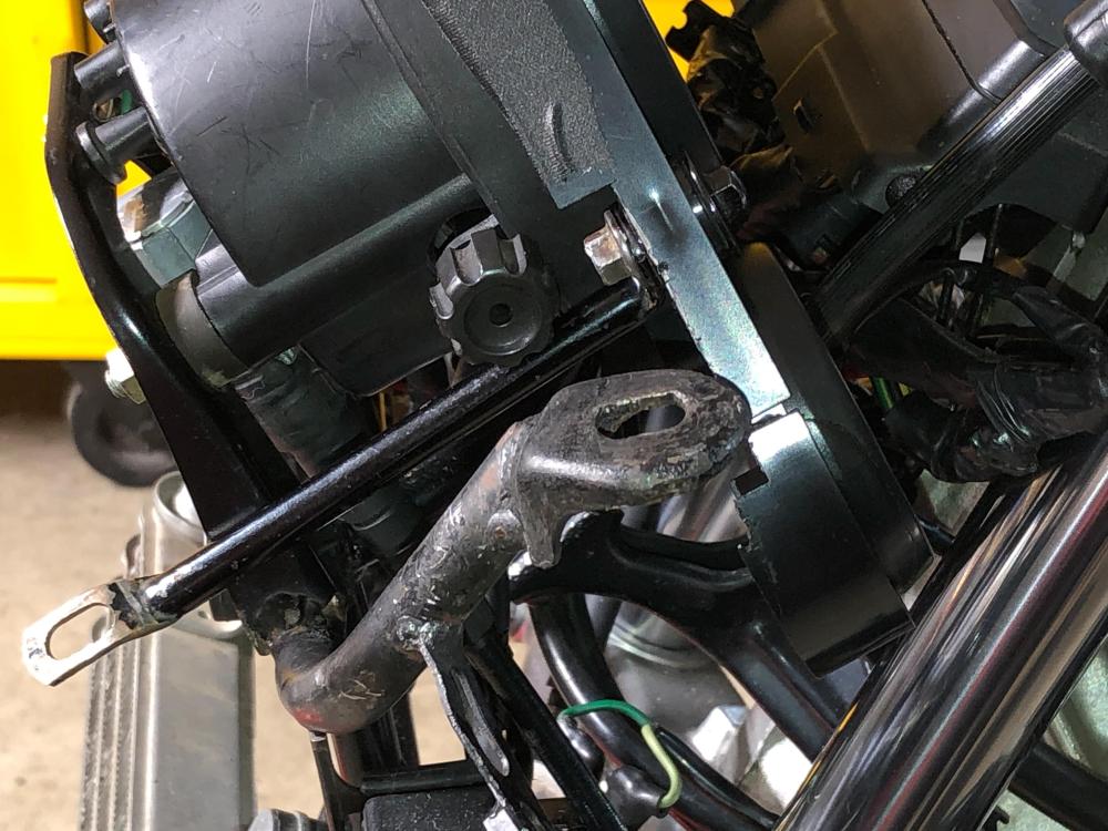

Member Contributer tsmitty Posted February 25, 2024 Author Member Contributer Posted February 25, 2024 I was check out pictures of your "Chrissy" loaded for camping, taking me back some. 🙂 This is what I have with the official Honda bracket and my idea with the tape. How does this plan sound? I create a flat on the tube with a hook on the end that goes down that bolt hole for the mirror? There is more than enough clearance for the mirror bolt and the flat piece of tube, then the bracket tightens on this side with the mirror bolt...
Member Contributer Captain 80s Posted February 25, 2024 Member Contributer Posted February 25, 2024 The problem with sandwiching anything fairly thick on top is that the mirror spacing is designed to apply pressure to hold the cowl securely. Why don't you dremel away a "relief" in the rolled over lip of the mirror mount just wide enough for the bracket to run thru and be flush to the underside. That short of a bracket bolted in that manner will be very secure.

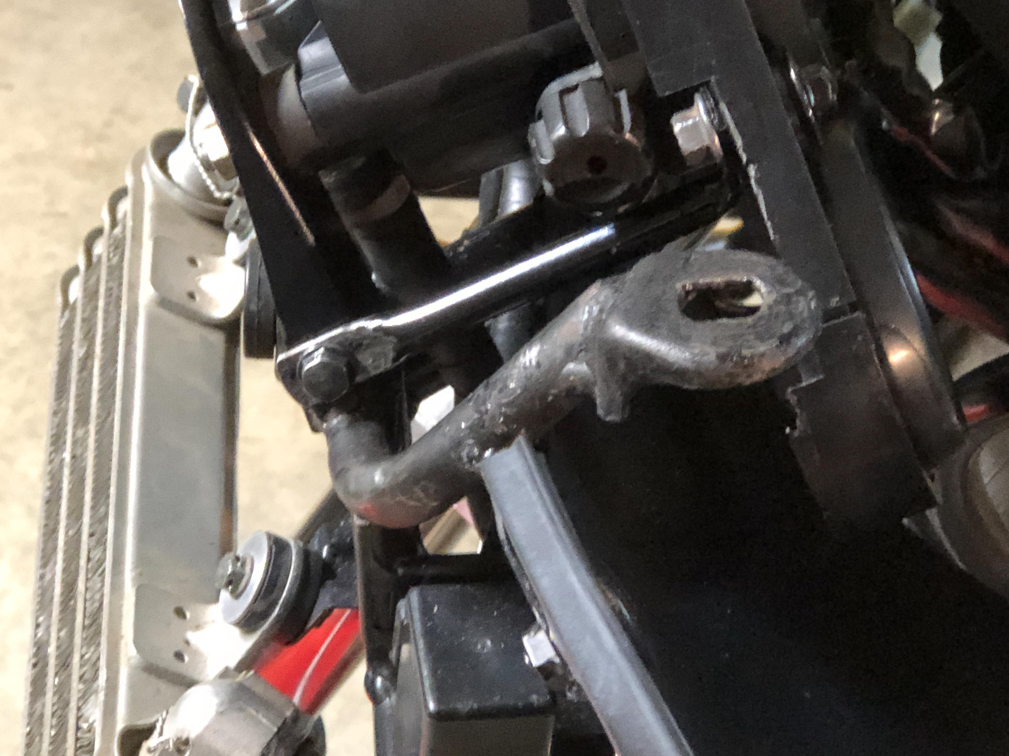

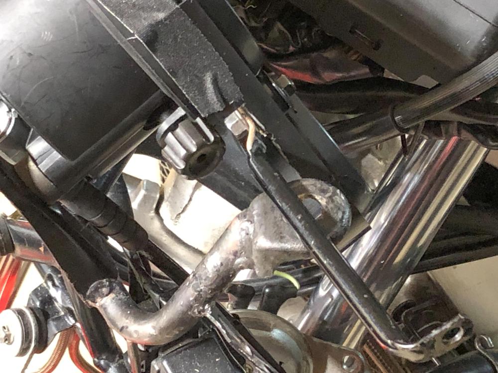

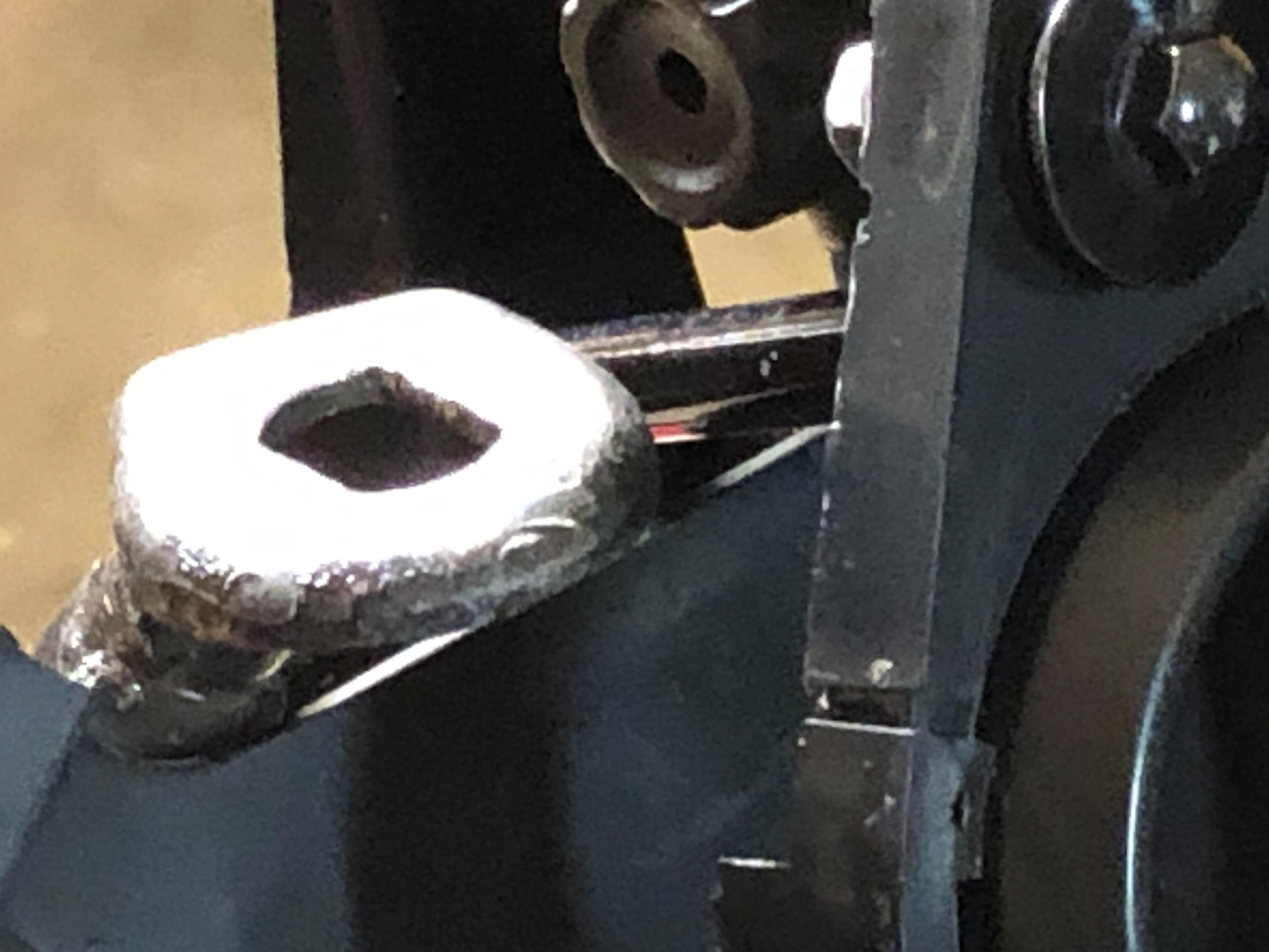

Member Contributer tsmitty Posted February 25, 2024 Author Member Contributer Posted February 25, 2024 15 minutes ago, Captain 80s said: Why don't you dremel away a "relief" in the rolled over lip of the mirror mount just wide enough for the bracket to run thru and be flush to the underside. Yes, very doable and perhaps use the mirror mount and a good grade 8 nut and bolt to put the initial smush on the tube... this sucks no computer in the garage and my old MacBook does not do VFRD well. Hows this one... the tube will reach down to the stamped oval-ish hole in the left upper in-fill panel mount tab.
Member Contributer tsmitty Posted February 25, 2024 Author Member Contributer Posted February 25, 2024 It looks to be running parallel to the gauges.
Member Contributer Captain 80s Posted February 25, 2024 Member Contributer Posted February 25, 2024 Doable. I personally would be running to the mirror mount for strength. The clocking is easy and can be fine tuned after the fact. I usually have to do a little tweaking for final fitment. I also think you want the bracket away from the bike so you can throw some serious heat at it. It helps a lot on the smush. 1

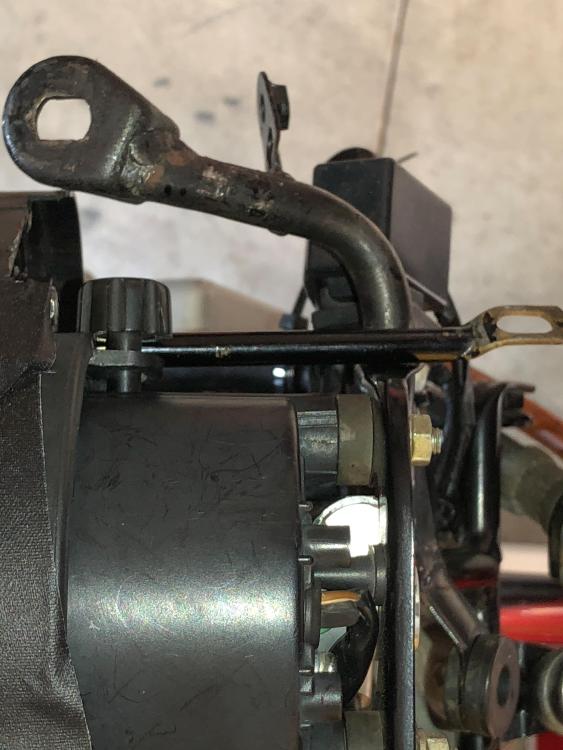

Member Contributer tsmitty Posted February 25, 2024 Author Member Contributer Posted February 25, 2024 Option 3... I like this one...
Member Contributer Captain 80s Posted February 25, 2024 Member Contributer Posted February 25, 2024 So do I. Smush and then hole drilled in the wall of the cowl stay? The angle to the mirror mount is better for staying in position, but that is a cleaner looking install.

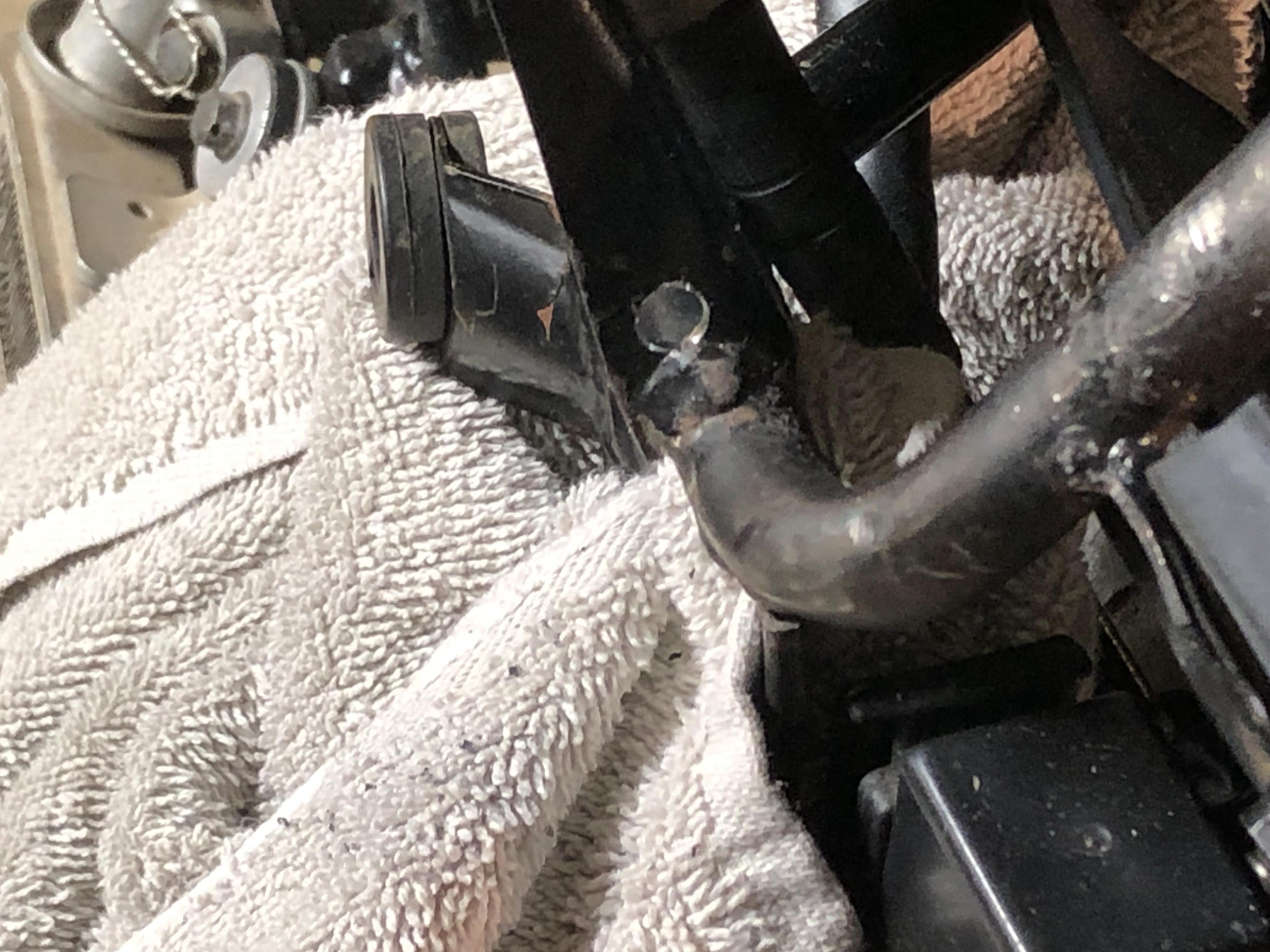

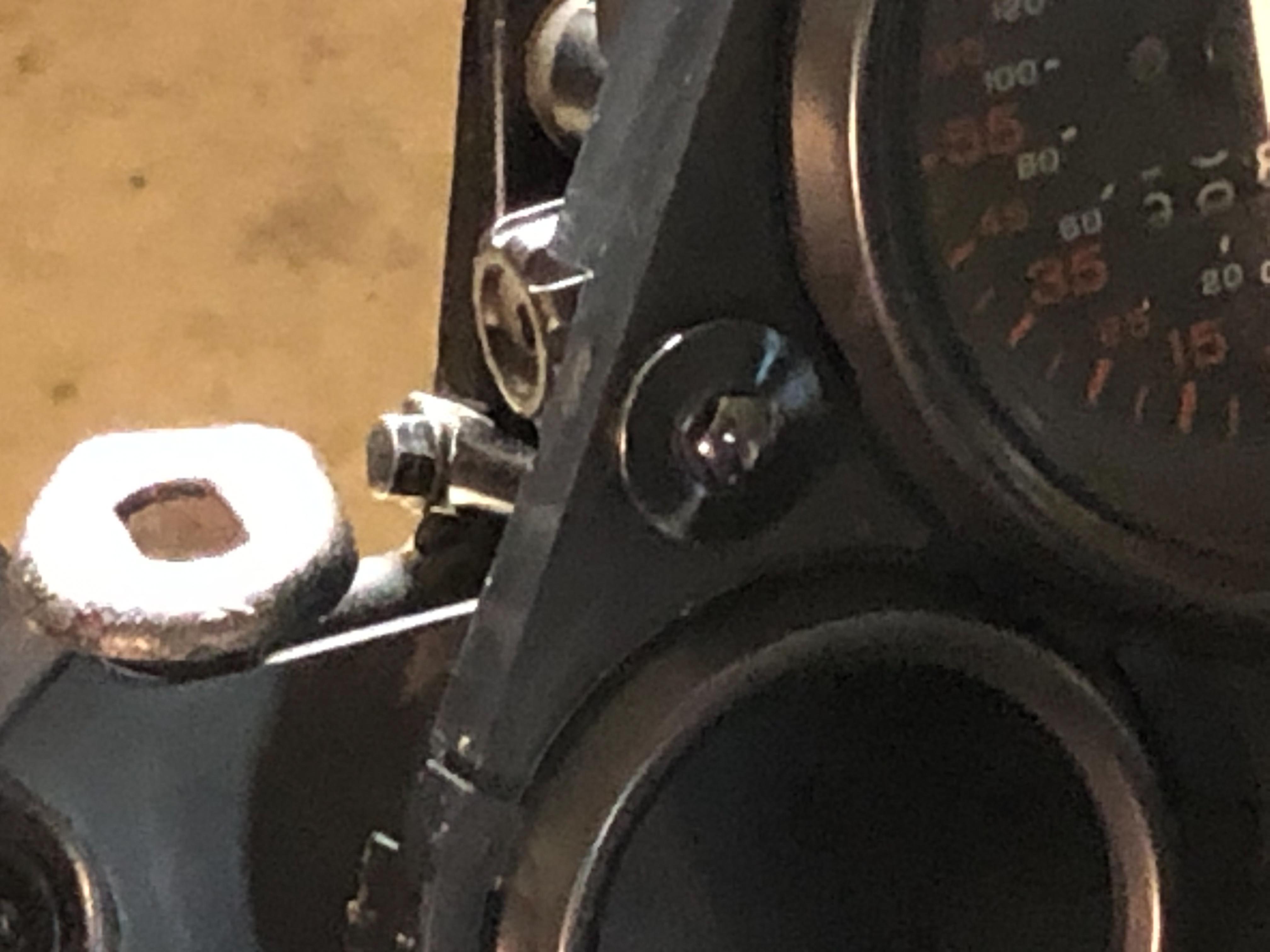

Member Contributer tsmitty Posted February 26, 2024 Author Member Contributer Posted February 26, 2024 I was thinking drilling thru the tube and the side of the gauge mount bracket as is right there, small bolt and nut, conical washer. The tube would be so much more sturdy or rigid not smushed down there.
Member Contributer tsmitty Posted February 26, 2024 Author Member Contributer Posted February 26, 2024 yea just disregard that last one, its late...

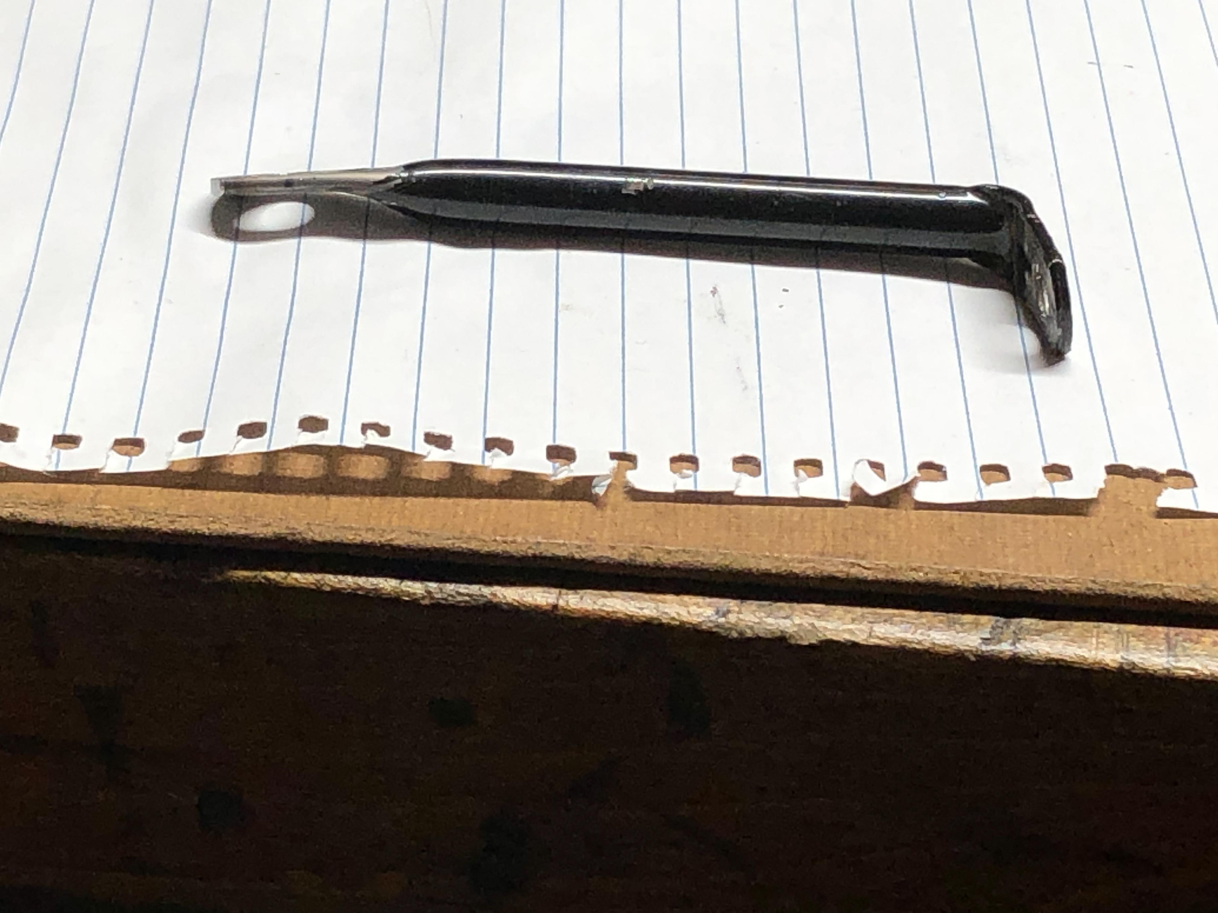

Member Contributer Captain 80s Posted February 26, 2024 Member Contributer Posted February 26, 2024 2 hours ago, tsmitty said: yea just disregard that last one, its late... Too late... smush it. You don't lose any strength in the same plane and it's a much nicer install. Plus flat on flat is a better engagement to hold it's position. Maybe there's a machine shop near you that will let you have 5 minutes on their press. But if you have a big enough vise and a torch, it will go easy. 1

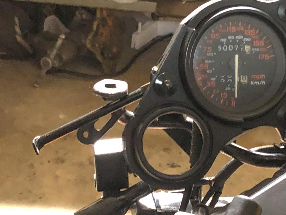

Member Contributer tsmitty Posted February 26, 2024 Author Member Contributer Posted February 26, 2024 I think I'm golden Captain. I don't think I'll need any tape, if so can be applied anytime. The speedo and bezel can wiggle together or separately. The only alteration to the bike is 13/64 hole in the cowl sub-frame. Thoughts?
Member Contributer Captain 80s Posted February 26, 2024 Member Contributer Posted February 26, 2024 Smush for the win! Nice. 1

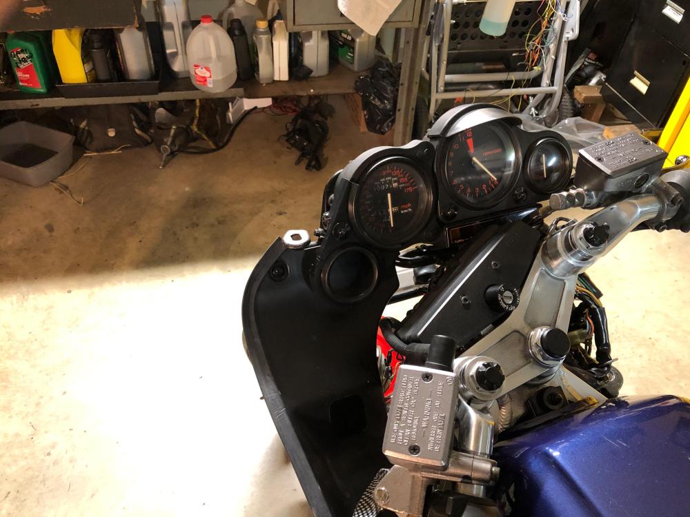

Member Contributer tsmitty Posted February 26, 2024 Author Member Contributer Posted February 26, 2024 Here is the meter mounted with the rubber overlay. I don't have the harness made up yet...easy-pezy to do later. I have another meter I got on eslay for 5.00 that one is to experiment on changing the letters and numbers to match the stock colors. And...here is what she looks like with her cloths back on. Please, an honest opinion of the final look. Represent? The good news is 1 bolt, its off of there and no one will ever know...
Member Contributer Captain 80s Posted February 26, 2024 Member Contributer Posted February 26, 2024 That's pretty cool. Nice job. Def unique. 1

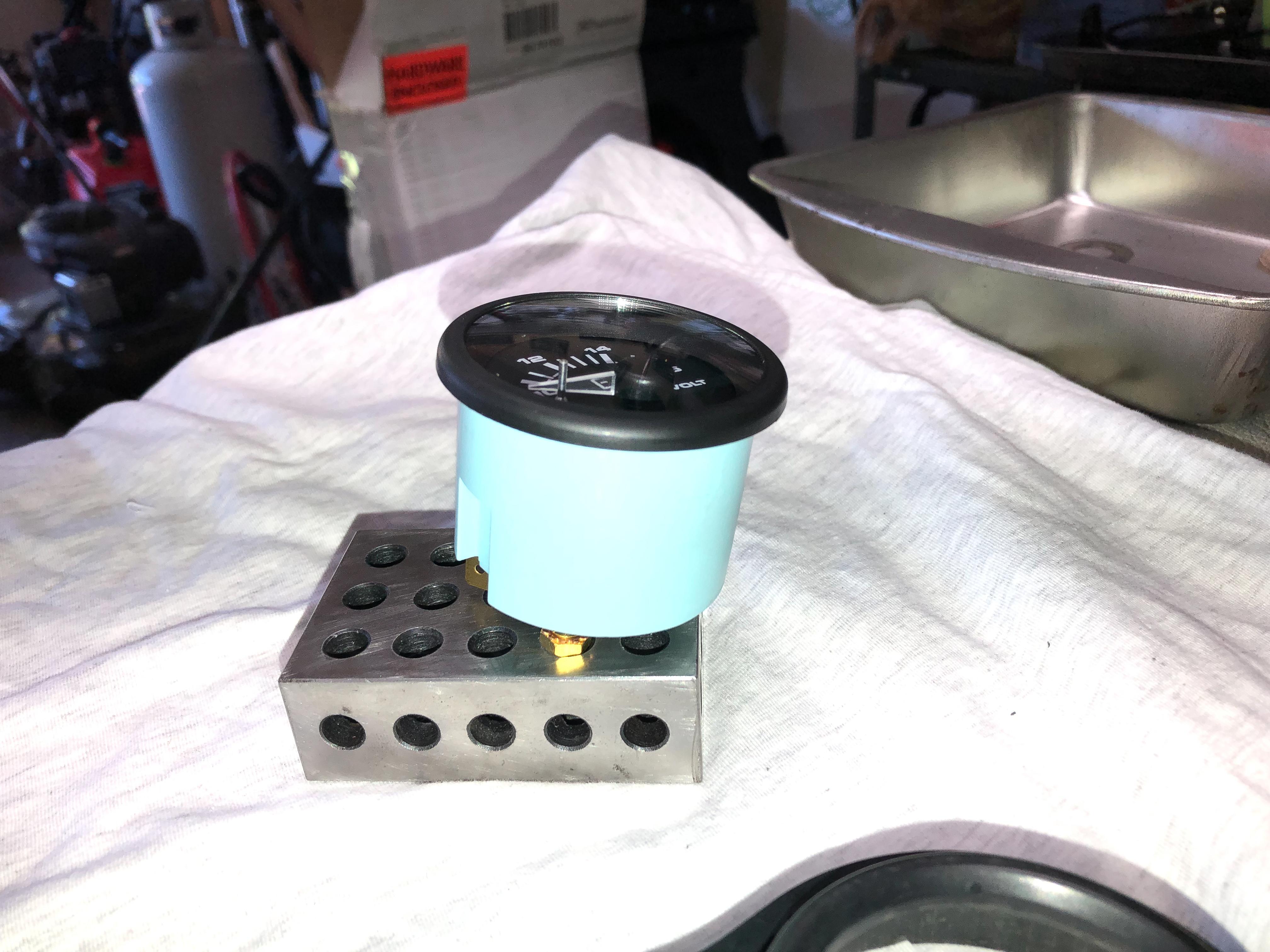

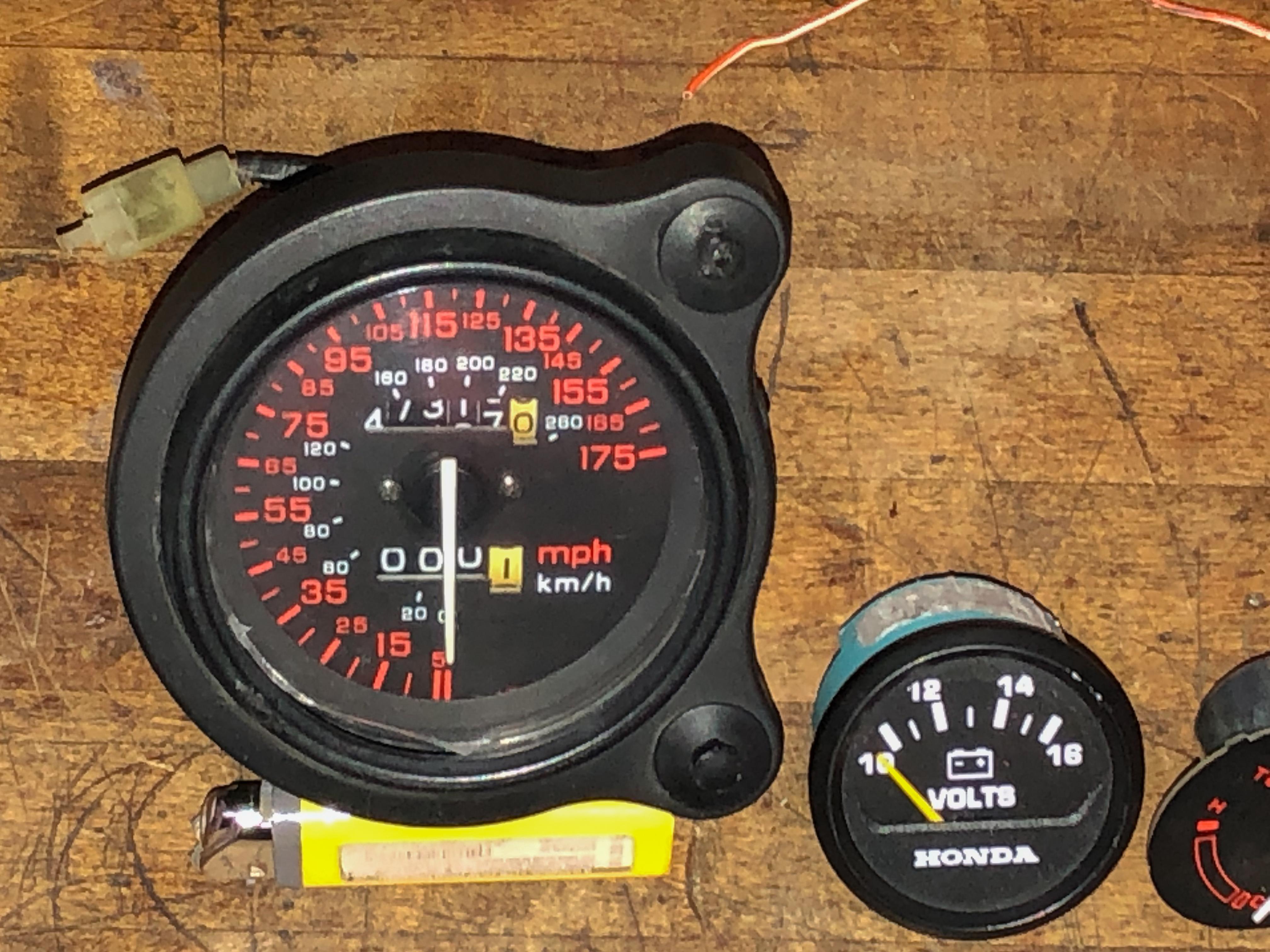

Member Contributer tsmitty Posted February 27, 2024 Author Member Contributer Posted February 27, 2024 Ok, now that the boo-hoo session is over and moving forward. Below, side by side, is a totally "toast" speedo and a 5.00 ebay sacrificial volt gauge. I have two questions... 1) How do I change the white letters and numbers into pretty reddish/orangish letters and numbers? 2) How do I transfer those techniques to the gauge that I have currently mounted to the bike? Aaannd...go.
Member Contributer Captain 80s Posted February 27, 2024 Member Contributer Posted February 27, 2024 I would take another hit with that lighter, chill out with a finger of bourbon and look at my killer bike with it's new custom Volt Meter. 2
