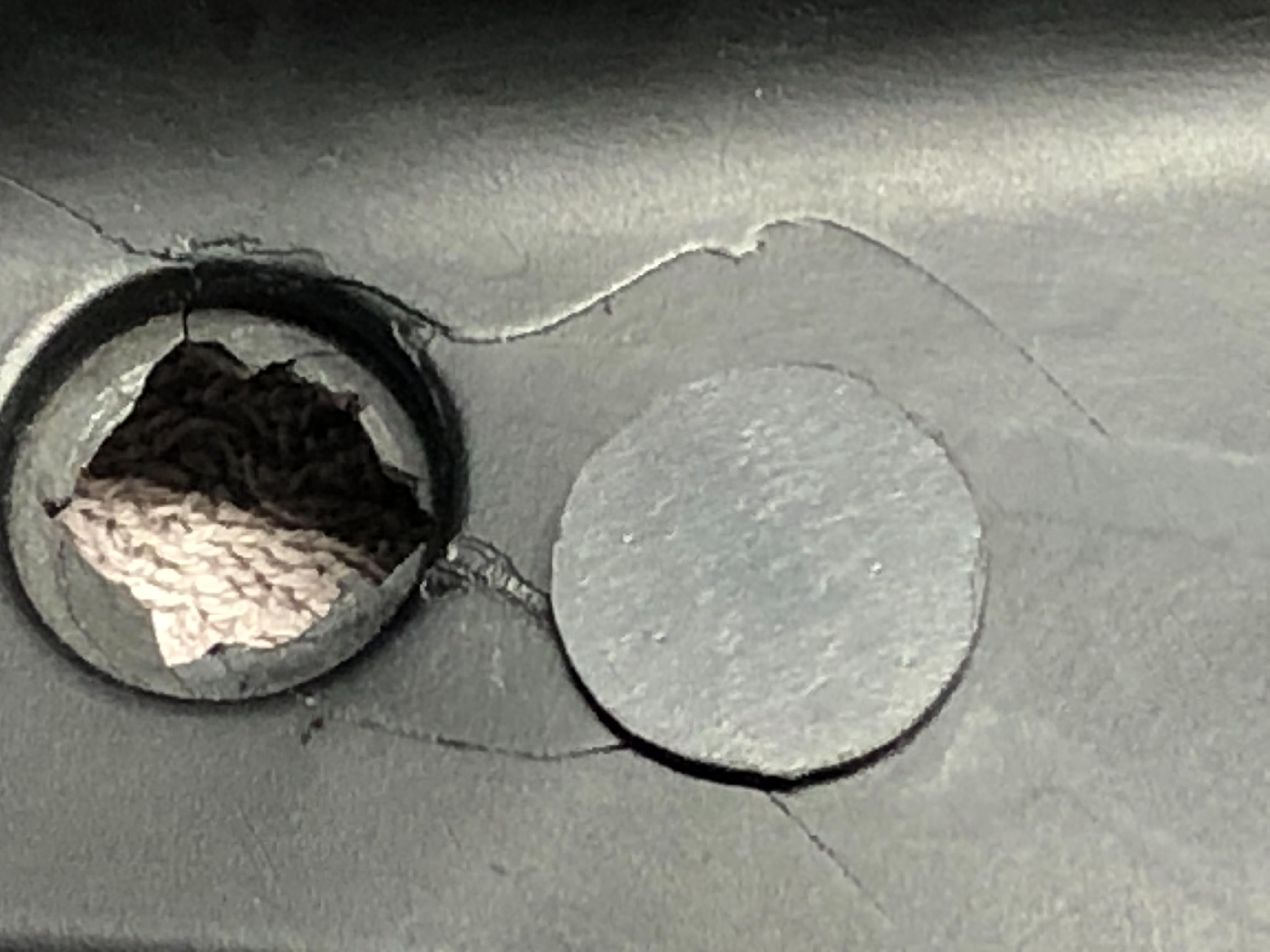

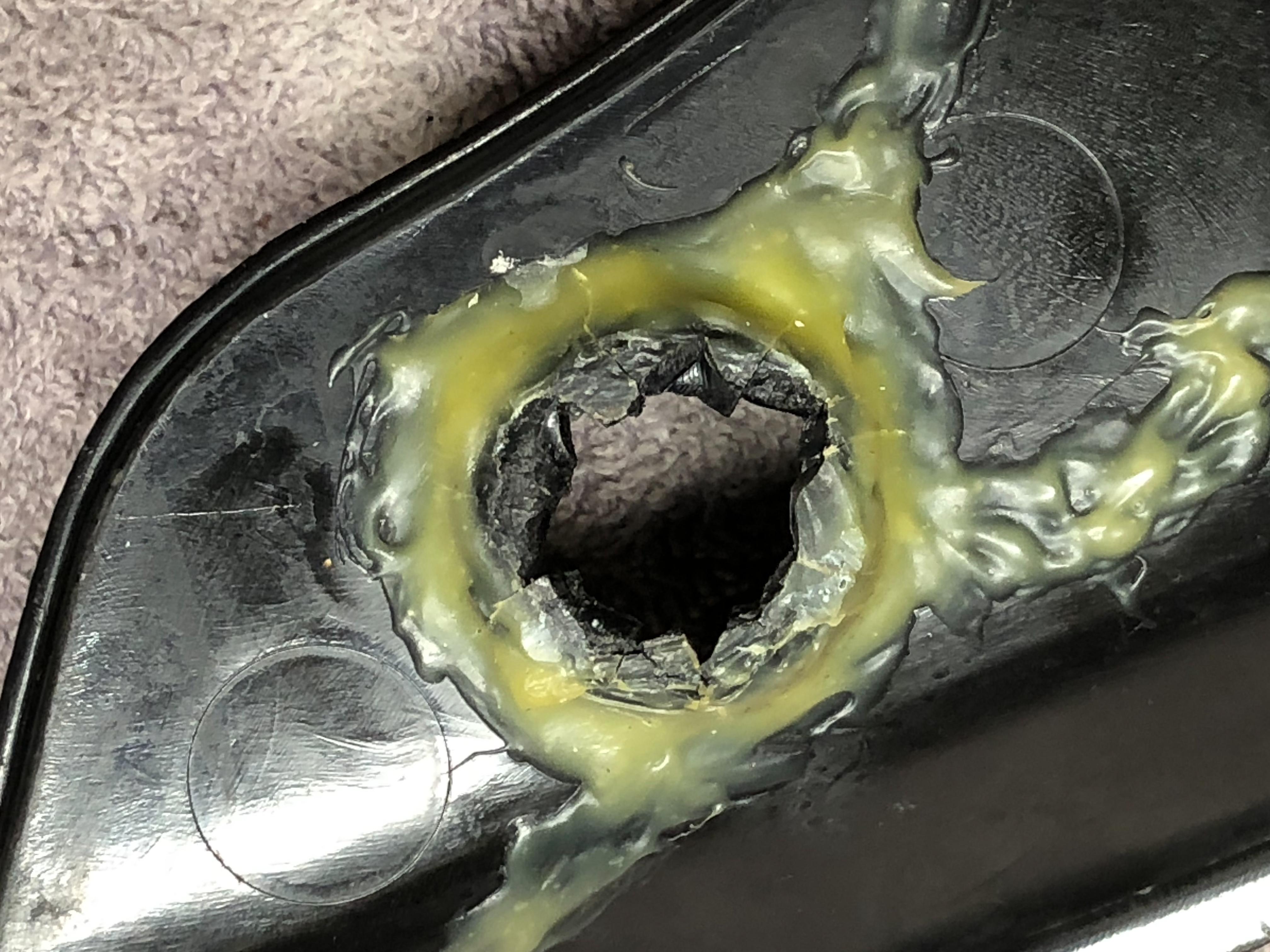

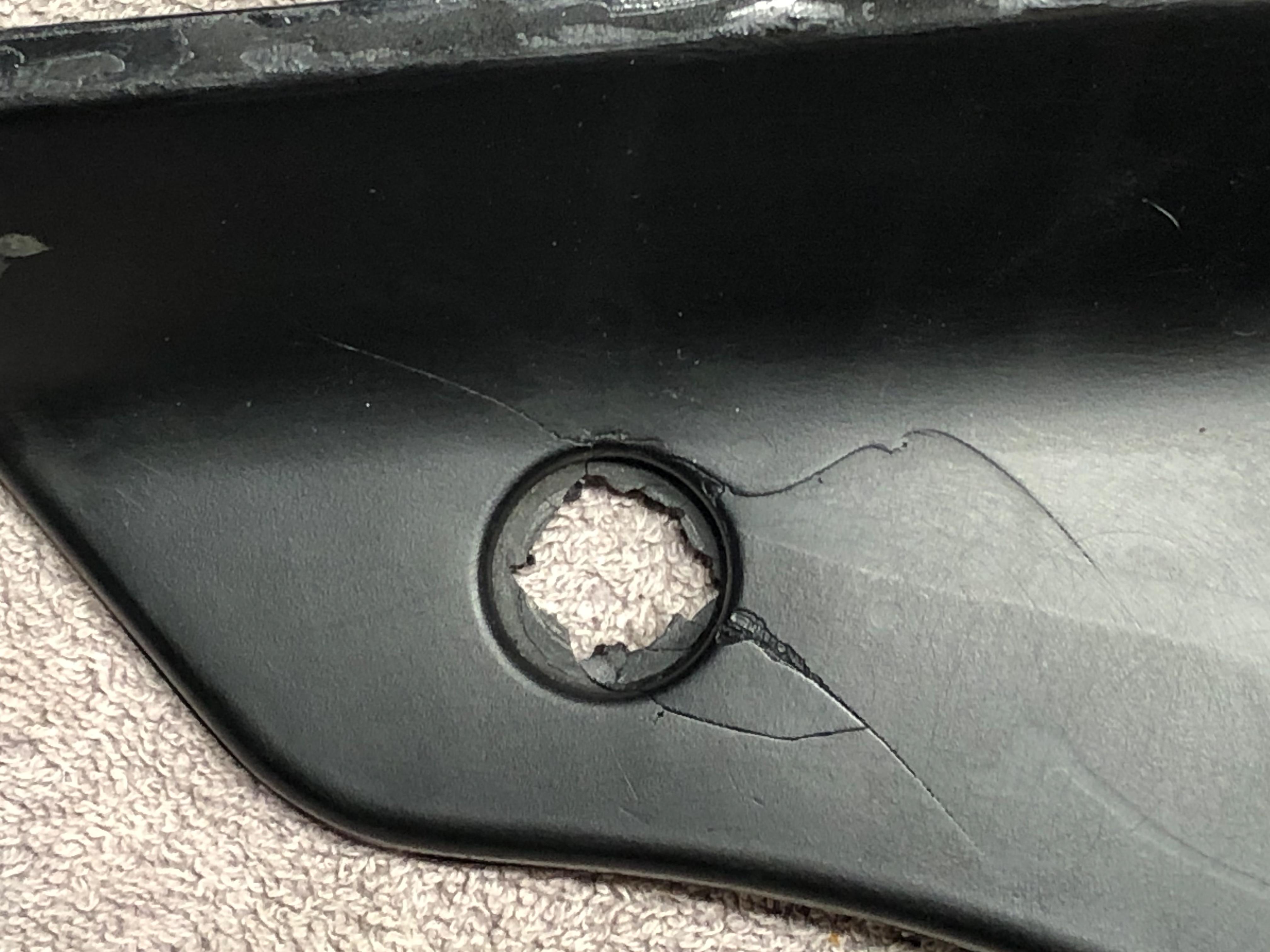

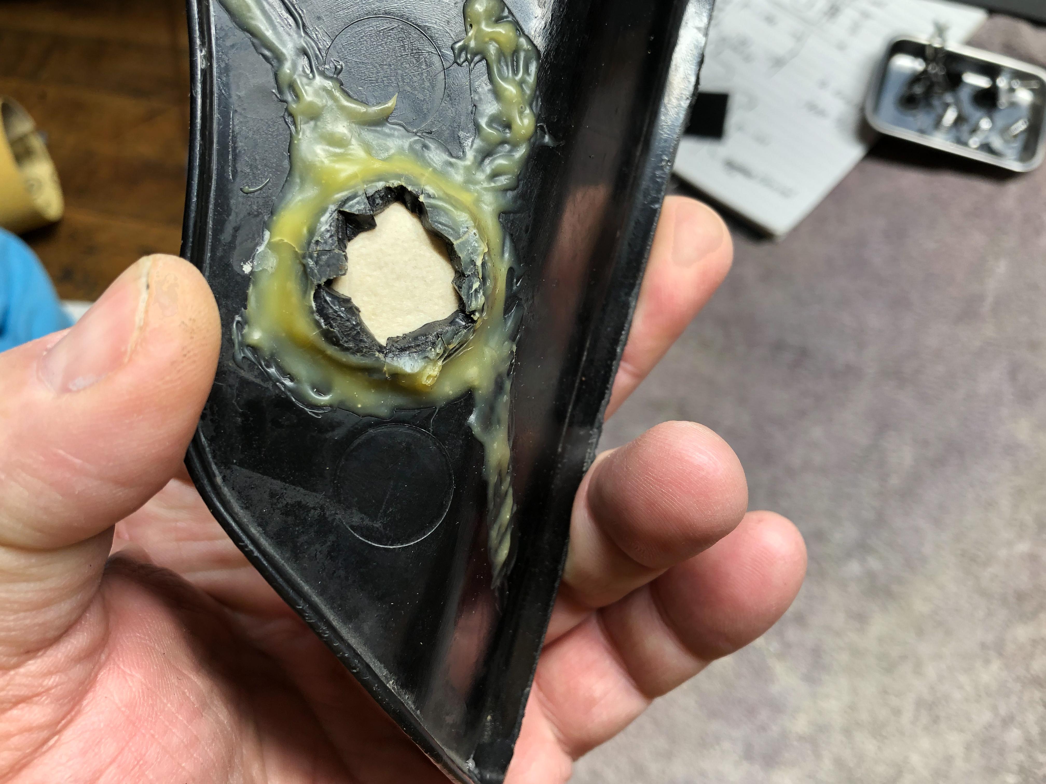

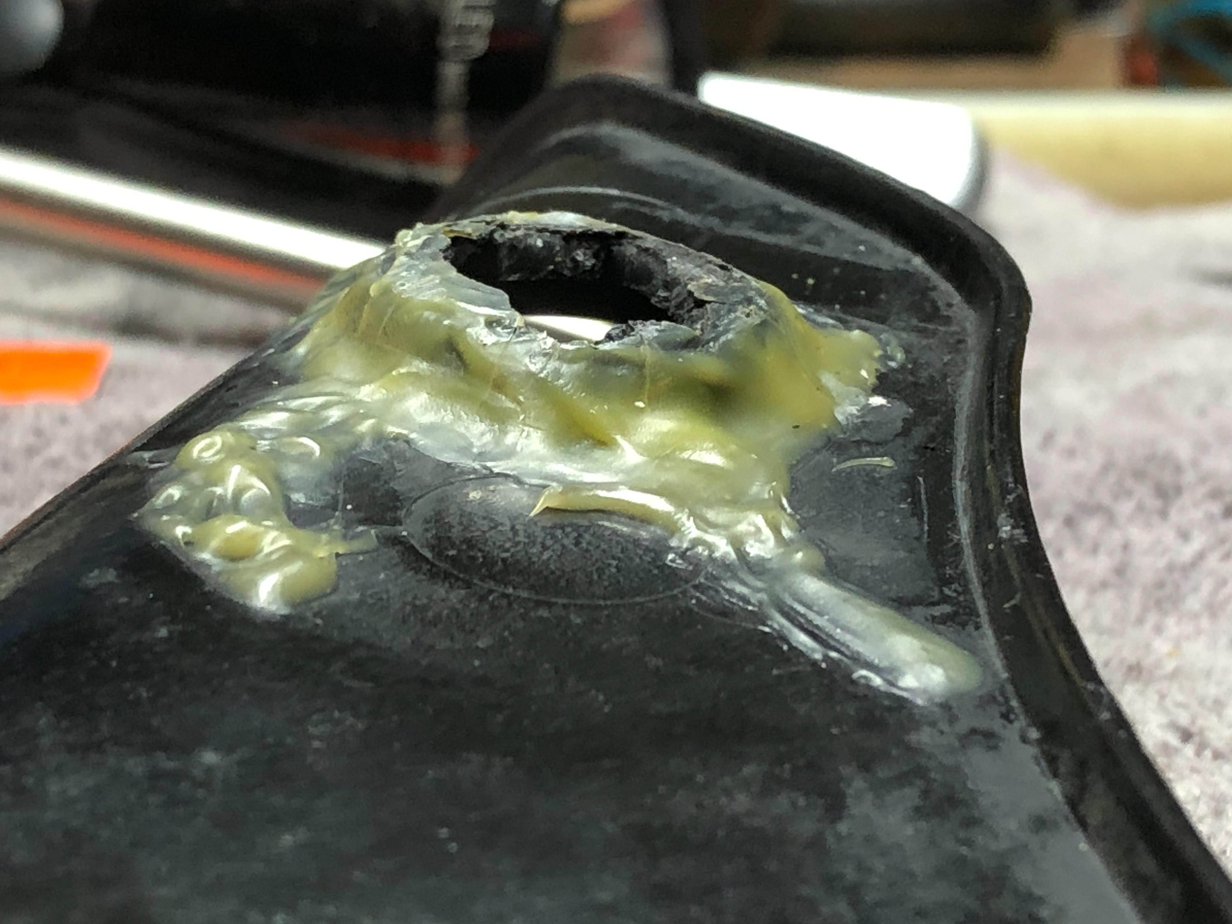

Cap. have you played around with that piece of fabric I sent you? the reason I asked is one of your in-fills; the left lower mount screw well is disintegrating at the bottom. Both the top and bottom screw locations have been epoxied. Well I'm thinking of that cloth material, it bonds so well to that abs plastic. I'll get some pics tomorrow, I know my description is pretty weak.
I know exactly what you're talking about.  That epoxy job was a "oh shit, I need this done right now for tomorrow" job, always meant to be revisited and correctly redone.  The epoxy was the right stuff, just no reinforcement plan in the moment.  Was just trying to keep the pieces from literally falling apart.  The fact that it lasted this long is pretty remarkable.  That plastic and that epoxy are perfect mates.
I think that "fabric" is a good application for those areas.  I was even planning on making some plastic "donuts" to go around the mounts on the back side for additional strength.
Yes! on the same track!
I'll talk later with you about it.
The stuff won't adhere to any epoxy. But still a great idea.

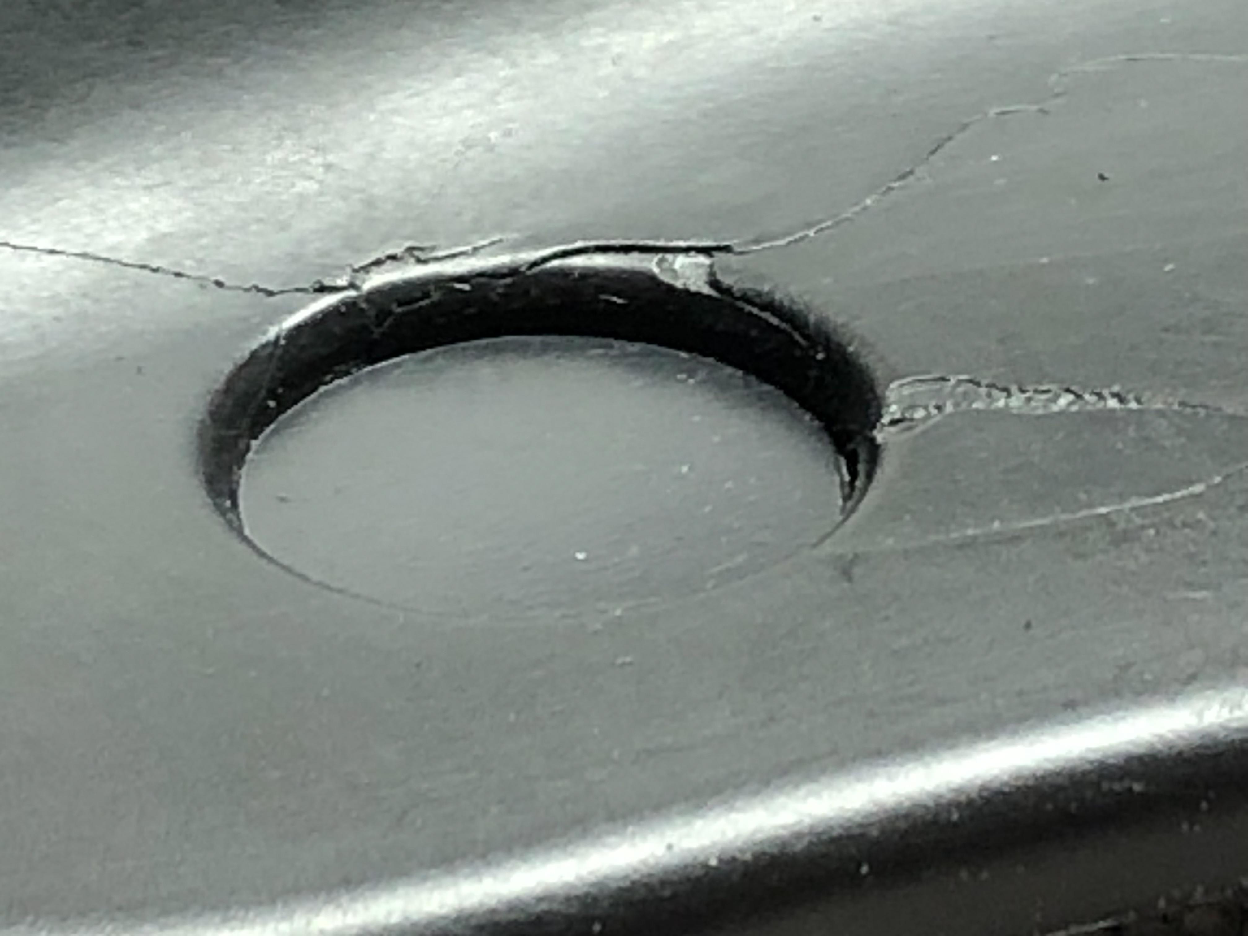

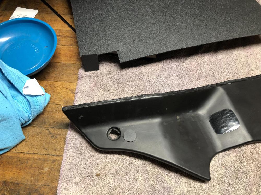

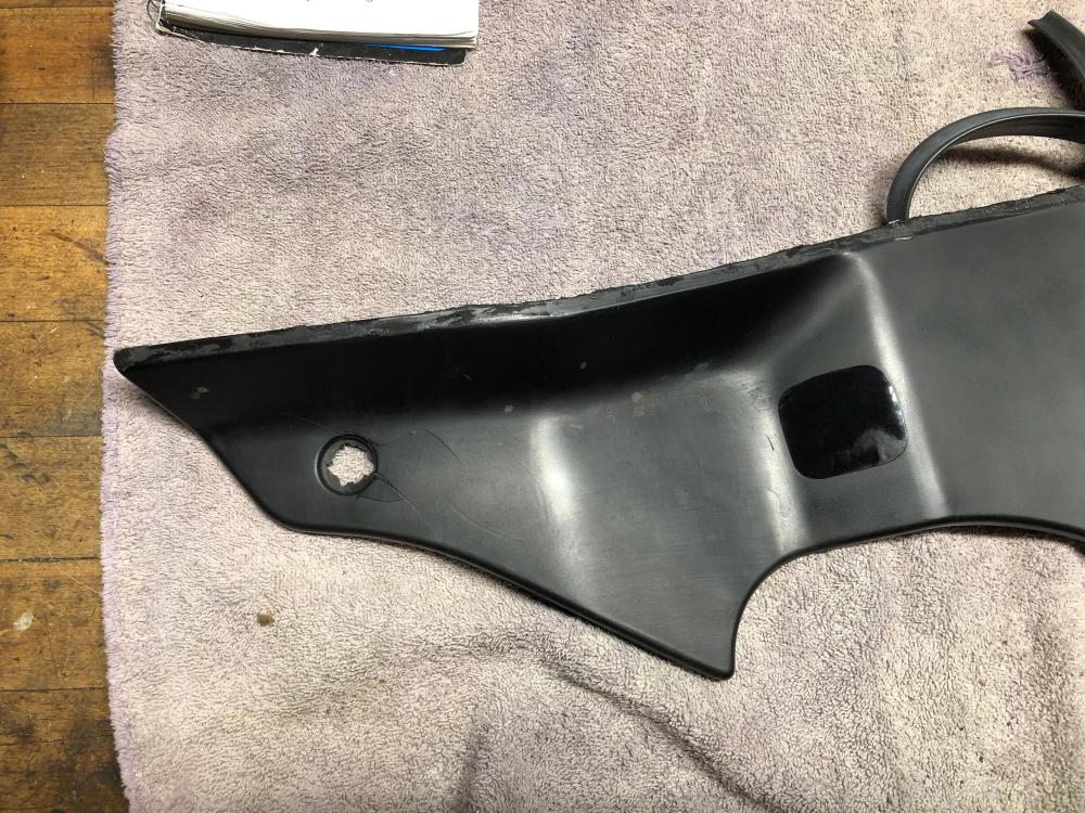

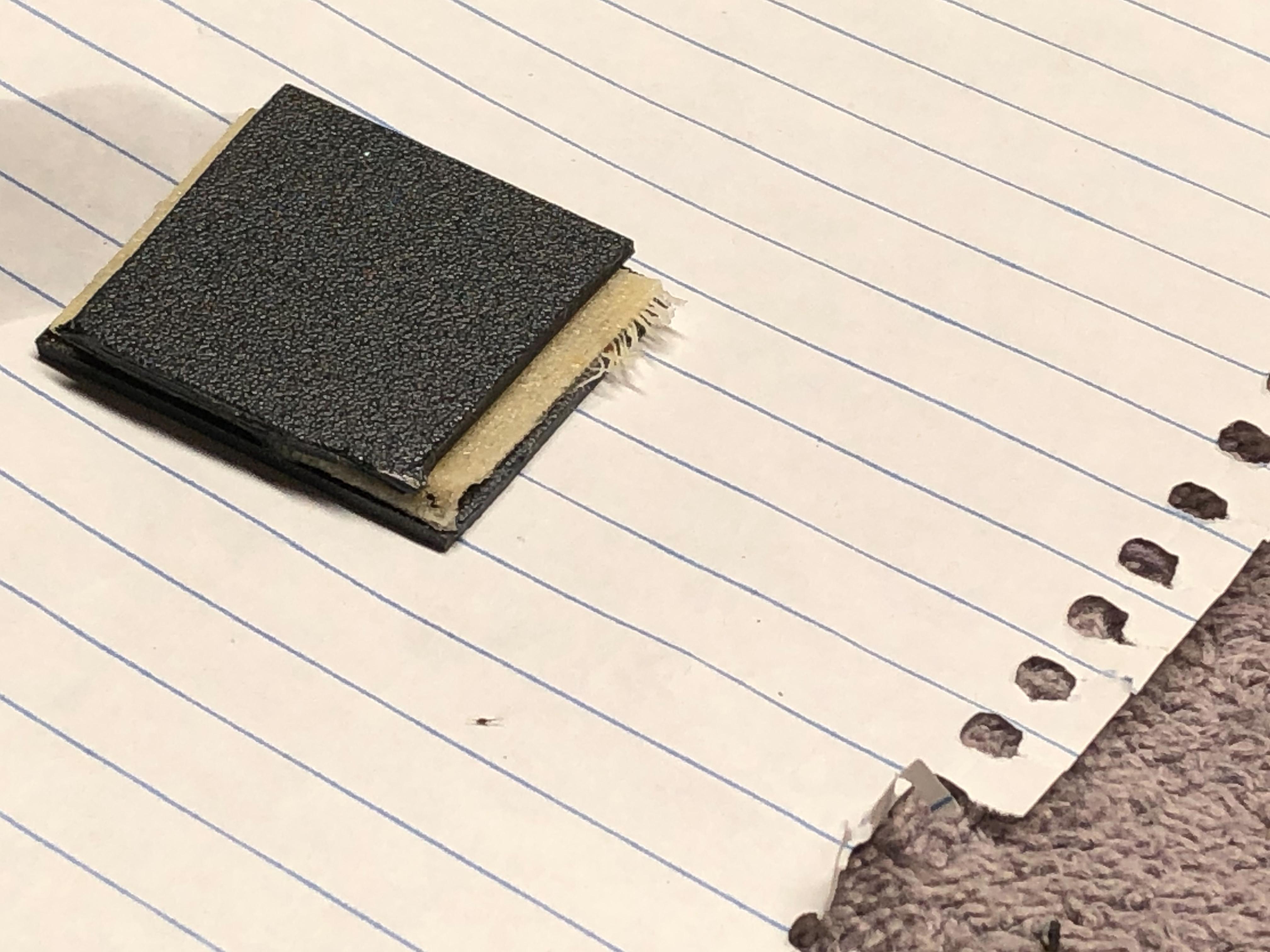

This is what I guess would be plan 1...
untitledshoot-1443.thumb.jpg.b227d6ceb6789a8a7ea73a270161874c.jpguntitledshoot-1442.thumb.jpg.ea710f5fedc7a875bc6f1181edba53d4.jpguntitledshoot-1441.thumb.jpg.c5f7f268cece47e2de70a465ab6b6dd8.jpguntitledshoot-1440.thumb.jpg.21861d002ce0f35fbb071fb29995541a.jpg
This is what I was thinking; I have some ABS sheet. ( https://www.amazon.com/gp/product/B0BJDKZWDF/ref=ppx_yo_dt_b_search_asin_title?ie=UTF8&psc=1 )
Making a new counterbore bottom, using the cloth as double sided sticky, then filling the back with more sandwiched abs and that plastic repair powder. Cant remember the name right now...Plastex or something.
untitledshoot-1454.thumb.jpg.e7f0063ba3cfd854b7ce9dae68ef9c6e.jpguntitledshoot-1453.thumb.jpg.38e0faf2e55dc0404ea1881ef1d5fbd4.jpguntitledshoot-1452.thumb.jpg.03bf794dfb592ee7fc2ddd086ff6df95.jpguntitledshoot-1451.thumb.jpg.aaacc3891310dd7648b358525c67b6f4.jpg
The con's of this would be loss of counterbore depth. The "shoulder screws" would need spacers to make up for the thickness change so the pretty infill still floats... 🙂
The pro's are top ascetics around the screw (hope) new pliable plastic to float around that shoulder screw.
Whats your thoughts?
I was thinking drilling thru the tube and the side of the gauge mount bracket as is right there, small bolt and nut, conical washer. The tube would be so much more sturdy or rigid not smushed down there.

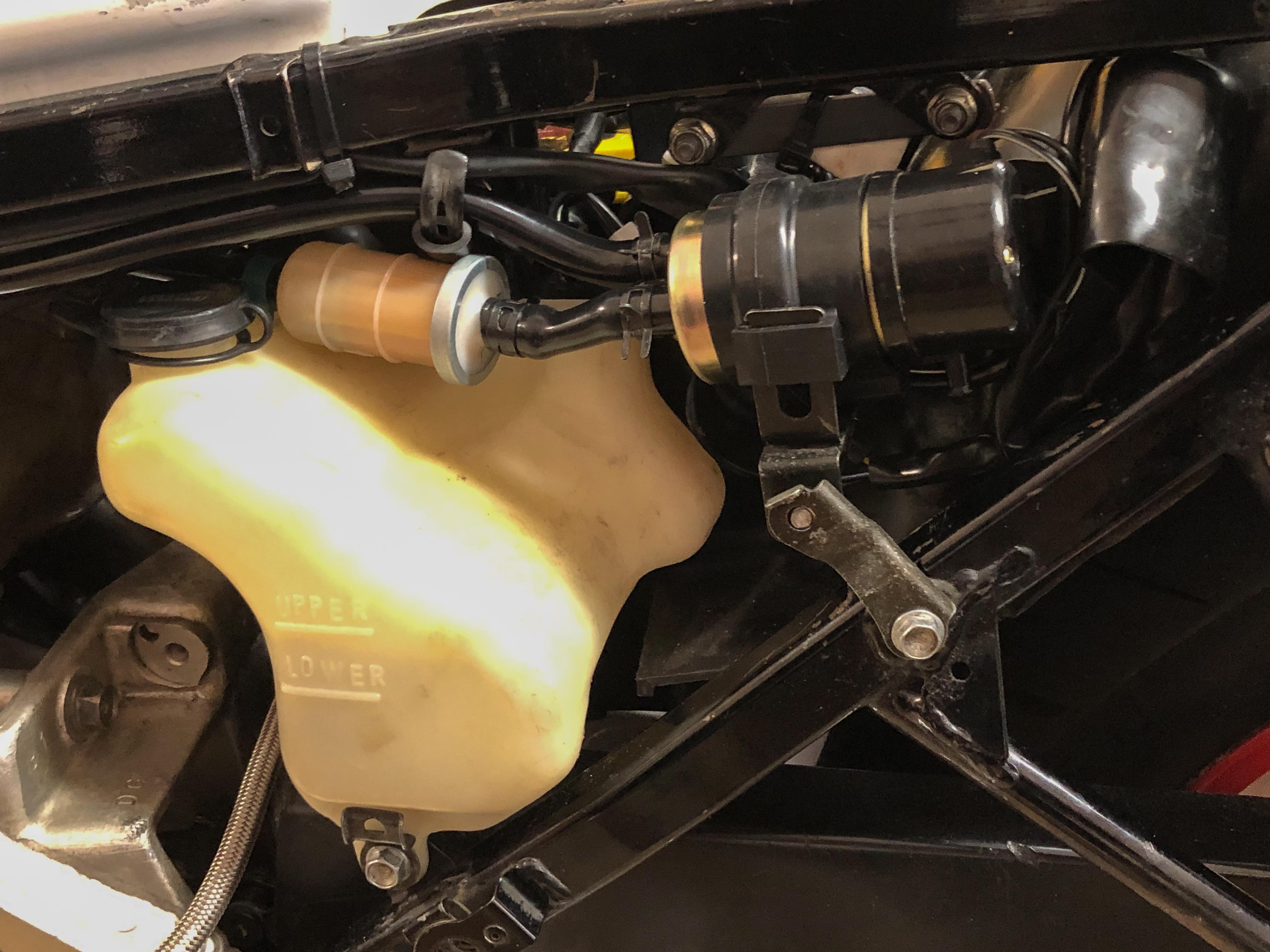

Like I said, you're gonna have to get a little creative getting the lines turned to go up and over the coolant tank.  I've used some brass 90 deg fittings on some other bikes where I created room for the extra length coming out of the pump.  Small section of fuel line with the fittings butted right up to the pump spigots,
Some others have cut the fuel pump spigots short and eliminated the bead.  I haven't had to resort to that.

Can the pump be moved and lay any flatter?
Of course.  Also, you might be able to make a small bracket to move the pump rearward a little to bridge the pump holder and the subframe mount.
I may do just as you said, bring it up and tilt it just a little flatter still maintaining the little drain.
The F/Pump you linked to earlier never got delivered and I know this will bring a cringe, I'm putting a new Mitubichi on it. Please keep me posted or pics of how you do yours.

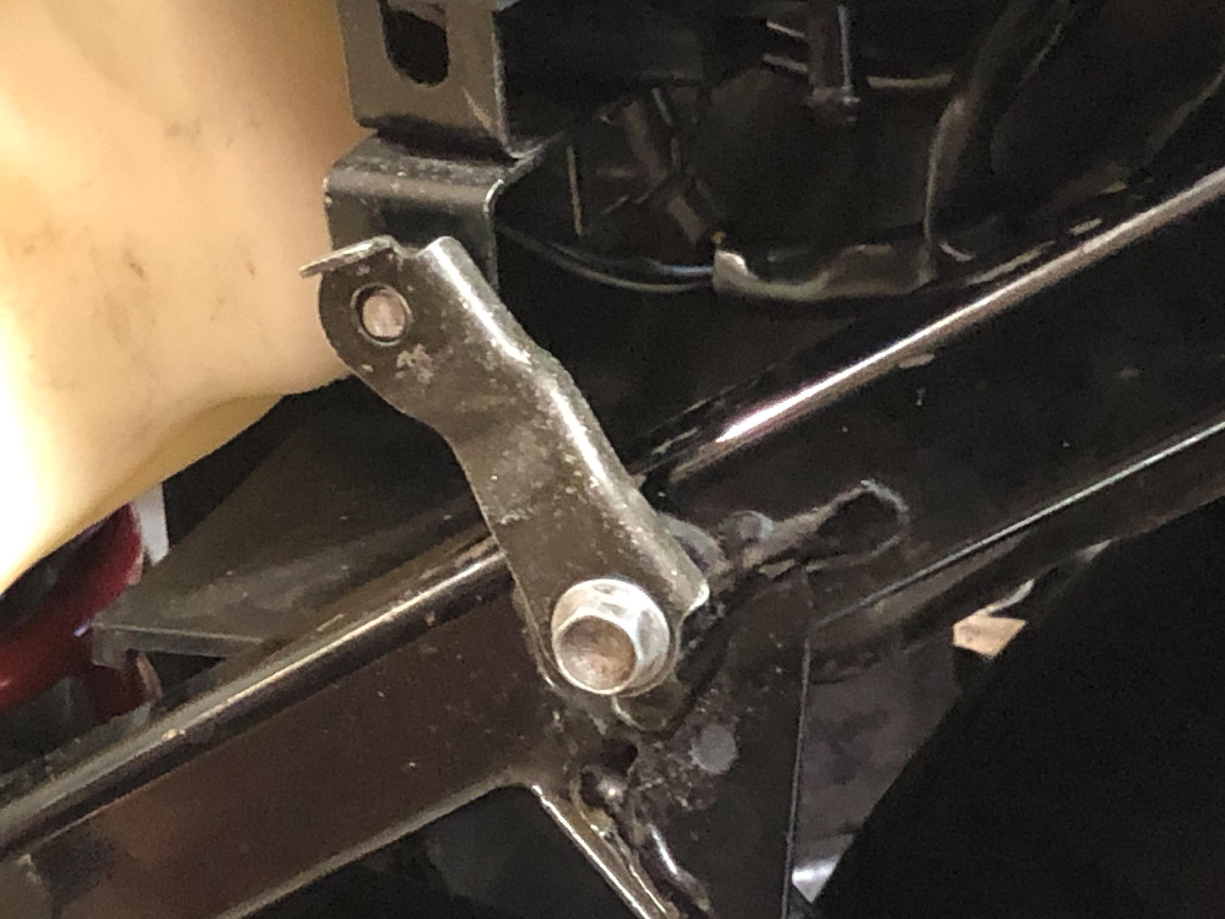

When I put this together last year, I used Motion Pro 5/16 with some not very confidence inspiring clamps.
What should I be using?
I have a low profile brass 90 coming out of the tank.
Cant remember right now where this bracket came from.
I believe that is the side stand mount to lower cowl bracket.
