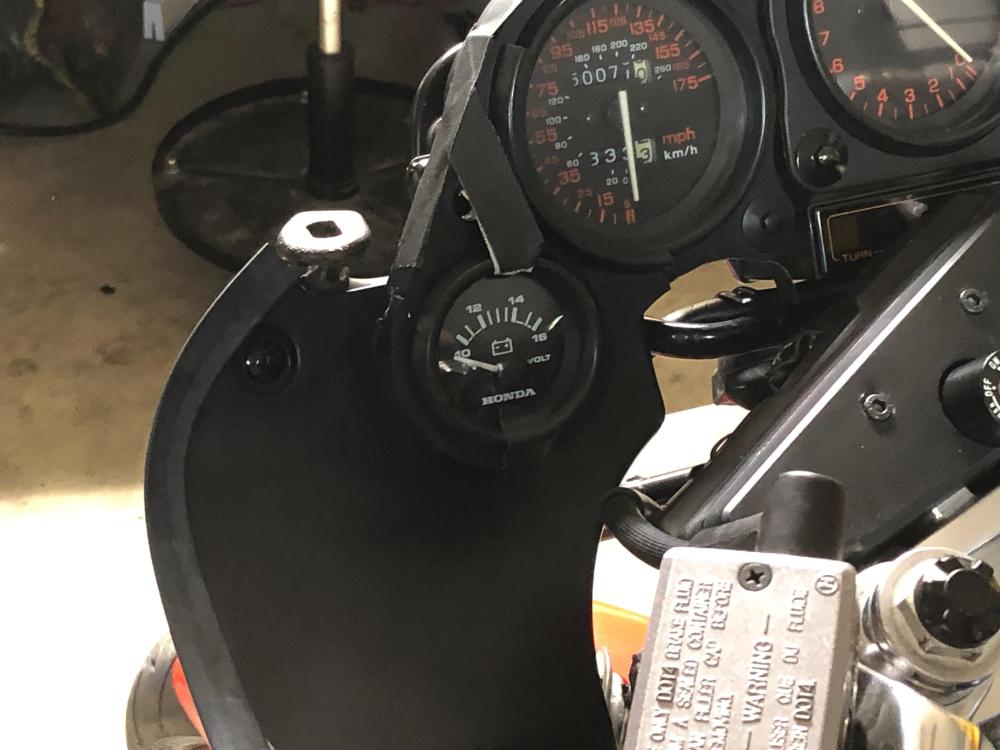

So if I pivot the bezel closer to the mirror mount, I can still just manipulate the "trip counter", more trimming of the V/M connectors, surface mounted bracket from the mirror m/post???? Long story short, there is clearance and everything can be reversible. I plan to do the same for the wire harness.

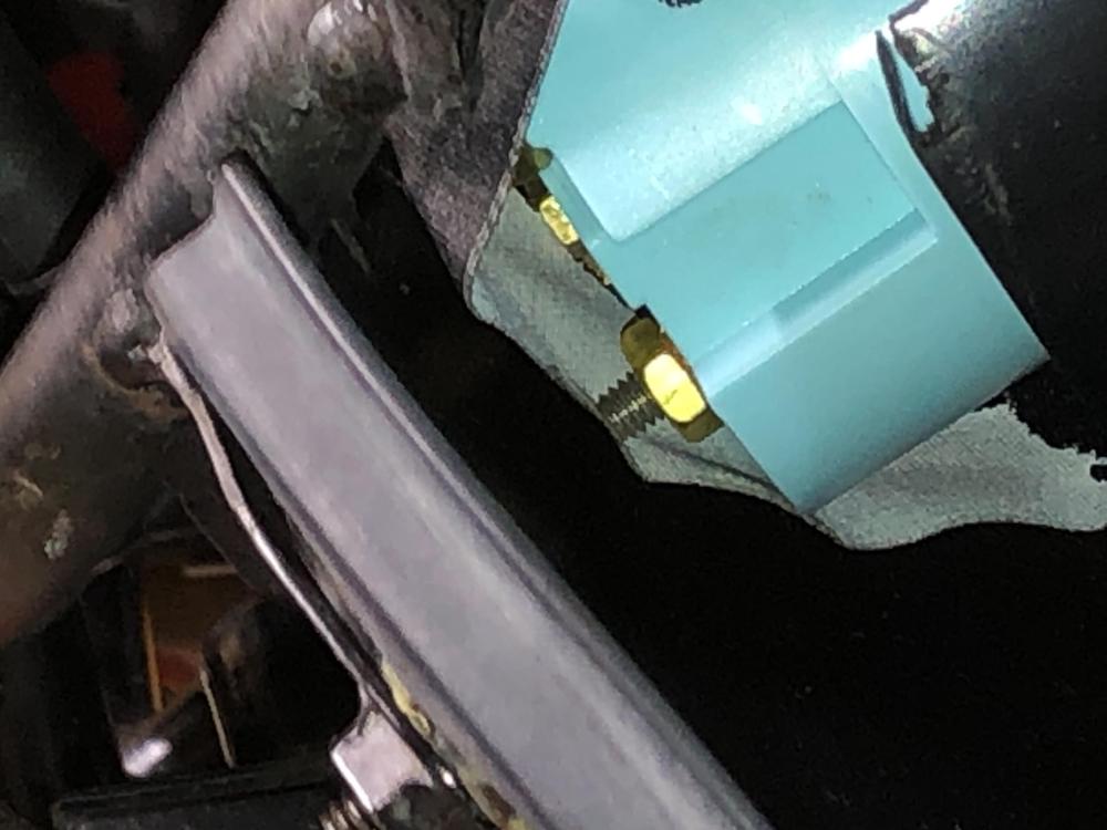

This is the clearance behind the volt gauge after trimming the terminals.

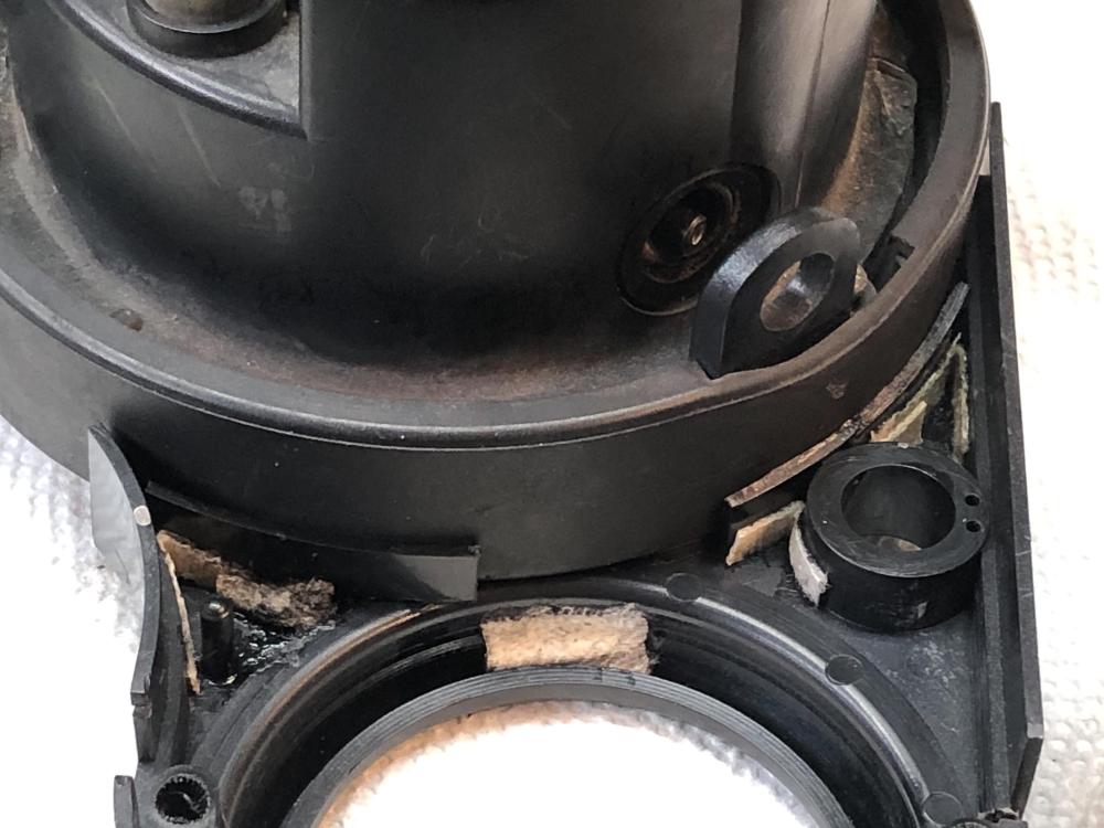

Inching forward, I did some reinforcing to the underside of the bezel.

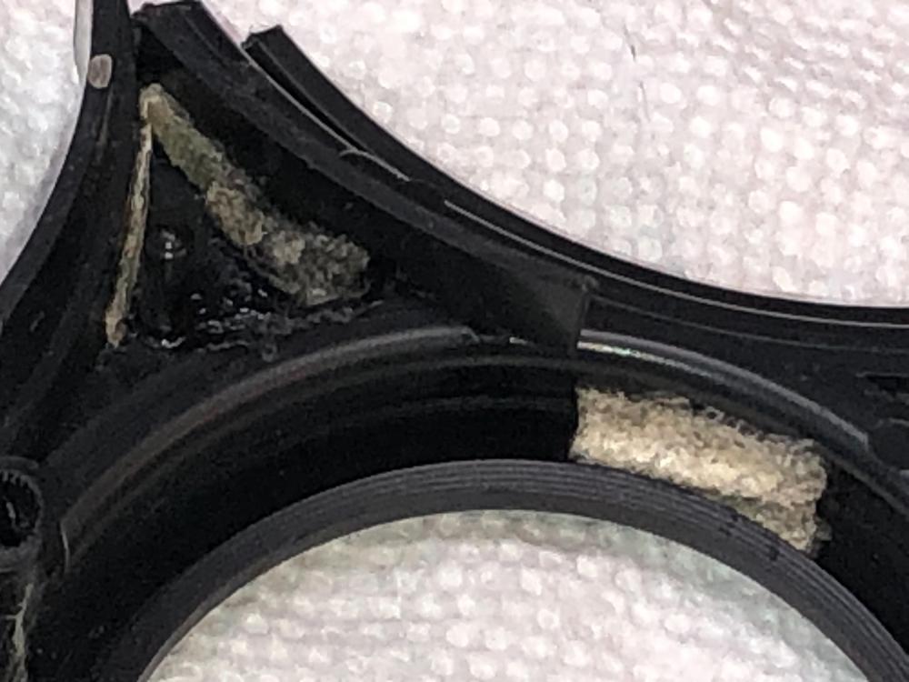

I added some curved plastic from scrap to better allow the assembly to nest to the tach-o, that fabric stuff I have is flippin awesome at this, I still went by later with Plastex in the corners of the unions to make me feel better but I'm sure wasn't necessary, that fabric holds quite well.
Fixed the threaded incerts for securing the meter.

What are your attachment points, on the gauge and bike?

I'm going to try to bring a bracket from under the left mirror mount, so it won't interfere too much with the speedo moving around.
Also looked at a bracket going down to a mount just under the speedo mount and fab up my own damper.
Or both.
Possible bracket running alongside the speedometer and zip-tie the volt assembly to the tach. assembly, but thought that might be too much load on the two speedhometer damped mounts.

I would try and independently mount it from the upper cowl / mirror stay area personally.  And / or try and bridge across form the area  the tach mounts to.
On the volt meter side, using the mount hole with a rubber washer for a little cushion.
The knob for the trip counter is directly behind, so any brackets has to come around that...
Yup.
Its warming up in the garage to work out there for a few. I'm going to work that angle. That one mount lug on the bezel looks plenty stout enough to hold the assembly.
Then try to come up under the mirror mount nut?

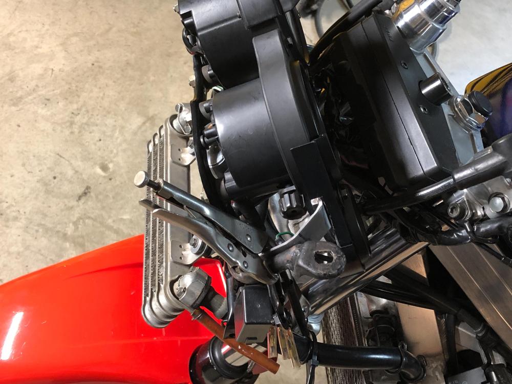

Moving right along...here is what I have so far.
image.thumb.jpeg.a88928a8438ec5ad97150c6efaaf0d9f.jpegimage.thumb.jpeg.97a721654af27f8d6e0c92992ba21ded.jpegimage.thumb.jpeg.4a6747cf3bc3ac3b0cdc1e3396d0d18b.jpegimage.thumb.jpeg.72449c27f33717f832f9c47825ffa354.jpeg

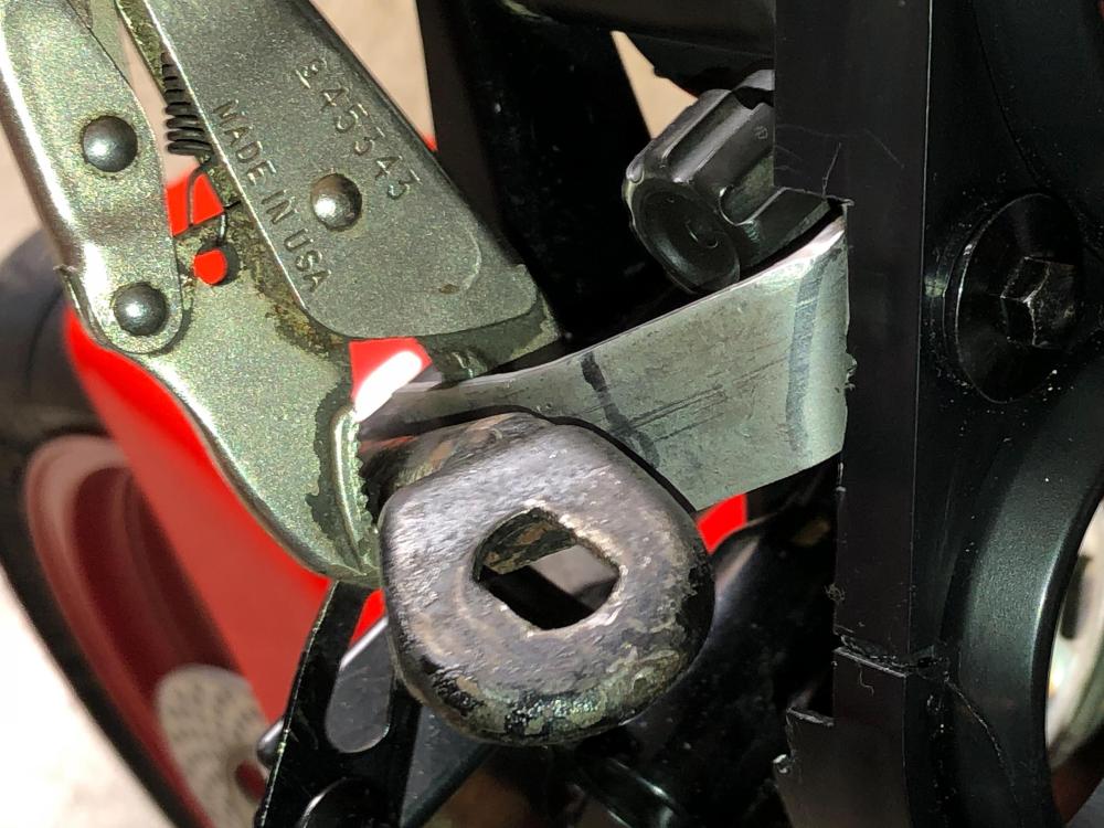

I don't think a hose clamp will be strong enough to secure the 1/8x3/4 steel bracket I'm using for the bezel to the mirror stay by its self.
Maybe a small anti-rotation bolt at the bottom of the bracket and hose clamp?
What do you think...
I think the vise grips should be a perfect place to mount a skeleton hand mirror...
No hose clamps.  Don't sink to that level at this point.

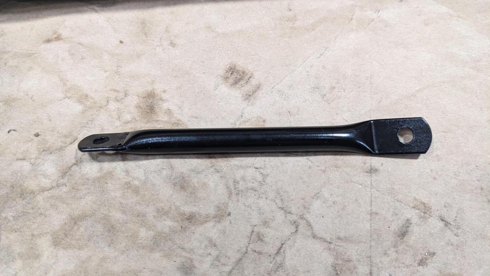

Here's an idea and it's simple, effective, strong and something Honda does.
Get some mild steel tubing.  Heat and press flat with some aluminum chunks, radius them for a smooth "smush" transition.  Then figure out the rotation / length to connect the meter and the mirror stud off the bottom.

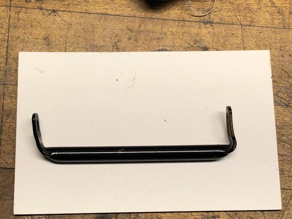

Here's an example from something I did for the 92
While the tubing is still in the "presses" and warm you can best guess an angle, but can be adjusted later.
That sure looks like a pretty straight piece with a ~80 deg rotation.

Yeah, I touched on it earlier.  Alum blocks that I radius the edges a bit on for my "dies".
Get the tube set up in the press at the depth / angle / rotation I want, heat it up good and smush the fuck out of it.
The mild steel tubing you can buy at Home Depot or Lowes works really good, but the inventory on it has been low in the last couple years.  I ordered some from a local steel supplier, but didn't like the composition as much.  It wanted to crack a little on the edges of the smush.
Aerospace titanium on the other hand smushes real nice, but shaping and drilling after isn't as easy.  And it doesn't paint as nice.

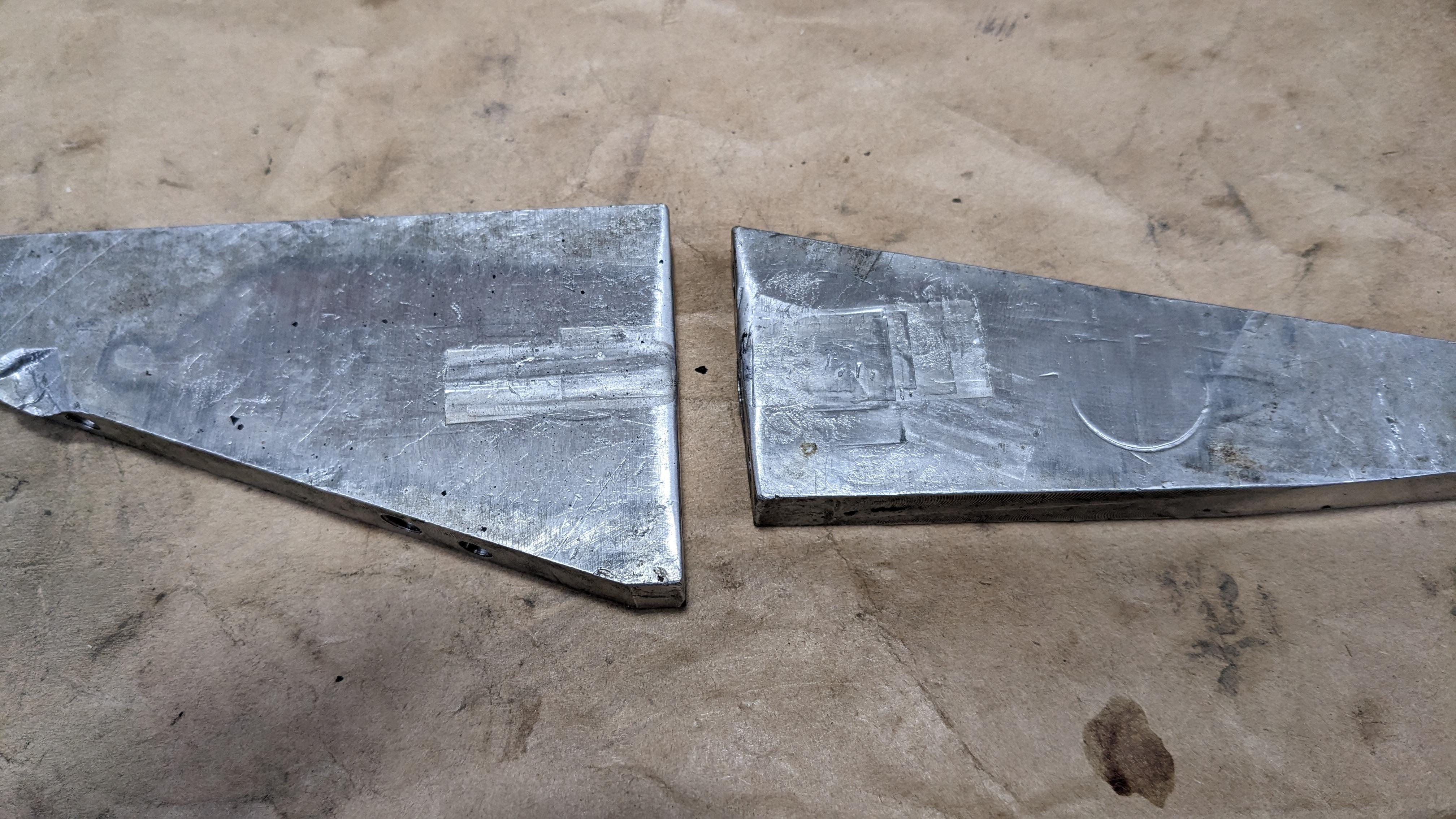

Oh, and here's my dies.  They are scheduled for replacement.  They've smushed A LOT of brackets.
