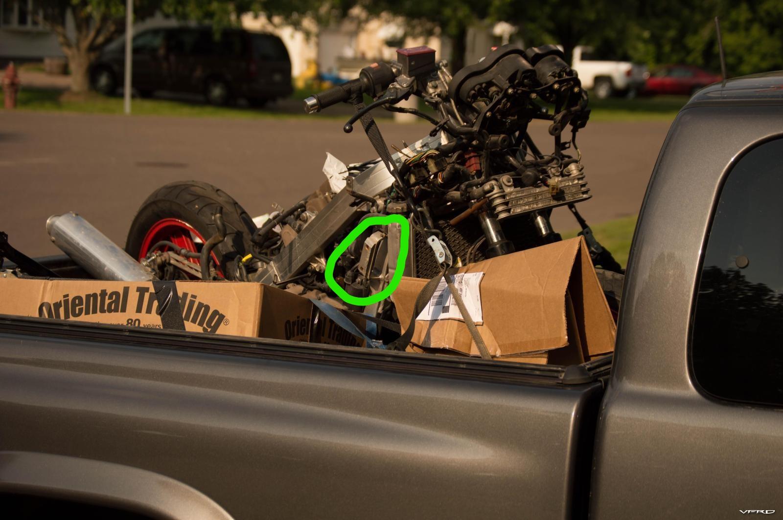

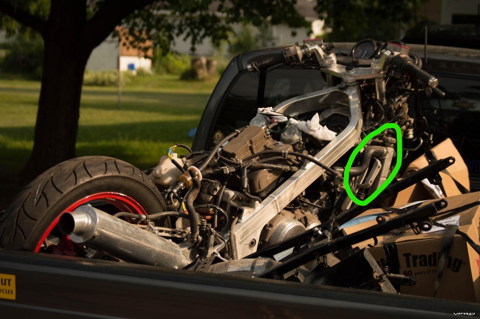

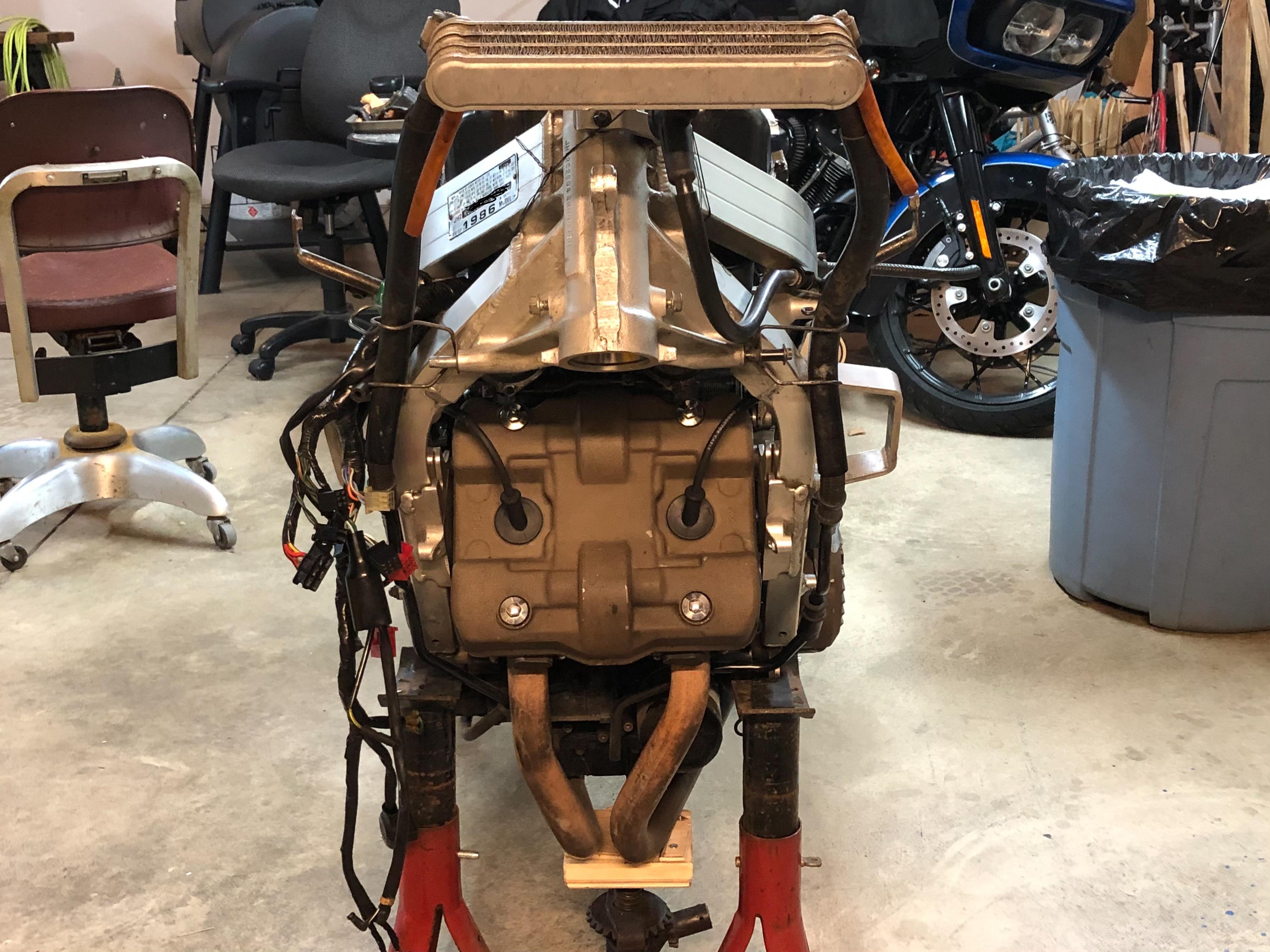

Member Contributer Captain 80s Posted April 9, 2023 Member Contributer Posted April 9, 2023 Don't think I have ever seen welded on radiator protectors like that before. Pretty sure you can see a radiator repair from before these were welded on? Anyway, that's pretty cool. And with a replaceable skid pad? And looks like the crankcase cover has a plate welded up to it too. Did that on both sides of my CBR600F2 race bike. 1
Member Contributer Wald Posted April 9, 2023 Member Contributer Posted April 9, 2023 2 hours ago, Captain 80s said: Don't think I have ever seen welded on radiator protectors like that before. Respect Captain 80s! This is what makes an expert!

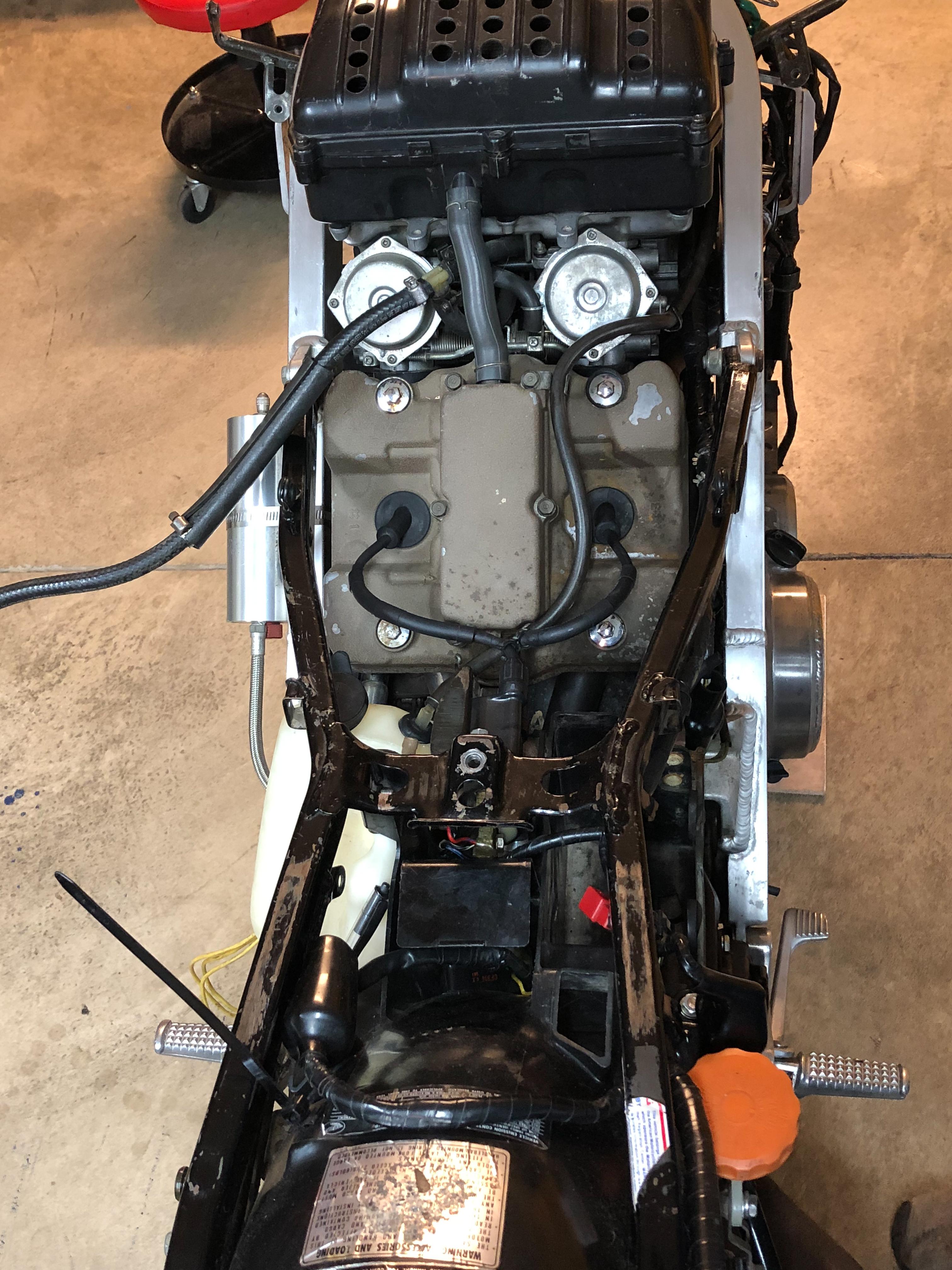

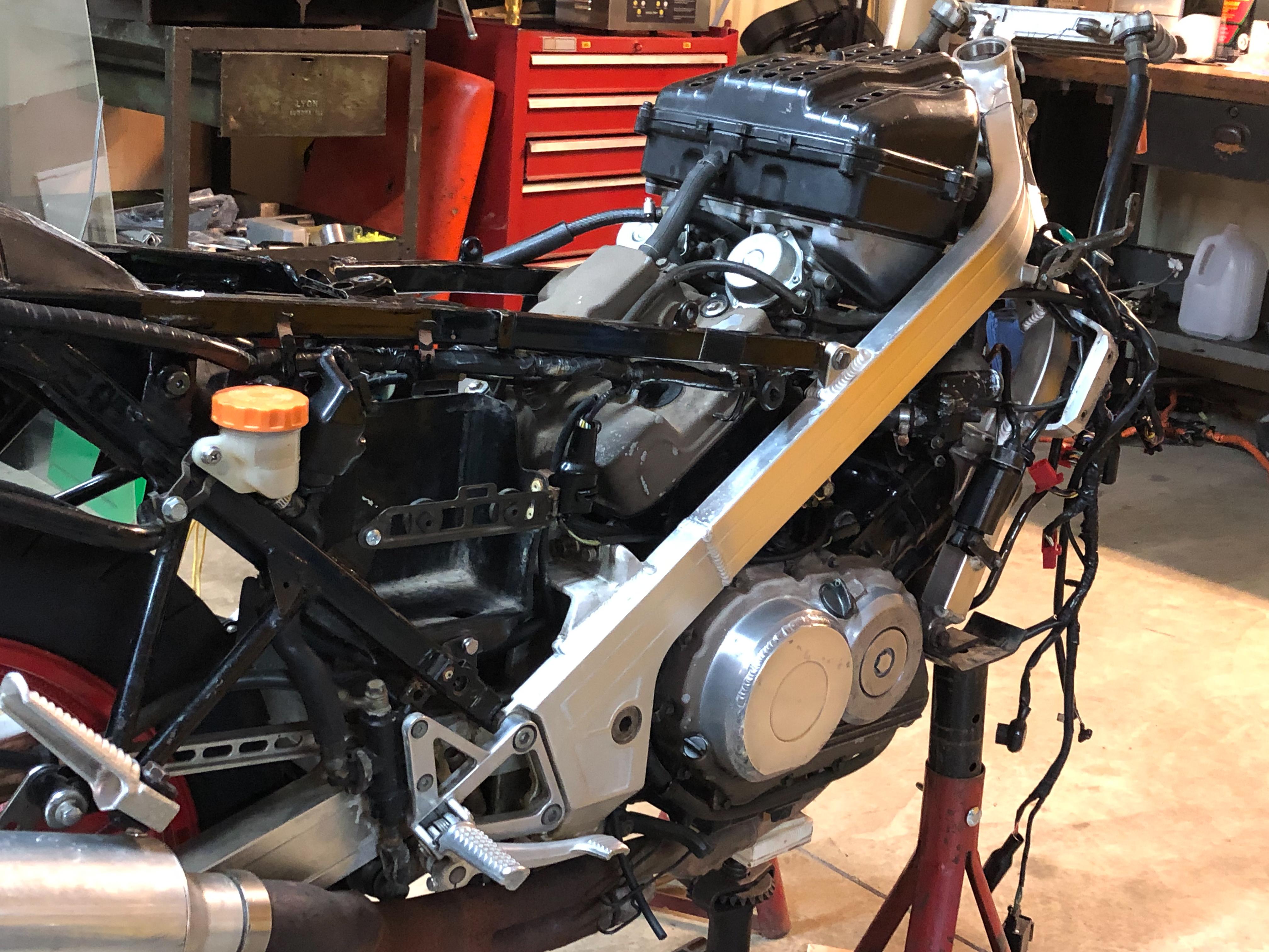

Member Contributer tsmitty Posted April 9, 2023 Author Member Contributer Posted April 9, 2023 Yes, I put the protectors on back in the early track days. The side cover came some years later after a full plastic restoration (when you could buy the plastic), I T-boned a deer at about 70mph. I made the cover cap from billet and have a friend Tig it on. When my son first bought the bike in 2018 or so, he hurried and got the thing running and took it out all day joy riding ( i strongly advised not!) well he let it sit for 2 years. When it finely got to my garage and I started checking my old girl out here's what i found so far; 1) Stator/Rec. toast! plug melted and terminals shorted together, it boiled the flippin battery dry, spots of battery acid all over... I told the boy it wasn't ready to ride! lol 2) Clutch slipping (not surprised, probably the one I put in back in the 90's 3) Whats left of the Kerker White Tip collector was looking like Swiss cheese in the 90's before I sold it. Afraid to take it off. 4) Radiator shows signs of someone putting a stop leak in 5) I put new plug wires on it this week 6) Rear brake disc worn below limits!!! Who the heck wears the rear brake out?!?! I don't think I ever wore a set of rear pads out! So whoever had the bike after I got rid of it let it go mechanically. The plastic isn't that bad other than the tail sections busted up pretty good, I'll get to that after I go through the electrical, front/ rear suspension (Progresive/ Fox). When my son and I first got the bike running the engine sounded very nice, a little rich. 2
Member Contributer tsmitty Posted April 9, 2023 Author Member Contributer Posted April 9, 2023 5 minutes ago, VFR750F3 said: I have spare parts if you need anything. Thanks! I'm trying to prioritize as best i can. I'm saving for a "Ricks" stator and a "Roadster" FH020 rectifier. I just put a eBay main harness in it, not after analyzing every connection. So, while I'm waiting for the funds for the charging system I'll go through the suspension and mechanicals.
