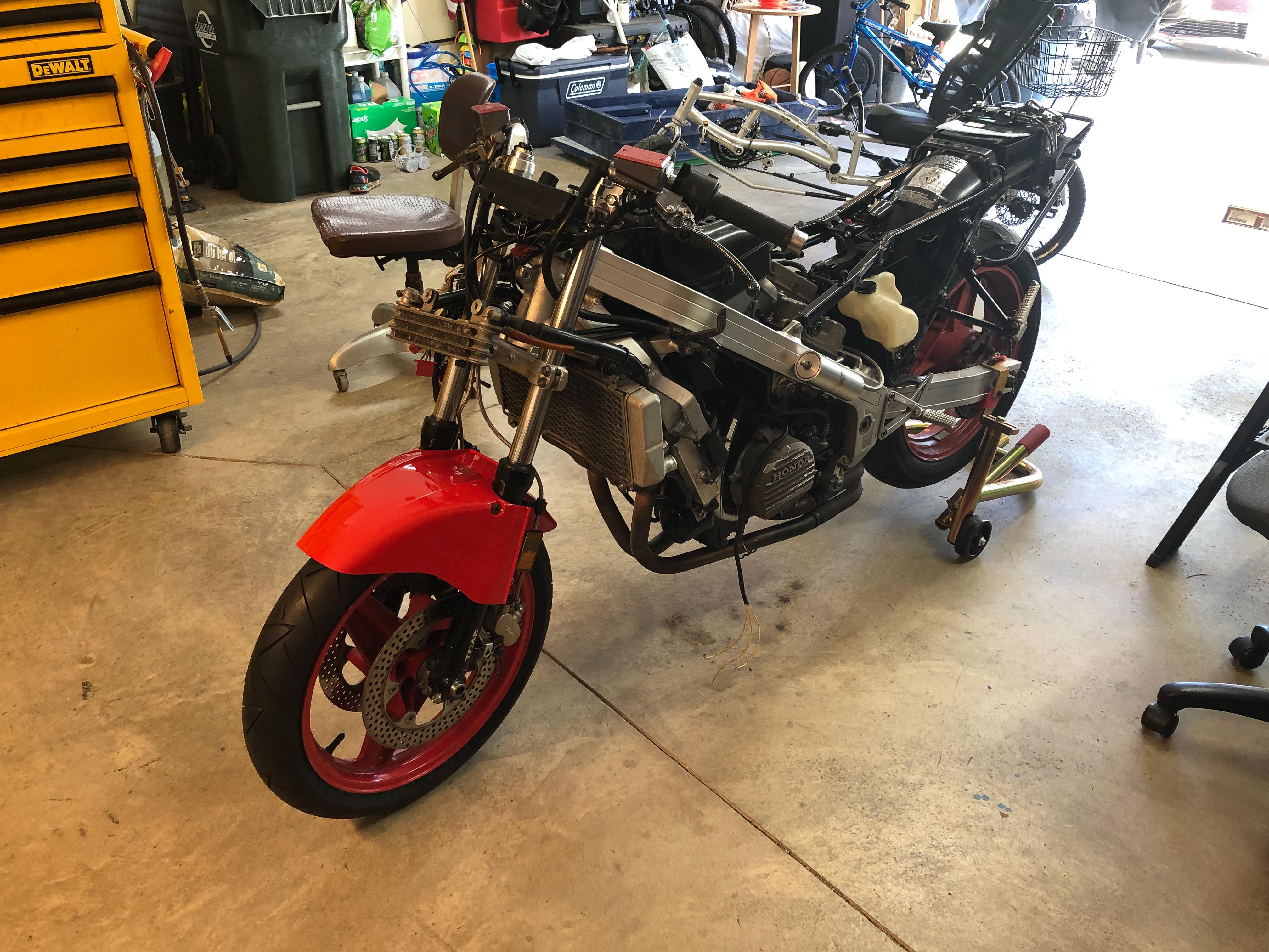

Member Contributer tsmitty Posted May 26, 2023 Author Member Contributer Posted May 26, 2023 The front end is coming along nicely, the forks are straightened, re-bushed and sealed the brakes are rebuilt, slaves and master cylinder. The clutch master is done, just waiting for the slave cup, spring and seal and then I'll be heading South to the rear end. The rear will be getting fresh brakes and rotor (thanks to Captain80 for the insight on a VF500 to VFR700 rotor cross fit), wheel bearings, chain and sprockets and the shock linkage will be looked at and the grease refreshed. On a side note, I put a wire harness on the bike unknowingly from a 86 FII, the does not fit exactly to my F model without cutting and rewiring. I don't want to cut this harness up, only as a last resort as I think this will be opening up a can of worms. The stock radiator, as beat-up and wrinkled as it is was tested, repaired by ICW Radiators and will be gladly put back into service. I do have a new aftermarket radiator that I fitted and had tested and boxed up for a back-up or traded should someone need. So the final takeaway with the front end? Captain80 said it best...."brake fluid sucks" or something like that... 1 Quote

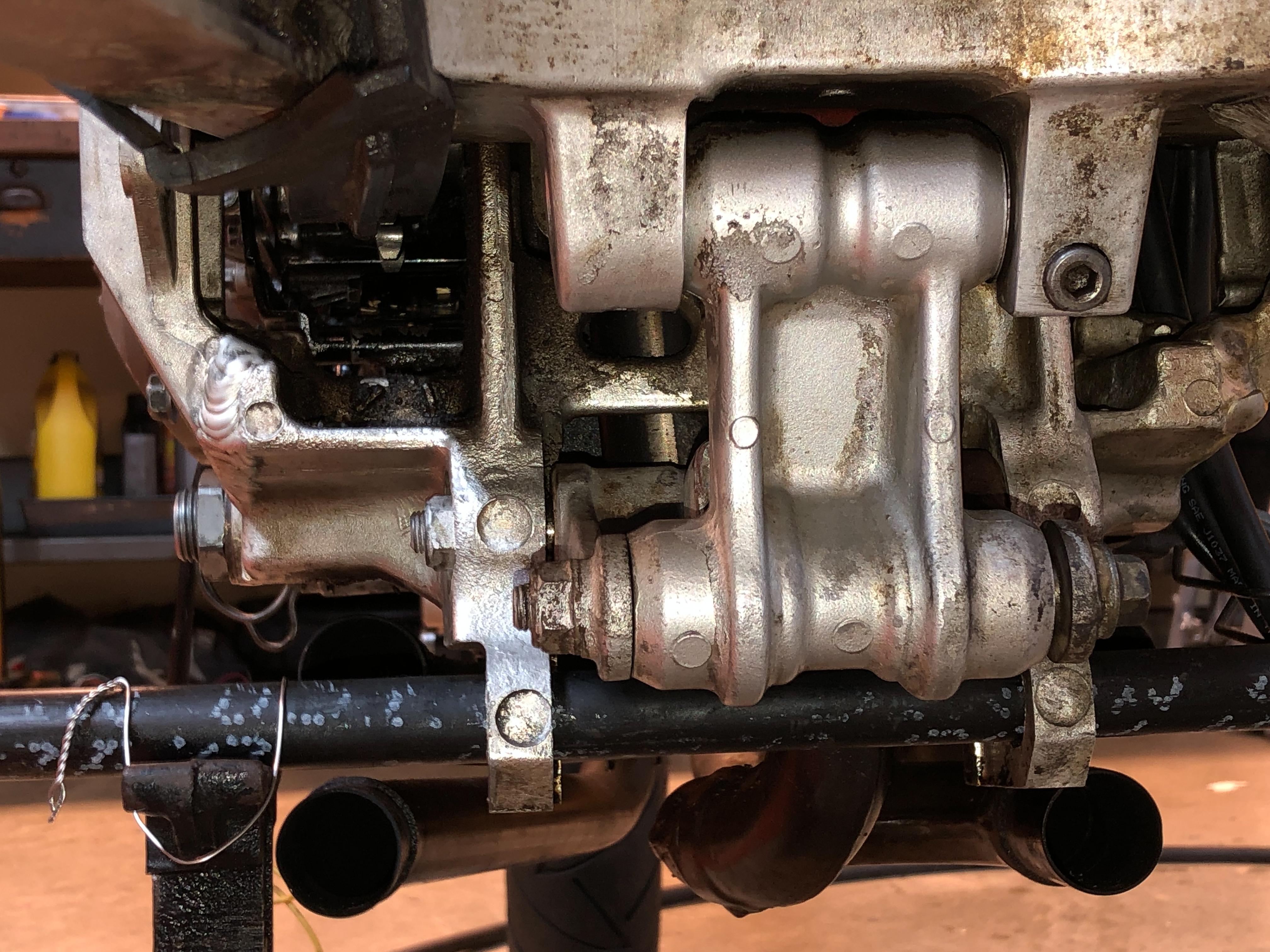

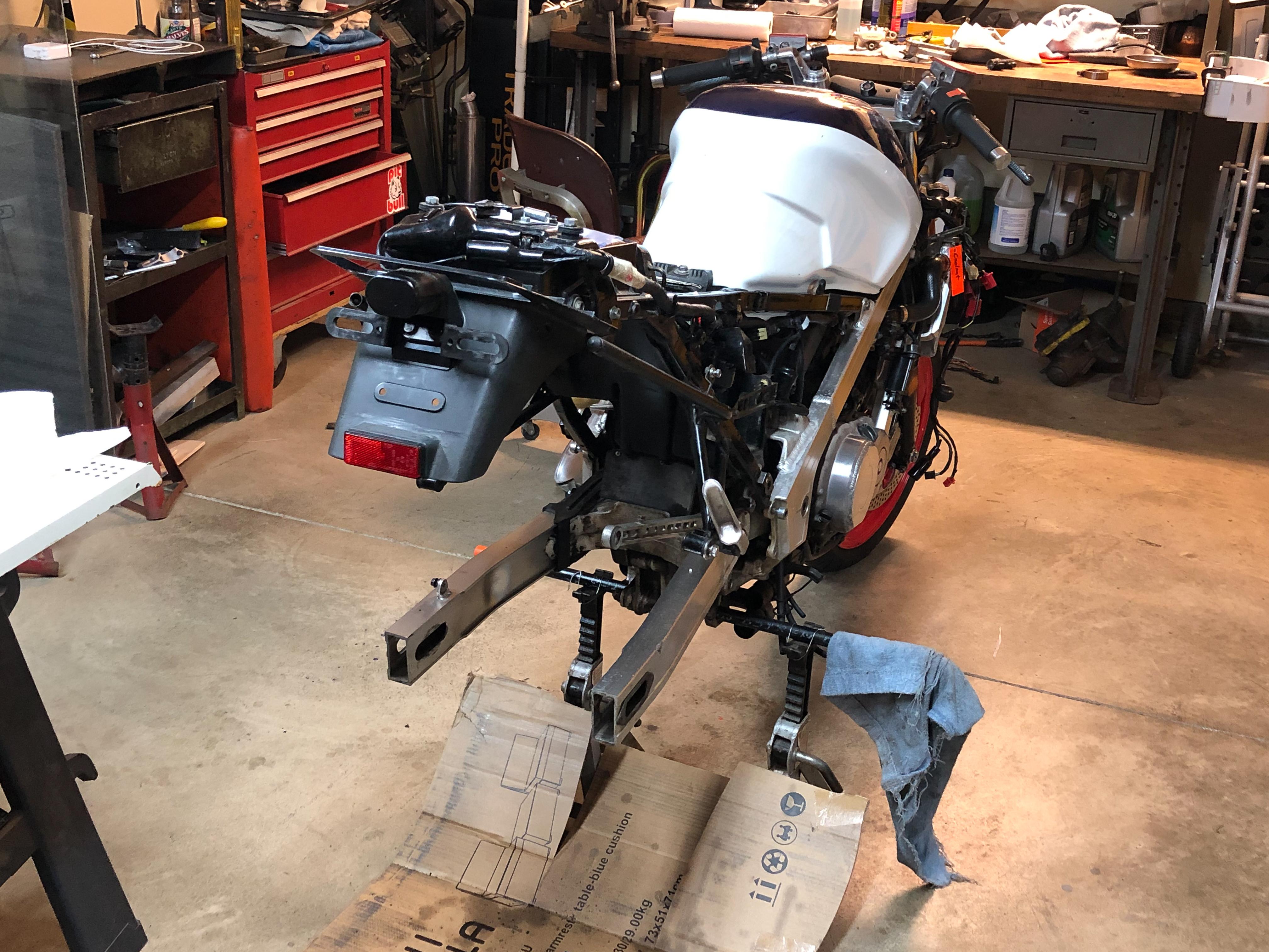

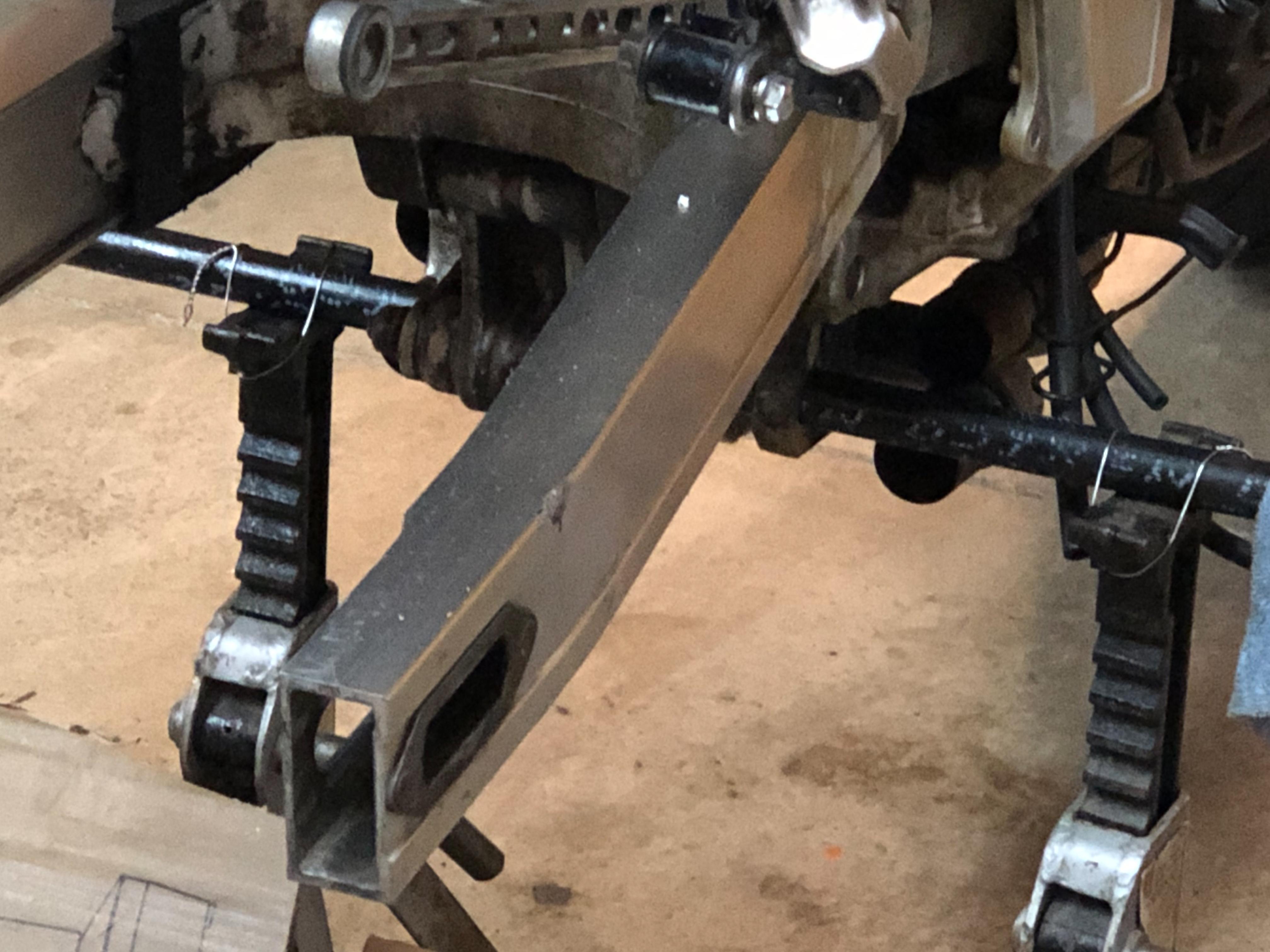

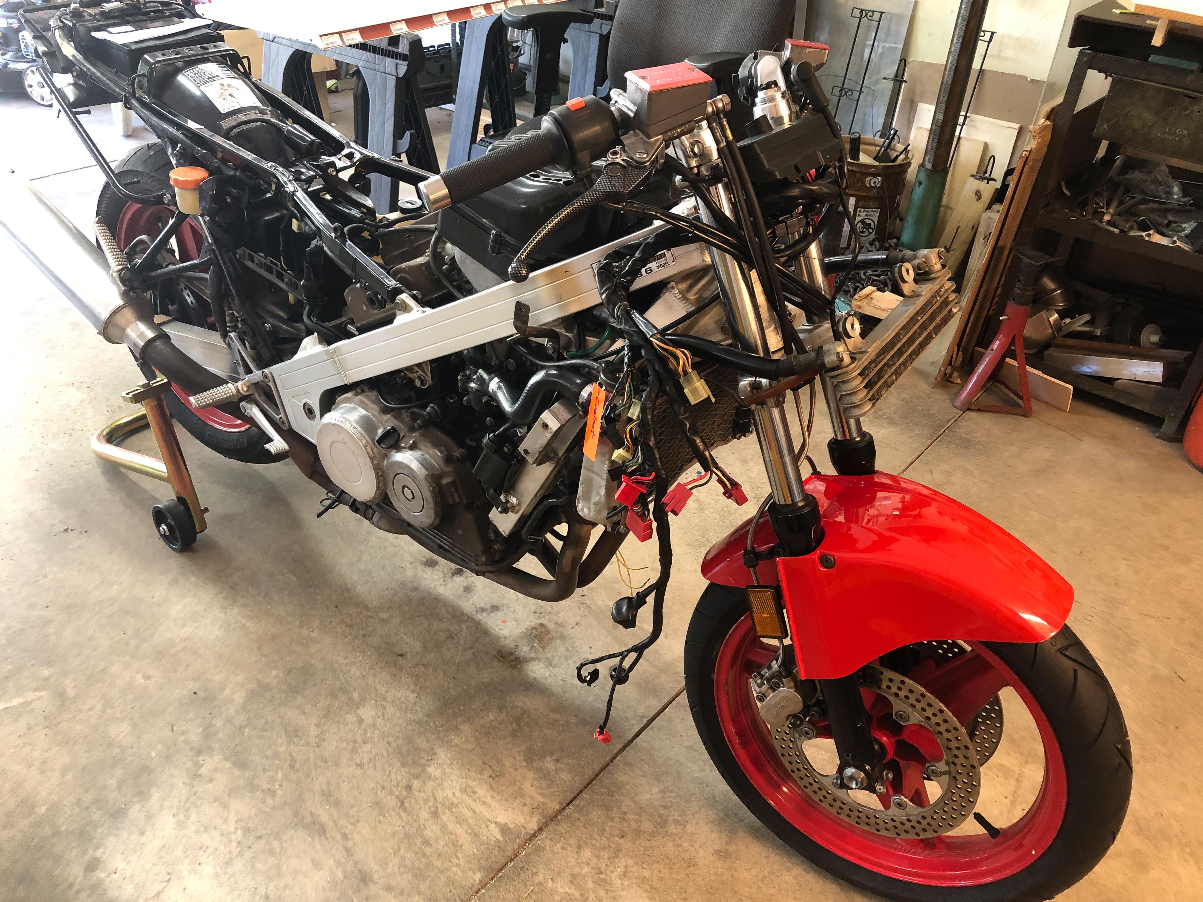

Member Contributer tsmitty Posted June 18, 2023 Author Member Contributer Posted June 18, 2023 Thought I would give an update on my bike. The front end electrical, mechanical, hydraulics and are done. Moving on to the back took a little doing, getting the bike confidently in the air was a bit of a challenge and took some reluctant drilling on the frame. Knowing the frame wound never be considered “collectable” I drilled the stock center stand mount locations to 7/8” to accept a piece of 1/2” “black pipe”. then to the jack stands she goes....floor wrenching sucks! The exhaust collector actually looked better than I thought, Its a Kerker White Tip I put on the bike in 86; it was pre ordered before I picked up the bike. Anyways the finish on the collector is long gone and hardly smooth and I don't know how to or if I should put a top coat on it before going back on the bike. So I removed the rear wheel and found the sprocket carrier dampers installed wrong, leaving full metal to metal contact with the sprocket carrier lugs and the wheel hub drive webs! I am so glad I’m going through this bike piece by piece… The rear brake caliper and master cylinder are all rebuilt, wheel bearings new, sprockets new as well as a new chain when the time comes. So today I'll pre-clean the swing arm linkage before I start pulling those pins. The swing arm has battery acid staining on it and I’m not quite sure how to disguise it. If you made it this far in this story...Thanks! 1 Quote

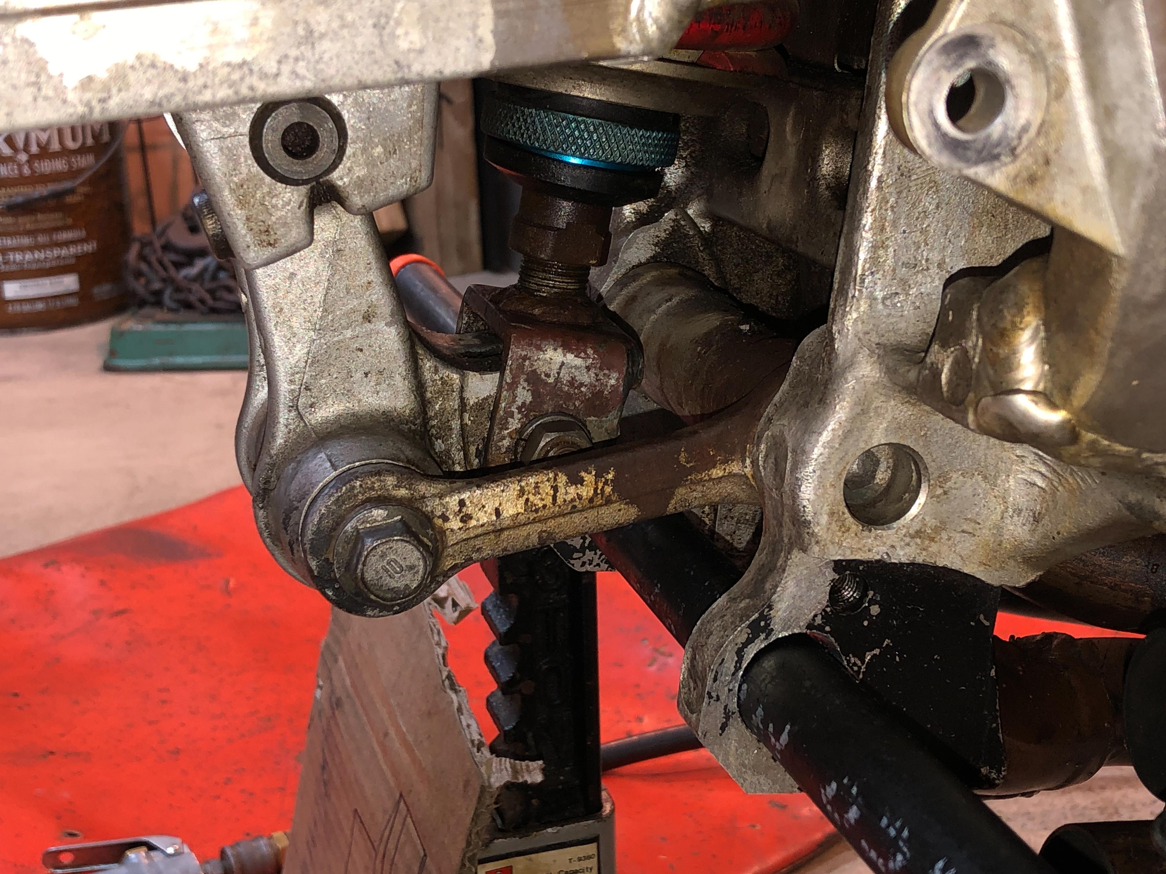

Member Contributer tsmitty Posted June 18, 2023 Author Member Contributer Posted June 18, 2023 Cleaned up the linkage as best I could. I feel comfortable pulling the linkage pins with minimal damage to the seals. So tomorrow I'll take a reference measurement from swing arm to sub-frame and take it out and on the bench. But my neck says I'm done for a day or so. 1 Quote
Member Contributer Captain 80s Posted June 18, 2023 Member Contributer Posted June 18, 2023 You can absolutely slide everything apart, clean (tub of gas and a toothbrush) and regrease the bearings, shafts and seals without damaging the seals. Been doing it for decades. The linkage bearings have a limited travel range and the needle bearings spread the load so much, they rarely "wear out". I have never had to replace bearings or seals after cleaning and inspection. Some shafts might show some wear patterns, but it is not anything that is usually detectable by measuring or tactile "inspection". Quote
Member Contributer tsmitty Posted June 18, 2023 Author Member Contributer Posted June 18, 2023 31 minutes ago, Captain 80s said: The linkage bearings have a limited travel range and the needle bearings spread the load so much, they rarely "wear out". Thanks Captain, that's very relieving to know! What are your thoughts on the shock? I don't know the model number, red coil spring. I have no reason to think anythings wrong but I don't know if it still has any, I guess nitrogen, and sure don't know the pressure it needs. I ain't looked yet, is shock length in the manual...? lol Quote

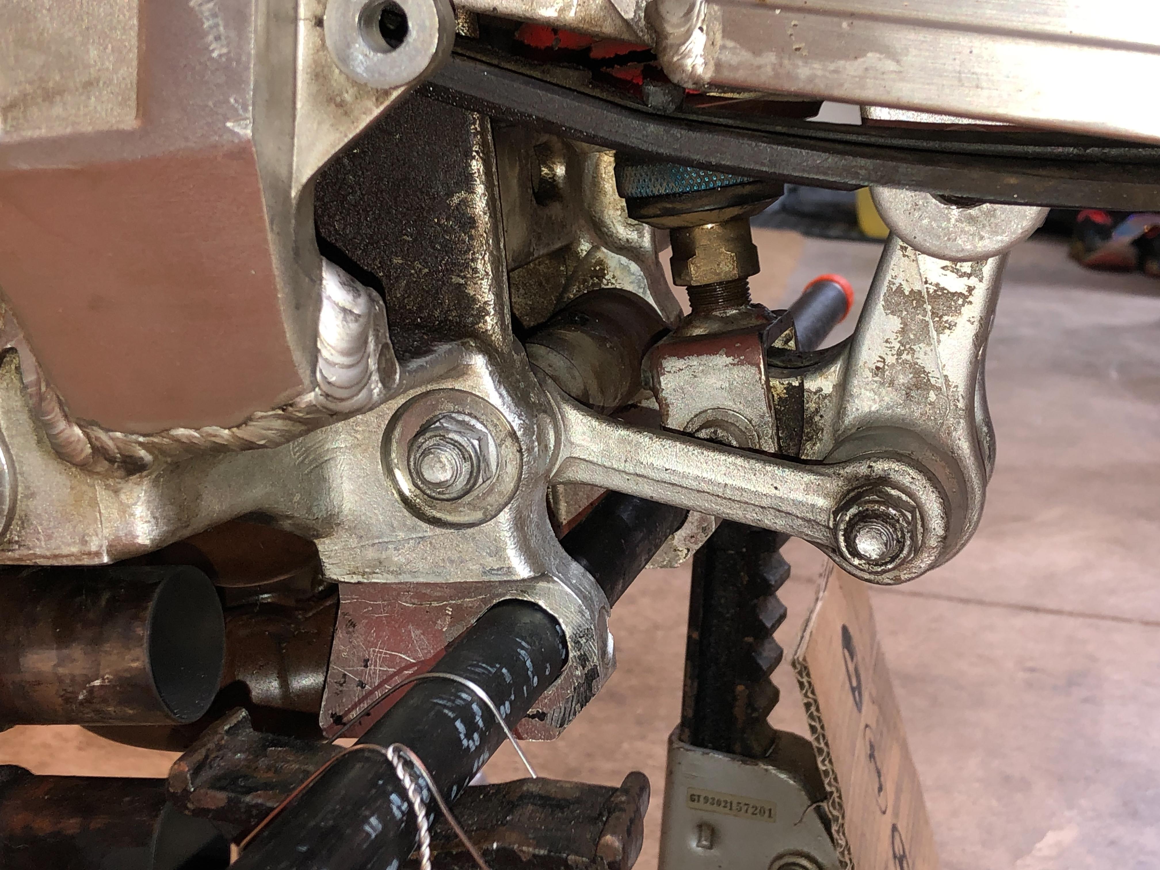

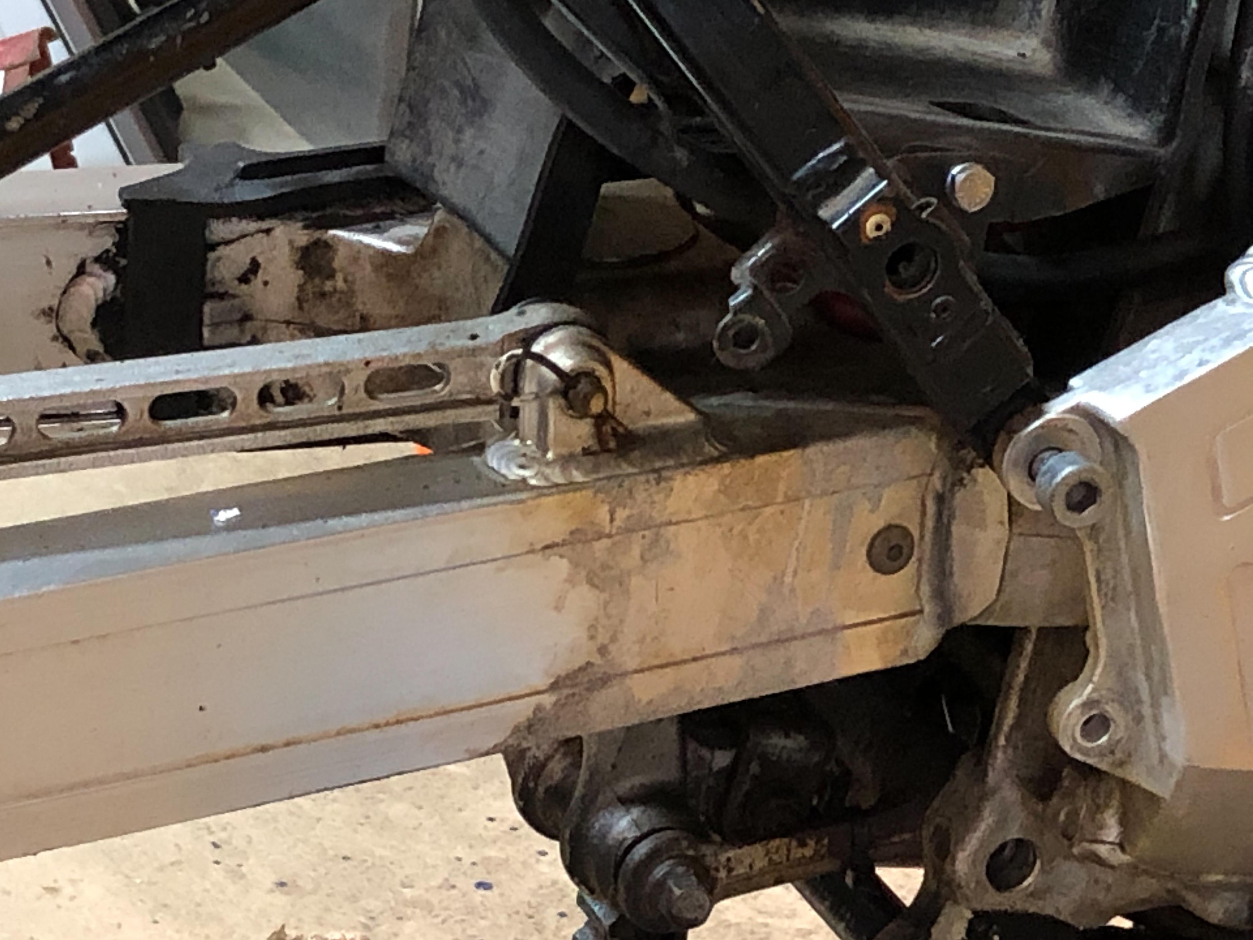

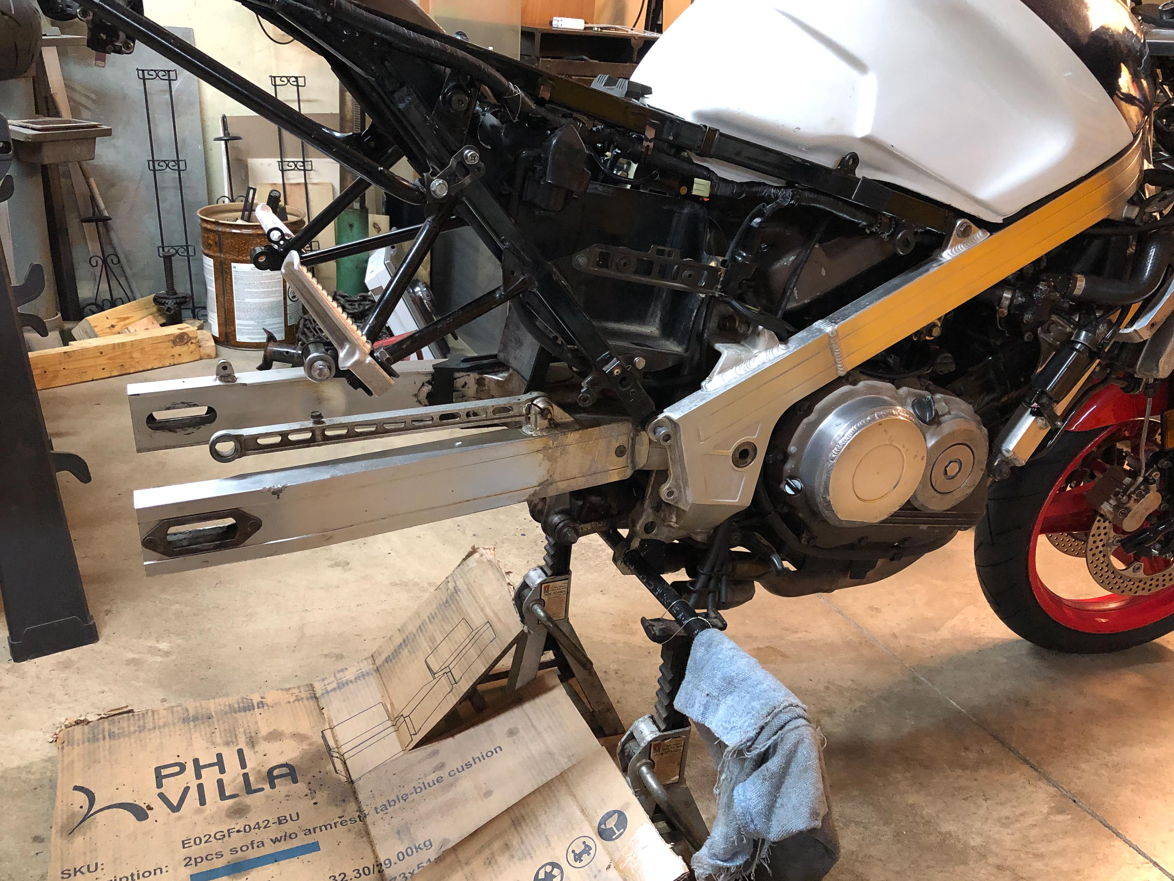

Member Contributer tsmitty Posted June 20, 2023 Author Member Contributer Posted June 20, 2023 Well the linkage is out and the swing arm off! No major issues just grime! Tons of grime! I have to say; whoever fitted the shock clevis to the linkage knuckle is a fu#%ing idiot! They should have used shims on both sides of the clevis pivot bolt instead of just tightening the bolt to death!! Not quite a smooth pivot action. The bad news is....it was me, probably 29 year old at the time...self proclaimed genius ! lmao I'll fix it... At least I'm off the floor doing bench work and the chassis is very close to complete. 1 2 Quote
Member Contributer Captain 80s Posted June 20, 2023 Member Contributer Posted June 20, 2023 1 hour ago, tsmitty said: Well the linkage is out and the swing arm off! No major issues just grime! Tons of grime! I have to say; whoever fitted the shock clevis to the linkage knuckle is a fu#%ing idiot! They should have used shims on both sides of the clevis pivot bolt instead of just tightening the bolt to death!! Not quite a smooth pivot action. The bad news is....it was me, probably 29 year old at the time...self proclaimed genius ! lmao I'll fix it... At least I'm off the floor doing bench work and the chassis is very close to complete. The only thing it sounds like 29 year old you did wrong was not use a torque wrench. Hell, a couple of the bolts I don't bother on either because the access is so bad. The lower clevis mount used to bug me too, it didn't make sense. Why would every other bolt have a bearing and shaft and allow for movement? I have the correct parts, nothing is missing and there is a torque value in the Service Manual. It was designed by Honda that way and I just stopped worrying about it. With it all assembled, the movement is smooth and not binding. I realized that it doesn't need to pivot. The way the linkage is designed, everything else is responsible for pivoting. What little fore/aft movement the shock does need is handled by the upper shock mount. Quote
Member Contributer tsmitty Posted June 20, 2023 Author Member Contributer Posted June 20, 2023 3 hours ago, Captain 80s said: With it all assembled, the movement is smooth and not binding. right. Not worried, The pin or sleeve tapped out of the knuckle bushings easy enough and had some flailing on the ends but all that got addressed. I don't have the shock off yet but the fitment should be a little better this time around. lol torque wrench on standby... Quote
Member Contributer tsmitty Posted June 20, 2023 Author Member Contributer Posted June 20, 2023 4 hours ago, Captain 80s said: Why would every other bolt have a bearing and shaft and allow for movement? Yeah its like roller bearings everywhere then all of a sudden bushings and a thin walled tube. The regular engineer was sick that day and Hank took over... I don't know if its a load thing but why such thin walled sleeve!? I do have the means to ream those bushings nice and square with the world and make an actual pin, it won't be hardened but who cares. I'm not feeling it though...lol Quote
