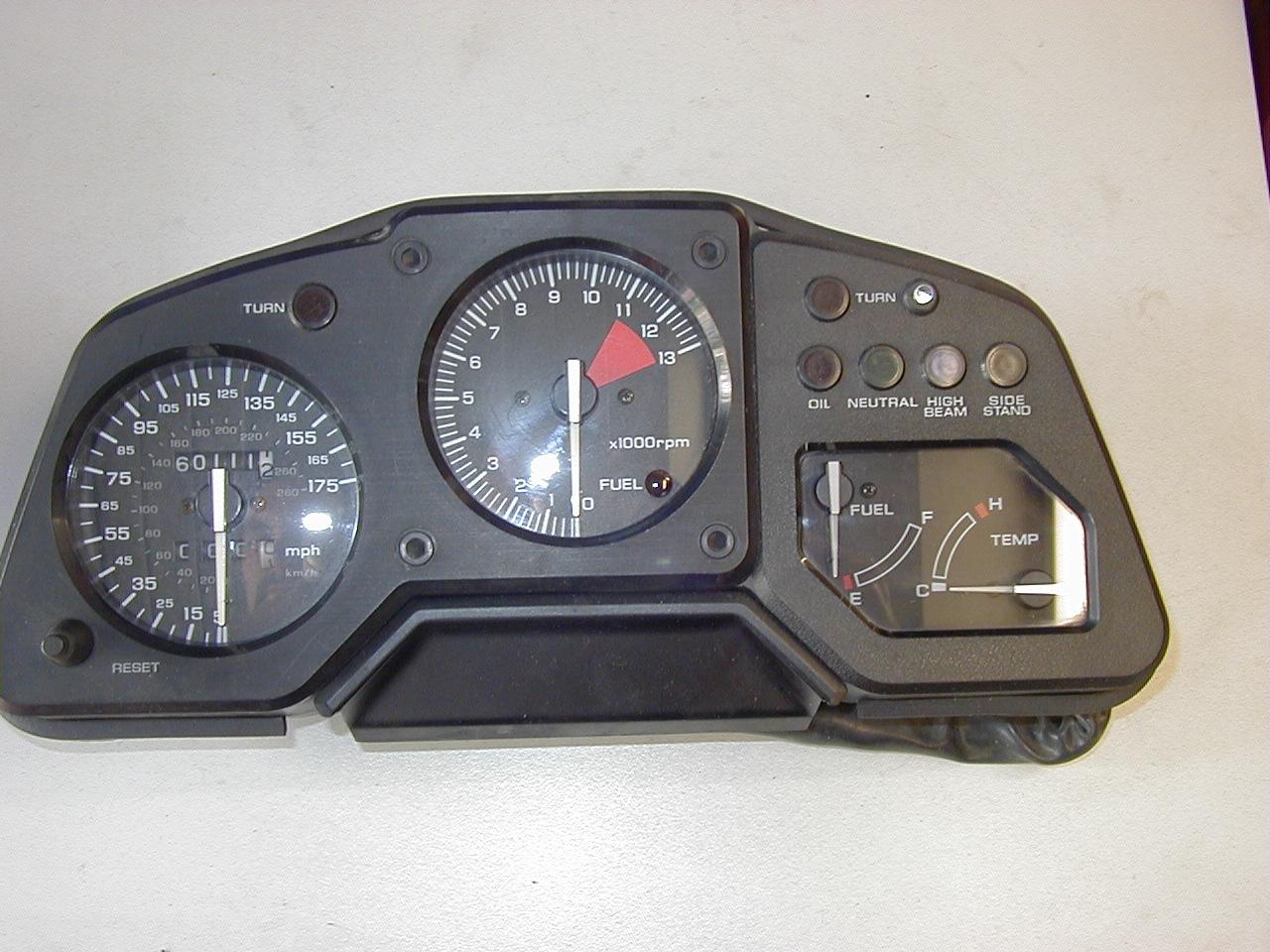

Member Contributer JZH Posted May 13, 2022 Member Contributer Posted May 13, 2022 US import? Strange for someone to remove the remote reserve switch. Do you have a low fuel light in the tachometer? Ciao, JZH Quote
