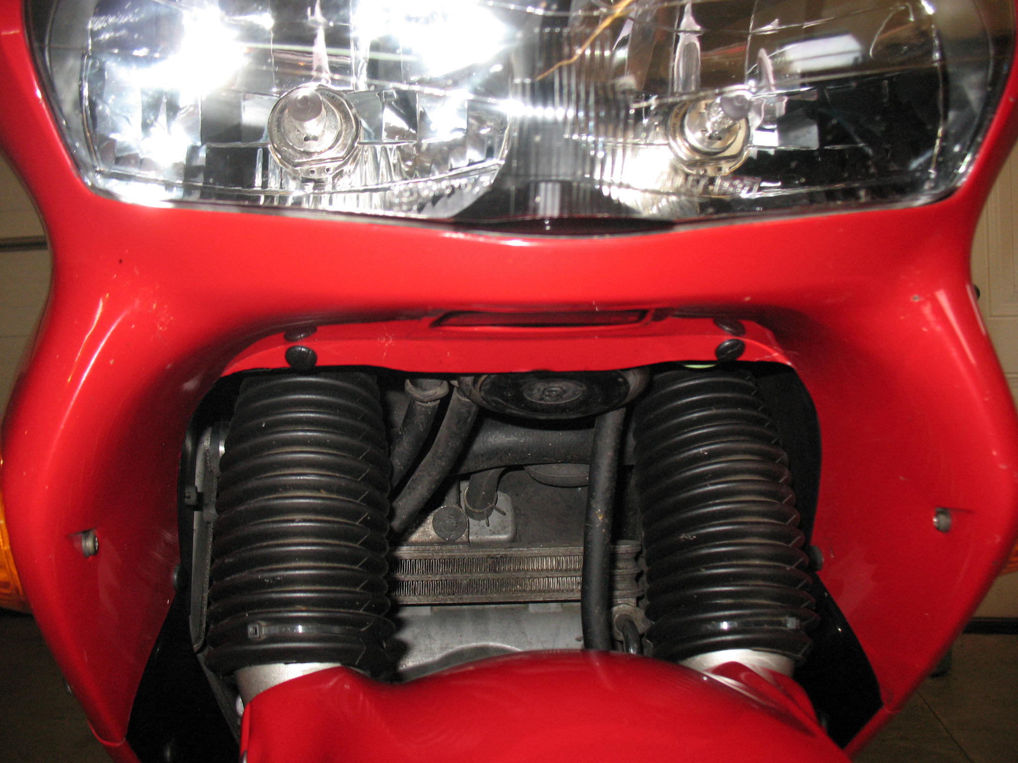

Member Contributer Fritzer Posted May 7, 2021 Author Member Contributer Posted May 7, 2021 That is why I installed fork boot covers when I replaced seals and bushings at 55K miles. They do a great job protecting against seal damage and help prevent dirt getting by the seals and contamination of the fork oil. You can easily see them in the photo, but in real life they disappear in the dark void. 1 Quote
Member Contributer DannoXYZ Posted May 7, 2021 Member Contributer Posted May 7, 2021 That's an awesome idea!!! Quote

Member Contributer Cogswell Posted August 28, 2021 Member Contributer Posted August 28, 2021 On 5/6/2021 at 10:22 PM, Fritzer said: That is why I installed fork boot covers when I replaced seals and bushings at 55K miles. They do a great job protecting against seal damage and help prevent dirt getting by the seals and contamination of the fork oil. You can easily see them in the photo, but in real life they disappear in the dark void. May I ask where those were sourced? Quote
Member Contributer Fritzer Posted August 29, 2021 Author Member Contributer Posted August 29, 2021 22 hours ago, Cogswell said: On 5/6/2021 at 10:22 PM, Fritzer said: That is why I installed fork boot covers when I replaced seals and bushings at 55K miles. They do a great job protecting against seal damage and help prevent dirt getting by the seals and contamination of the fork oil. You can easily see them in the photo, but in real life they disappear in the dark void. Expand May I ask where those were sourced? I purchased these polisport fork dust covers on amazon while in the process of rebuilding my front forks. They are way too long but that was no problem. The small end fit perfect over the inner slide tube and cut end for a perfect fit over the top part of the fork outer case. You can leave the rock chip protector on and install the dust bellow cover over the top of it. Zip tie both ends and you are good to go. You can find these same items here - https://www.amazon.com/gp/product/B077L6ZCJK/ref=ppx_yo_dt_b_asin_image_o02_s00?ie=UTF8&psc=1 I have to mention that they do raise the normal operating temp at cruising from 172F to 176F due to the larger diameter. However, I have never had a overheat issue with them on. Overall, I think they are a well deserved mod if you have forks off for maintenance. Eliminates rock chips and dust and water penetration thru the seals. This keeps the fork oil much cleaner over the years and dramatically increases the life of your fork seals and bushings. 1 Quote
