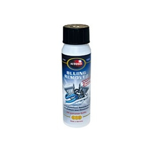

Member Contributer Thumbs Posted March 2, 2021 Member Contributer Posted March 2, 2021 The stuff to effortlessly remove corrosion and discolouration on stainless steel is Autosol Blue Remover Its phosphoric acid in a gel, wipe it on, wipe it off ....just don’t get it on your skin Takes all the effort out and only works on the corrosion 3 Quote
Magneto Posted March 2, 2021 Posted March 2, 2021 I think it is not a secret that toilet cleaner does the same for no money. Two issues: after acid wash steel needs to be passivated, most neglect that step and second cleaning doesn’t last. Honda uses steel that tarnish easily. Quote
