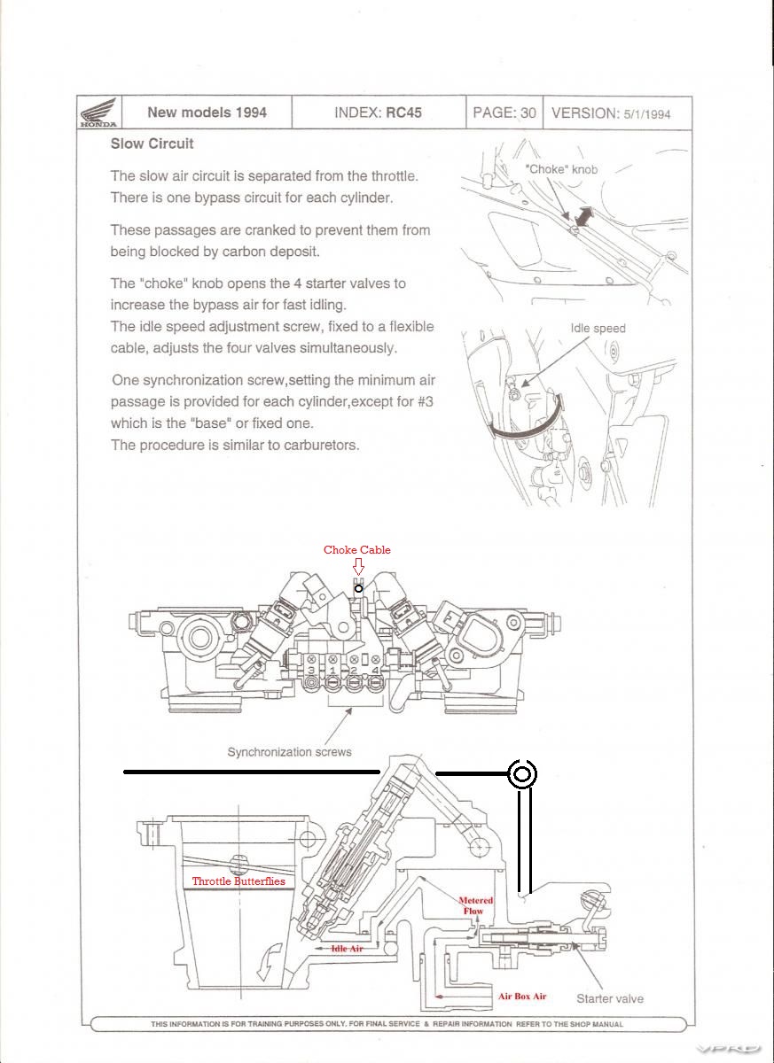

Member Contributer Grum Posted November 13, 2020 Member Contributer Posted November 13, 2020 Starter valve synch. Note this link for getting correct valve offset. Has a huge effect on idle and small throttle opening. 2 1 Quote
RedMist Posted November 13, 2020 Author Posted November 13, 2020 1 hour ago, Grum said: Starter valve synch would be first to check before engine valves. Note this link for getting correct valve offset. Has a huge effect on idle and small throttle opening. I was looking at some feedback from various sources, and I stumbled across this device: https://thedigisync.com/ While it seems to be a bit expensive for a one-time adjustment, it may be handy to have for future needs. What do you think? I know on the VFR, there is one valve that is set in place as a reference.... I think the second from left is the reference valve (the one that doesn't have a screw). I know that something like this would have been handy to have on my old V45 Sabre! That thing NEVER wanted to start and I was always terrified of digging in and synching FOUR CARBURETORS! BTW, thanks Grum for being one of the more helpful members on this great forum 🙂 Quote

JimMoore Posted November 14, 2020 Posted November 14, 2020 13 hours ago, RedMist said: It actually seems to do fine when "choked" (idle adjusted since the '99 doesn't have an actual "choke" like the 4th gens). A little warbly initially but maintains idle fine upon adjustment. However, regarding valves, would you recommend adjusting the starter valves first before going for the engine valvetrain? I'm not sure about that, but I do know that hard starting is an indication of tight valves. I'll also second the other poster. Mine starts at first touch of the start button. 1 Quote
