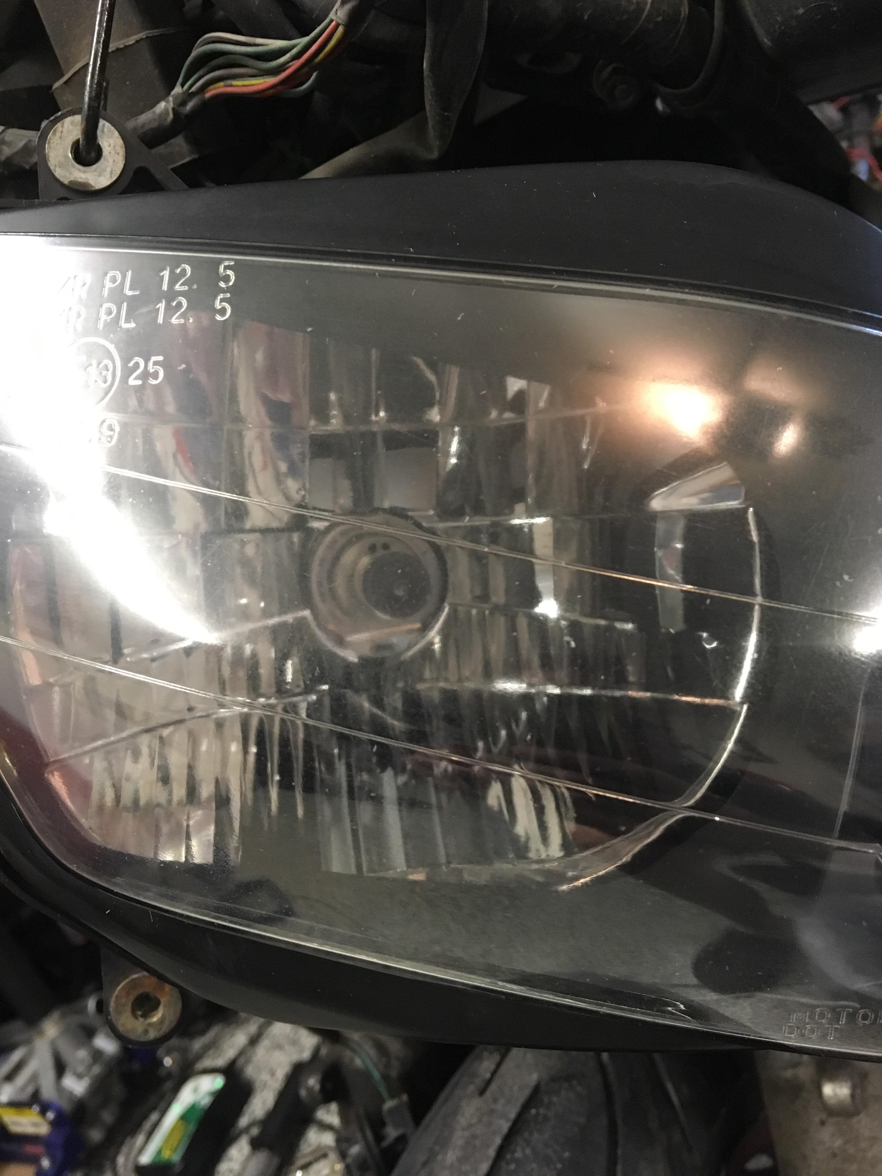

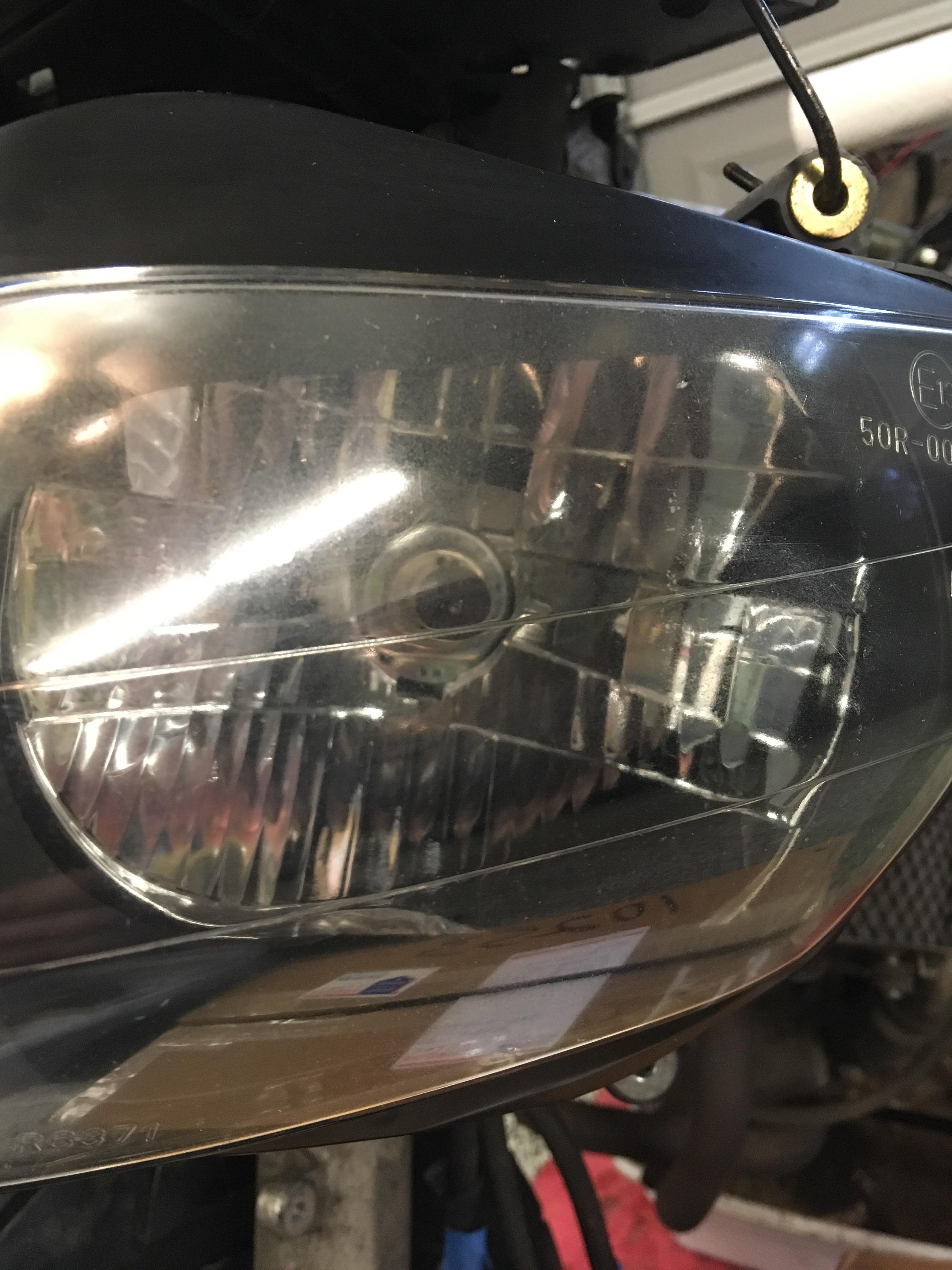

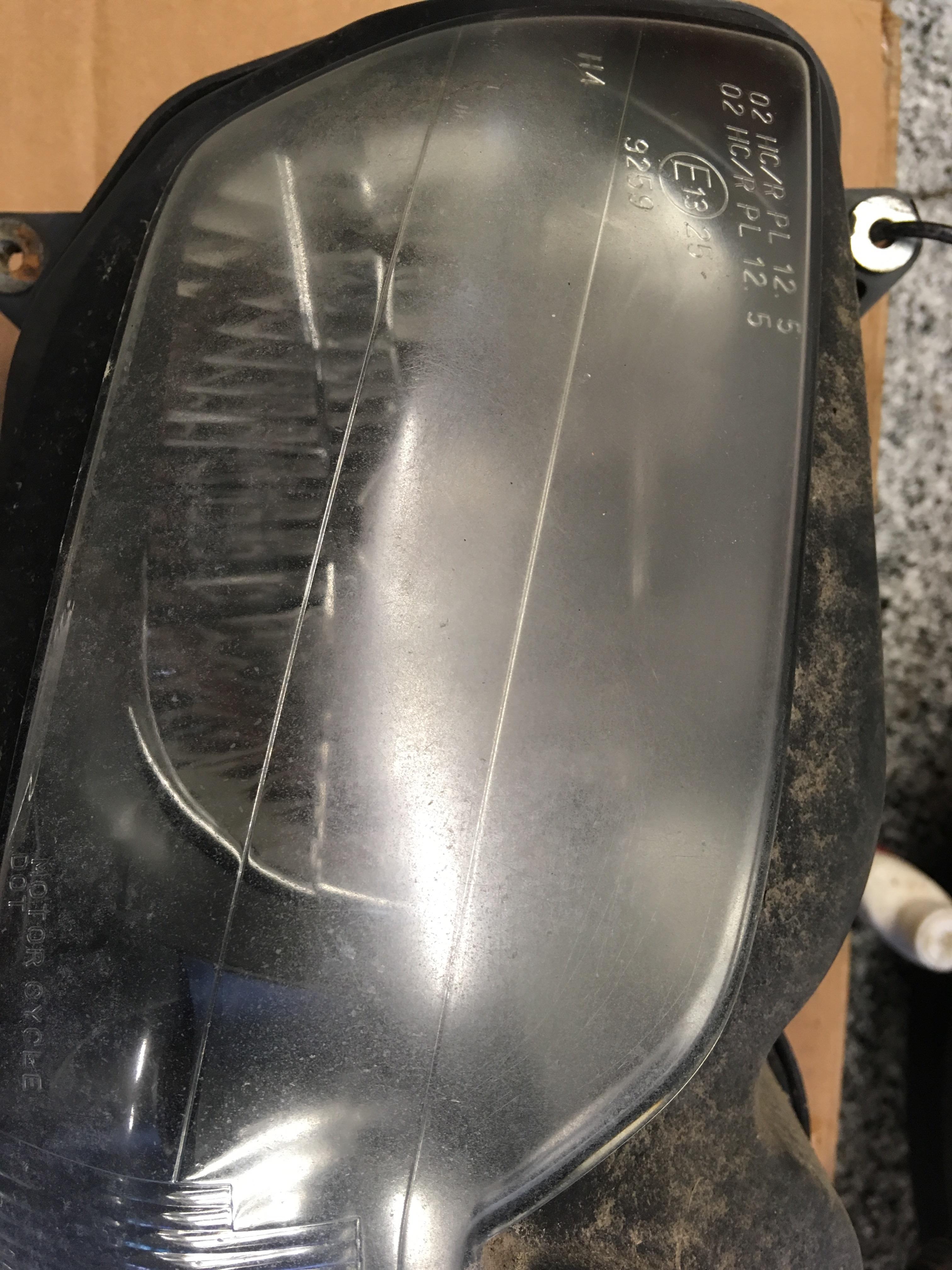

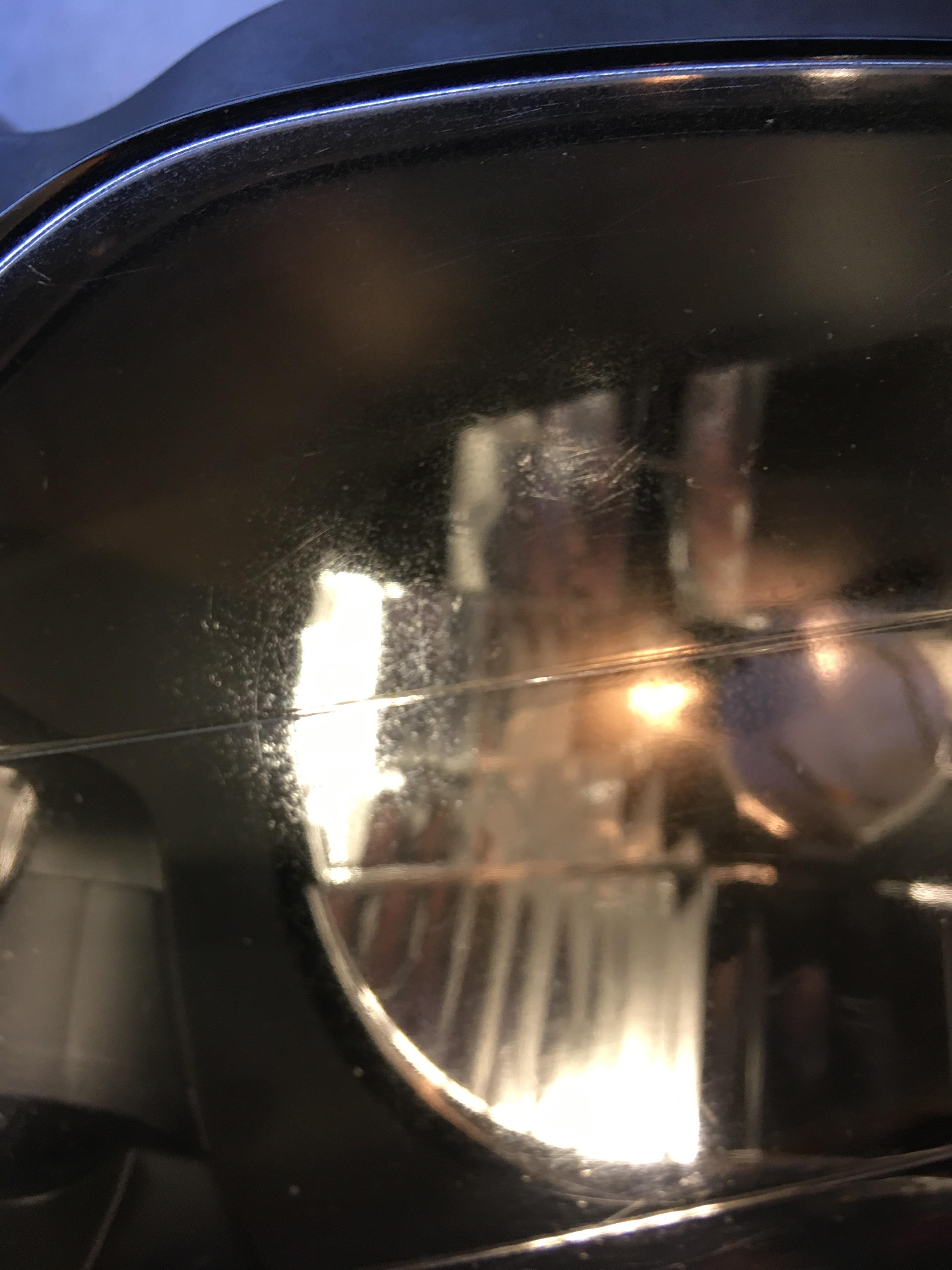

Member Contributer KevCarver Posted February 3, 2020 Author Member Contributer Posted February 3, 2020 Thanks for the detail adkfinn! Here’s what we’ve got: Top left corner is where I tried the polish Quote

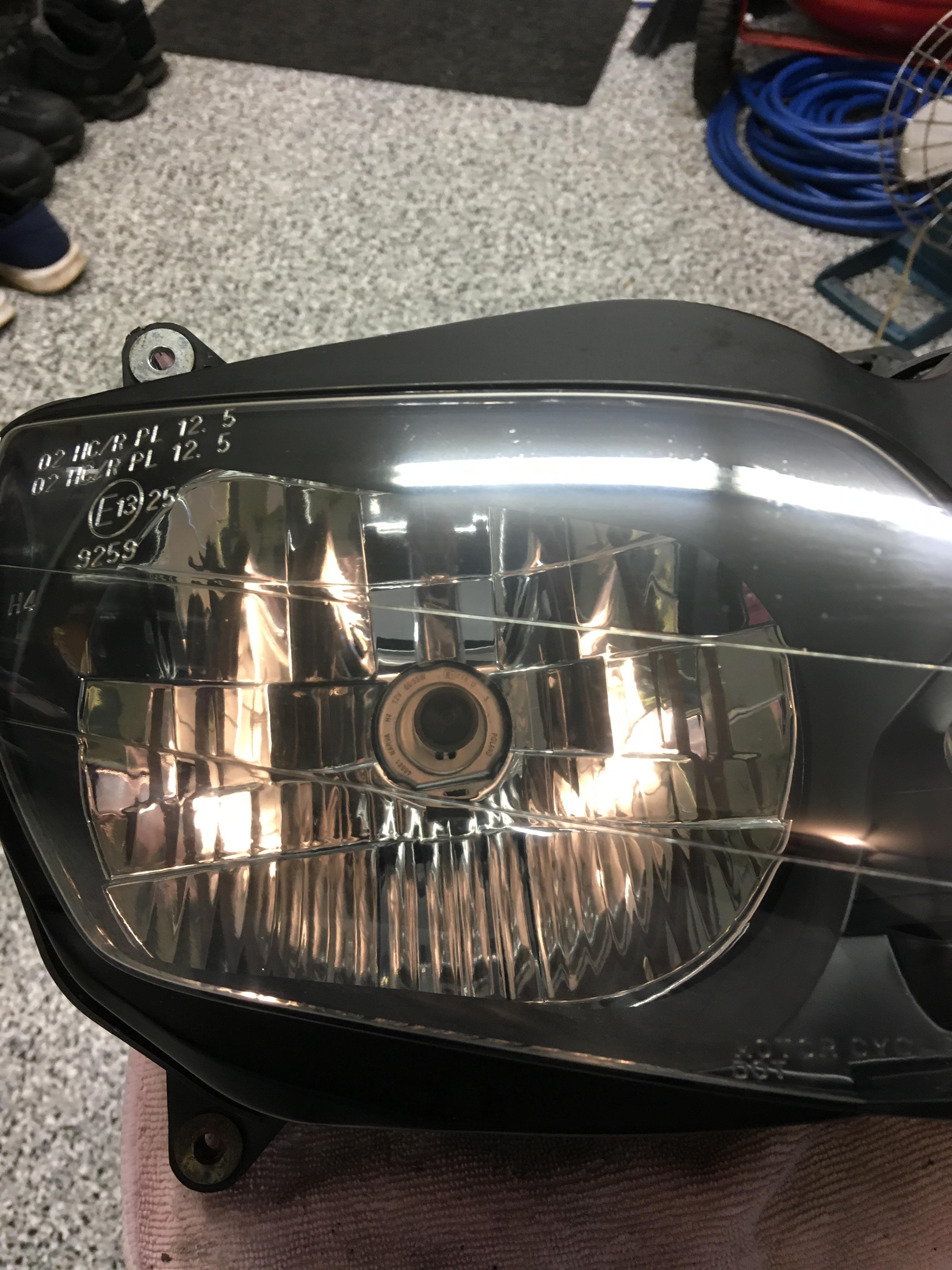

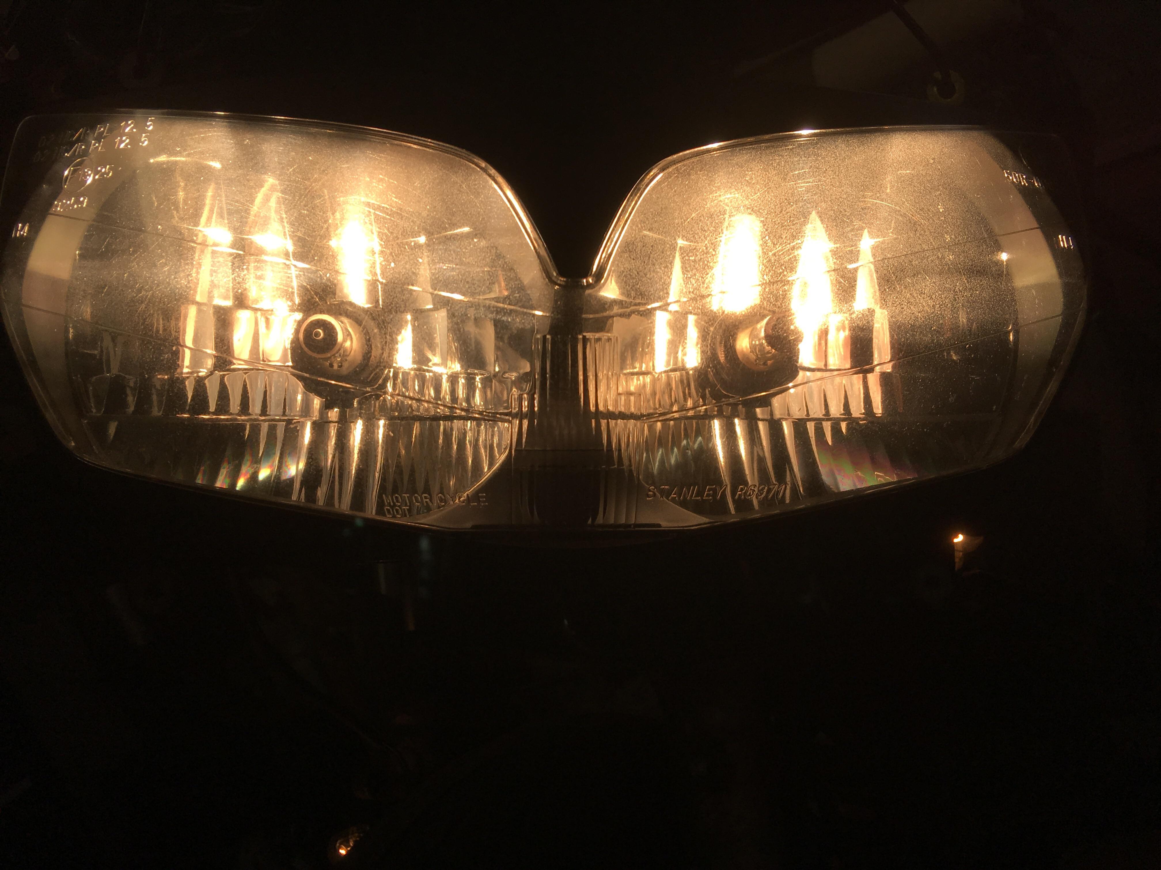

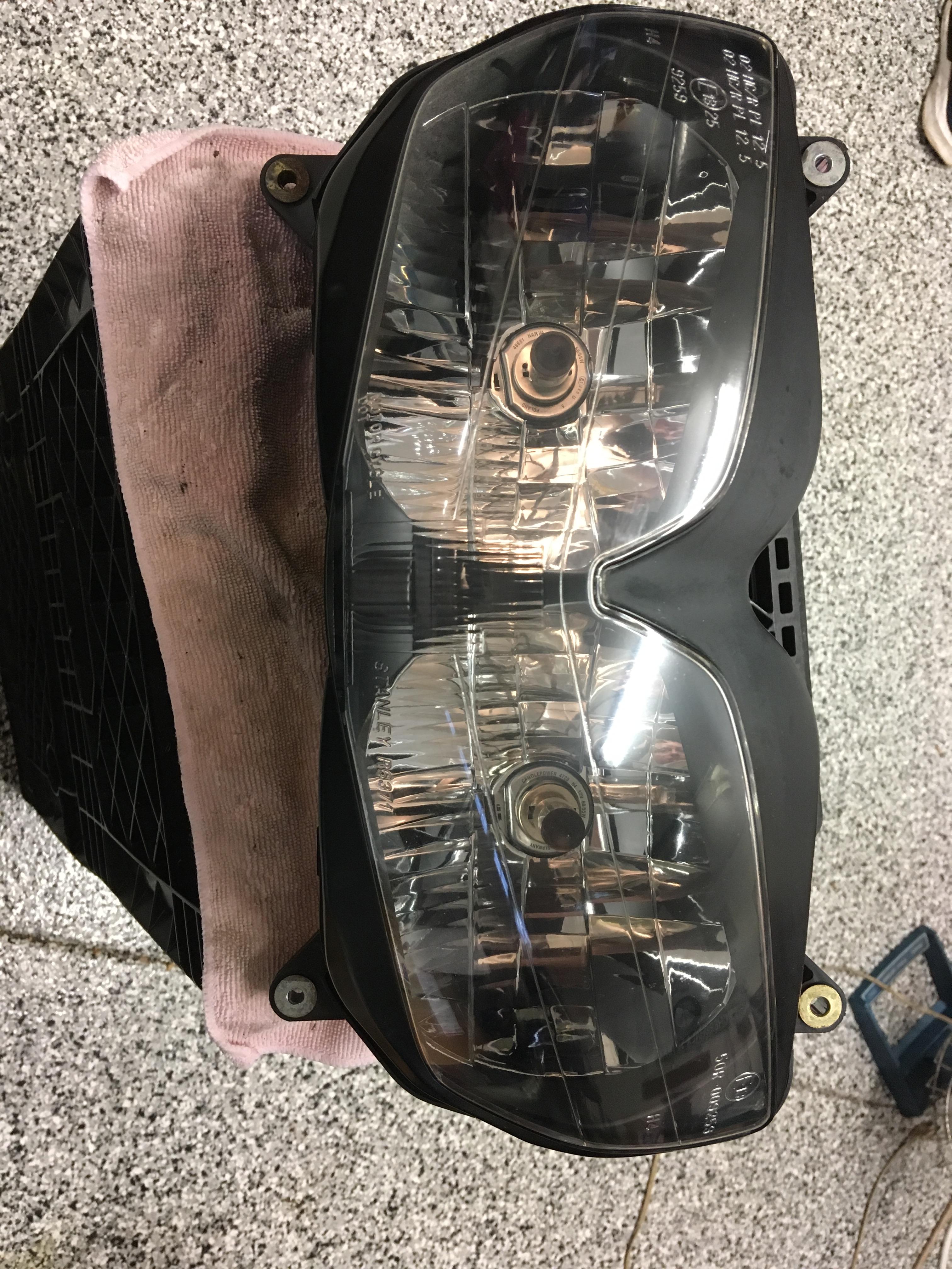

Member Contributer KevCarver Posted February 3, 2020 Author Member Contributer Posted February 3, 2020 Getting there! Did the starboard side with polish only, and started on the port with 1500 wet. I got scared seeing it turn all swirled, so I switched to polish. Not sure if I should have sanded through that, then polish. You can see (I think) in the second pic some of the slightly still hazy areas. Quote
Member Contributer Grum Posted February 3, 2020 Member Contributer Posted February 3, 2020 Keep at it Buzzner ya getting there, just need plenty of elbow grease! I remember years ago polishing plastic watch faces. Used the 1500 wet and dry which gives you the scary frosted effect to get the main scratches out, then I would do a lot of polishing off with an old product called Brasso (metal polish). Eventually came up like glass. 1 Quote

Member Contributer adkfinn Posted February 4, 2020 Member Contributer Posted February 4, 2020 I'll second what Grum said - You have to choose a grit that will get the deepest scratches/damage out that the lens has already incurred, then work your way back to smooth with subsequent grits then polish. The scratched frosted look is scary when you start and are in the middle of the process, but it will come back nicely as you work your way through. I haven't used Brasso but I have seen it suggested elsewhere also, fwiw. Kevin - Based on your close up progress pic, I think you need to jump back to sanding and get those scratches out, then bring the entire surface back to polished. Also - I wouldn't suggest you sand your light if it doesn't have scratches/need it. You could hit it with cutting compound if you have it, then polish. I would only go as coarse as necessary to remove imperfections, no further. The end result should be the same, it will only take you longer to get there. edit - this is a good prompt to get my spare light out and get going on my clean up and retrofit. I am still thinking I'll go with bi-xenon projectors, the newer led projectors don't seem to be ready for prime time yet to me. Are you considering any mods while you are working on the headlight? Quote

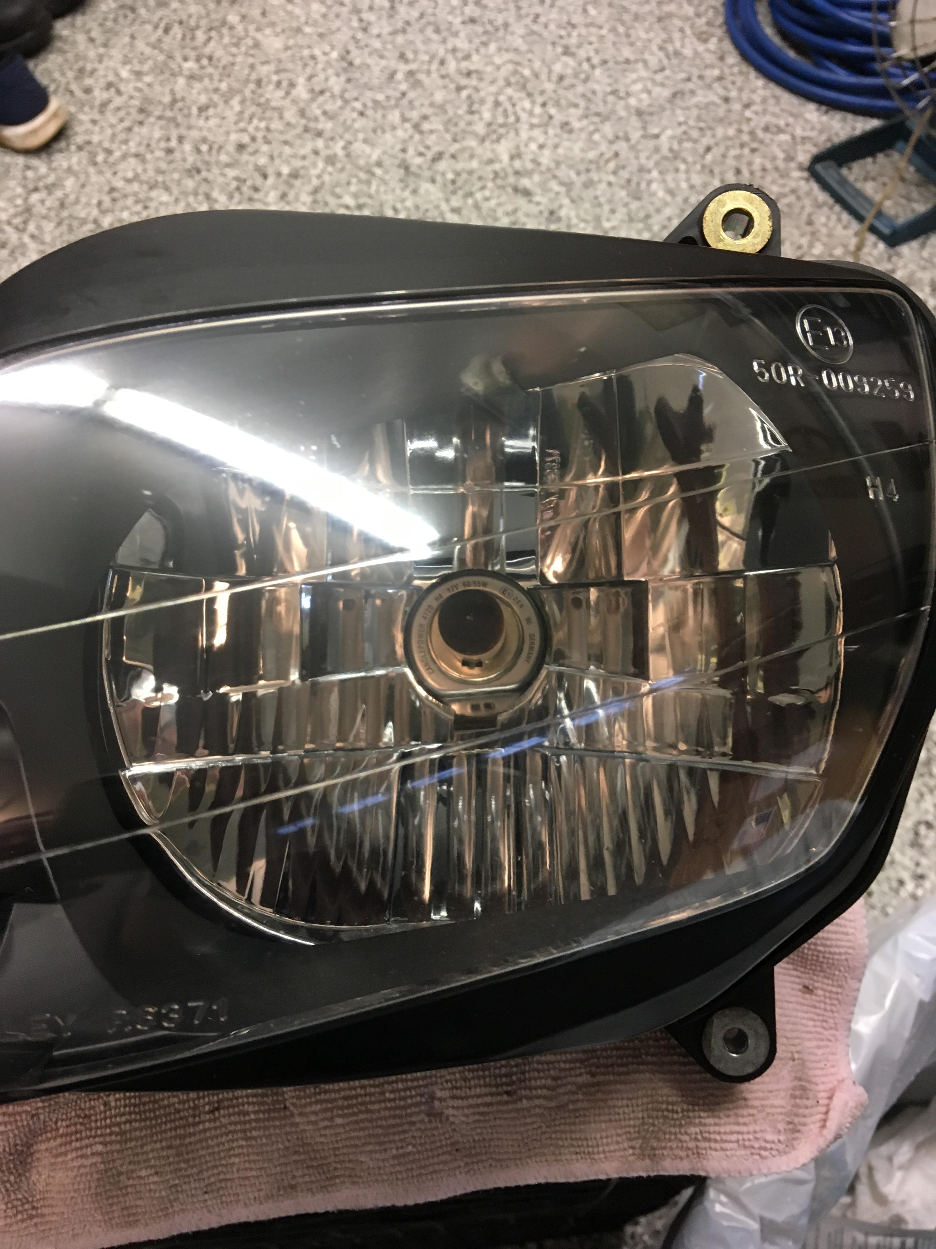

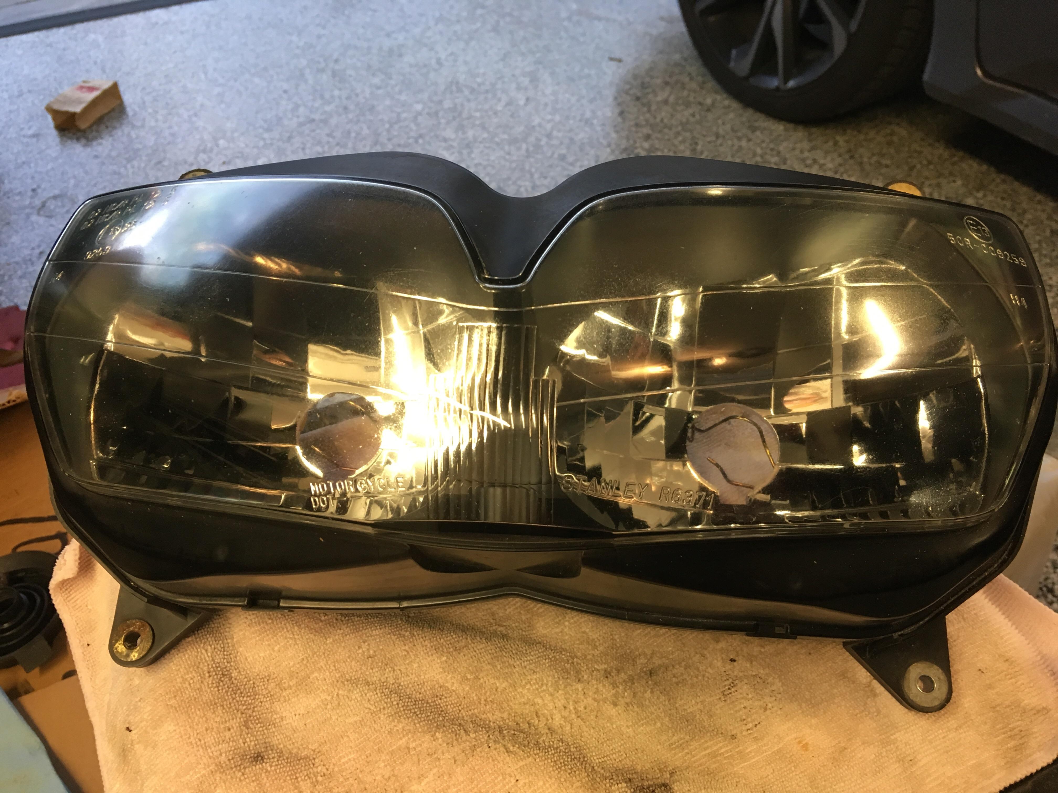

Member Contributer KevCarver Posted February 5, 2020 Author Member Contributer Posted February 5, 2020 Job done! I'll reserve final judgement until the morning when it is completely dry, but it looks great at the moment! I did a combination of most of the above; Mainly polishing with light plastic polish, and some sanding with 1500 grit, finally finishing off with the 3M sealer/clear coat after the included 3000 grit pad. I guess the biggest thing I didn't understand was that I didn't need to finish it completely clear and polished before clear coating. The Chris Fix video from MaxSwell and also the 3M instructions both left it clouded over. So that was not my original intent. I'm leaving it alone until tomorrow, so I'll see what it looks like then. Quote
skant153 Posted February 5, 2020 Posted February 5, 2020 If I may offer a few critiques on the video posted above from a bodywork standpoint.. 1. It's not a good idea to skip more than 1 grit. Going from 600 to 2000 is a big difference. Sanding creates a valley and ridge pattern, the next grit knocks the ridges down but doesn't get the valleys. With the right grit, you slowly approach the valleys. If you skip too much grit, you're hardly impacting the ridges but leaving deep valleys. This will impact the light diffusion in the final product. 2. I'd use a 2k clear coat. That evaporative cure stuff doesn't have staying power. It'll flake right off and come off in the rain. Spraymax makes a rattle can 2k. Press a button in the bottom and it'll release a hardener. This will create a durable, solvent resistant clear coat that will last quite a long time. 3. Just not a fan of the swirling sanding motion. If you can, get blocks from an auto store too, your hands are the worst sanding blocks. 4. Don't wax for probably a week after clear coating. You need to allow for off gassing. It's also funny he said you wouldn't need wax at the start then waxes it at the end. 1 Quote
Member Contributer KevCarver Posted February 6, 2020 Author Member Contributer Posted February 6, 2020 Here are the pics I took yesterday afternoon and I just checked this morning after fully drying, and then some. They look the same now. The sealer/clear coat fills in all the sanding cloudiness and dries clear. The same thing happens with water or alcohol, but of course dries cloudy again, so I was skeptical. Of course you can tell it’s not brand new, but really you’d have to look closely. Considering where it started, I’m beyond thrilled! 6 Quote
