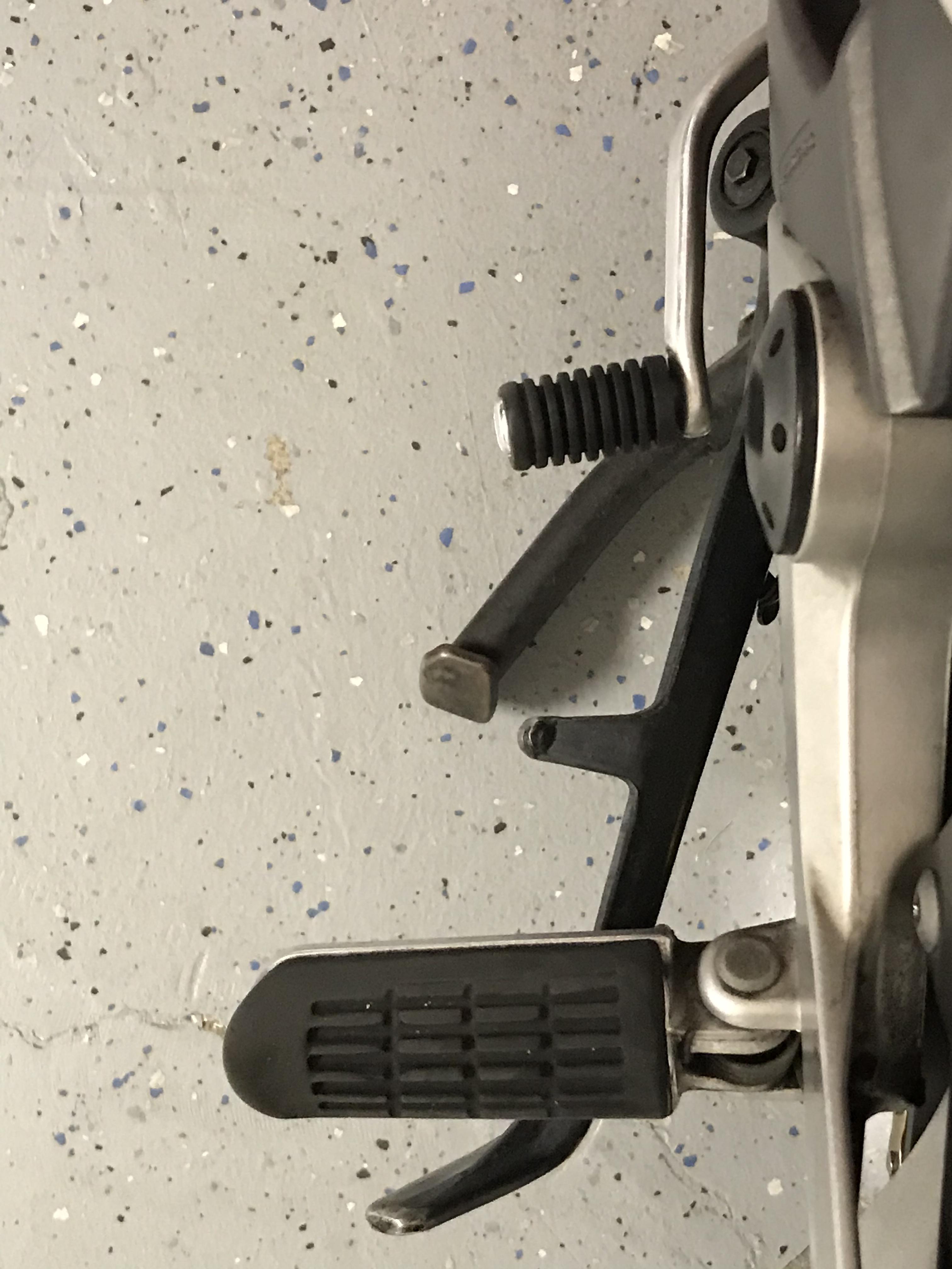

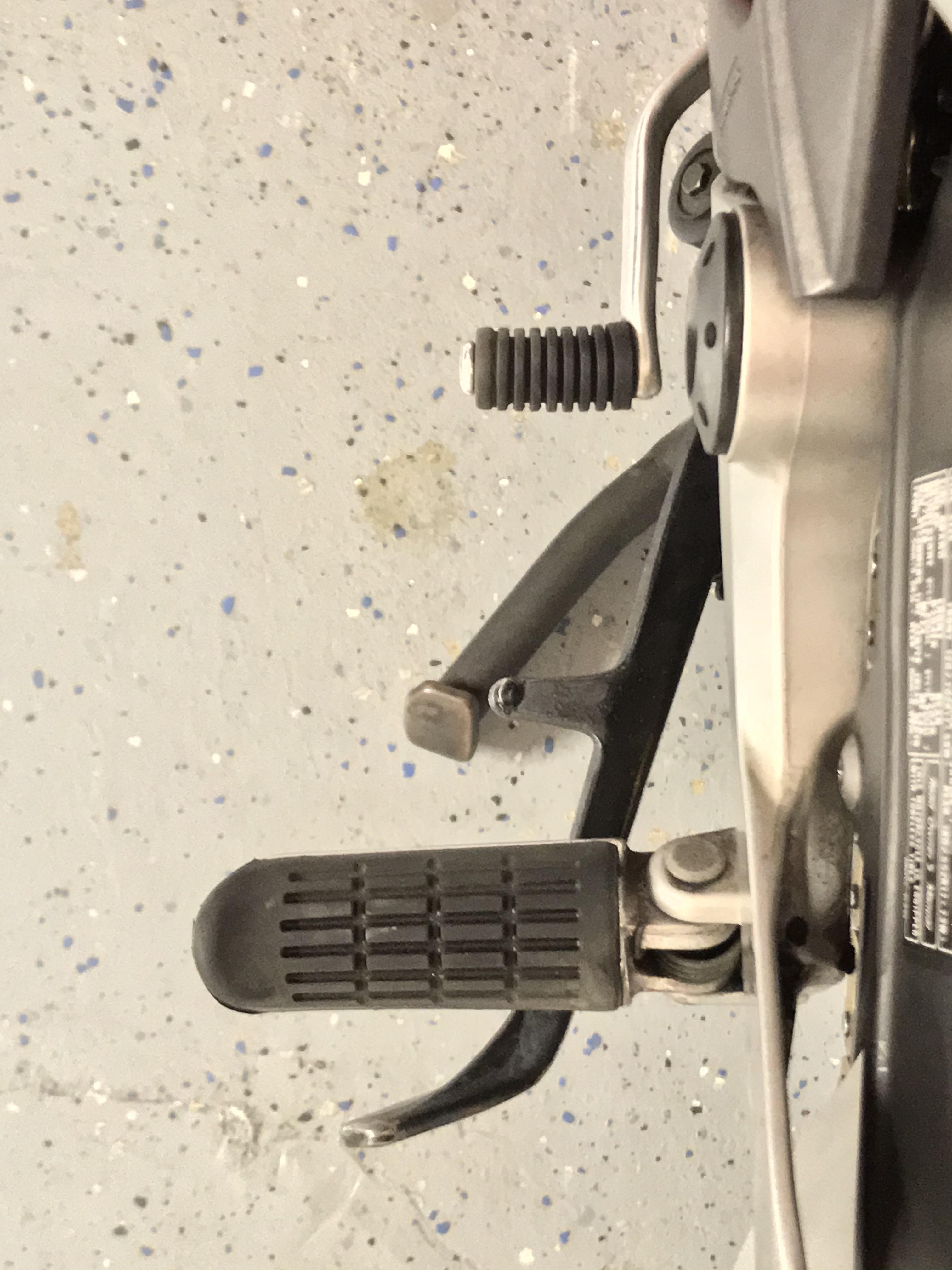

8200rpm Posted November 11, 2019 Posted November 11, 2019 1998 VFR800FI Are these bent, or are they normally like this? Quote
Member Contributer Grum Posted November 11, 2019 Member Contributer Posted November 11, 2019 They look bent to me, they should both be at the same angle as the foot peg. Quote
Member Contributer Philois1984 Posted November 11, 2019 Member Contributer Posted November 11, 2019 I am sure this same question was asked many months ago with very similar photos. Maybe others have had this issue as well? Quote
Member Contributer Skids Posted November 11, 2019 Member Contributer Posted November 11, 2019 Definitely bent to my eyes. Quote
Member Contributer FJ12Ryder Posted November 11, 2019 Member Contributer Posted November 11, 2019 Both look bent to me. Quote

Member Contributer JZH Posted November 12, 2019 Member Contributer Posted November 12, 2019 Definitely bent (pretzeled, really). The shift lever is easy to find second-hand, and fits other VFRs (like my 3rd gen). Brake lever looks expensive to me! Ciao, JZH Quote
JoelF Posted November 15, 2019 Posted November 15, 2019 The brake lever is easy to heat and bend with a propane torch. Heat until it looks kinda sweaty. I bent mine to adjust for lowered pegs, never removed it from the bike. Quote

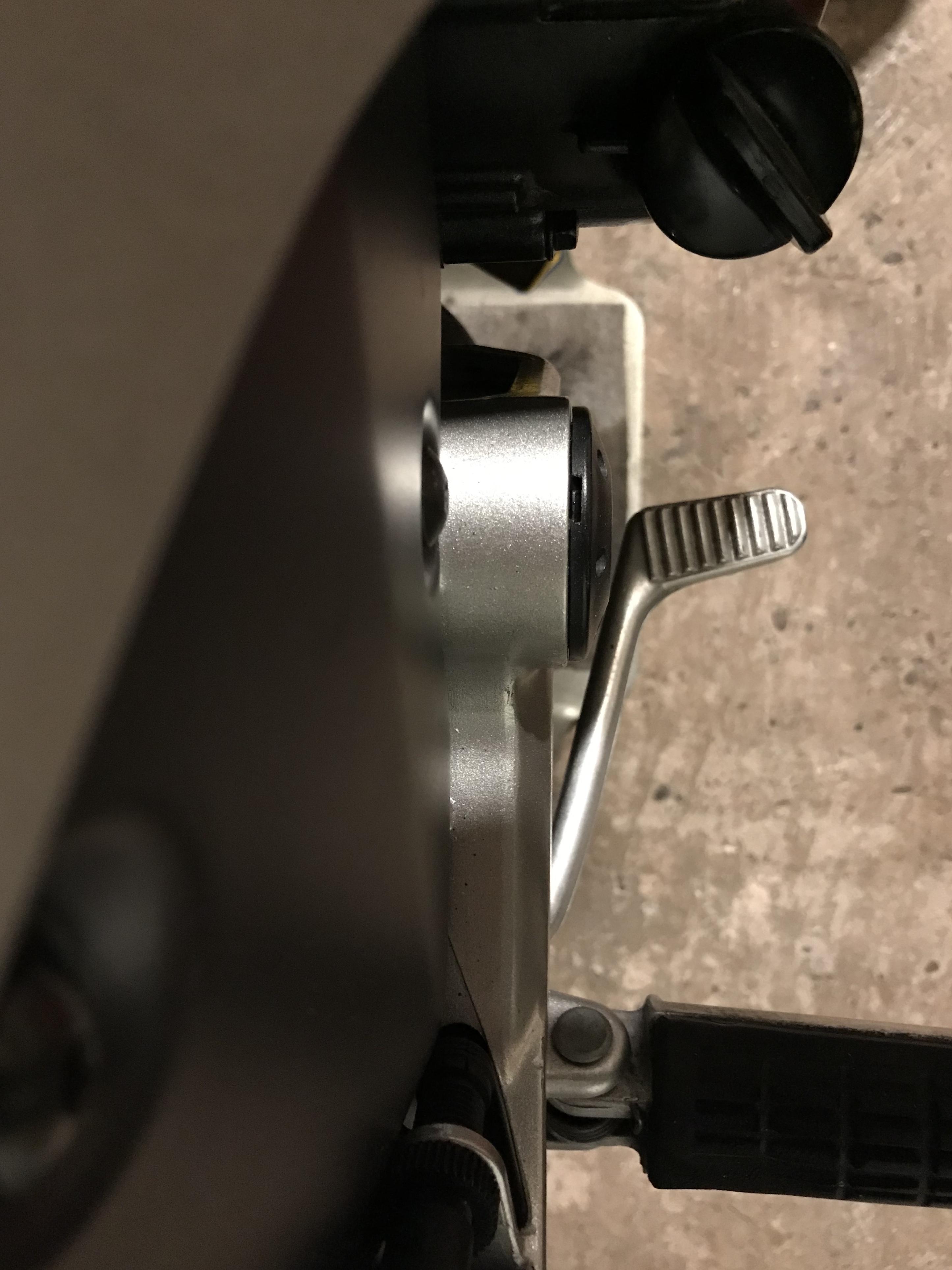

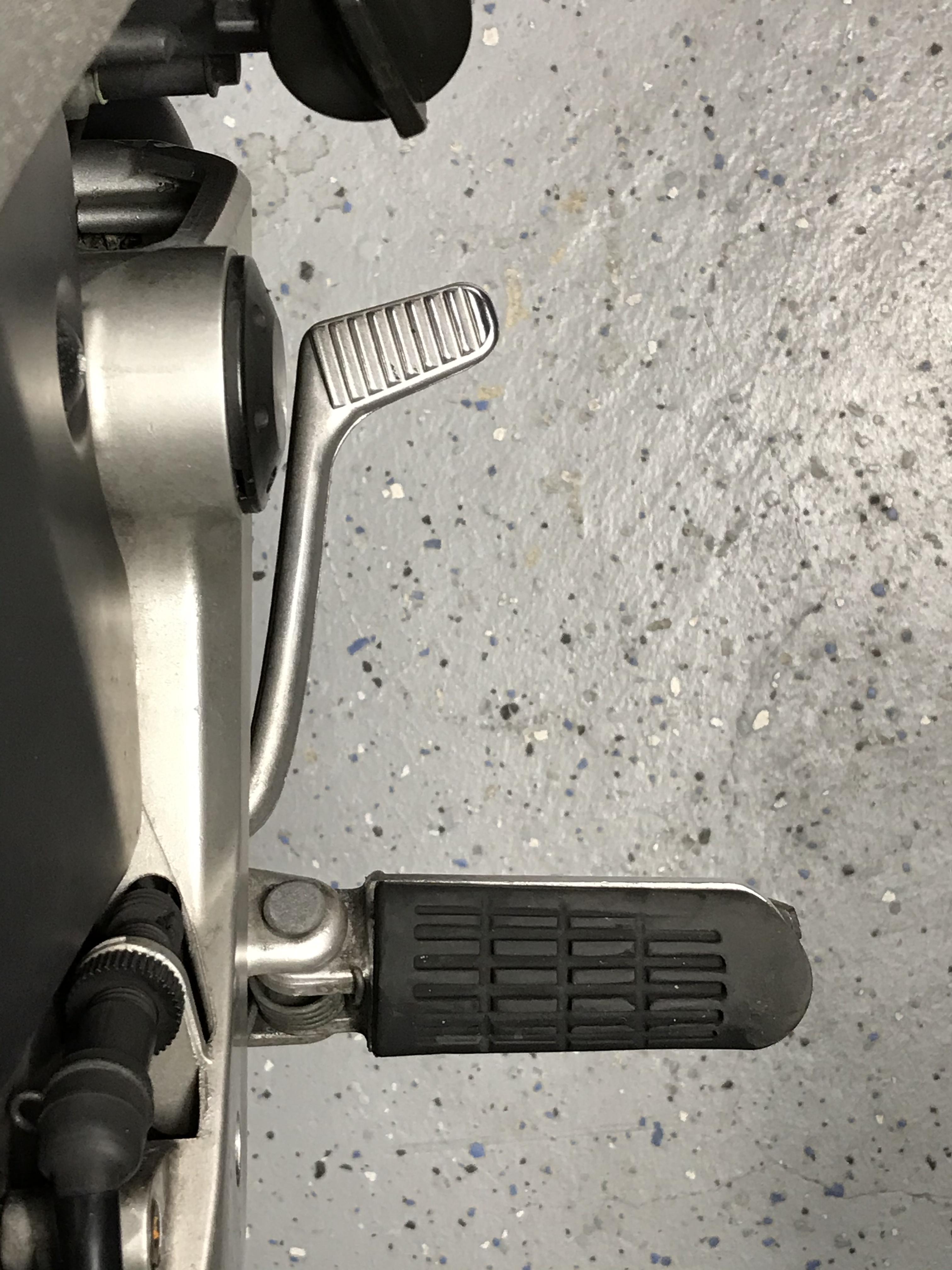

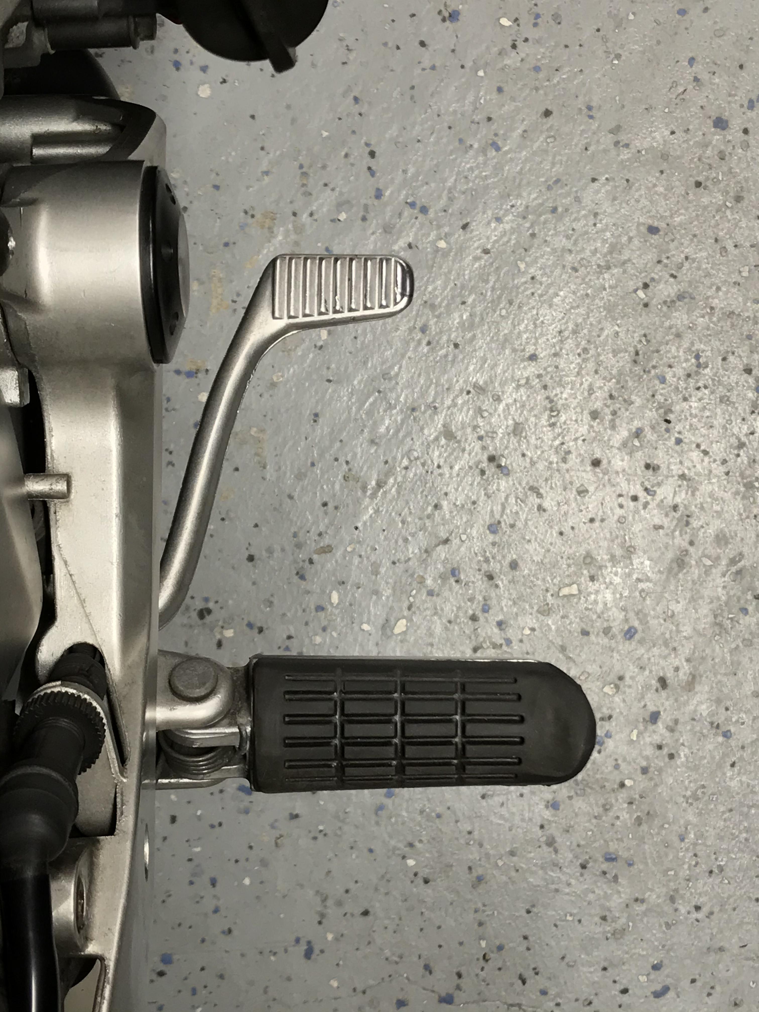

8200rpm Posted November 18, 2019 Author Posted November 18, 2019 Stuck them in a vise and bent them straight. Shifter was easy. Put the toe piece in the vise and applied leverage from the open clamp end that attaches to the gearshift spindle. Brake pedal was a bit more stubborn. Put the pivot side in the vise. Slipped a 26mm extended handle box wrench onto the step end and pulled it straight. 1 Quote
Member Contributer Grum Posted November 18, 2019 Member Contributer Posted November 18, 2019 Looking good, just like new again, well done. Quote
Member Contributer Skids Posted November 18, 2019 Member Contributer Posted November 18, 2019 Nice one! Quote
8200rpm Posted November 18, 2019 Author Posted November 18, 2019 6 hours ago, Grum said: Looking good, just like new again, well done. I wouldn’t go that far, but it’s good enough. Can’t let perfect be the enemy of good. My wallet can’t afford perfect. I have to constantly remind myself that achieving cosmetic and even mechanical perfection on a 20 year old motorcycle can become a hard lesson in the law of diminishing returns. Quote

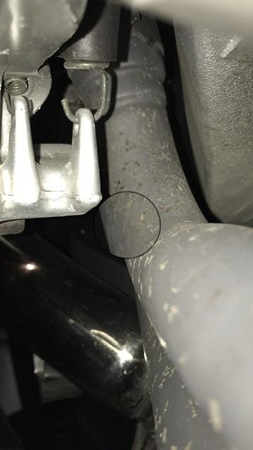

Member Contributer ChrisBezz Posted November 19, 2019 Member Contributer Posted November 19, 2019 I’m just wondering how you remove a brake pedal from a 5th gen VFR? There seems to be an exhaust pipe in the way? Quote
Member Contributer ChrisBezz Posted November 19, 2019 Member Contributer Posted November 19, 2019 My rear brake pedal. Quote
8200rpm Posted November 19, 2019 Author Posted November 19, 2019 The exhaust didn’t pose a clearance issue on my ‘98. Once I unhooked the springs, pedal slipped right off. 😮 Yep. The washer and circlip was missing! It’s amazing all the little parts I find missing on this bike. Quote
