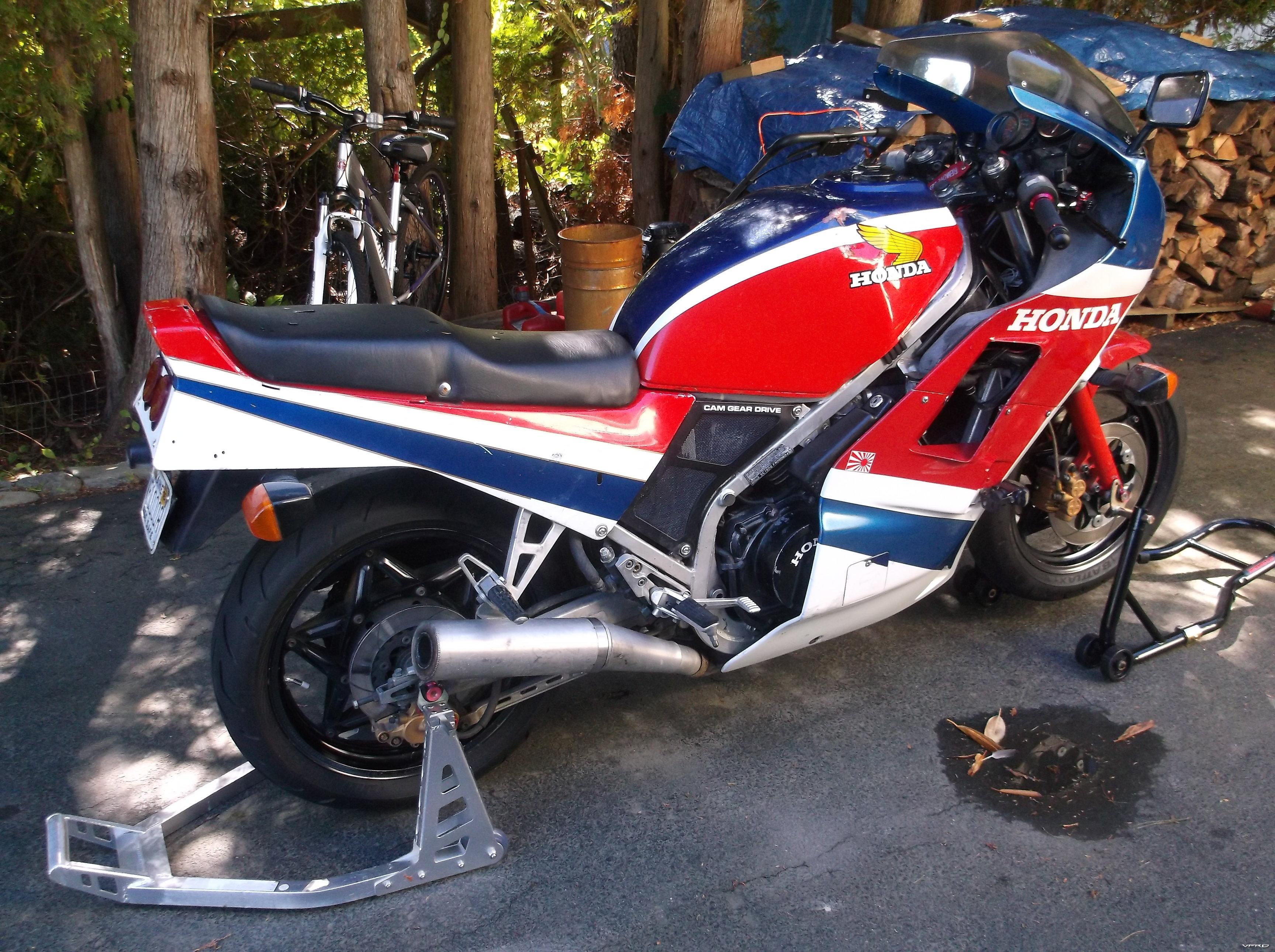

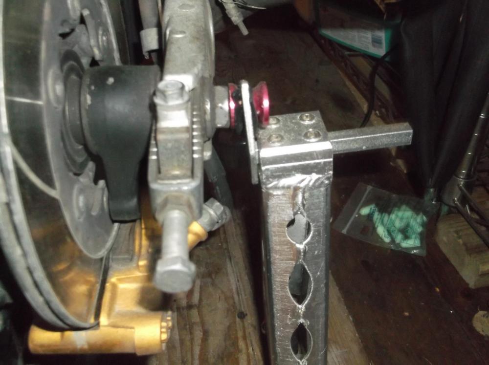

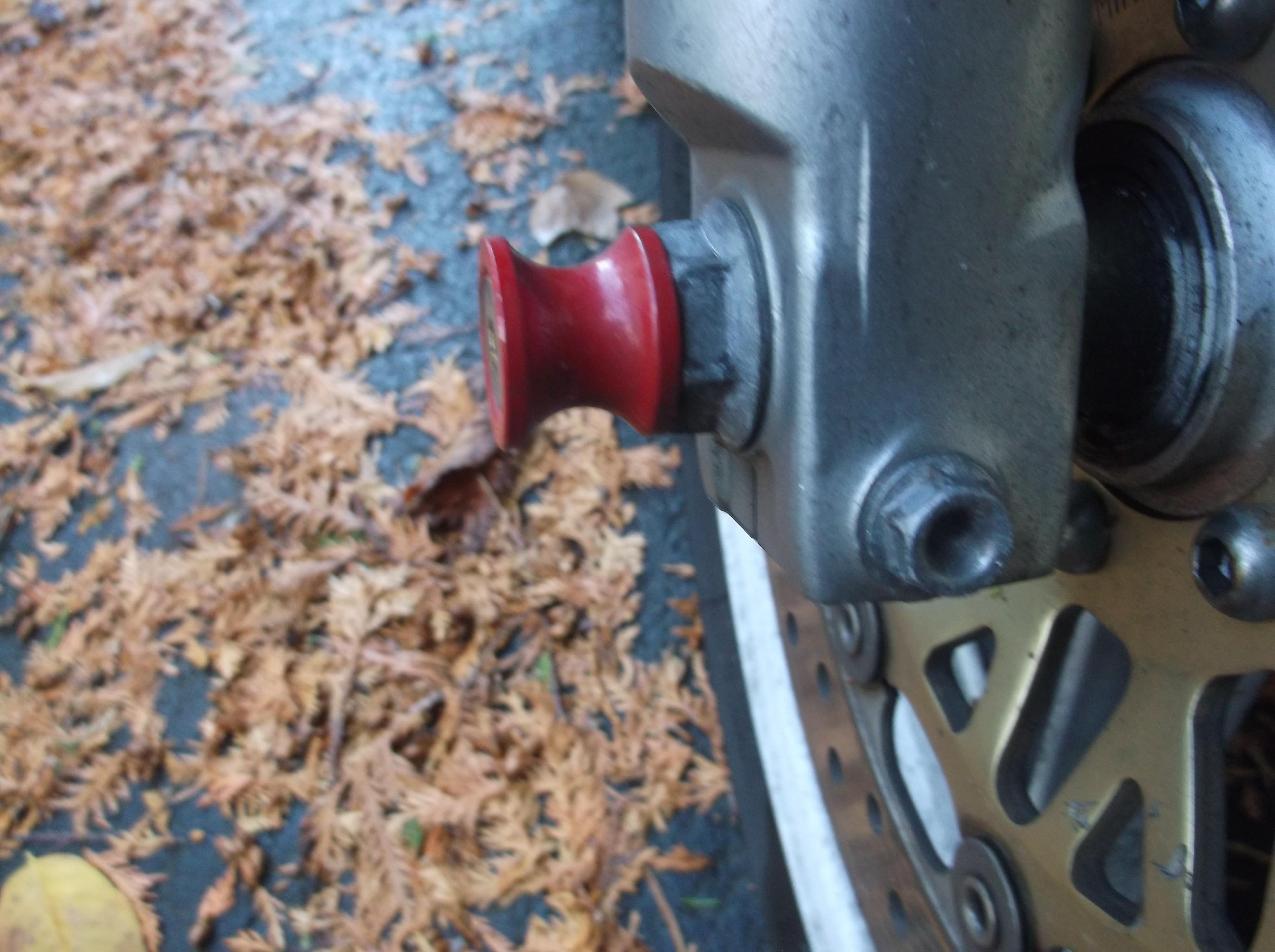

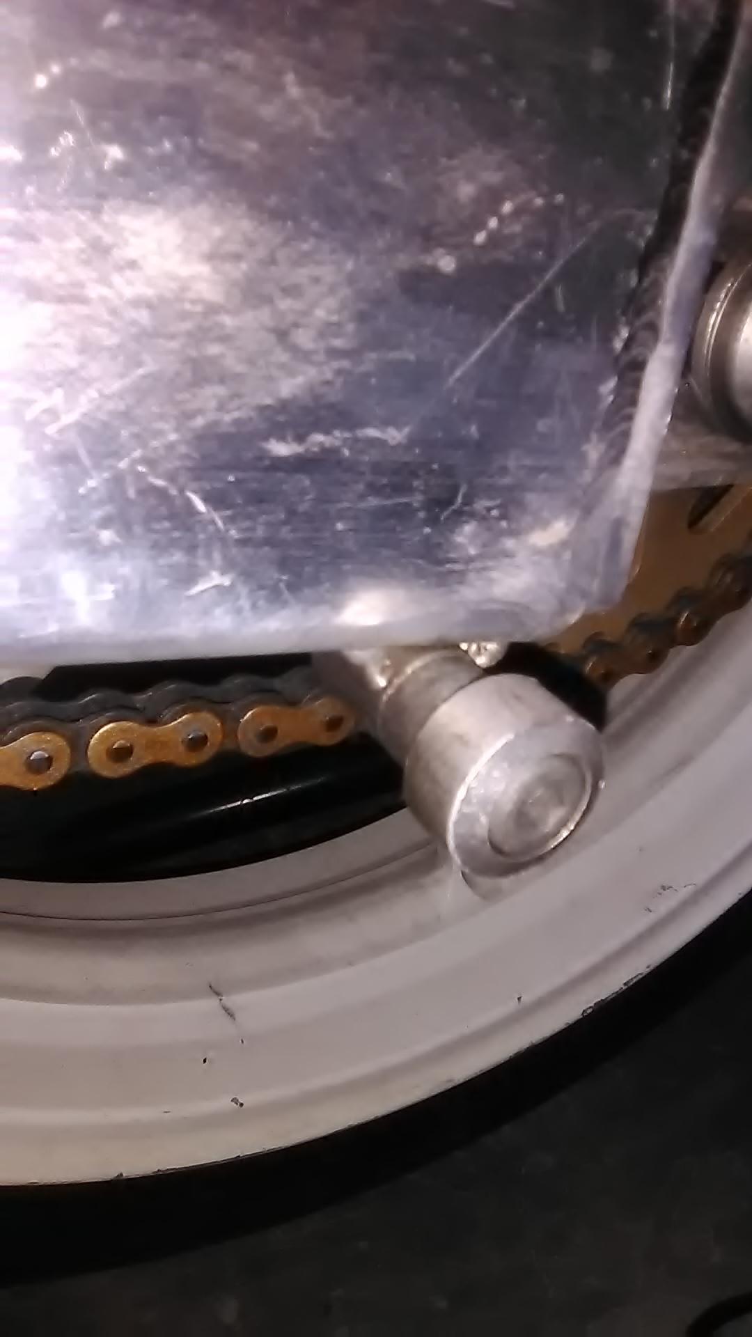

Member Contributer FromMaine Posted October 23, 2019 Member Contributer Posted October 23, 2019 The 86 rear axle is hollow. https://www.ebay.com/itm/1986-Honda-VFR750F-Interceptor-Rear-Axle-86/281659679255?hash=item419439a217:g:hJ0AAOSwxYxUseqc https://www.ebay.com/itm/1986-Honda-VFR750F-Interceptor-Rear-Axle-86/281659679255?hash=item419439a217:g:hJ0AAOSwxYxUseqc As gll429 mentioned above, run a rod through the axle. On my 85 R I used a solid rod, think it was 10mm and threaded one end then tapped my bobbin and screwed it on, Ran the rod through the axle, think I needed to ream a few imperfections, measured, cut and repeated the same one the other end. On my 97 front axle I just tapped either end and used a flat head socket screw for attachment. I have 4 paddock stands and they all have the both the spool and flat attachments, but the flats are nowhere as secure as the spools which is why I fitted them. Good luck. Quote
Member Contributer FromMaine Posted October 23, 2019 Member Contributer Posted October 23, 2019 This is probably a better picture. Quote

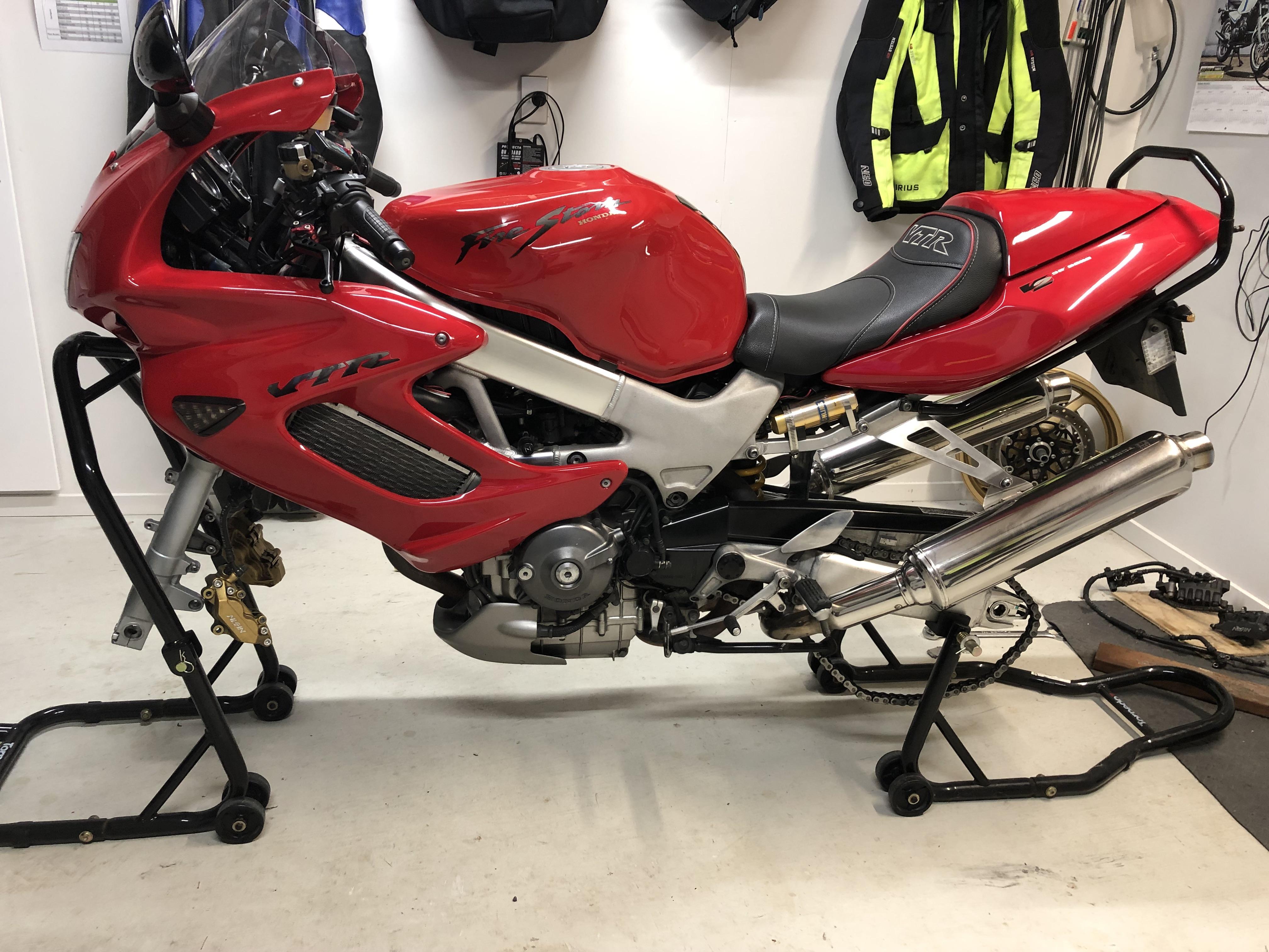

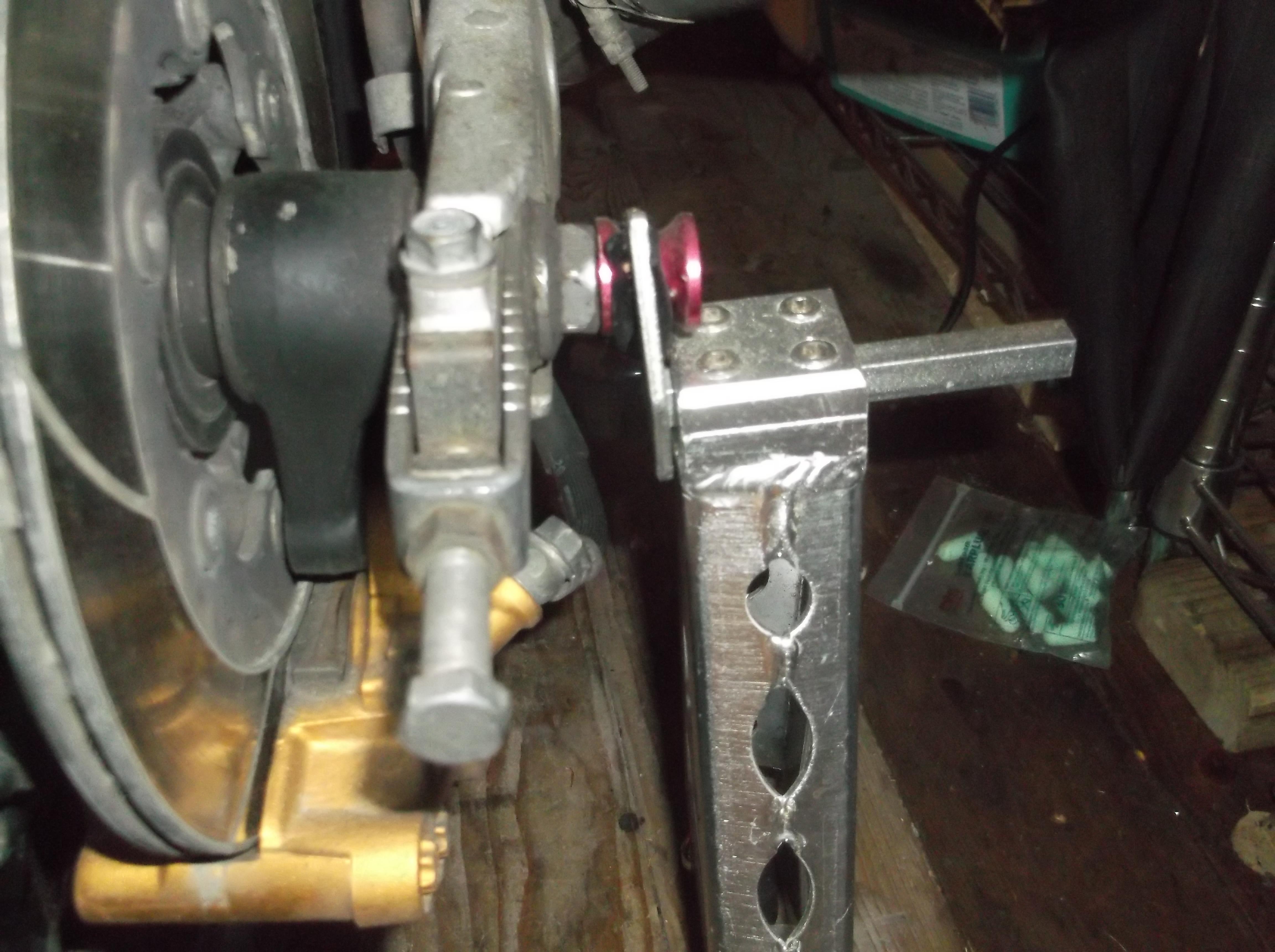

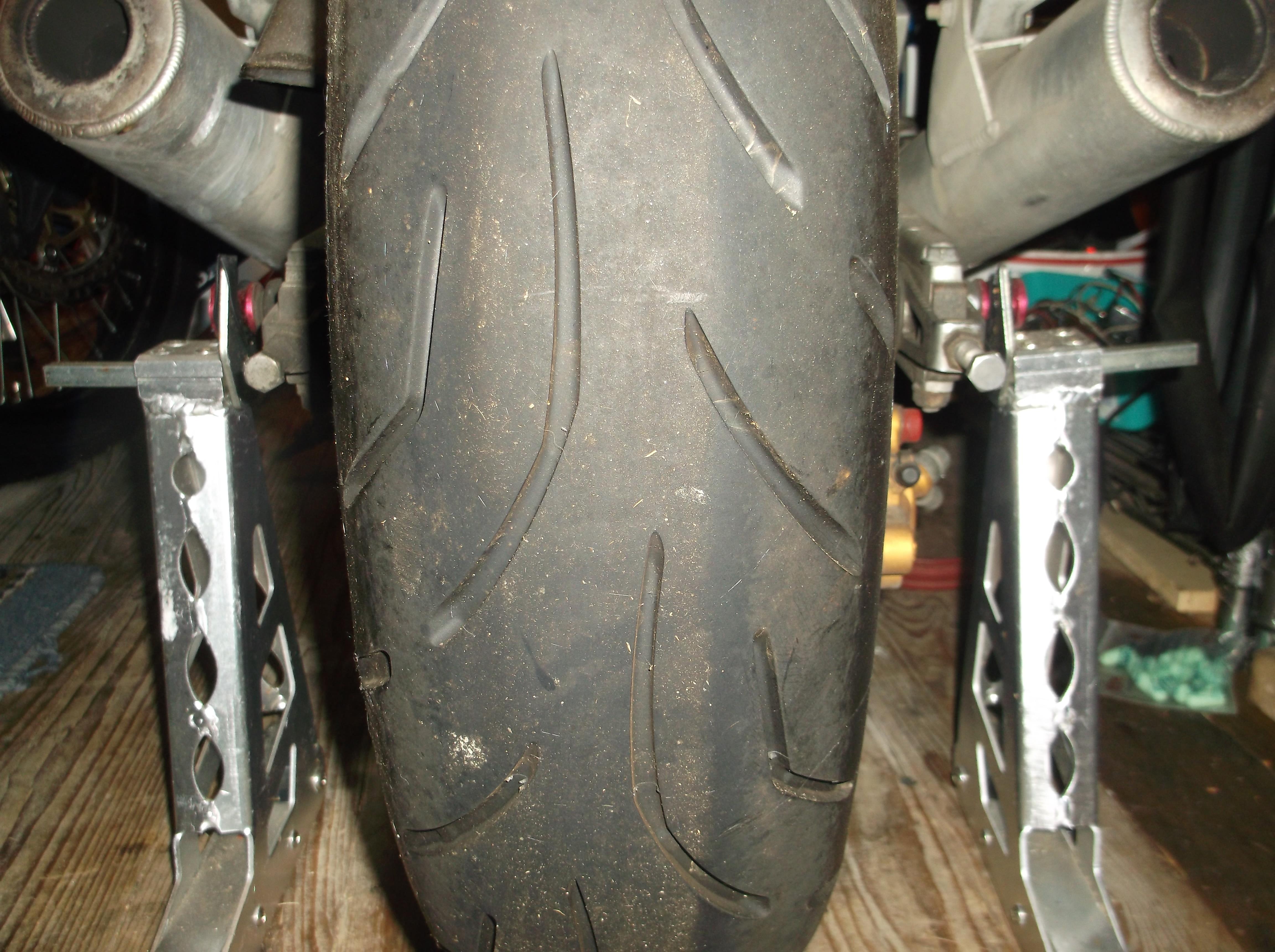

Member Contributer Terry Posted October 30, 2019 Member Contributer Posted October 30, 2019 I'm pretty happy with my front and rear stand combination, the rear just lifts the swingarm using rubber pads on metal angles that can be adusted for width. And the front lifts directly on the steering head via a pin inserted into the stem. It's a fantastic combination until you want to remove the swingarm/shock or the steering head. Quote
BluRoad Posted November 14, 2019 Posted November 14, 2019 ^^^^ Your bike and shop are disturbingly clean. Beautiful VTR. Quote
