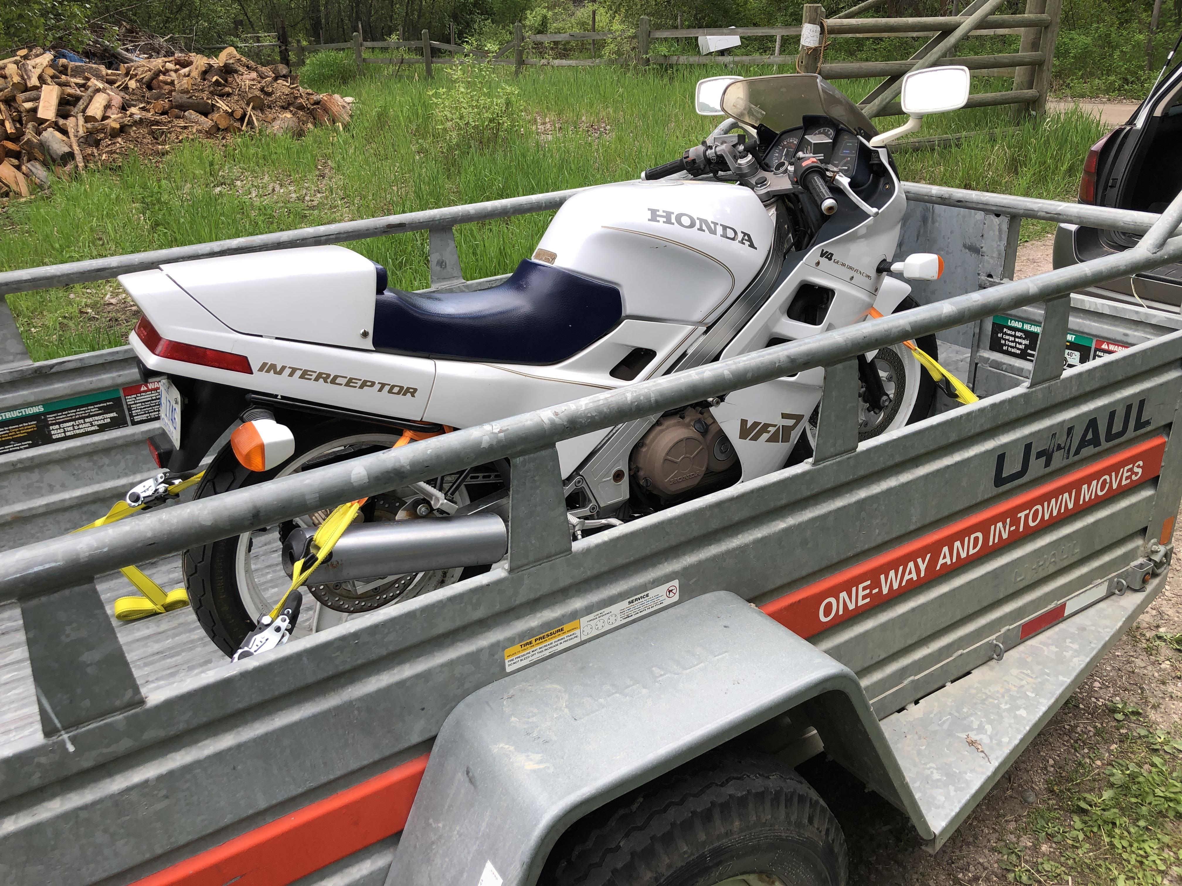

Counterbalance Posted June 1, 2019 Posted June 1, 2019 ...VFR700 F2. Does this bike want to be a good bike? - or a bad bike. Quote
Member Contributer Mohawk Posted June 1, 2019 Member Contributer Posted June 1, 2019 Sweet find, looks like it was in a nice warm dry storage area. Have fun recommissioning it. Quote
Member Contributer MaxSwell Posted June 1, 2019 Member Contributer Posted June 1, 2019 Welcome to the asylum. I'd say that machine has a future in the right hands. Any body work come with it? Good luck and good wrenching. Quote

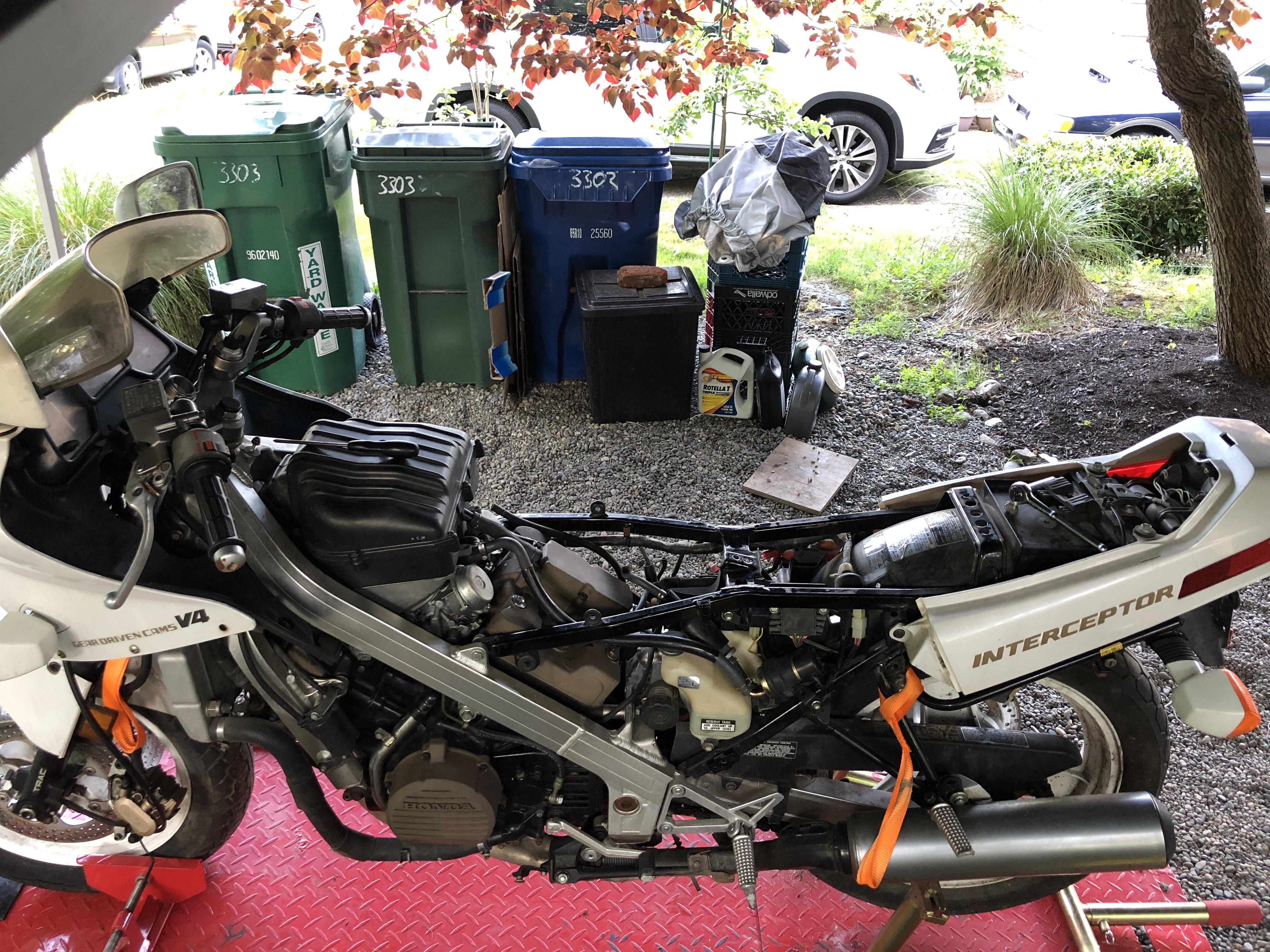

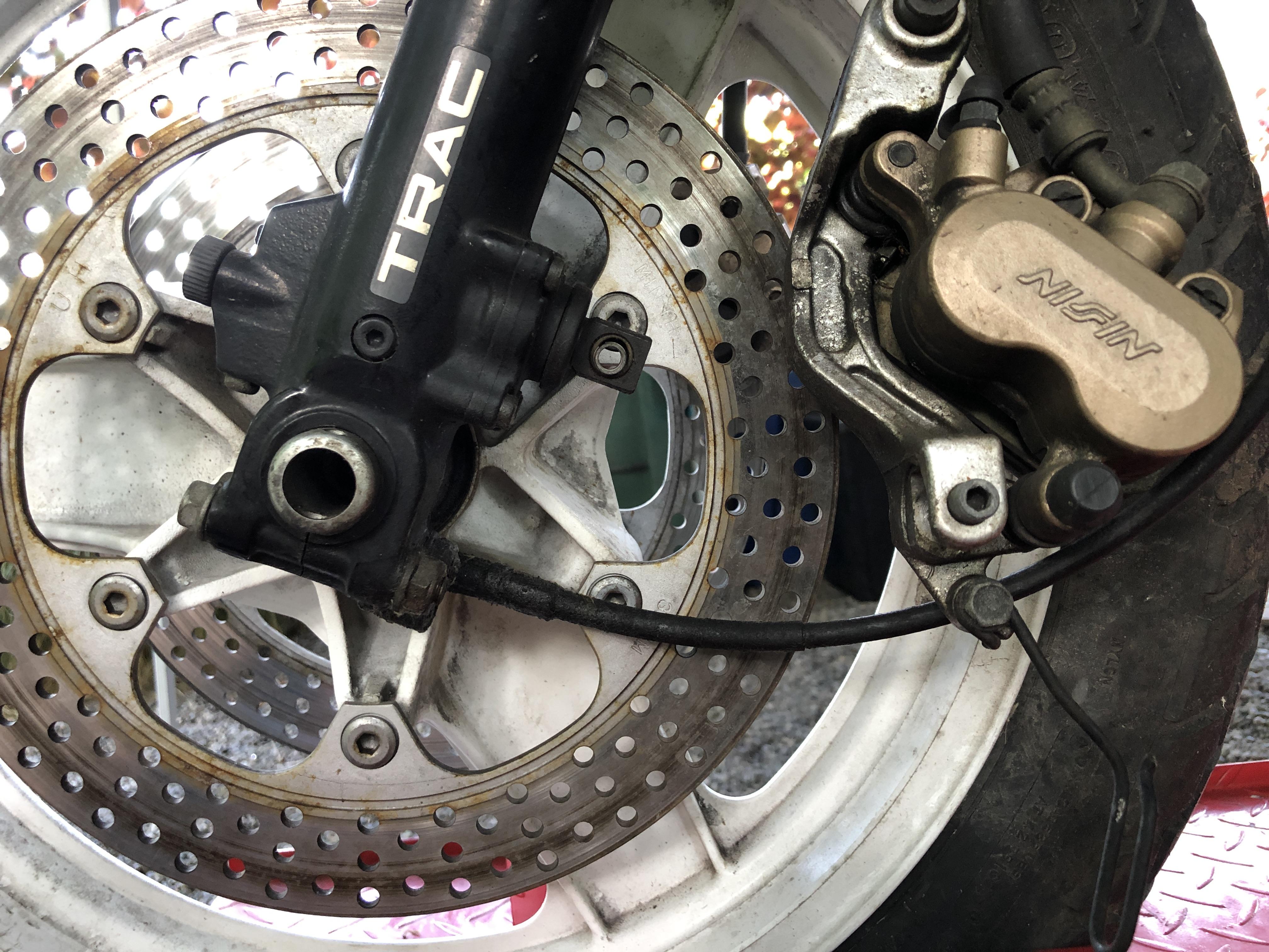

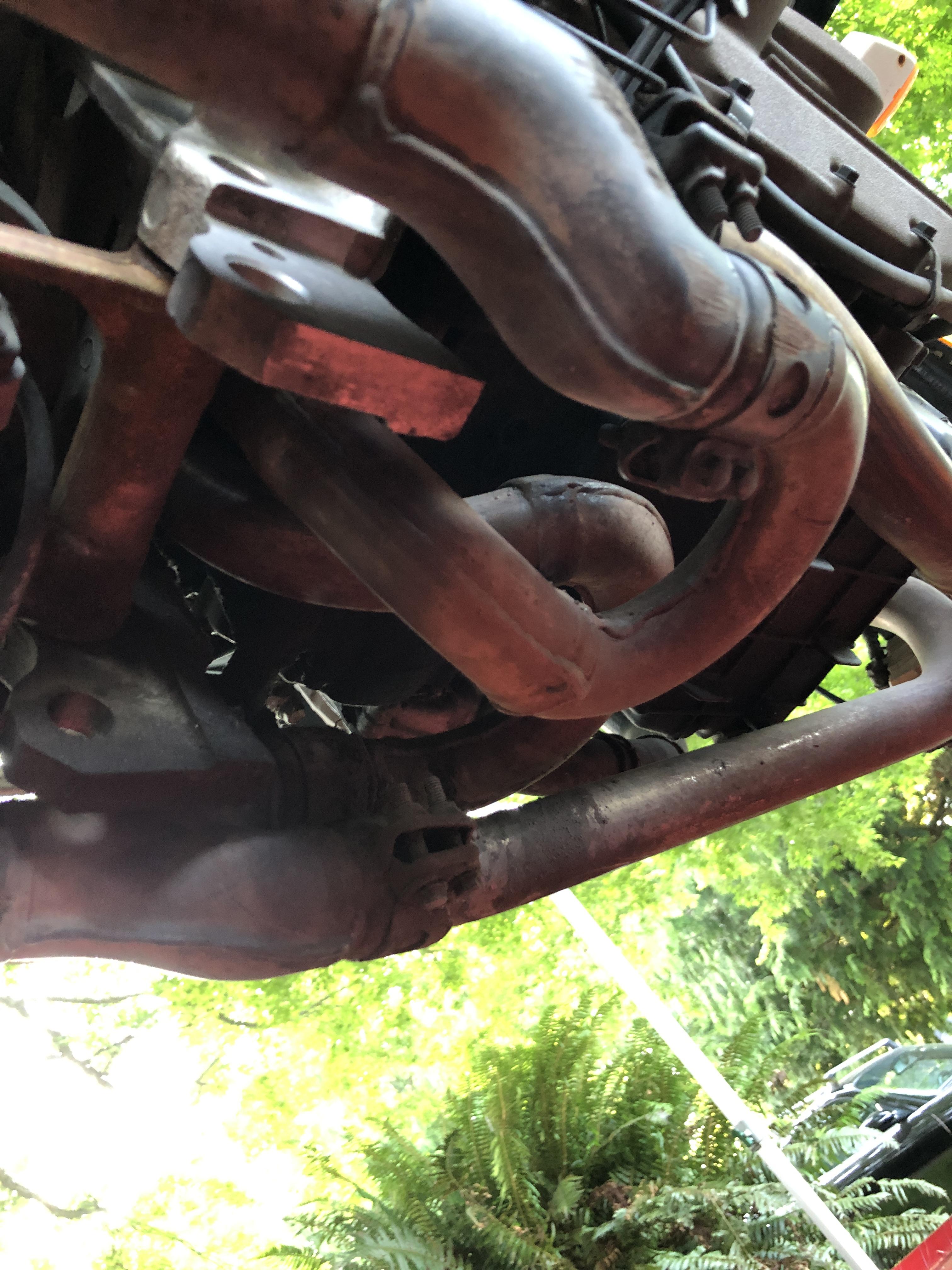

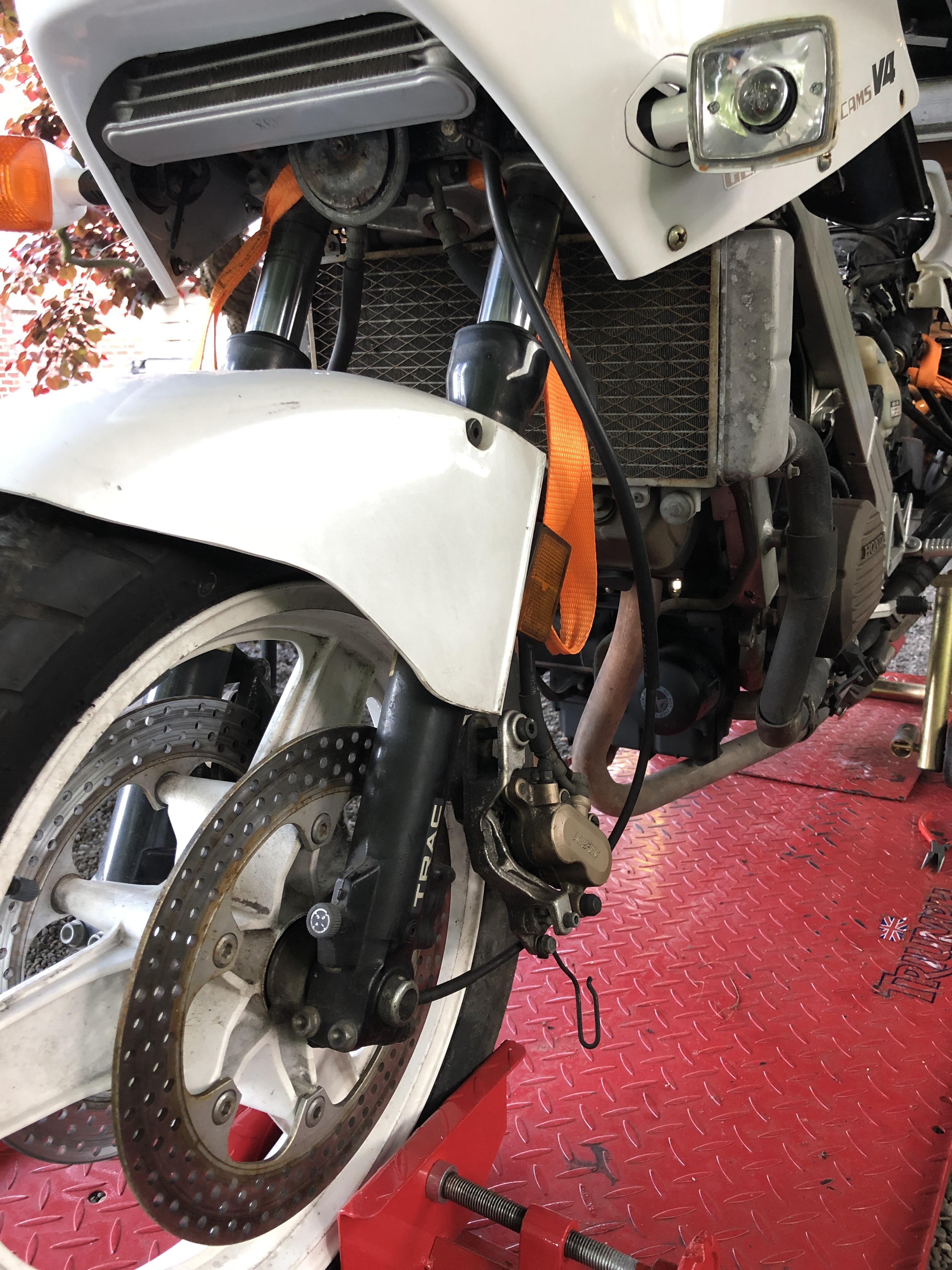

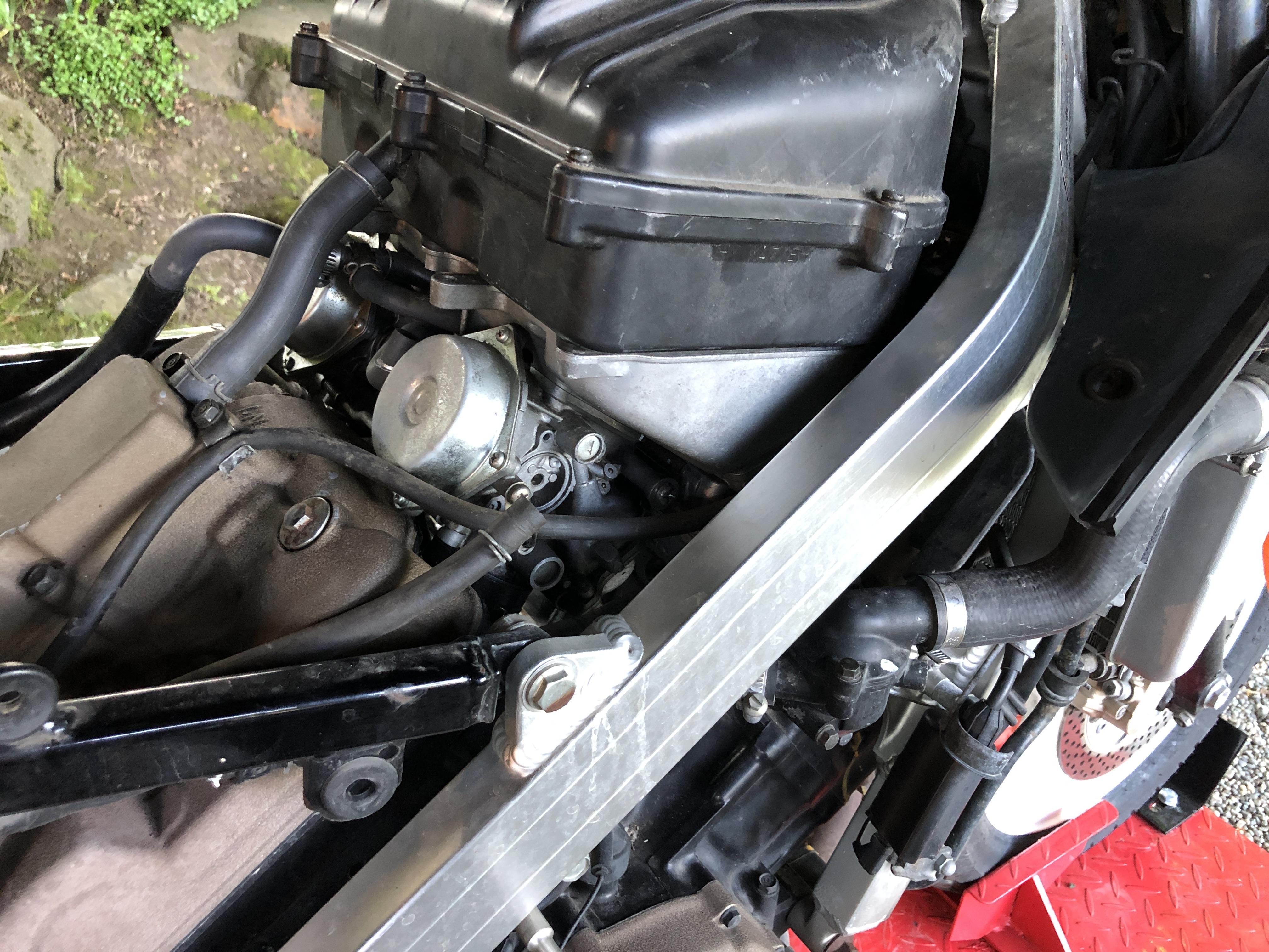

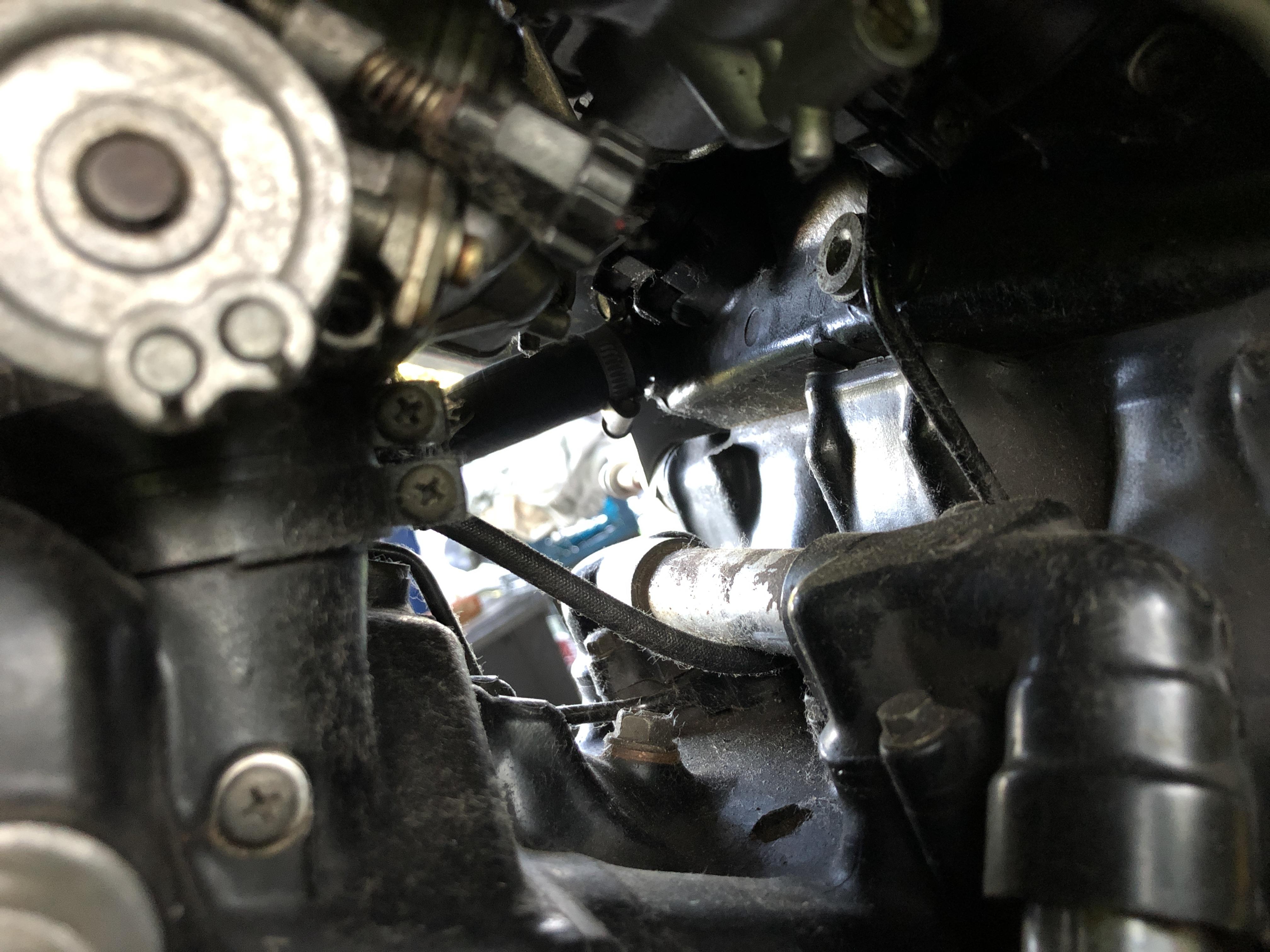

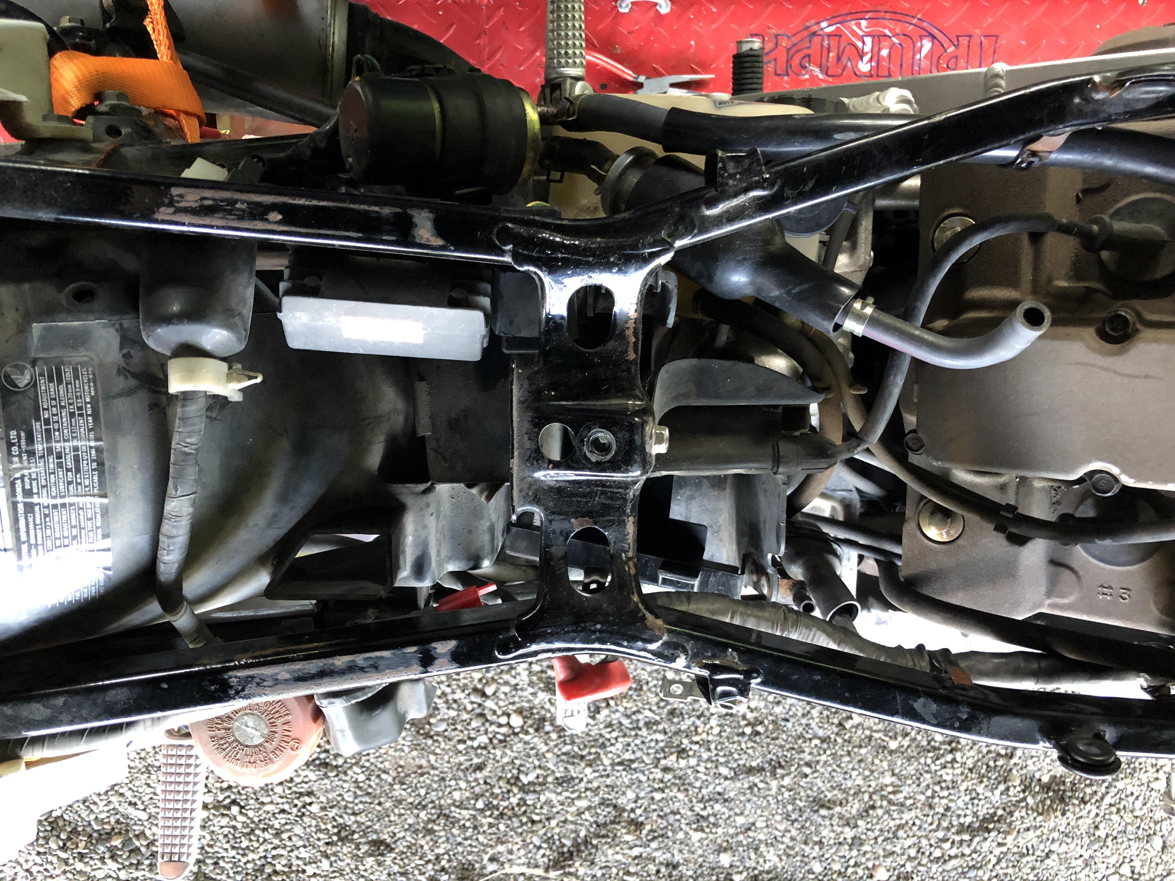

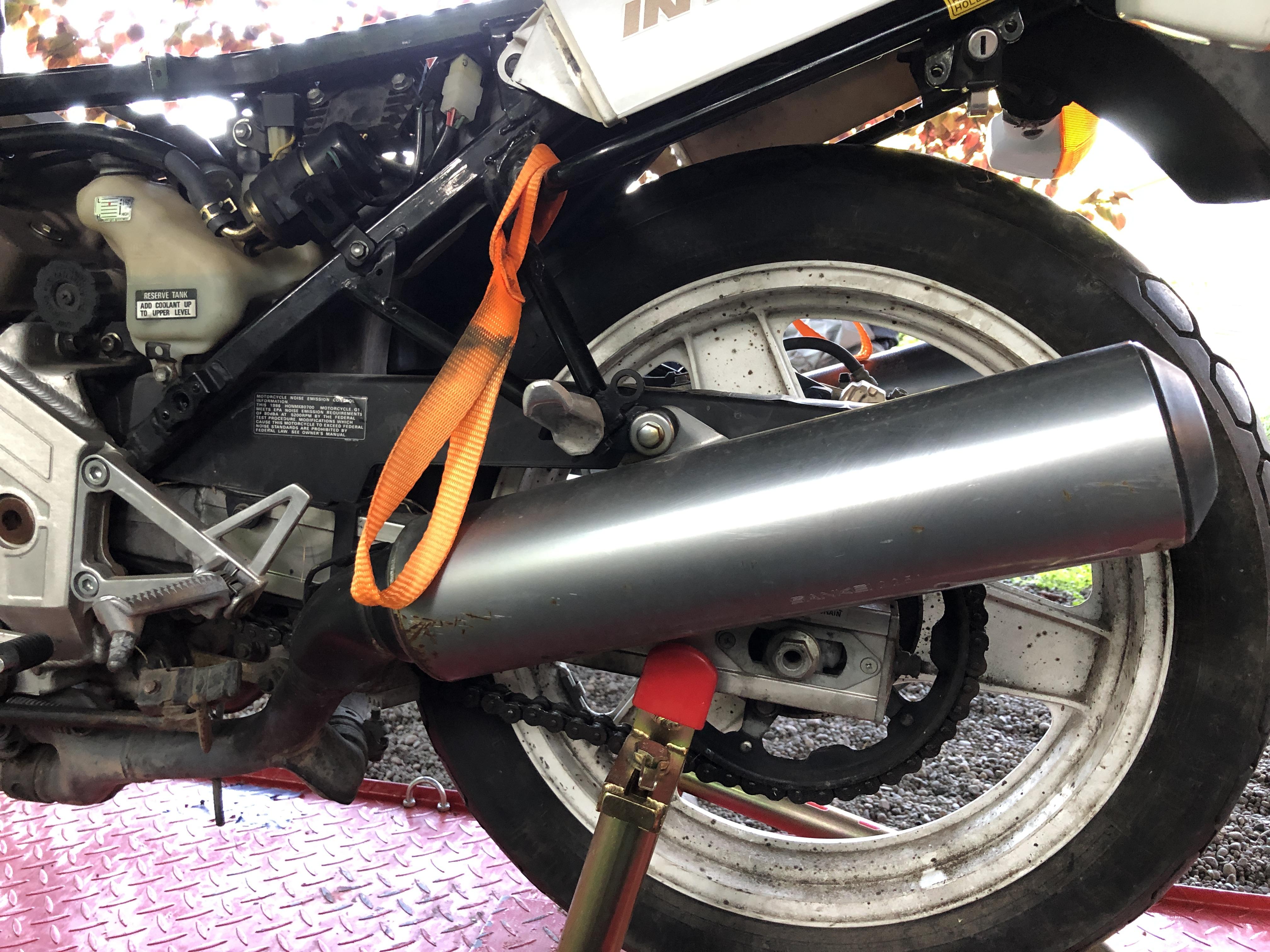

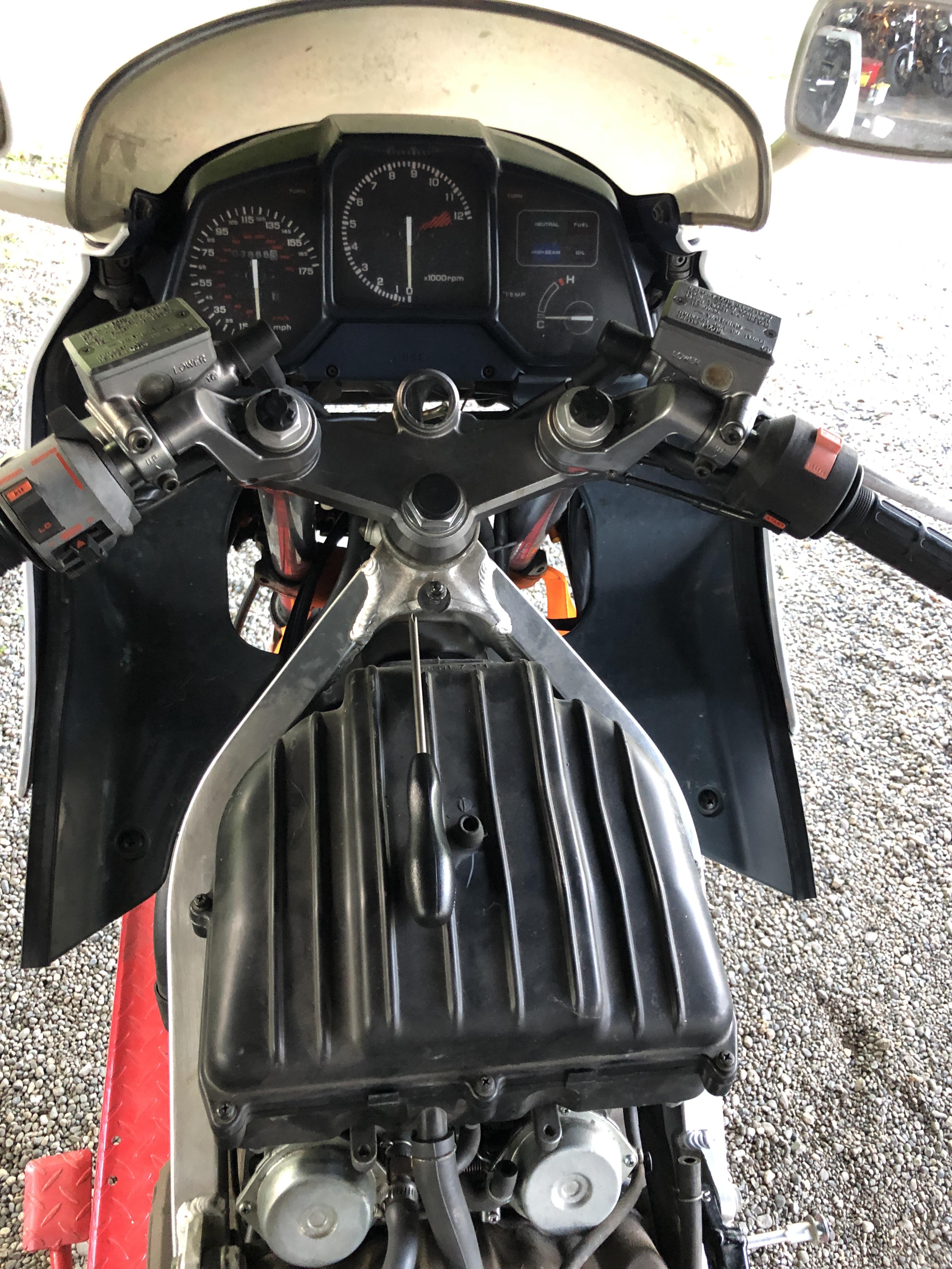

Counterbalance Posted June 1, 2019 Author Posted June 1, 2019 12 minutes ago, MaxSwell said: Welcome to the asylum. I'd say that machine has a future in the right hands. Any body work come with it? Good luck and good wrenching. Here’s the story - I’ve got about $3K in mind to put toward this bike. I’ve been looking for a V4 for a while and I just couldn’t walk away from the low mileage on this one. It has expensive problems, but a lot to show for itself too. Here’s the start of a ‘get run’ list which will help me know how to proceed. 1) keys are long gone so I need ignition, tank lock assembly and seat release (HELP!) 2) rebuild hydraulic clutch system 3) carbs need rebuilding and gone through with intake rubber replaced as needed 4) plugs, oil, coolant, filters, etc. 5) ? (Your input here) ? Then, it fires right up, I smile from ear to ear, say something about how great Honda’s are and then decide how to proceed, right? The lower fairing is shot both sides. Some hooplehead grabbed the tailight to move the bike and cracked it but nothing is missing. The rest of the plastic is very good. Generally the bike is low wear and damage appears mostly cosmetic. I’m worried about old rubber and the attendant trouble from just parking a bike for 30 years. Any help on key/ignition/fuel-cap so I can move on to the next step? Thanks for looking! Quote
Member Contributer Dutchy Posted June 1, 2019 Member Contributer Posted June 1, 2019 Being a VFR700 (and not a VF....) cams shoudl be ok. But I'd inspect them 1st prior to pouring serious money into her..... Quote

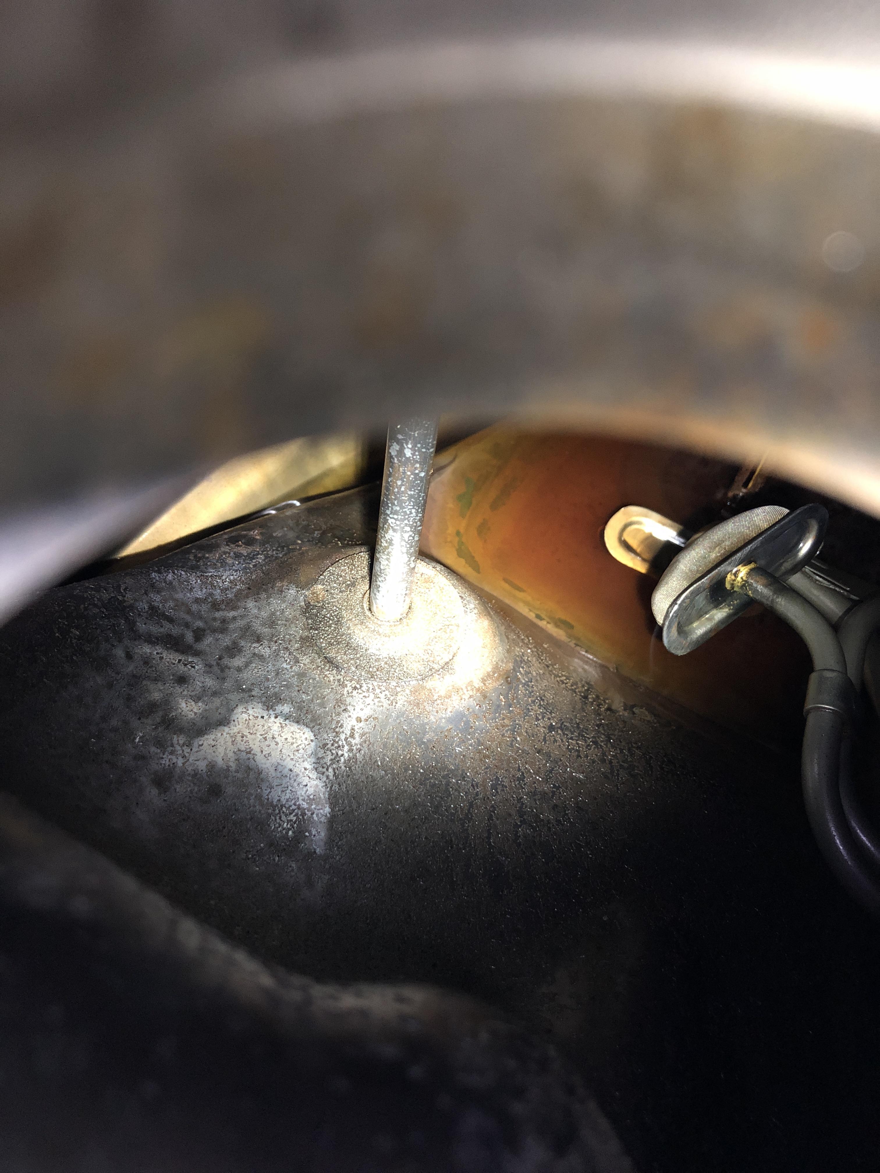

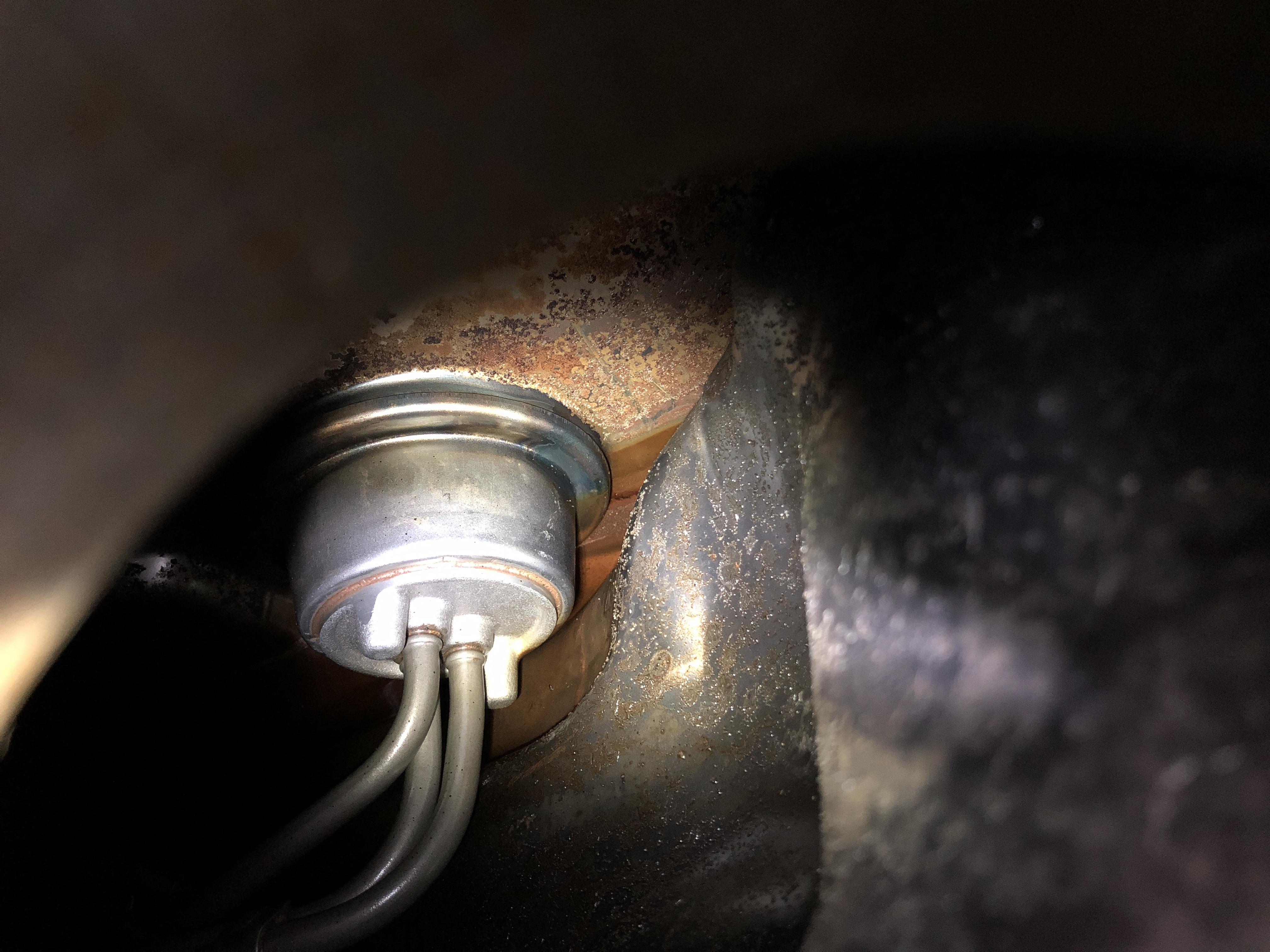

Counterbalance Posted June 4, 2019 Author Posted June 4, 2019 Ok, I’ll admit to being a bit of an OEM slave. My thinking is that you have to be pretty damn good to do better than Soichiro! Plus, part of what motivates me is preserving these bikes as they were intended. That said, it isn’t always practical (nor as much fun) as digging in and modding-out. From a standard of perfection, this bike is pretty rough for as low mileage as it is but if it’s a good running motor and suffers little from age, I think it could be a candidate to return to stock and very presentable condition. It won’t be me who makes it a show bike; I collect these bikes to ride after all. Alternatively, some of the items in great shape on this bike (exhaust, upper and mid fairings) could be sold to fund some engine work and tuning improvements. Hard to say - let’s see if it runs first! Got the keys cut today and gratefully it also worked for the fill cover (although I was sweating at first because it was quite stuck). I looked inside and... not too bad! Any reason not to fill it up with my vinegar wash for a couple days? Quote
