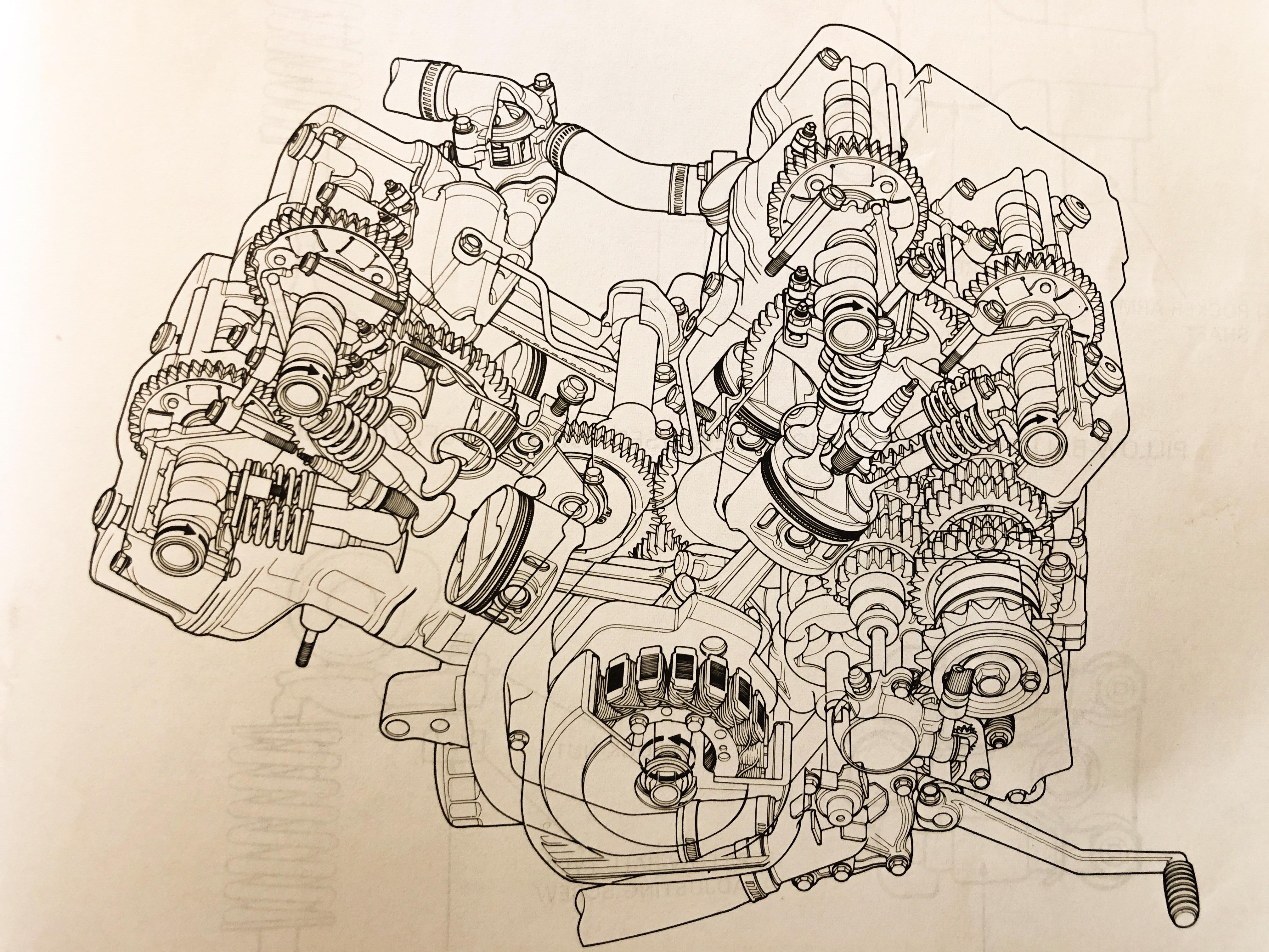

Counterbalance Posted June 4, 2019 Author Posted June 4, 2019 2 hours ago, Dutchy said: If you are in it for the monetary gain/re-coup in the future, I'd walk way now.... What? I should’ve bought a Harley? 😳 I rather think of it as trying to avoid mistakes that there’s no need to pay for. How’s that? I do hope that I’m not the last owner, and that the next guy will thank me (instead of curse me) the deeper he gets on his restoration. I can live with the losses if I’m living that way. 👍 Factory manual arrived today. Here we go! 1 Quote

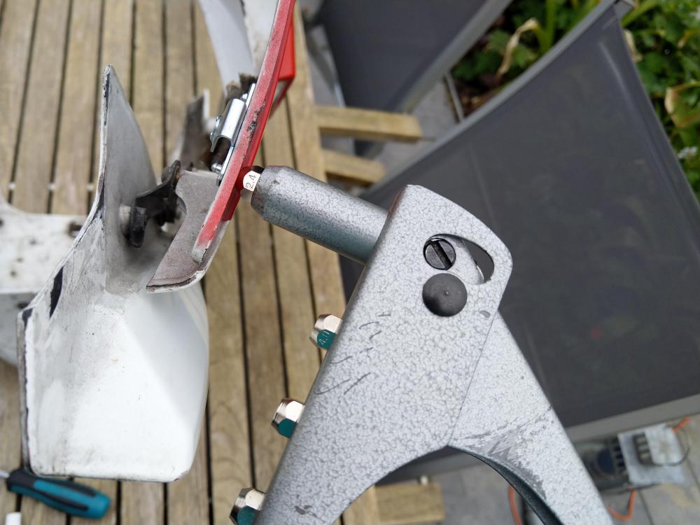

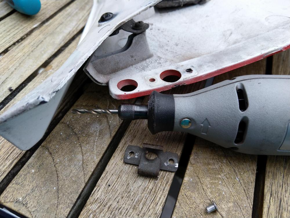

Counterbalance Posted June 11, 2019 Author Posted June 11, 2019 On 6/8/2019 at 9:02 PM, taglicious said: I would do internal matting for the lowers if you are purchasing them. Fnd the heat resistant matting (they are thinner than the rest, just make sure you measure & cut, before placing, you get one shot lol). If not used, when you paint, it will eventually bubble. I rode with mine for about a year, then the paint started bubbling near the exhaust areas. The bodies are a tad tighter than stock; some places at 1/8"-3/8's. The holes you need are located, but not pre-drilled, and some 'tabs for fitment', may need to be thinned up, or deleted for access to other parts. You sound handy enough 😉 good luck broda This is very helpful, thanks! I’ll look into the matting and talk to my painter about heat sensitivity. On my lower fairings, most attachments are riveted. Drill out and rivet in place on the new fairings the way to go there? Quote
Member Contributer Captain 80s Posted June 11, 2019 Member Contributer Posted June 11, 2019 9 hours ago, Counterbalance said: On my lower fairings, most attachments are riveted. Drill out and rivet in place on the new fairings the way to go there? Yeah, the dzus plates and lower fairing clips, just drill out and rivet on new fairings. Quote
