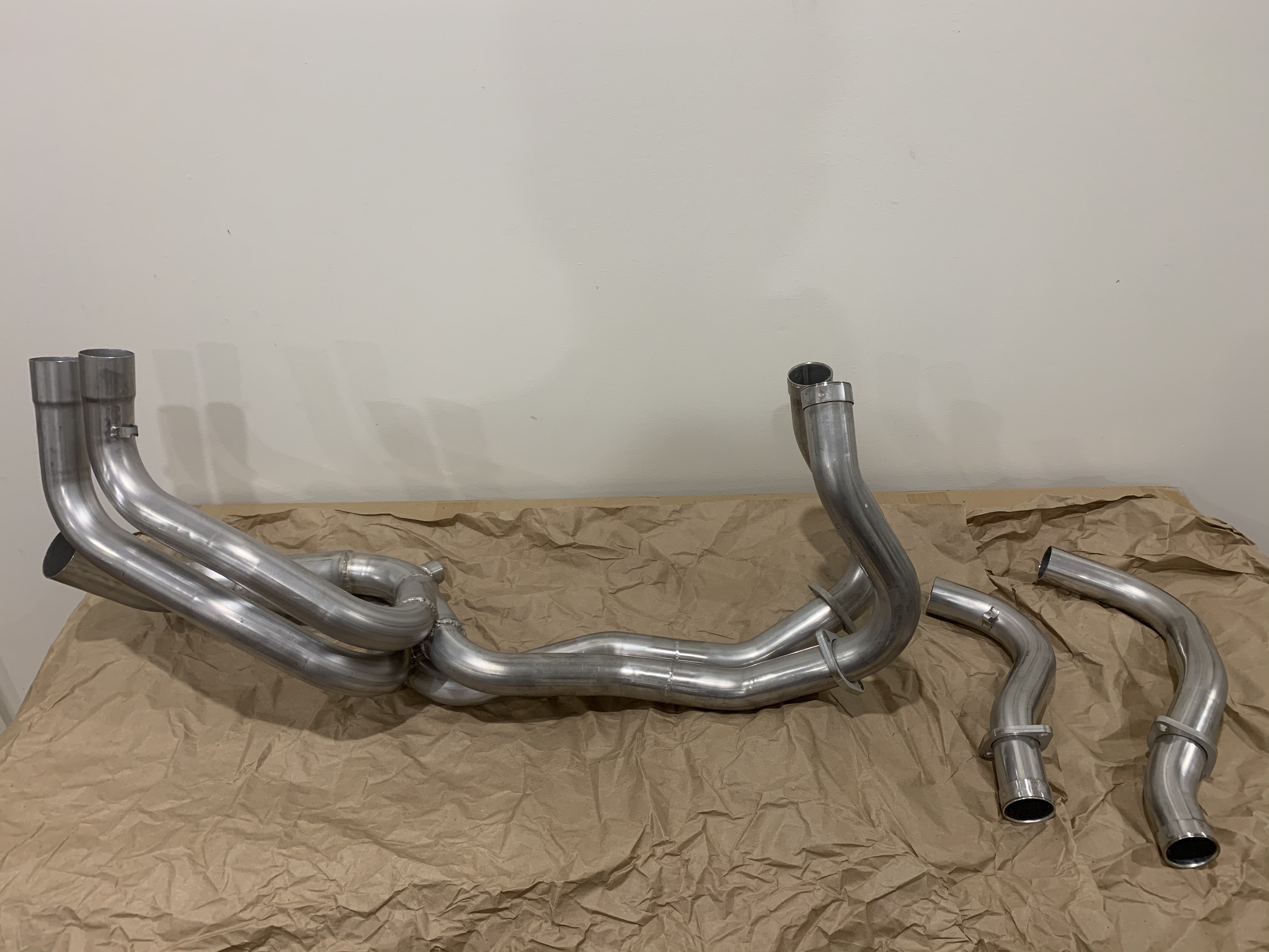

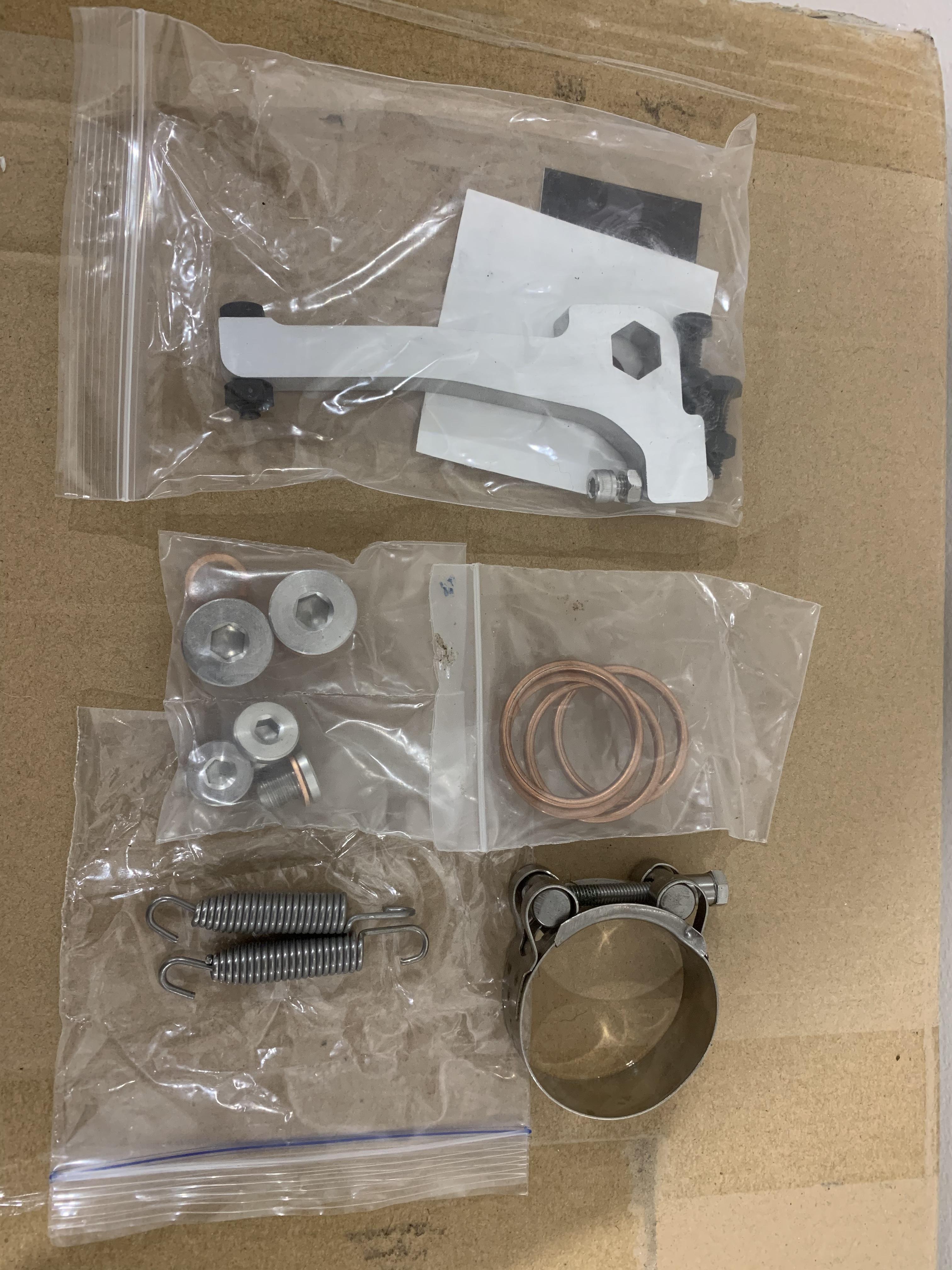

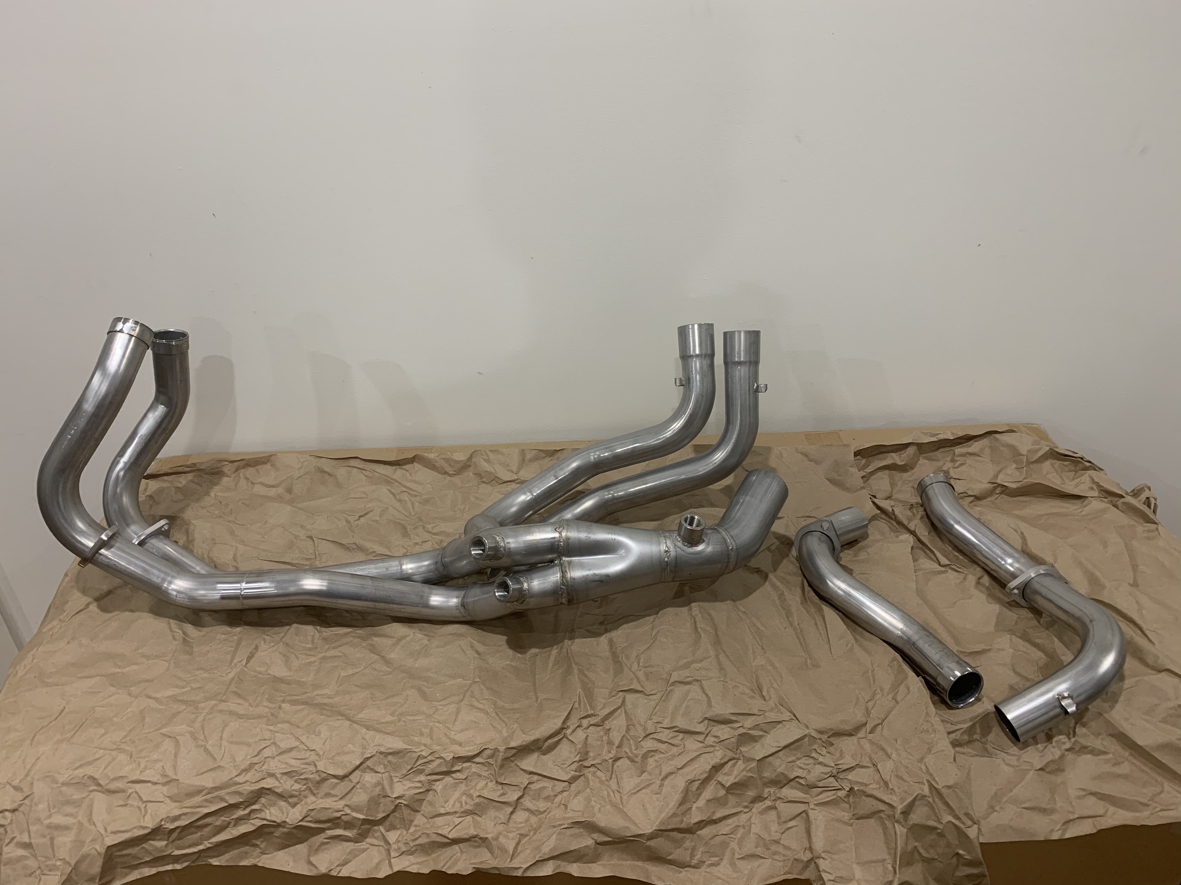

MrSquiggle Posted June 17, 2021 Posted June 17, 2021 If anyone is interested I have a brand new set of headers to suit a Gen 6 that haven’t been fitted thanks to a change in my circumstances. The headers have three ports for O2 sensors and they were passivated as part of the manufacturing. What I’m offering: New headers Exhaust gaskets (2 sets) Set of O2 port bungs and copper gaskets CNC’d centre stand stop made by Sebspeeed (https://www.vfrdiscussion.com/index.php?/forums/topic/93673-sebspeed-56th-gen-center-stand-stop/&tab=comments#comment-1108003) Power Commander 5 map to suit aftermarket air filter and Staintune end cans I’m chasing full new price for the headers, the rest I’ll include for no additional cost. These are located in Australia, but I’m happy to ship worldwide at purchaser’s cost. Please PM for more details or to make an offer. Quote

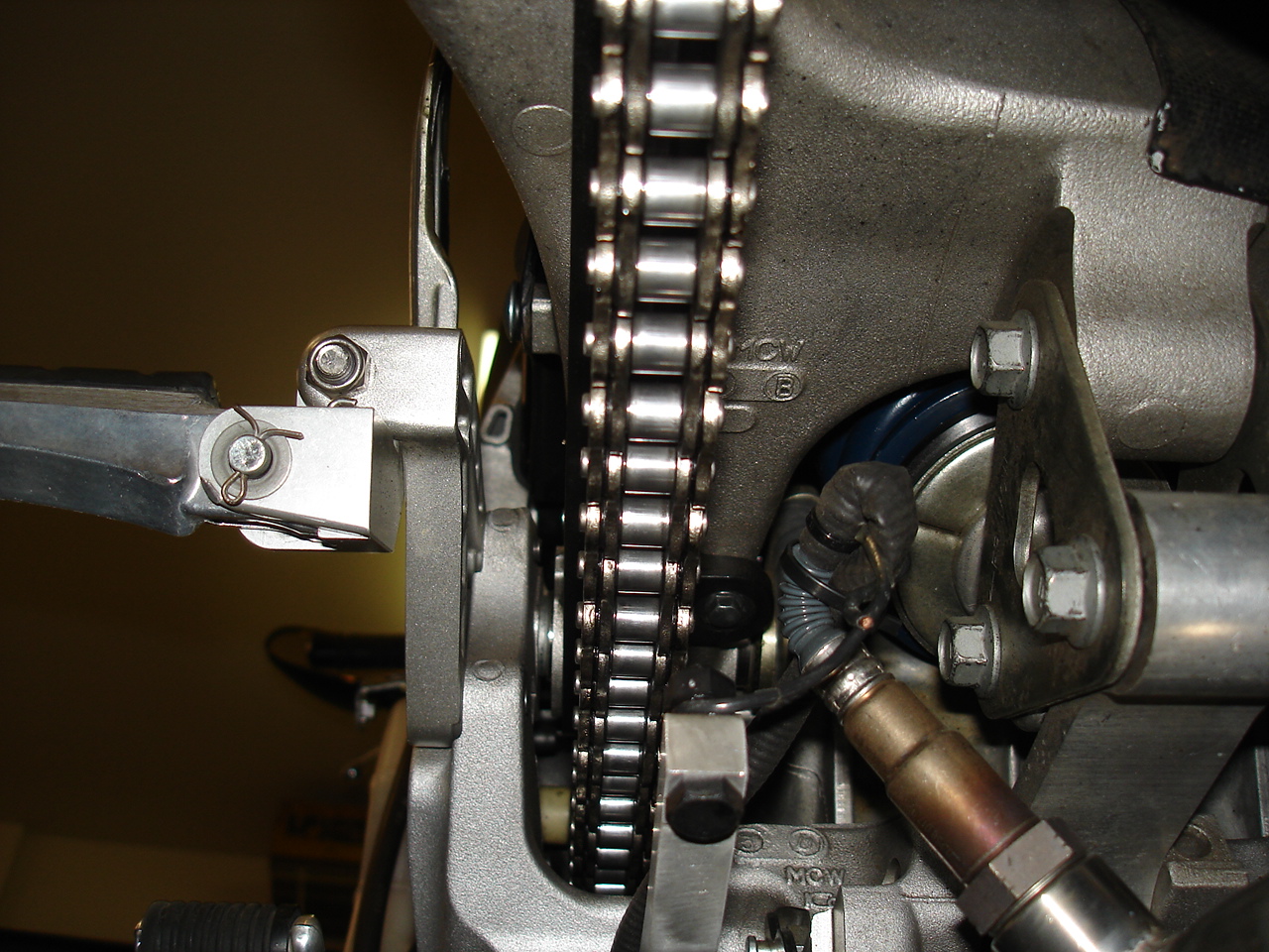

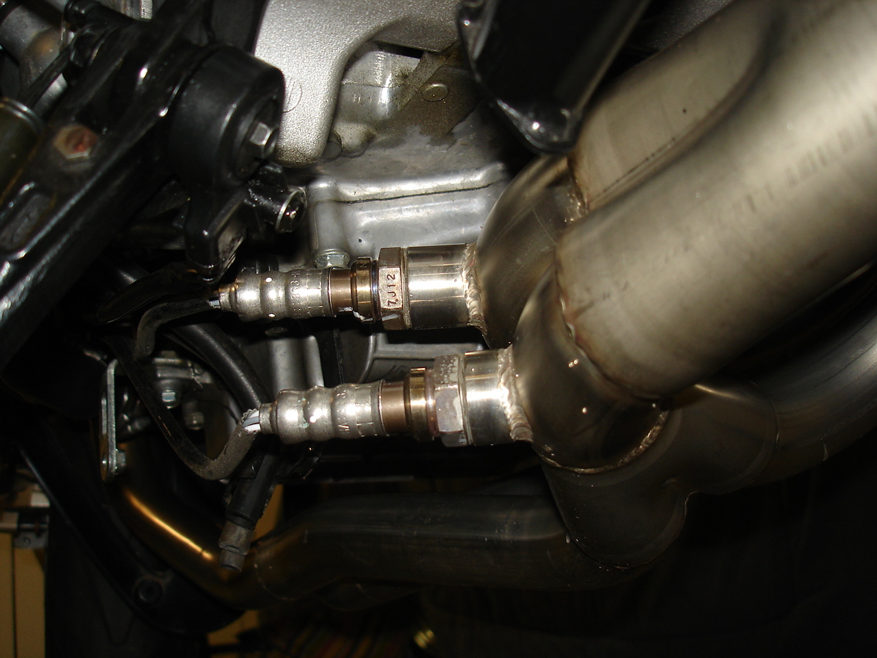

Member Contributer Cogswell Posted June 25, 2021 Member Contributer Posted June 25, 2021 On 5/29/2021 at 9:10 AM, ShipFixer said: Waiting to see how it works out for you guys before I shift to a wideband on mine 😂 Do they make sensors with right angle connectors by any chance? Gonna go look... Mr ShipFixer, I think this might be what you were waiting for. My delay in putting any miles on this with the wideband O2 has been a function of other work I was doing on it that had its own set of problems. But, finally got that resolved and now going down the road with about 100 miles on it. The first pic is of how the O2 sensor wire has survived so far. Seems fine. I think the pigtail on it would be sufficient to clear the chain, tho if I pushed it hard that way, it would just barely brush it. So, in the pic I took a piece of scrap solid core copper wire to create a stay, bolting it to Seb's center stand stop. That kept it far enough from the chain that I was not able to push to the chain over against it. For the time being it's experimental - maybe not necessary, will see. If it helps, this is not a new chain - has about 13,000 miles on it, but is well maintained. I suppose as they near end of life they could get more side to side play and potentially rub the wire - time will tell. In the other photo, I had some clearance issues with the lower OEM O2 sensor. There may be some variance from unit to unit - but in my case the O2 sensor fouled the fairing. It was significant enough that the fairing could only just barely be attached to the center stand bolt even if bent around it. (It would have eventually cracked, so that was quickly ruled out). The apparent choices were to trim the faring, find a shorter O2 sensor or trim the O2 bung. I didn't want to alter the fairing and AFAIK there are no "short" O2 sensors available, so I went the route of trimming the bung. You can see in the photo that the lower one is about 1/2 the length of the other. It took about 1/2 hour with a Dremel cutoff wheel and then a file to clean up the face of it and make sure it was square with the centerline of the bung. It seems to work fine. Others may not have this issue - YMMV. Anyway - with the MTB now the AFR target can be controlled and the module will adjust fueling to it on the fly. There's no way of separating the effects of the headers from the RB/MTB module, but my seat of the pants dyno tells me that the mid range of about 5,500 to 9,000 revs is more responsive and fun to ride. IIRC when Yaman remoted in and looked over the tune, I could see that there was some ignition advance dialed in through that range (I need to go back in and spend more time looking it over, but at this point I just want to ride and enjoy it) so that could be another piece of the puzzle. Past about 10,000 it looked like a degree of timing was backed out. At low throttle settings it was set to a target 13.5 AFR for fuel economy and higher throttle settings to 12. That intuitively seems like a good compromise. Regardless, it runs great - very happy with it. Anyway, it's been a long journey time will tell how durable it all is as some miles add up on it. Cheers 2 Quote
