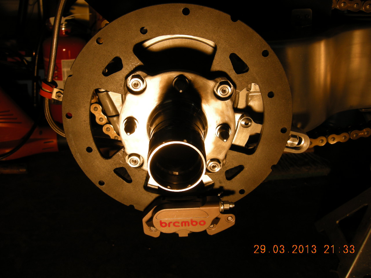

Member Contributer BusyLittleShop Posted February 15, 2018 Member Contributer Posted February 15, 2018 On the street I employ both the fronts and the rear In an effort to squat the weight transfer whereas on the track I only concentrate on the fronts... Light weight Ceramic Matrix Composite rotors $2,500 a set Light weight Ceramic Matrix Composite rotor off a Ducati $500 used $1,500 new... Quote

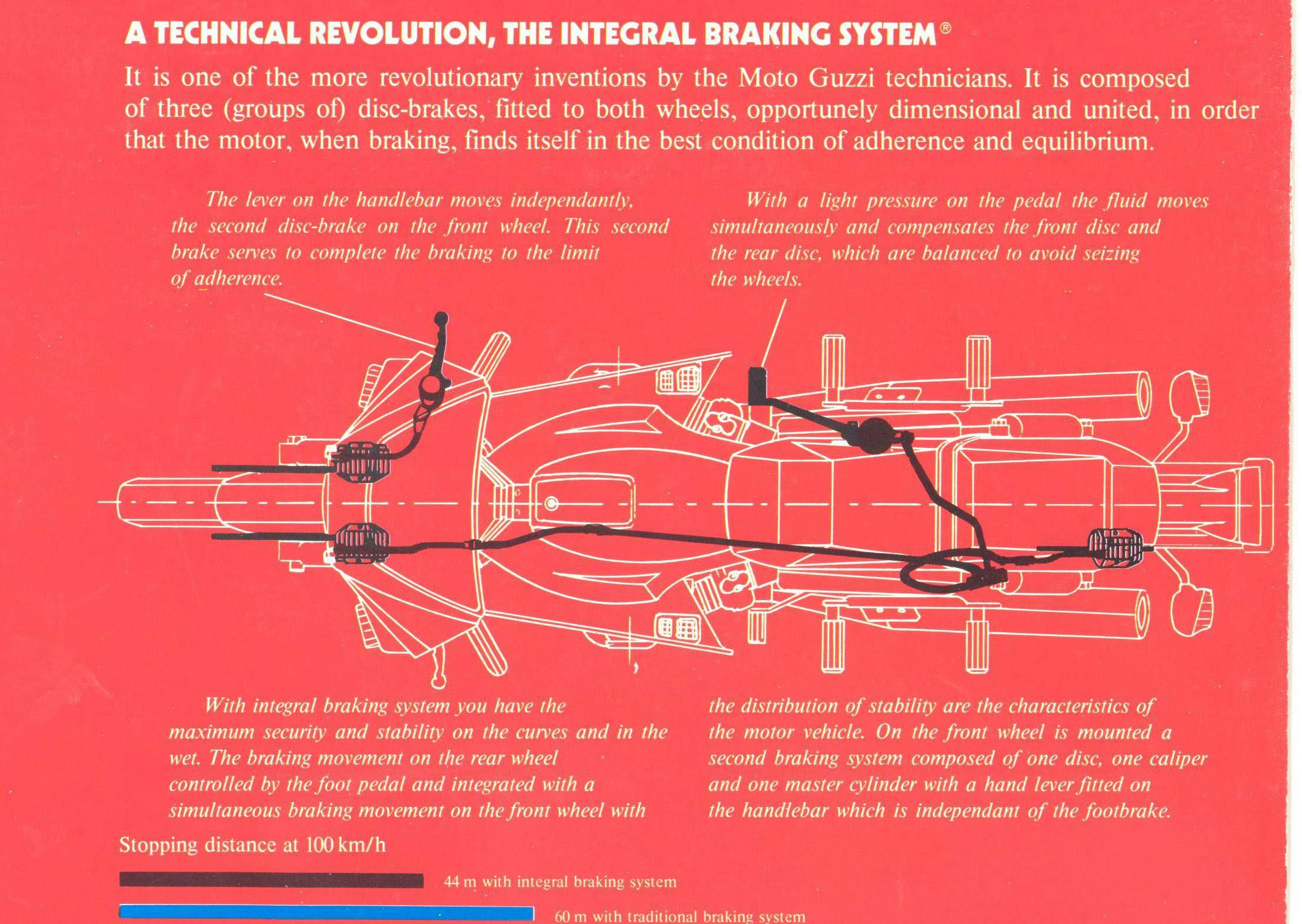

timmythecop Posted April 3, 2018 Posted April 3, 2018 Both my bikes have linked brakes. My work bike, a 1300 pound Harley, I used always on, but modulated back only for cone course and both brakes every other time. For not linked sportbikes, I used the back to continue braking when I needed to ease off the forks being so compressed. Guzzi's way of doing it: Quote
