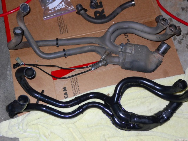

Member Contributer vfr350 Posted April 5, 2014 Member Contributer Posted April 5, 2014 Gutted works, something looks fishy how the cut vs weld was made. Someone got it right 2nd time round eh? Quote
Member Contributer Switchblade Posted April 5, 2014 Member Contributer Posted April 5, 2014 Any video of said gutted collector ? Quote
Member Contributer Rush2112 Posted April 5, 2014 Member Contributer Posted April 5, 2014 Nice DIY job... looks good. No offense, but that cat chamber was designed to maximize catalyst surface area as the exhaust passes through the honeycomb not efficiently usher exhaust gases out when the chamber is empty. That in conjuction with the larger diameter exhaust runners that BR pointed out makes a 98-99 header more of a performance upgrade than a gutted cat chamber on a later model Sent from my SCH-I200 using Tapatalk Quote

Member Contributer vfr350 Posted April 8, 2014 Member Contributer Posted April 8, 2014 So you are saying the gutted system is worse off by collector design? Quote

Member Contributer Rush2112 Posted April 8, 2014 Member Contributer Posted April 8, 2014 (edited) So you are saying the gutted system is worse off by collector design? What I'm saying is a cat-less '98 - '99 exhaust header is a better performance mod than a gutted cat system. The empty cat chamber is not designed or shaped as an efficient "Y" collector pipe and the empty chamber will have turbulent gas flow because of that. Because of the shoulder, or squareness, of the chamber it can even develop a resonance with a reflected wave that could reduce exhaust scavenging effect at certain rpms. The tubes of the catalyst honeycomb would direct gas flow and prevent this in normal operation. The 2 into 1 collector on the '98 - '99 exhaust header has a more efficient "Y" shape design and the exhaust pipe runners exiting the motor have a 3mm larger diameter than the stainless cat systems and flow exhaust better at higher rpms. The stainless cat systems uses the smaller diameter pipes to increase exhaust gas velocity to get hotter exhaust gases to the catalytic converter quicker to heat up the catalyst surface and reduce emissions. The sacrifice with this is more back pressure and reduced exhaust gas volume flow at higher rpms when compared with the '98 - '99 exhaust header. Sand blast the headers with aluminum oxide, not glass bead because the silicates left behind can interfere with ceramic adhesion, and ceramic coat and corrosion is a non-issue. The whole thing cost me less than $150 including buying the headers. Edited April 8, 2014 by Rush2112 Quote
