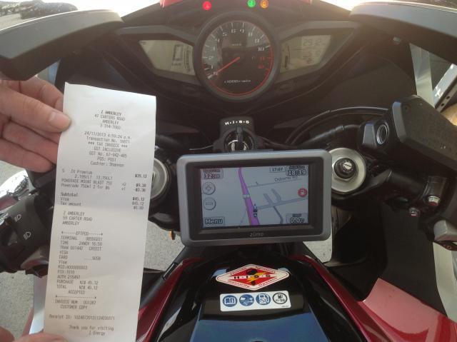

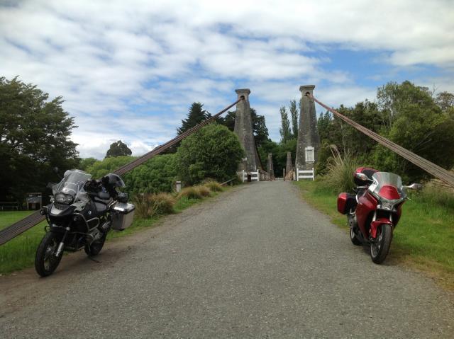

LoopRider Posted December 15, 2013 Posted December 15, 2013 Thanks! Here in South Africa a bigger tank is not really necessary as all our fuel garages are within 200 km of each other. Just annoying to stop so often. In NZ it is rare to have go even that far between fuel stops, but I am with you, who wants all their stops to be at fuel stations and not other places. Here is my approach, get a small, light plastic siphon and travel with guys with the bikes that have uber large tanks ... Then you can easily risk doing 290 kms and laugh at the servo that you were nearly out of gas ... BMW adventure bikes with the big 33 litre tanks are best ... Buy them one free tank load at the start of the trip and they might stay with you for 4000 kms .... Awesome insurance ... Quote

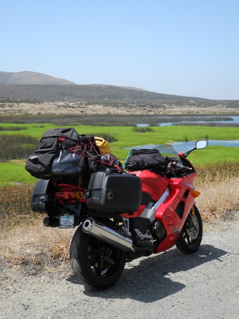

Member Contributer BonusVFR Posted December 16, 2013 Member Contributer Posted December 16, 2013 Is there a way to rig a small bottle/canister under the left bag similar to what I have done on my 5th gen here? This one liter bottle is my emergency and stove fuel. Out West in the USA, tank range is a big deal sometimes and several times I have been faced with 200 miles between petrol stops. I always carry a siphon hose as well and usually ride with ST oil tanker bikes. 1 Quote

DangerousDave Posted December 17, 2013 Posted December 17, 2013 Is there a way to rig a small bottle/canister under the left bag similar to what I have done on my 5th gen here? This one liter bottle is my emergency and stove fuel. I'd like to see a couple better pics of your mount there myself. I also carry a 1 liter aluminum can full of fuel when I'm traveling, but it takes up valuable luggage space. That's a right clever idea. 1 Quote

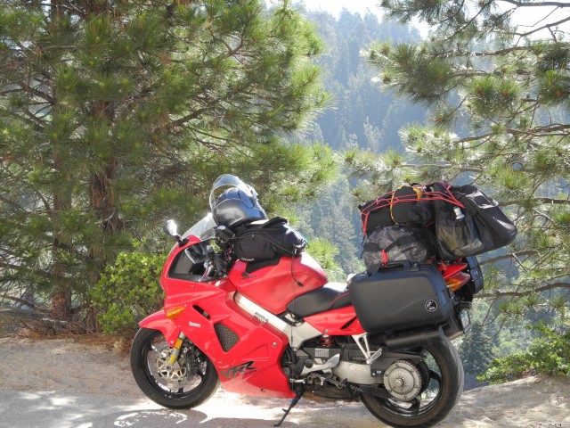

Member Contributer BonusVFR Posted December 17, 2013 Member Contributer Posted December 17, 2013 DD ...here is another shot of the "Tool Tube". I think I got these at a hardware store but they are available from Twisted Throttle. http://www.twistedthrottle.com/twisted-throttle-tool-tube-w-mounting-kit . The one liter MSR bottle fits perfectly. I mount them on my SW Motech racks.....there was not enough room to put them inside the racks. I see that I have another flask in one of my bags but that is for me not the bike. 1 Quote

DangerousDave Posted December 18, 2013 Posted December 18, 2013 DD ...here is another shot of the "Tool Tube". I think I got these at a hardware store but they are available from Twisted Throttle. http://www.twistedthrottle.com/twisted-throttle-tool-tube-w-mounting-kit . The one liter MSR bottle fits perfectly. I mount them on my SW Motech racks.....there was not enough room to put them inside the racks. Nice! I already have that exact MSR bottle. That's what I normally carry *in* the luggage. I like that. I think I might have to get one of those. 1 Quote
