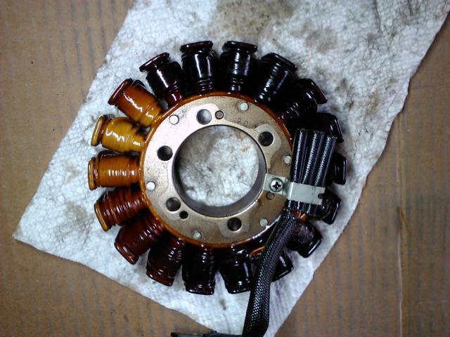

spud786 Posted March 23, 2013 Posted March 23, 2013 (edited) I've seen some oem suzuki stators fail at 5 or 10,000 miles Like the vstrom, thats pretty pathetic. I tracked the DRZ stator failures nationwide, offroad it was about 10,000 mile average life, mainly street, average about 20,000 mile. Many did the after market thing, only to redo it later, same here on vfrd, although we've had a lag of aftermarket stator issues here, allowing this avenue of replacement to creep back in with high regard. Im on my second vfr oem stator first one 56,000 miles, second one is now over 45,000 miles, that seems pretty good consistant track record, if you ask me. If the gary's can do post 50,000 miles then maybe its a decent aftermarket, Im just going off other aftermarket stator history. On a side note, what ever produces the results long term, is what Im intererested. I use the history of the results , and on the vfr the oem stator produces the best output, and longest life, and direct fit doent hurt either when you need to get it done without complications. My wiring has not seen the damage others have, and that damage might have actually accelerated their stators demise. Edited March 23, 2013 by spud786 Quote

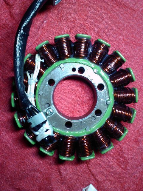

sudo Posted March 31, 2013 Posted March 31, 2013 I finally got my stator back from Gary last week. Total turnaround time including shipping both ways was 15 days. Strangely, he still hasn't cashed the personal check that I sent along with my stator.The stator looks good. I asked him to upgrade the windings and cable. They do look like they're a thicker gauge than the OEM stator. Gary replaced the rubber grommets and plug too, which I hadn't expected. I slapped it into my '02 yesterday and she runs fine. It feels good to be riding again. Quote
NakedViffer Posted March 31, 2013 Posted March 31, 2013 (edited) I finally got my stator back from Gary last week. Total turnaround time including shipping both ways was 15 days. Strangely, he still hasn't cashed the personal check that I sent along with my stator. The stator looks good. I asked him to upgrade the windings and cable. They do look like they're a thicker gauge than the OEM stator. Gary replaced the rubber grommets and plug too, which I hadn't expected. I slapped it into my '02 yesterday and she runs fine. It feels good to be riding again. He runs a business, he probably does check cashing at a specific time. Whats the ballpark of getting this done? I've got two used OE stators and I trust neither. I really thought one was upgraded, but i pulled it from the old motor and it turned out to be a stocker. Edited March 31, 2013 by NakedViffer Quote
spud786 Posted March 31, 2013 Posted March 31, 2013 (edited) sudo, on 31 Mar 2013 - 10:52, said: I finally got my stator back from Gary last week. Total turnaround time including shipping both ways was 15 days. Strangely, he still hasn't cashed the personal check that I sent along with my stator. The stator looks good. I asked him to upgrade the windings and cable. They do look like they're a thicker gauge than the OEM stator. Gary replaced the rubber grommets and plug too, which I hadn't expected. I slapped it into my '02 yesterday and she runs fine. It feels good to be riding again. HOw can you tell the oem is an opaque coating, if they were actually heavier wiring, it would produce a differnt output anyway, from what ive seen posted numbers wise, its shy of the oem output but still usable. Id like to see them go 50,000 miles, then maybe its comparable to oem. While a few have posted their vfr oem hasnt made it past 20 or 30,000 miles that below average, Both of mine have gone well over 50,000, and the last one still going. So thats the bar to beat. IMO the whole issue with stator life is the coating degrade not the wiring Edited March 31, 2013 by spud786 Quote
Member Contributer YoshiHNS Posted March 31, 2013 Member Contributer Posted March 31, 2013 Looks good! The windings seem to be done with more care than the OEMs. Quote
