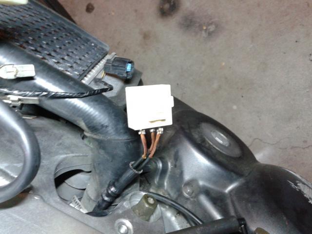

sudo Posted February 11, 2015 Posted February 11, 2015 I noticed that my battery has been a bit weak lately, so I figured it was time for a new battery. While I was charging up a new battery, I took the opportunity to inspect my wiring. To my surprise, I found that an inch of insulation had melted off each wire on the stator side of the connector to the R/R. It seems that the insulation on the rewound stators don't cope with heat very well. I'm going to chop off the connector and solder the wires together tomorrow. Quote

Member Contributer CornerCarver Posted May 25, 2015 Member Contributer Posted May 25, 2015 I noticed that my battery has been a bit weak lately, so I figured it was time for a new battery. While I was charging up a new battery, I took the opportunity to inspect my wiring. To my surprise, I found that an inch of insulation had melted off each wire on the stator side of the connector to the R/R. It seems that the insulation on the rewound stators don't cope with heat very well. I'm going to chop off the connector and solder the wires together tomorrow. WOW...did you notice the arcing between leads while running the bike? I would think it would look like a light show in that area while the bike was above 5k rpm. Quote
