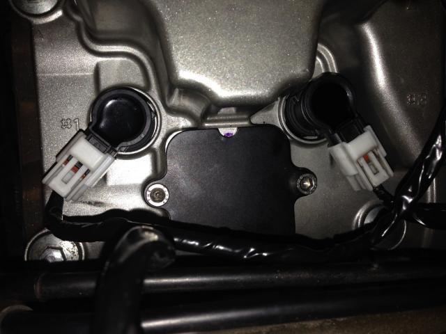

Member Contributer gig Posted February 9, 2015 Member Contributer Posted February 9, 2015 2008 CBR1000 COP's and harness, 1.4 lbs lighter, much cleaner, -4 coils hanging all over the bike. Thanks Rush and Mohawk for the assistance 2 Quote

BiKenG Posted March 1, 2016 Posted March 1, 2016 Old topic I know, but in discussing the merits or otherwise of CoP vs normal coils, no-one mentioned ignition interference suppression. This is a very big deal and manufacturers put a lot of effort into passing the strict regulations. Resistive plugs were a BIG improvement, but stuffing the coil right on top of the plug has to offer the best improvement of all. I doubt performance or even emissions really has anything to do with it. Ignition suppression is probably the biggest factor, but packaging now plays a very big part in vehicular design. Just trying to cram everything into the available space can be tricky and with bikes they need to be able to place everything for optimum weight distribution. CoPs are simply better at all these. Whether it's worth doing on an older bike is just down to personal preference. I like the idea of freeing up some space and saving a bit of weight. As long as they work correctly it'll make bugger all difference to the performance though. 1 Quote
BiKenG Posted March 2, 2016 Posted March 2, 2016 2008 CBR1000 COP's and harness, 1.4 lbs lighter, much cleaner, -4 coils hanging all over the bike. Thanks Rush and Mohawk for the assistance Can anyone confirm how the later CBR CoPs fit to a 5th Gen? I tried VFR1200, but they seemed too short. The CBR1000RR4-7 Cops will fit, but slightly long. The above picture looks perfect, but hard to tell and as far as I can see looking at pictures, the later CBR ones (RR8->) look very like the VFR1200's, but impossible to confirm either way as I don't have any on hand to check. Well I do, but they're on the bike and even without fairings, they're a ba****d to get to. Anyone have an RR8-> CoP they could measure? Quote
