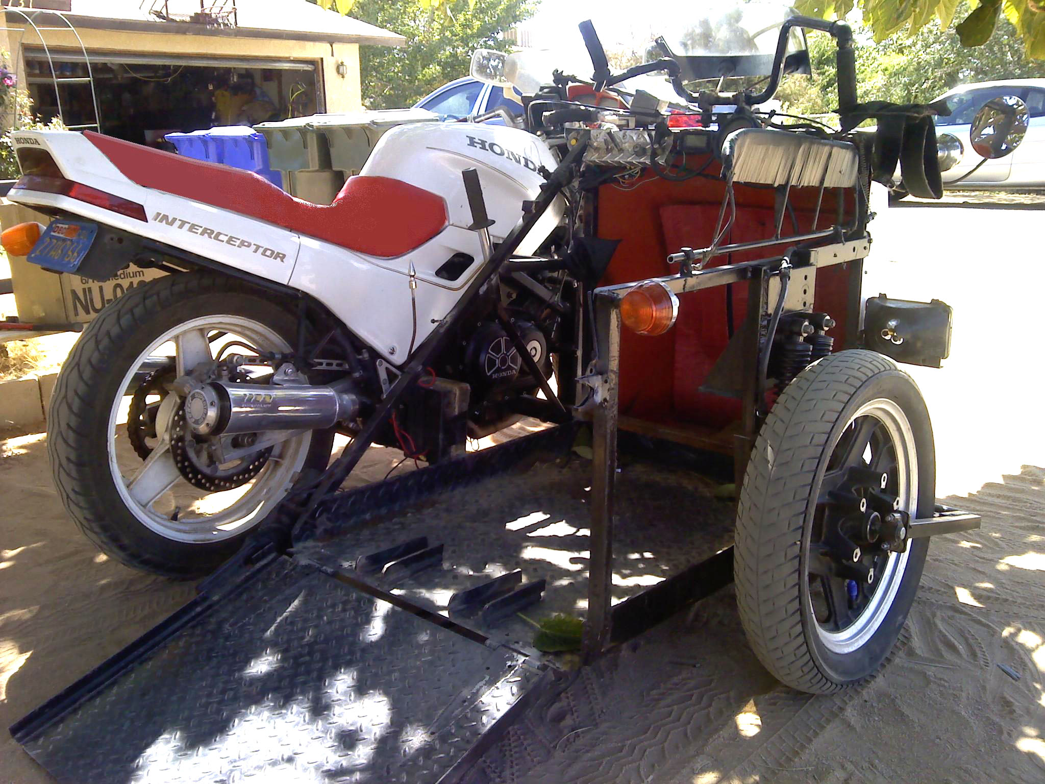

Guest sjsartwork Posted July 31, 2010 Posted July 31, 2010 (edited) hey vfr lovers...heres a link to my very first test ride today....im a quadriplegic thats crazy enough to have attached my sidecar to a nice 86 vfr 700.....it took some unique frame adaptations of myown design and i even did much of the welding myself.man this things gonna be NUTS!!! I didn't get to crazy in the vid.Im still testing everything out for safety. anyways guys heres the link...pass it on and remember, where theres a will...theres a way. Edited August 2, 2010 by sjsartwork Quote

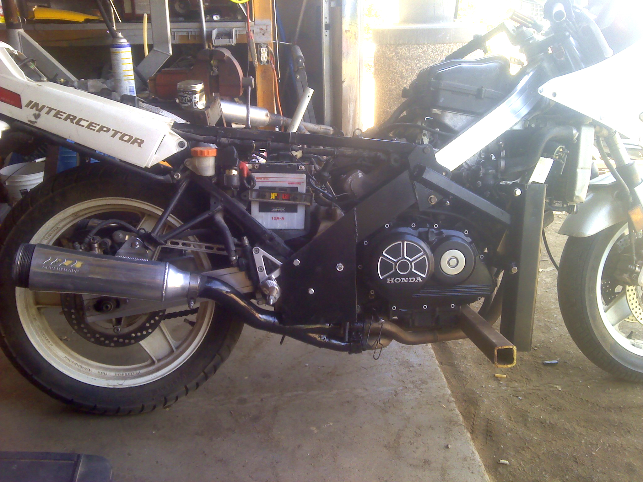

Guest sjsartwork Posted August 2, 2010 Posted August 2, 2010 as far as engineering...the trickyest part was a strong mount to the bike...so after a-lot of thought first,i decide to encase the aluminum frame with steel basically on both sides of the bike....each side has 7 strong bolt to motor/frame points then each sides steel frame is welded to the major cross bar. i feel like i built everything stronger and heavier than need, but i wanted it to be safe and trustworthy. Quote

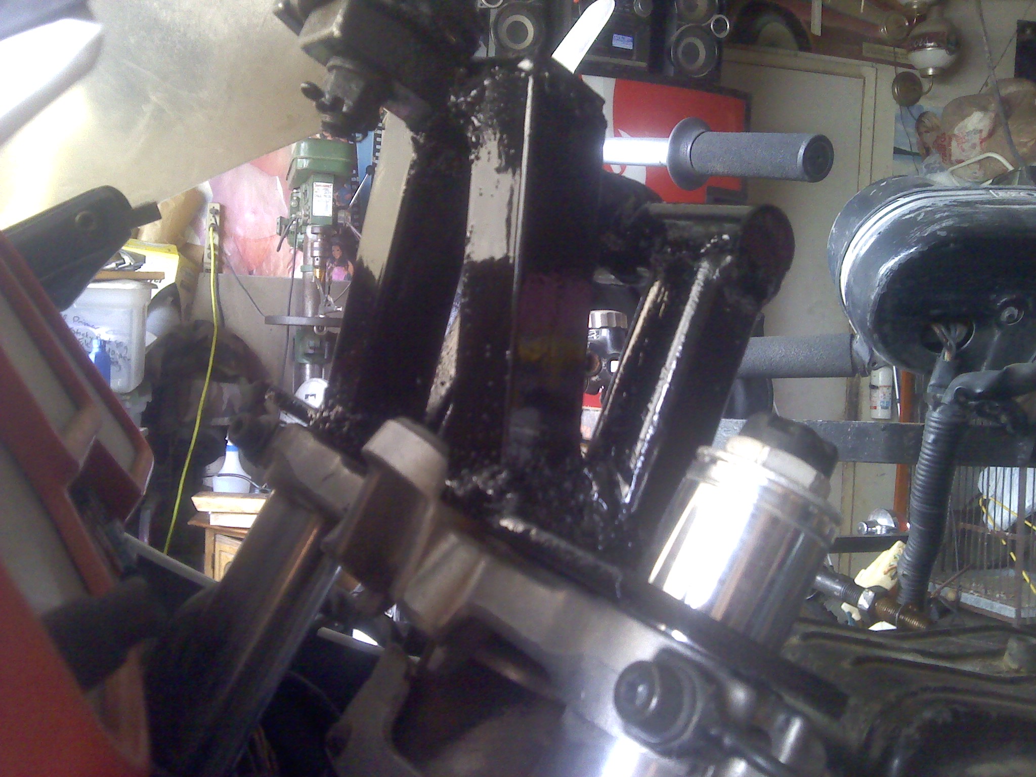

Guest sjsartwork Posted August 2, 2010 Posted August 2, 2010 (edited) i made an outrigger on top of the forks for steering...it ties in to the sidecar handle bars with a tierod... For throttle i had to make an elbow throttle plate to gas it... Edited September 2, 2010 by sjsartwork Quote
Member Contributer Ripper Posted August 2, 2010 Member Contributer Posted August 2, 2010 Awesome... That's the kind of stuff that gives people hope, anyone can do anything no matter what! Is the turning radius enough to make a tight right hand turn? Quote
Member Contributer rdguy Posted August 2, 2010 Member Contributer Posted August 2, 2010 Oh man I wish you had taken pictures along the way and posted it as a project I would have loved to see how you developed it along the way. That is awsome! I hope it works and you can ride it safely. :goofy: When you get the time, could you let us know how you've set up braking and shifting from the sidecar? More pics are always good, too. Last year at Friday 13th, I saw a 1 front/2 rear trike with a totally flat floor and a scooter powerplant powering the right rear wheel. Very slick, but lacking the VFR exhaust note. :fing02: I'm just getting a disabled parking pass for my dad, and found out that the Province of Ontario will issue disabled stickers for motorcycle license plates. I wonder what kind of reaction THAT gets from passersby. Glenn Quote

Member Contributer rdguy Posted August 3, 2010 Member Contributer Posted August 3, 2010 ....i've been hittin a lever with my left hand but found out theres no way to shift with my left hand...cause when i let off the throttle theres too much engine breaking to allow shifts.....SOO ...back to the drawing board.... <snipped> .....im keepin my fingers crossed on that one(even if i do have to duct tape them that way) ....this whole ride depends on that working out...im gonna start fabing up a design tomorrow. That's the way I like to do it - the first cut at something is just there to let me know what I overlooked... Kewl stuff. Keep at it, and let us know how it goes. PS: I'm curious about your handle. What sort of artwork? Glenn Quote

Member Contributer alwaysaware Posted August 5, 2010 Member Contributer Posted August 5, 2010 Thats awesome the way that you set it up to steer from the side car. Can you still have a passenger ride on the regular seat? If you have kids, it would be worth a million bucks to see the reaction of people as a child rides by them with an adult in the sidecar. Great work. :laughing6-hehe: Quote
Member Contributer VF1000RS Posted August 5, 2010 Member Contributer Posted August 5, 2010 Very cool. Maybe you can setup an electronic quickshifter wired to a large rocker or toggle switch or joystick switch to trigger with your left hand? Might help with shifting? Quote
Member Contributer gll429 Posted August 8, 2010 Member Contributer Posted August 8, 2010 COOL...the elbow throttle worked out pretty good. after some simple wiring and tieing up some loose ends, this thing will be roaring down the road finally. what about a 4 wheeler thumb throttle? a trigger throttle? a jet plane style "T" throttle? find one with a thumb button for the clutch and add a lever for the brakes :biggrin: Quote
