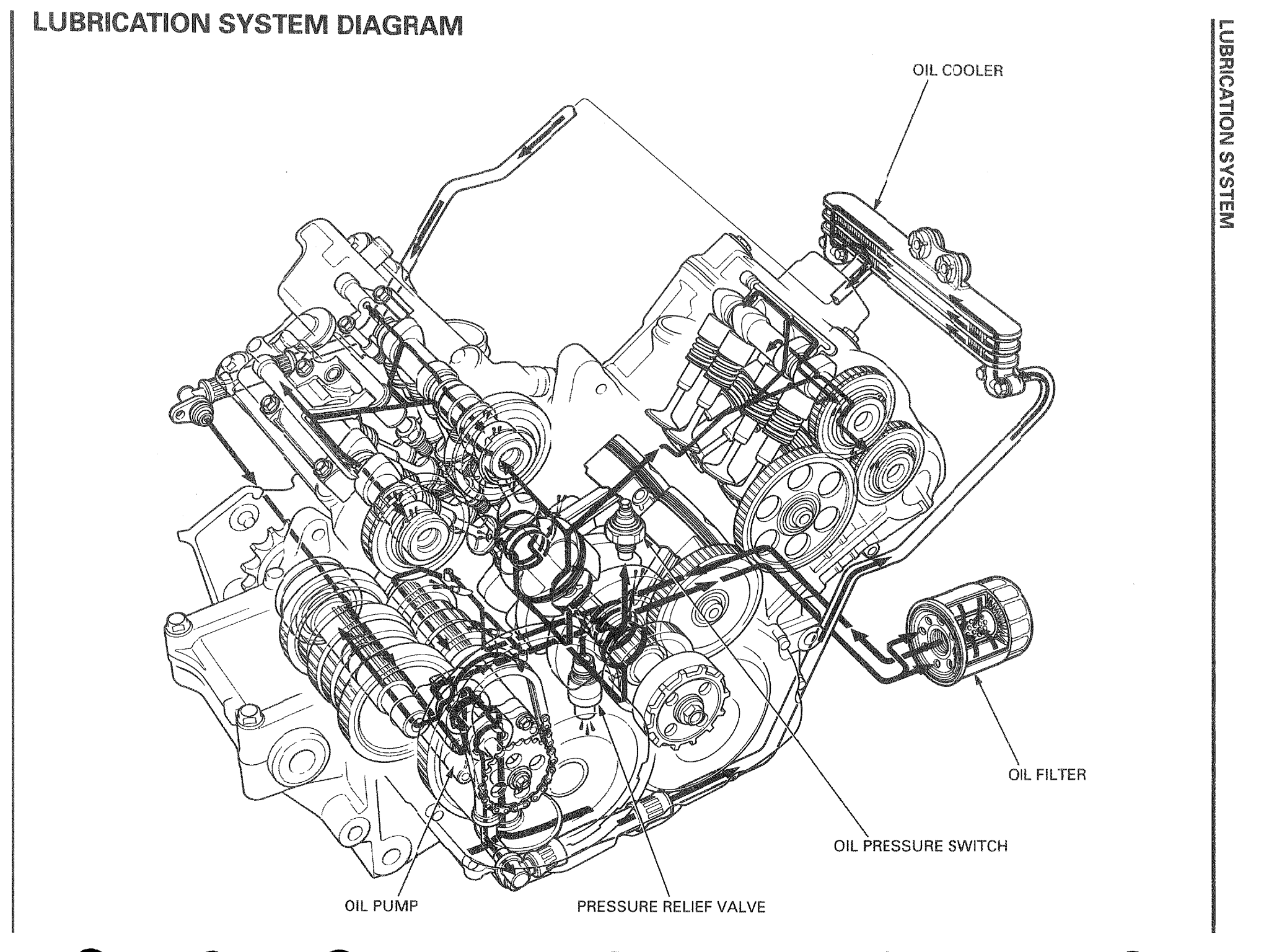

Member Contributer Stray Posted July 11, 2020 Member Contributer Posted July 11, 2020 Out of interest, does anyone know which way round the oil flows on a VFR 800? Does it flow into the right side of the cooler (throttle side), or into the left (clutch side)? Also, does anyone know how much air gets trapped in the cooler? I’ve been reading about air hampering a cooler’s effectiveness if the fittings are at the bottom. Fittings on the top help fight this but pain in the arse to drain oil for a service. Got a 5 row RC51 cooler on my 5th gen and it works fine. Was wondering if part of it was full of air. Made a different mounting bracket to centralise it in the frame. Just curious on the above, really. Stray Quote
Member Contributer Grum Posted July 11, 2020 Member Contributer Posted July 11, 2020 1 hour ago, Stray said: Out of interest, does anyone know which way round the oil flows on a VFR 800? Does it flow into the right side of the cooler (throttle side), or into the left (clutch side)? Into R/H side. Out of L/H side. 1 Quote
Member Contributer Stray Posted July 14, 2020 Member Contributer Posted July 14, 2020 Thank you Grum - that’s brilliant! Same as coolant flow: right to left. Quote
