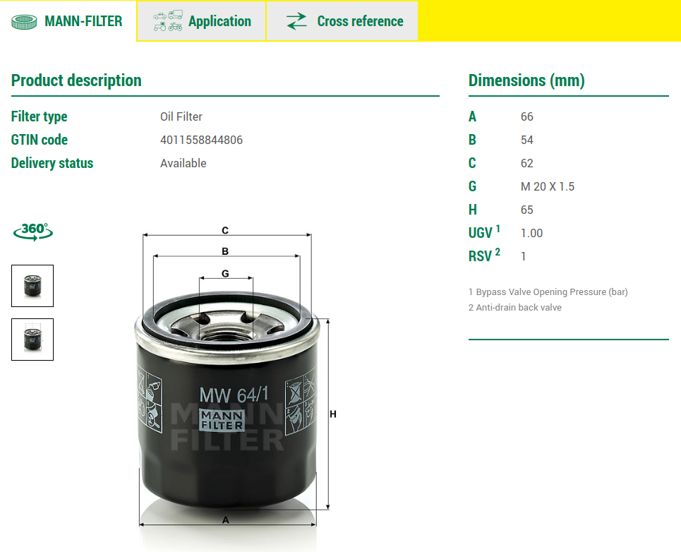

Desmo Posted March 26, 2023 Posted March 26, 2023 MANN recomends this trough their catalouge: MW 64/1 Quote
