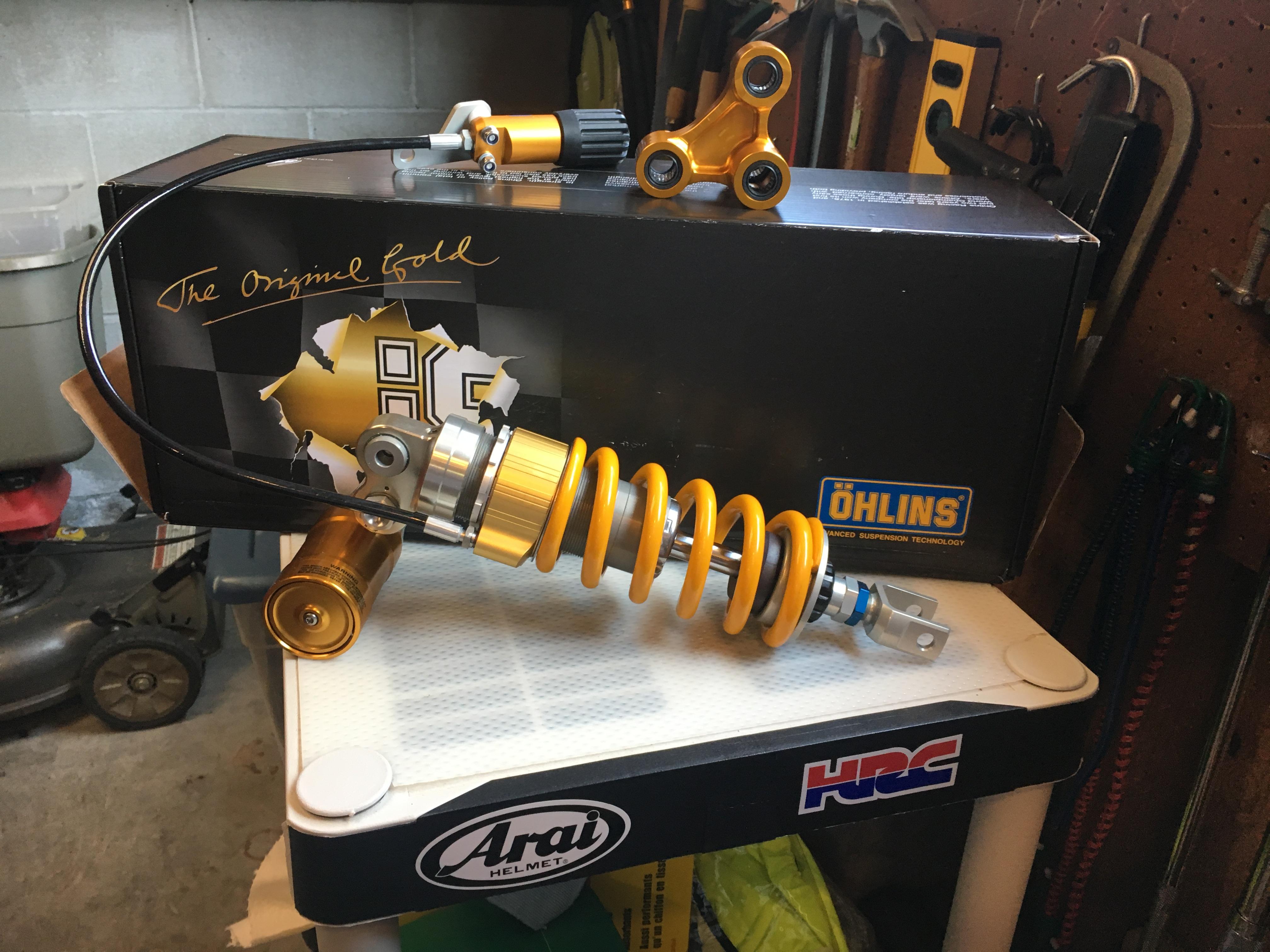

Member Contributer RC36Rider Posted June 1, 2017 Member Contributer Posted June 1, 2017 3 minutes ago, Misterbish said: Thanks for confirming the fitment. You are welcome. One thing that might give you grief, though is the remote preload hose and knob. I'm not positive that they are routed to the same side and of similar lengths. The Bird's shock is a confirmed OK fit on the 6th Gen. Quote
Misterbish Posted June 1, 2017 Posted June 1, 2017 Hi Yeh i did wander about the remote preload, i found the info with the Blackbird rear shock off this site, here's hoping it will be an improvement in the handling being 2 up with luggage(very light front end), if not i will source a VFR1200 rear shock and try that, for some reason VFR1200 shocks can be had for a lot cheaper than a half decent Blackbird shock. Quote
