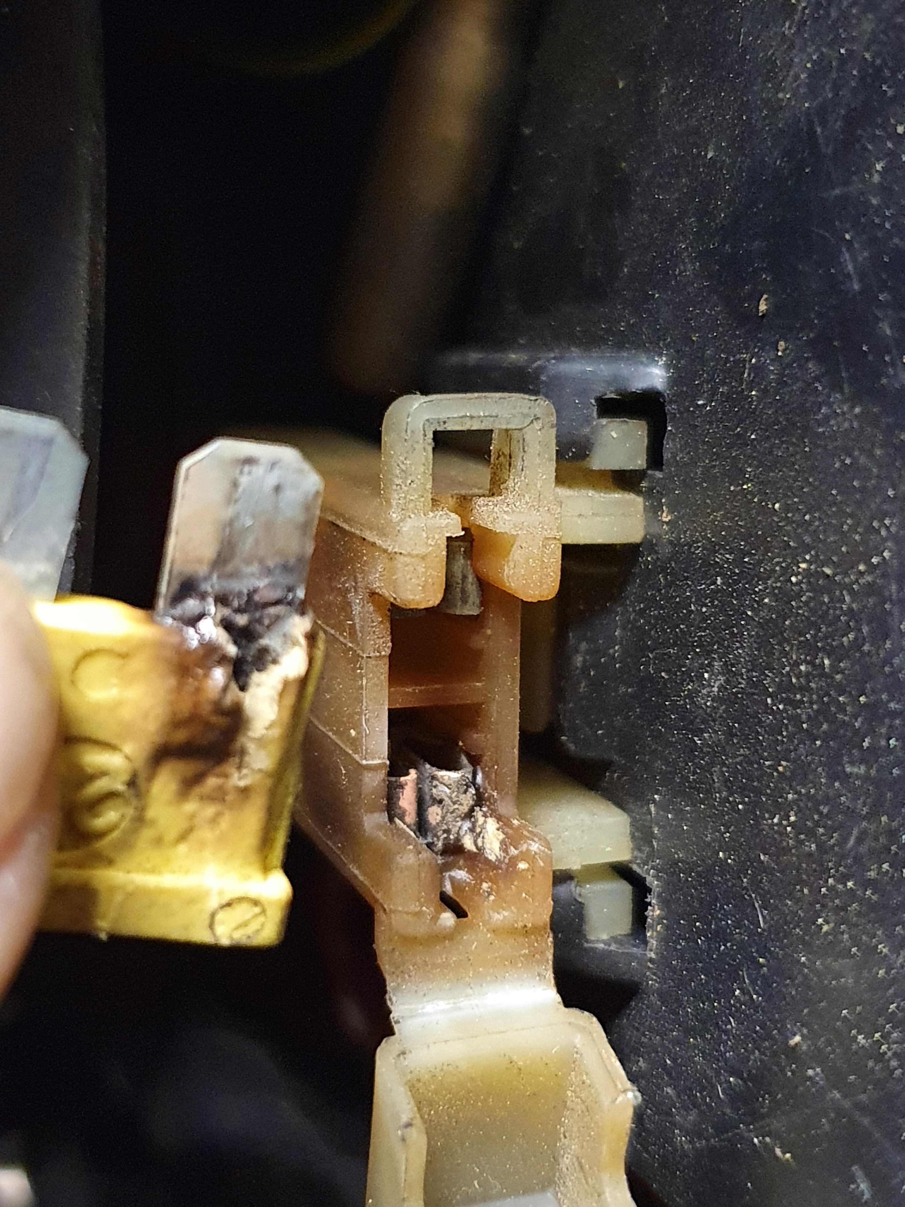

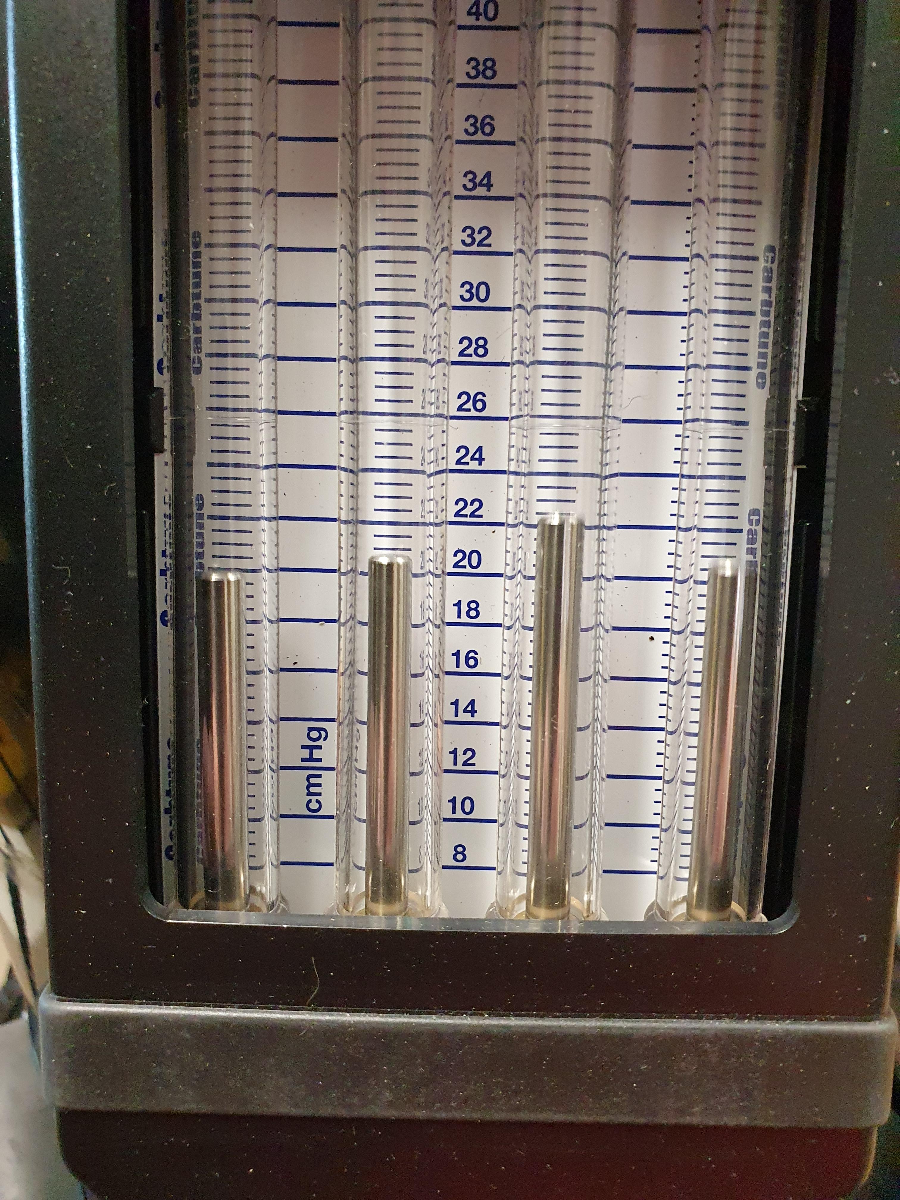

Member Contributer Bren Posted April 10, 2023 Member Contributer Posted April 10, 2023 I would in order; Check tank for rust, 7 years is a long time to be standing. Check, clean (if K&N) or replace the air filter. Check the starter relay and other connections in that area for crispiness or overheating. Check main ground, right side of bike behind the rear fairing level with the battery box - clean and tight. Check battery connections are tight and the battery is good, get a load test done even if new. Balance the starter valves, your symptoms sound like they need doing A can of injector cleaner, may or may not help. It could just be that it needs to have a few tanks run through it to wake it up again. Good luck 👍 Quote

Member Contributer interceptor69 Posted April 11, 2023 Member Contributer Posted April 11, 2023 As an aside I guess I didn't realize the starter valves had anything to do with normal running. I thought they only affected start up. Mine have never been checked/adjusted since 1998. Quote
Member Contributer Grum Posted April 11, 2023 Member Contributer Posted April 11, 2023 With only 9,500 miles on a 23 year old bike probably means a lot of quiet times. This could cause injectors to gum up along with some nasty condensation build up within the tank. If after running a couple of tankfuls with high quality fuel injector additive doesn't work, then it would be a good investment to have the injectors professionally cleaned and flow balanced. For info, the Starter Valves on a 5gen are not set equally. Cylinder 1 = Reference, non adjustable. Cylinder 2 = Matched to 1. Cylinder 3 = 20mmHg More than 1. Cylinder 4 = 10mmHg More than 1. Wouldn't hesitate in fitting some new Iridium Plugs - NGK CR9EHIX-9. Plugs can certainly cause the symptoms like you're having. Good luck. Quote
Member Contributer Grum Posted April 11, 2023 Member Contributer Posted April 11, 2023 5 hours ago, interceptor69 said: As an aside I guess I didn't realize the starter valves had anything to do with normal running. I thought they only affected start up. Mine have never been checked/adjusted since 1998. Agree, set for optimum idle and small throttle opening smoothness butterfly operation has the greater effect beyond that. And of course the fast idle wax unit acts on the S/V's. Not sure on how badly adjusted S/V's would need to be to have a bad effect on higher RPM's, but would imagine by then idle rpm would be crap. Quote
