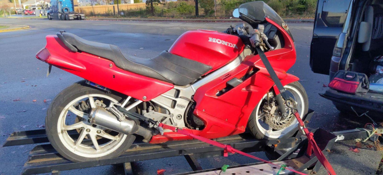

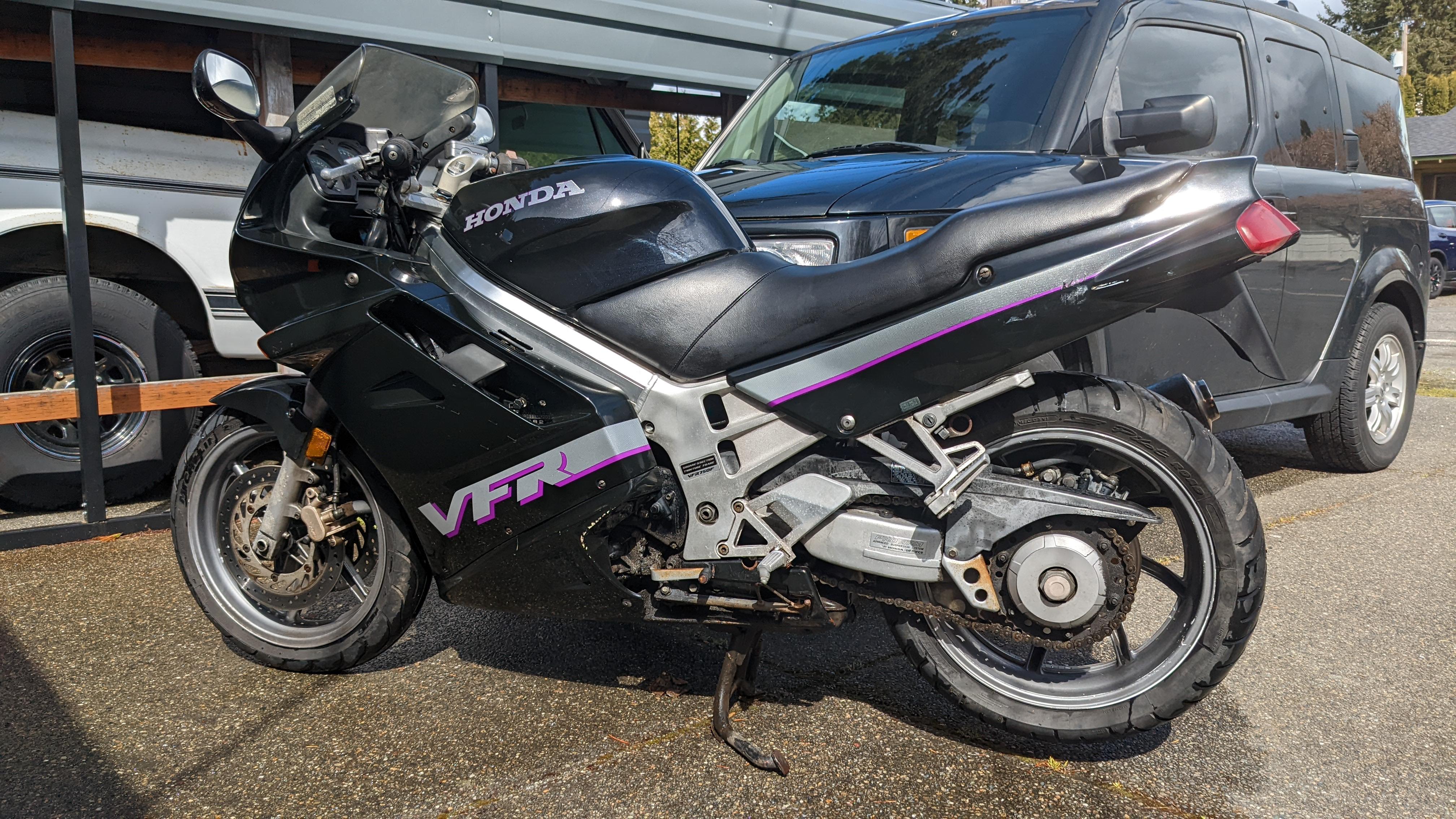

Picked this up last year.  1992 VFR, 50K.  $500
All there except the side stand trim (as usual).  Didn't run, but I was very confident it just got parked after talking to the owner.  It was his Brother in Law's bike who passed.  2020 tabs.

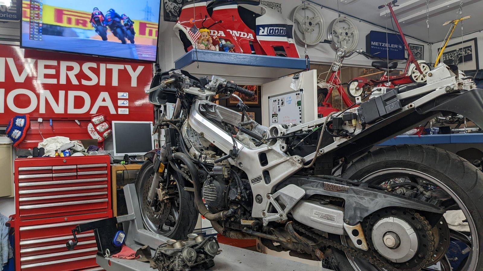

Time to dig in.
Carbs out and lose some bullshit while I'm at it.

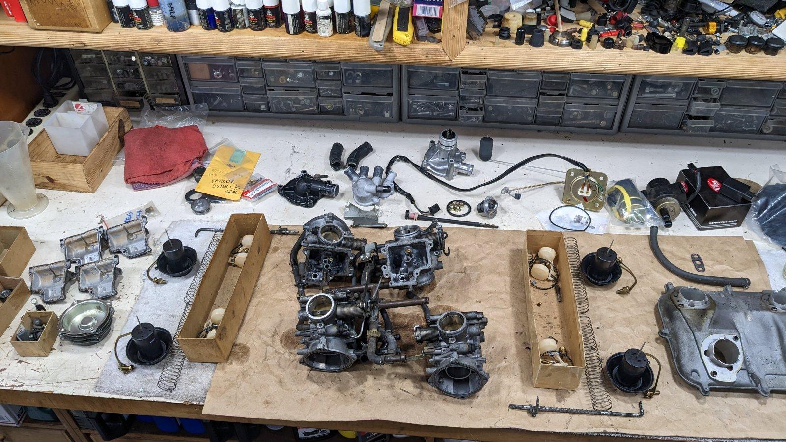

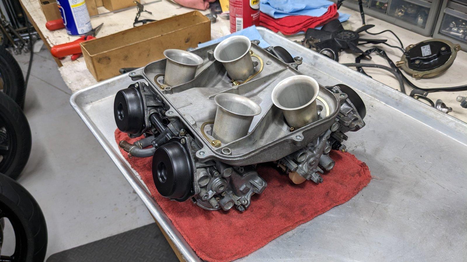

Split the carbs to clean and replace all the o-rings.  And back together for a bench synch.

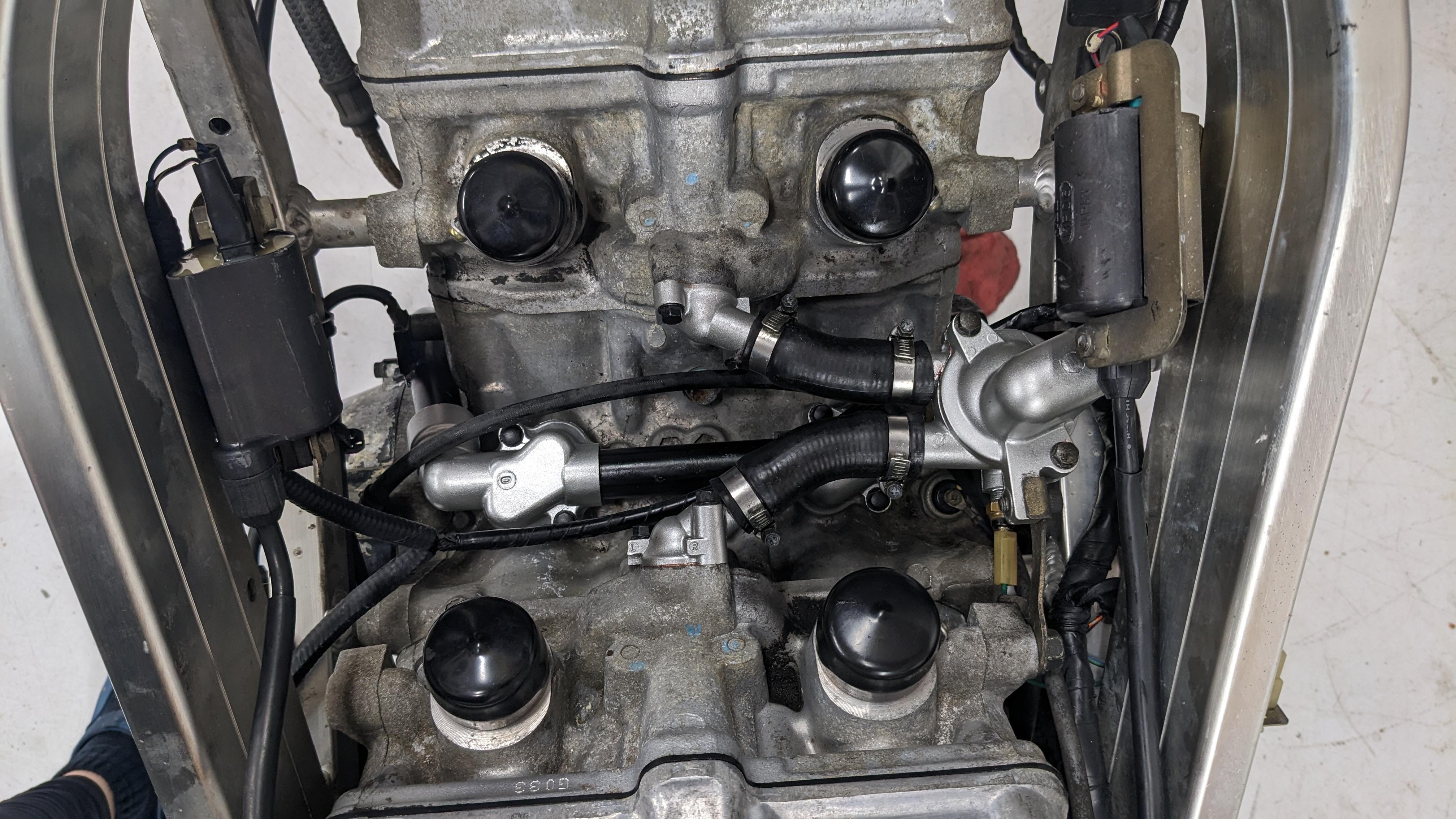

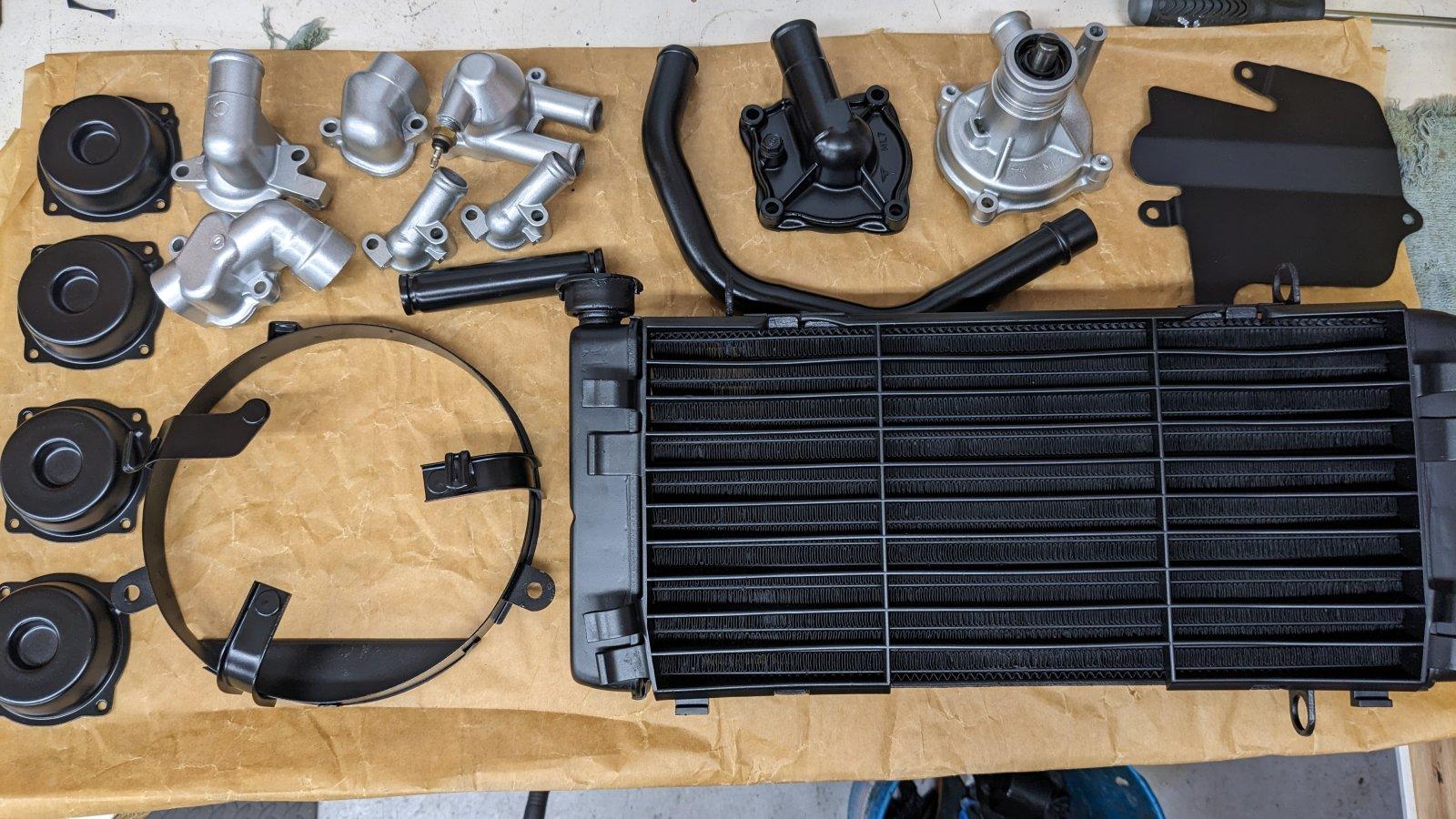

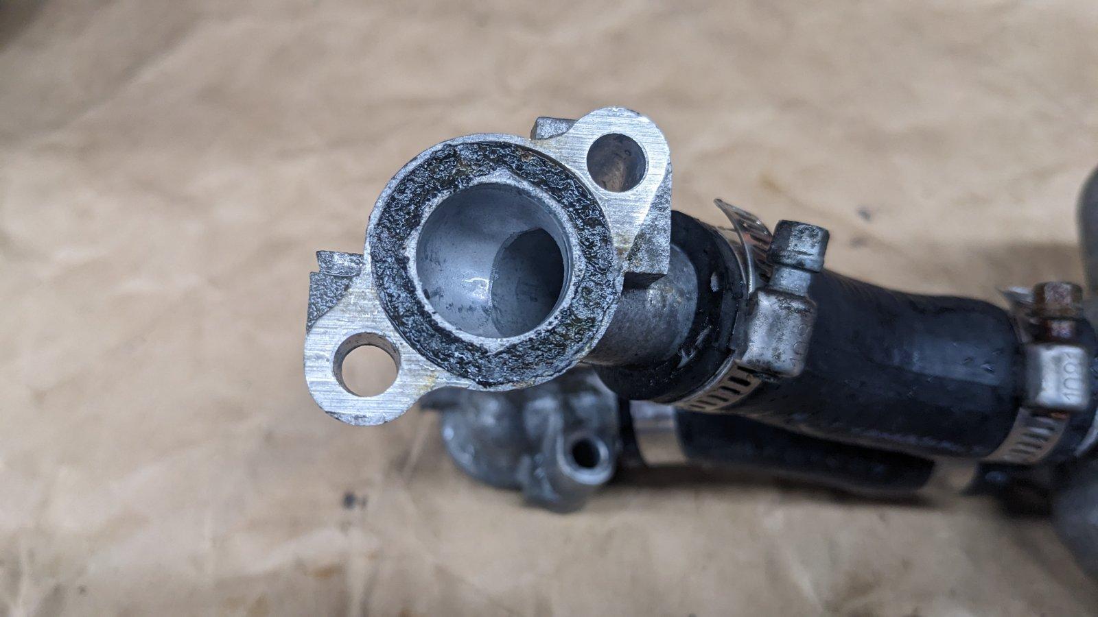

Cooling system out to restore and get all new o-rings.
Everything restored to go back in.

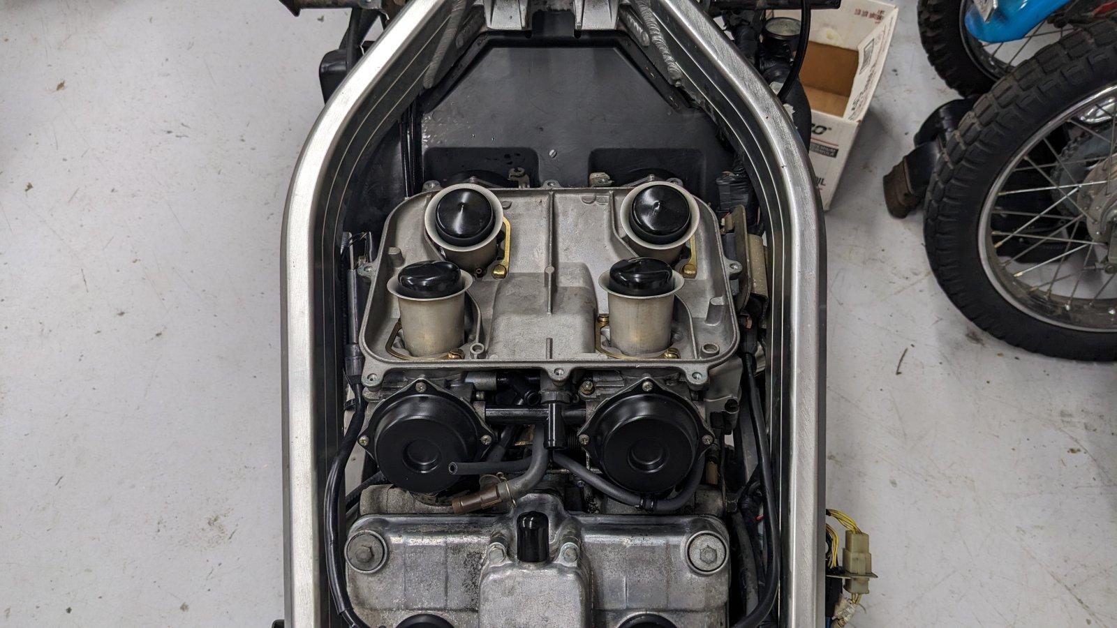

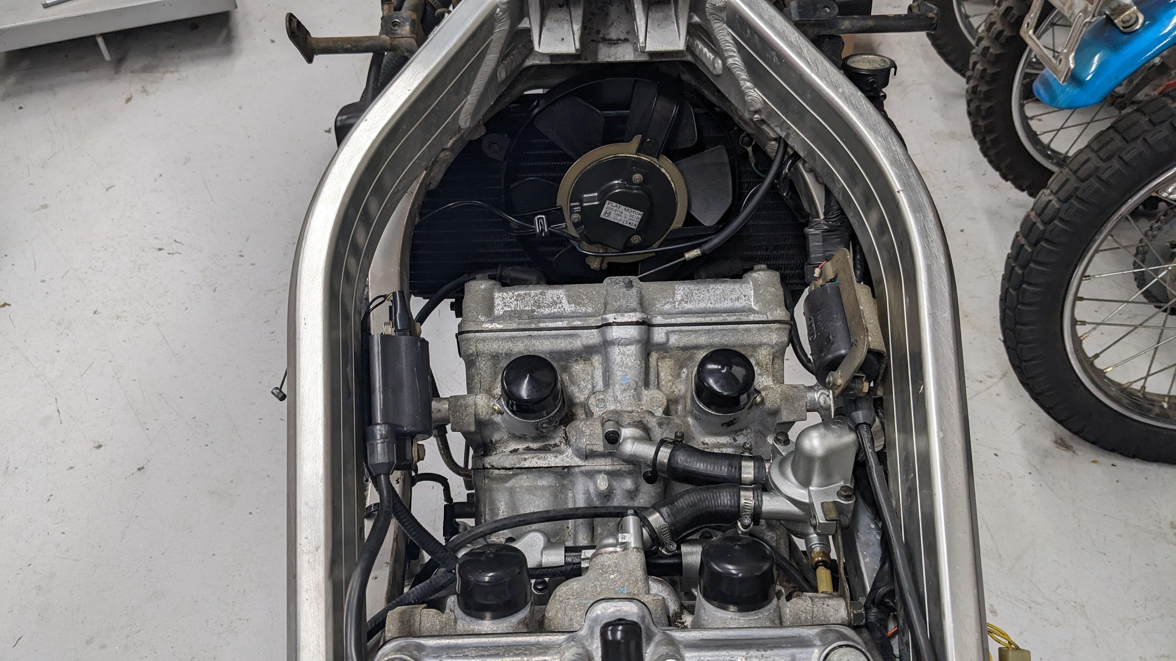

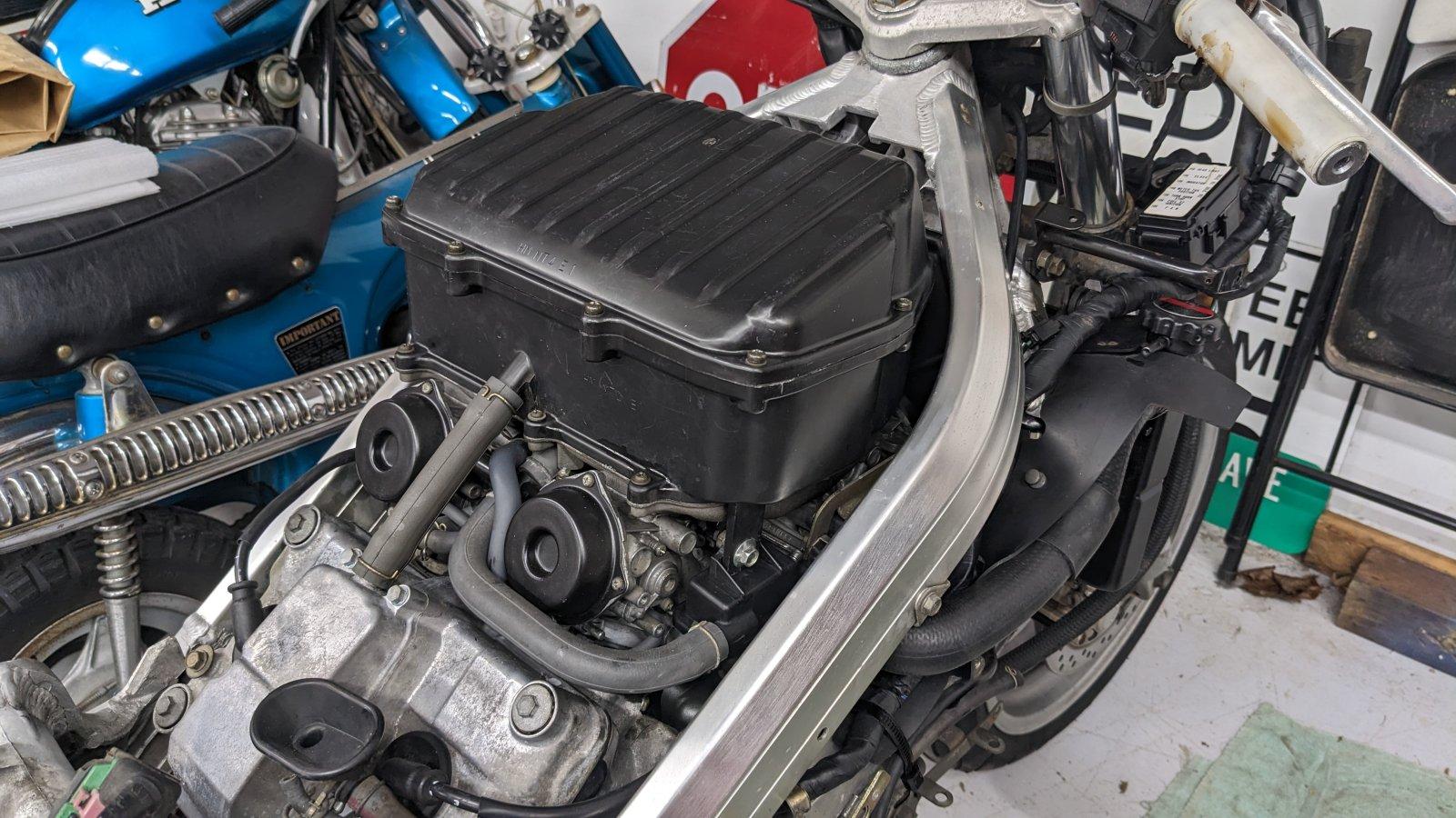

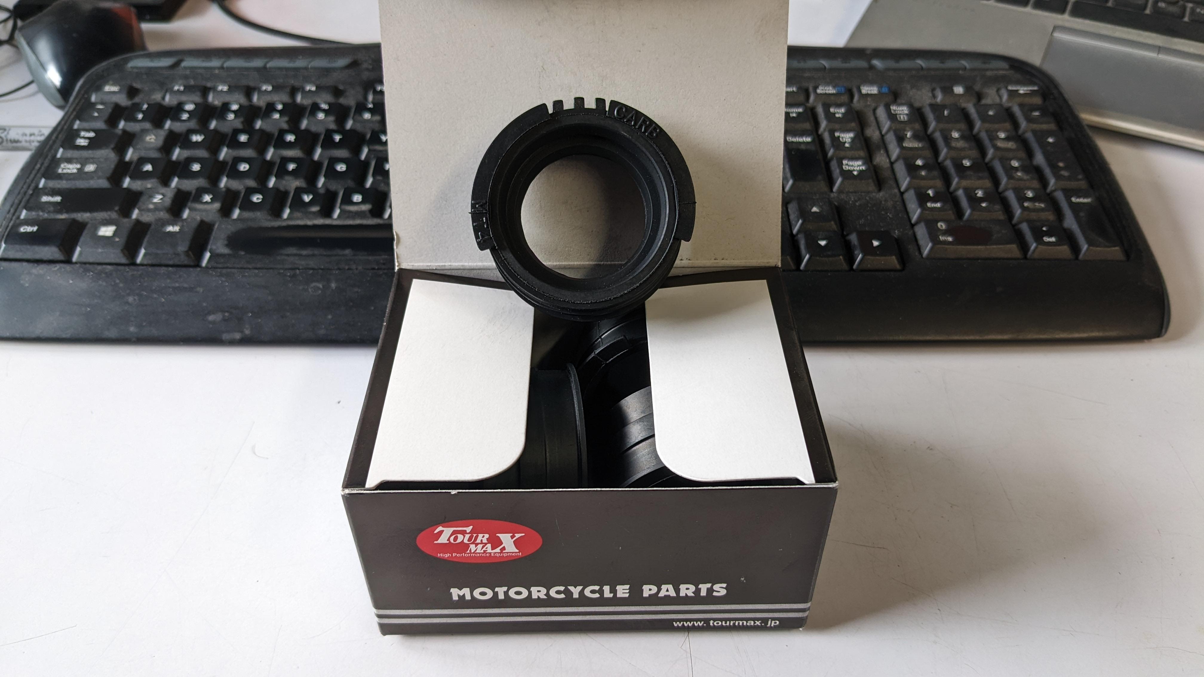

Rebuilt carbs in.  New insulators are like cheating when installing carbs, they almost fall in.
The rest of the intake system installed.

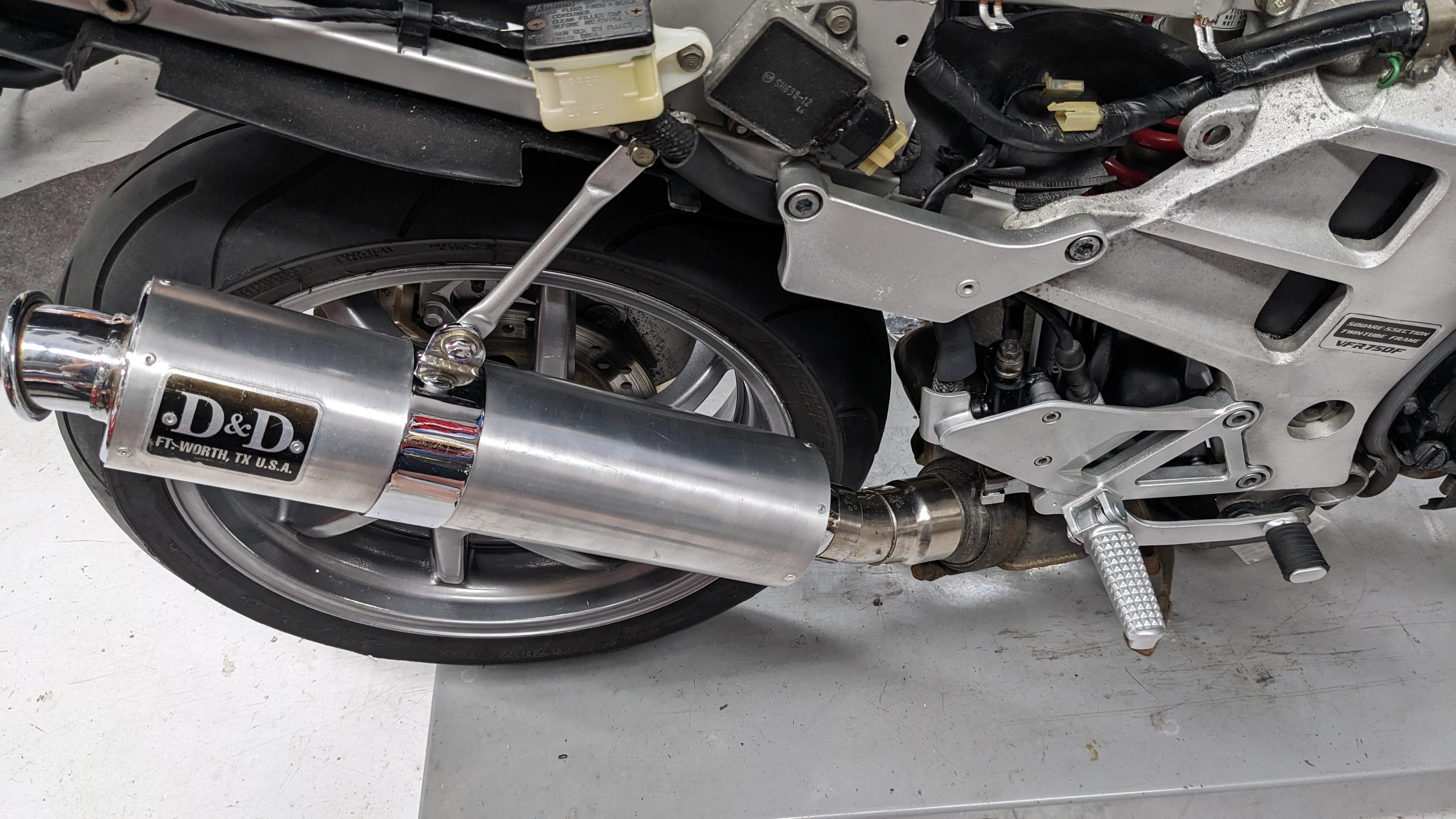

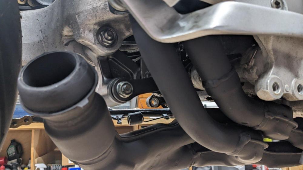

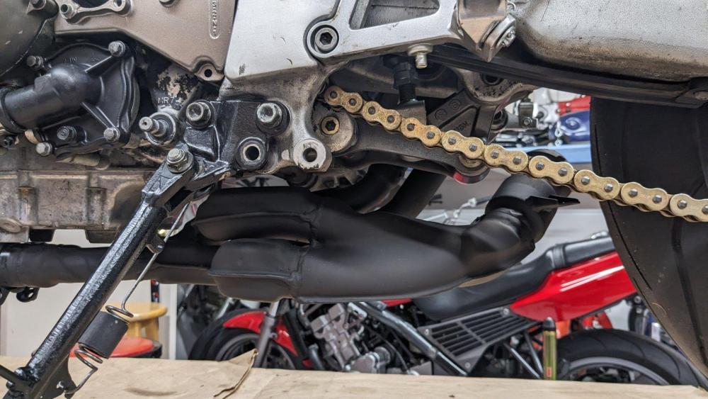

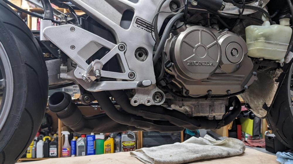

Custom D&D Slip-On installed for the first run.
OK.  Time for some oil and fuel and see if we were right.
Started instantly...   after I installed the bolt for the wire harness ground!!

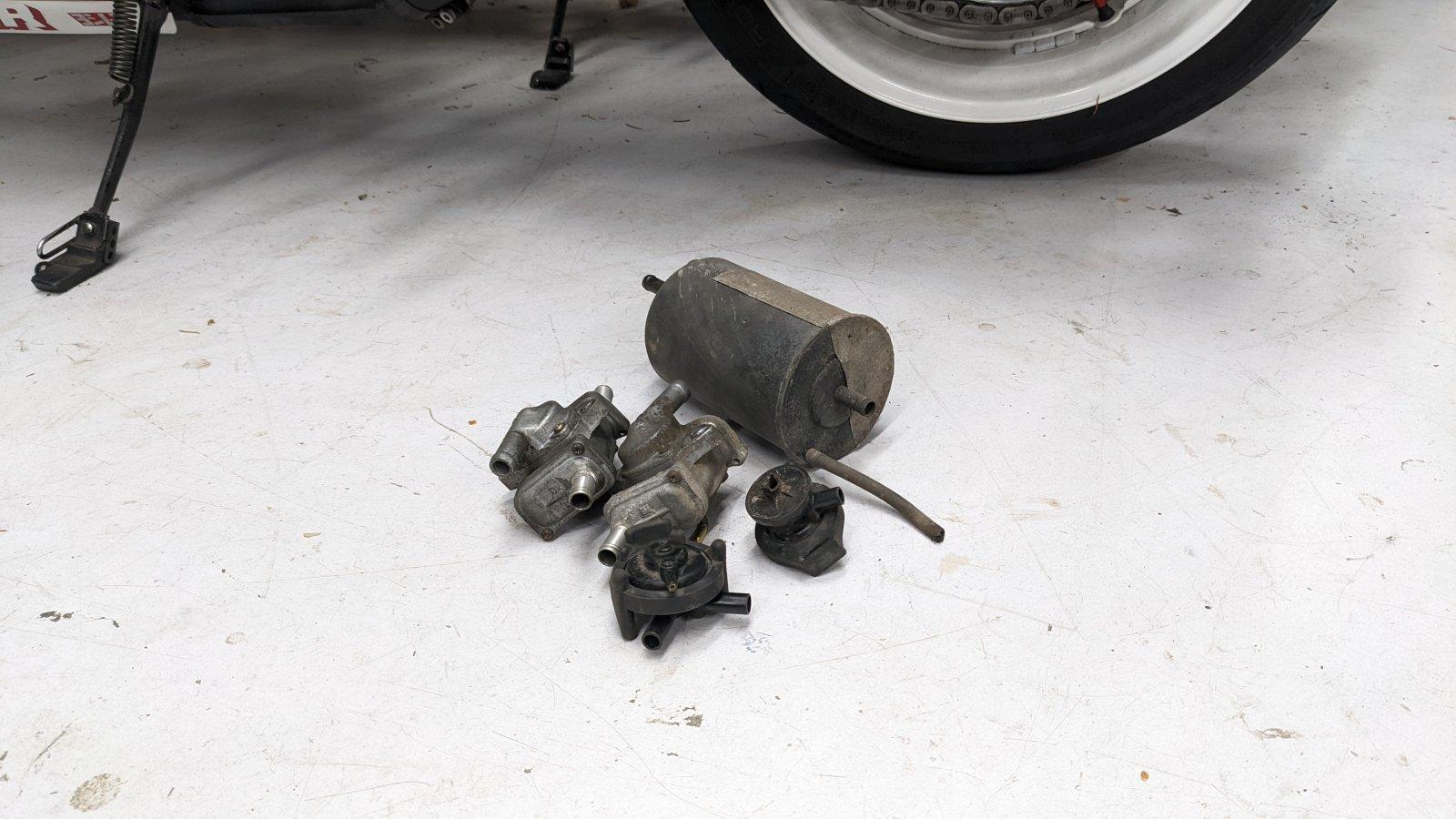

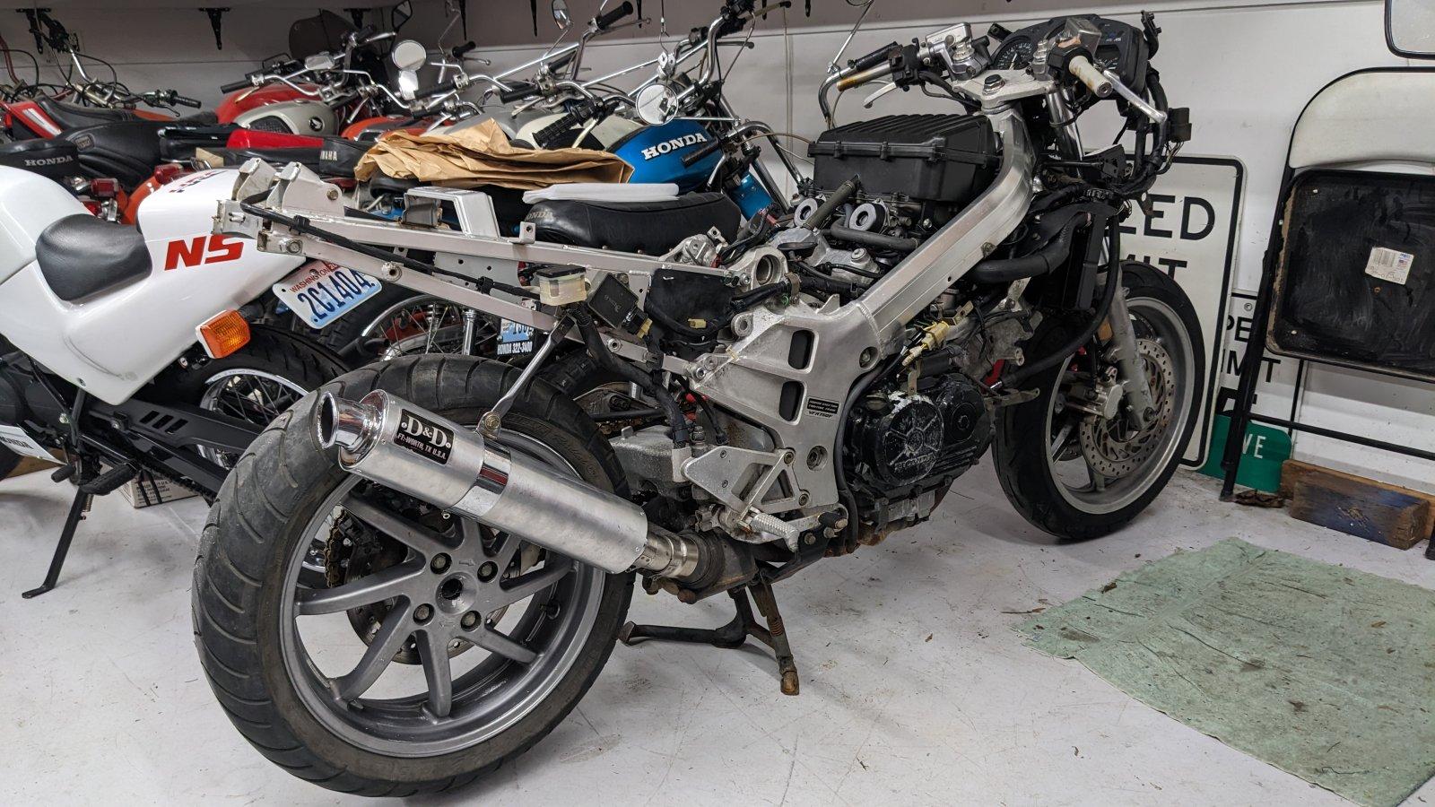

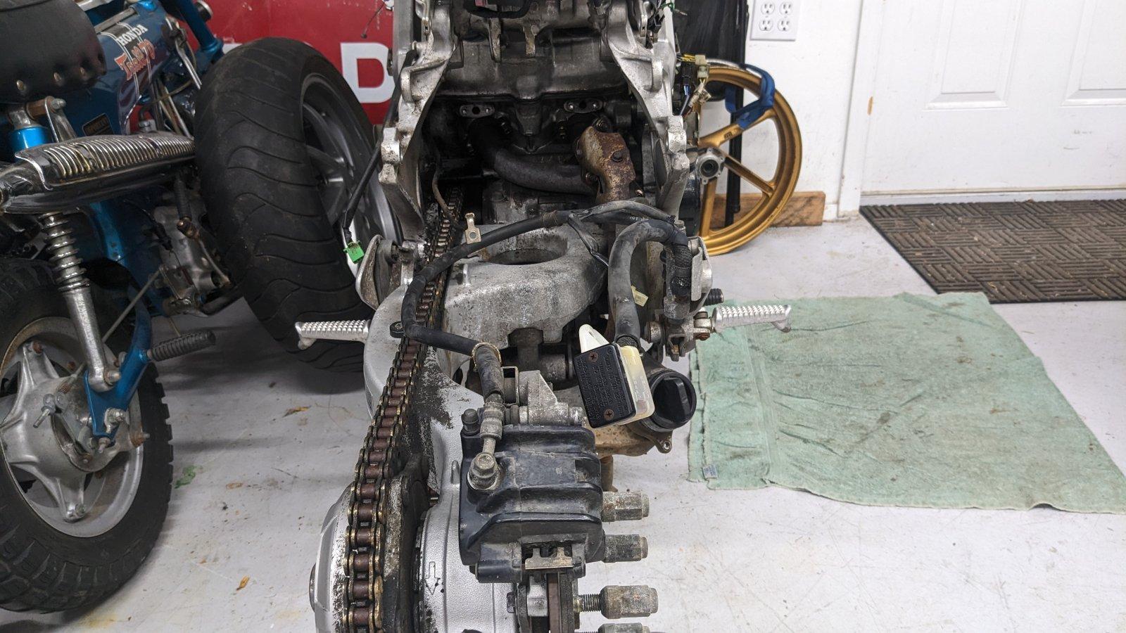

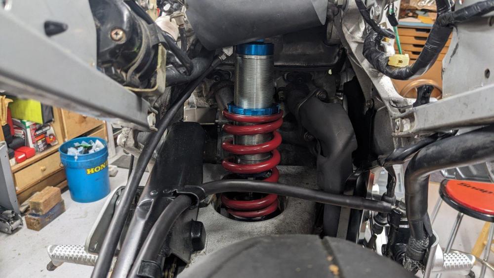

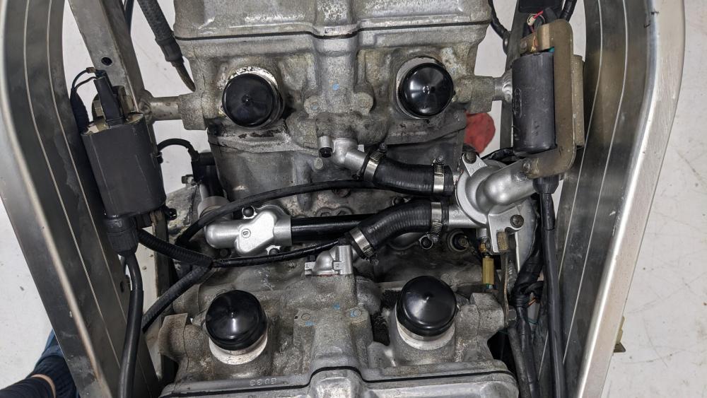

I had pulled the shock and removed all the PAIR hard lines too.
And then made some block off plates.
It was nice to get that done and out of the way.

I must figure out the same plumbing on my RC-51: remove all the CA EVAP stuff. Checking VFRD sucks because it reminds me how minuscule my garage skills are despite decades of VF/VFR ownership.

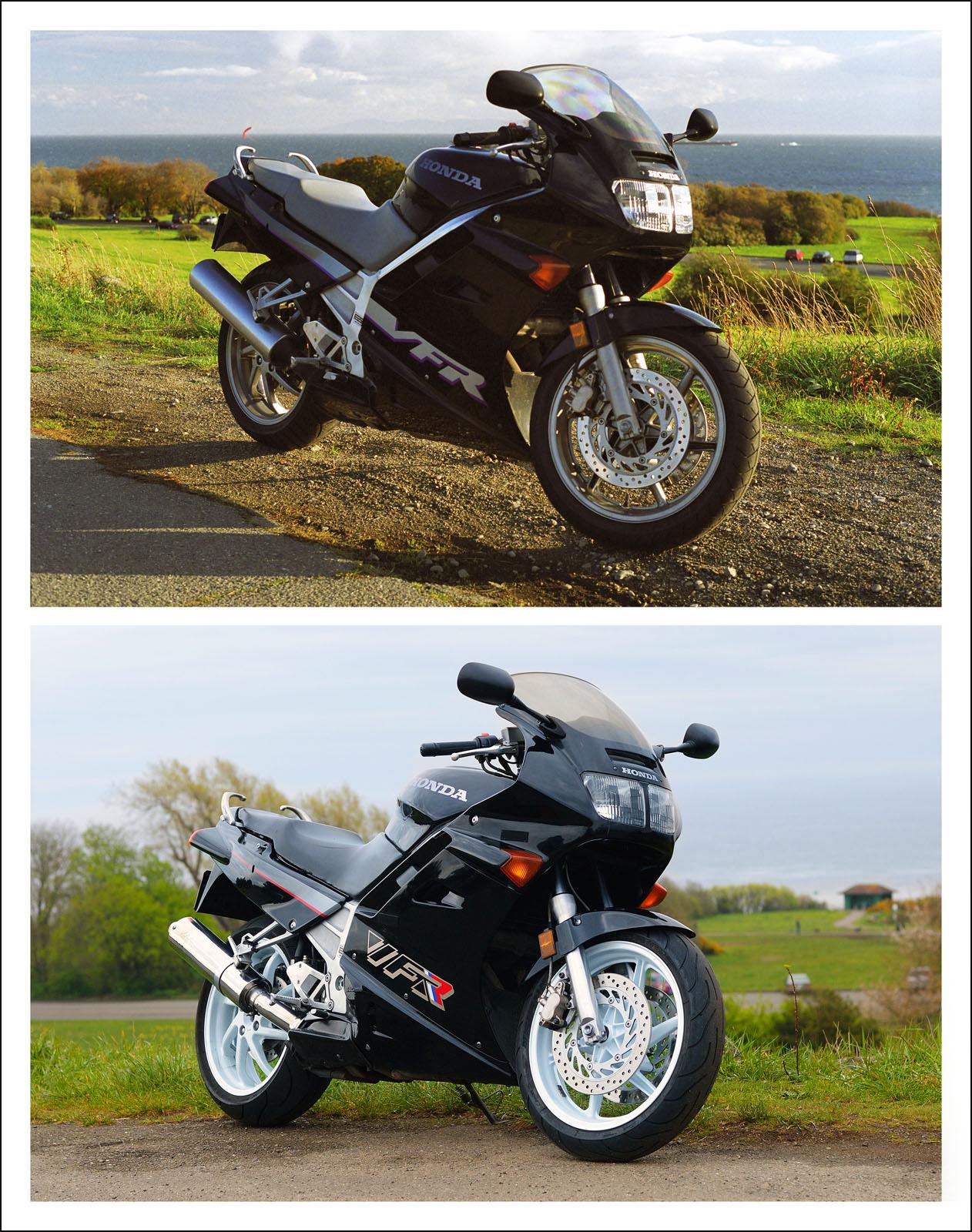

     Speaking of bodywork, I've attached pics of my '92 as stock and after a few changes. I really didn't like the purple/grey VFR decal and bought a set as used on the black 1990/1991 VFRs in Europe. they are similar to the one on red VFRs, but with a gold shadow instead of silver. I applied red tape on rear fairings just wide enough to cover the purple.

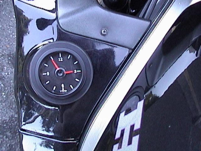

     Lastly, one of the fellows on the old mailing list, Dave Matthew, found that a 2" diameter VDO clock could be fitted to the left side panel. There's a round knock on the panel near the front of the tank. That is where Euro models housed the fuel switch. Here's a link: VDO Marine Clock
Best of luck with your project.
As this is a VFR, possibly a better use for that location would be to fit a voltmeter!

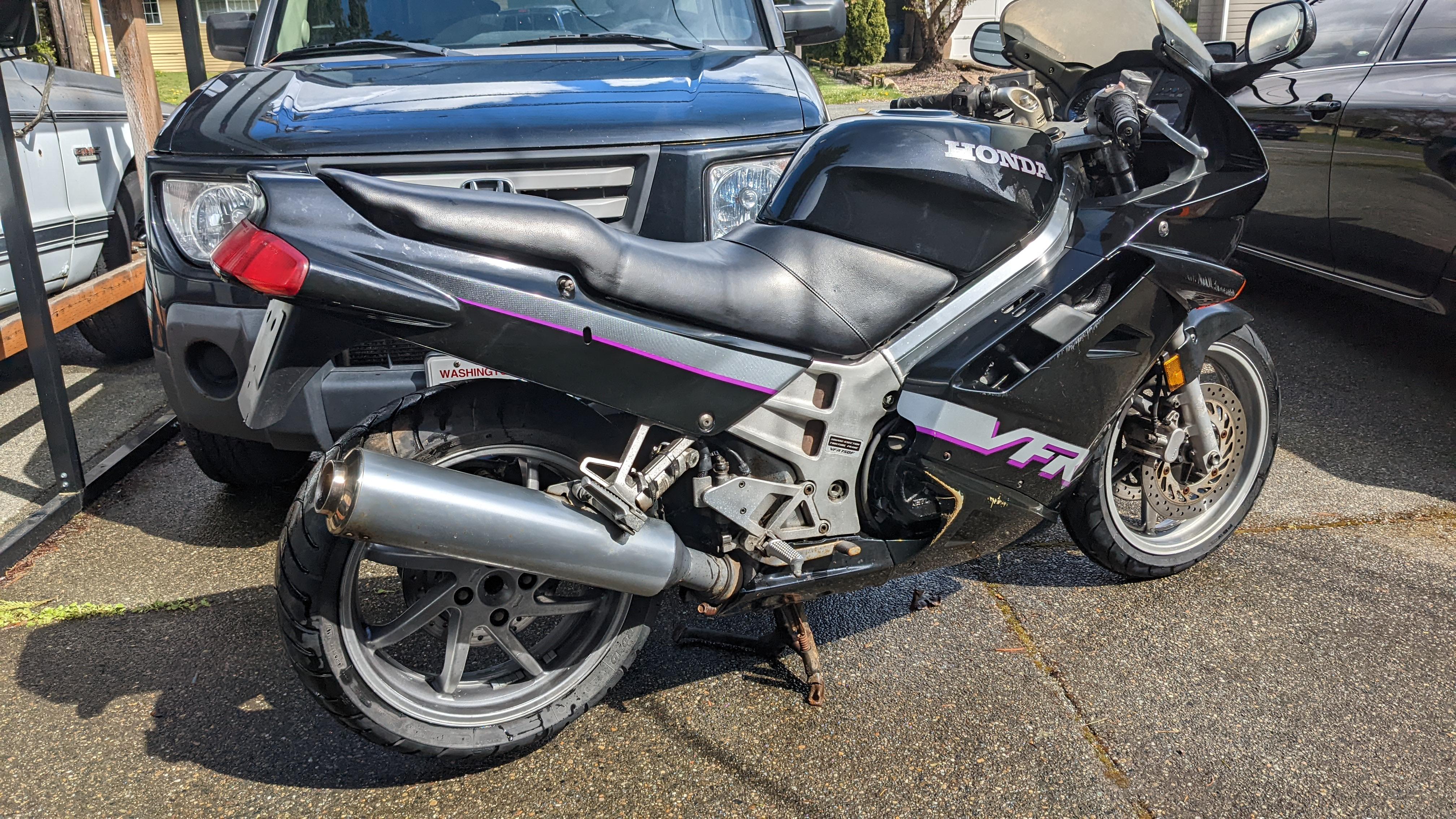

Yeah...  not my first rodeo...    I own a 95
I flipped a 90 last Summer...   before @ $400
After...   sold for $2300

The bike did have the stalk rear winkers on it, but they were trashed.  I wouldn't have kept them in any case.  I have some amber lenses already, but I`m not sure which way I'm gonna go yet.  I might make the red lenses running lights and signals.
Its gonna have some original style mirrors at first.  My 95 had 2000 mirrors on it when I got it and came with the brand new originals.  The weathered 92 mirrors went on the 90.
Forks are pretty rough.  I have a real nice set of 97 forks that will go on, along with a 97 wheel and rotors.
If any thing goes in the fuel valve blanking plate, it will be a Honda Voltmeter.
Graphics wise, I will be eliminating the whole purple stripe and VFR.  I already have a plan to update it, but keep it OEM looking.
Body work is OK, but yeah, I've got some tabs to repair.  Done quite a bit on other projects.

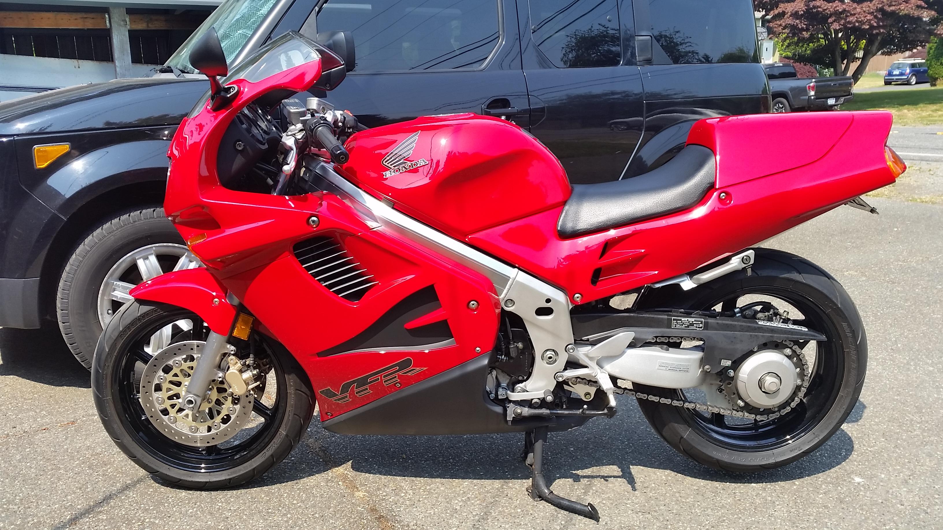

I fitted the spare grey seat from my '91 VFR, and quite liked the look. (shameless excuse to show an old favourite)
5 minutes ago, Lorne said:
I look forward tossing what you come up with.
I like that too.  Way more than I thought I would.

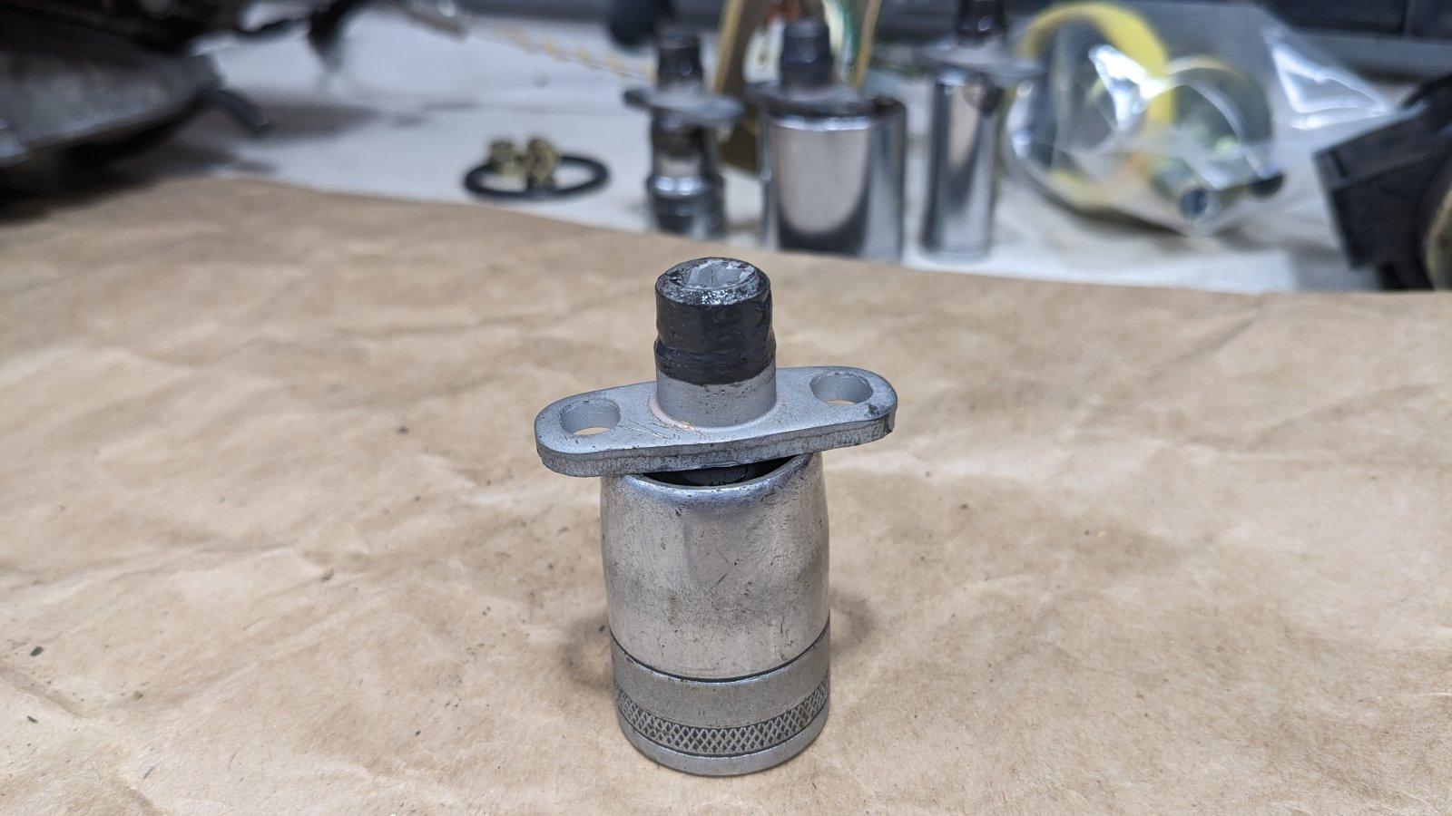

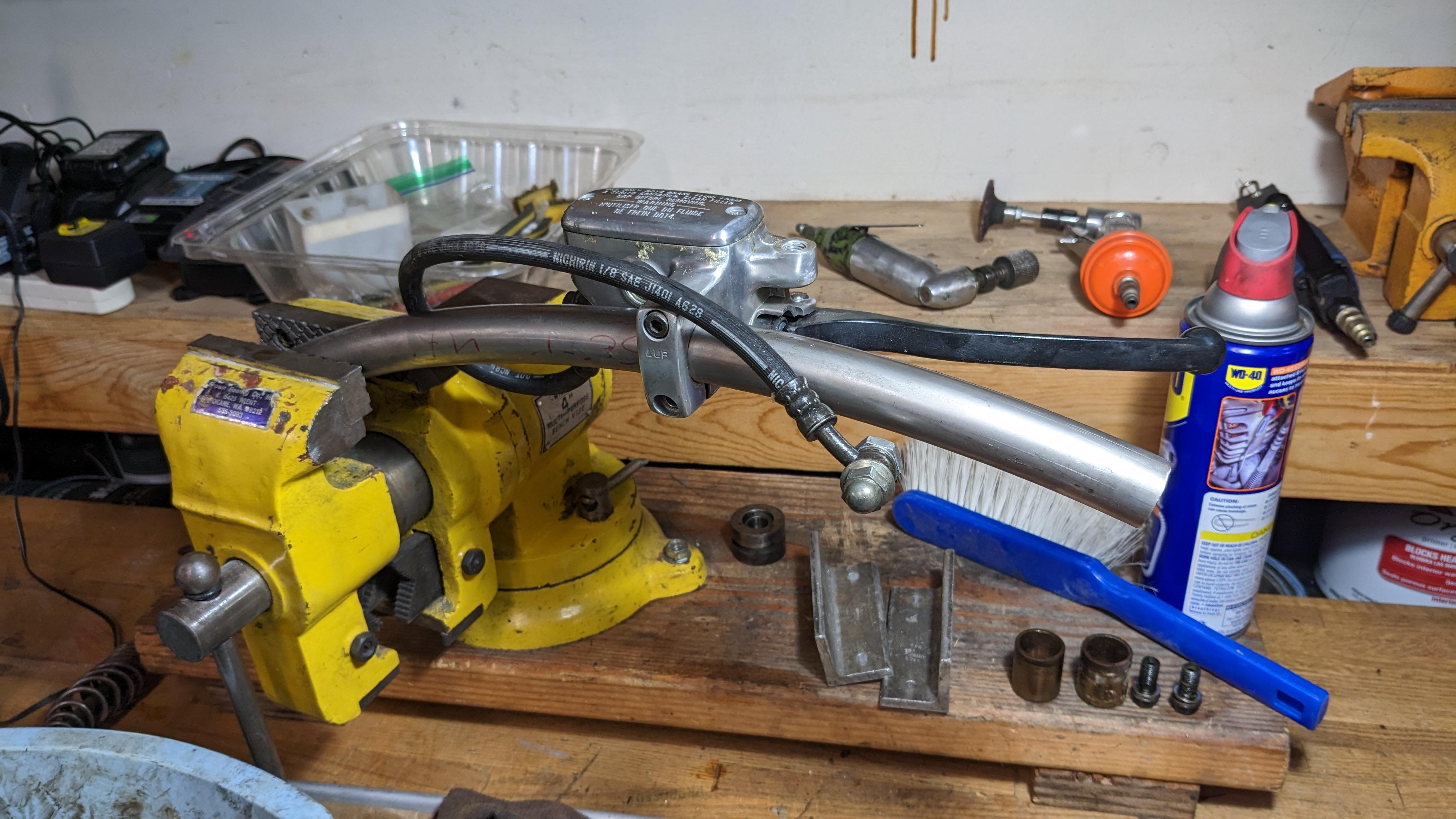

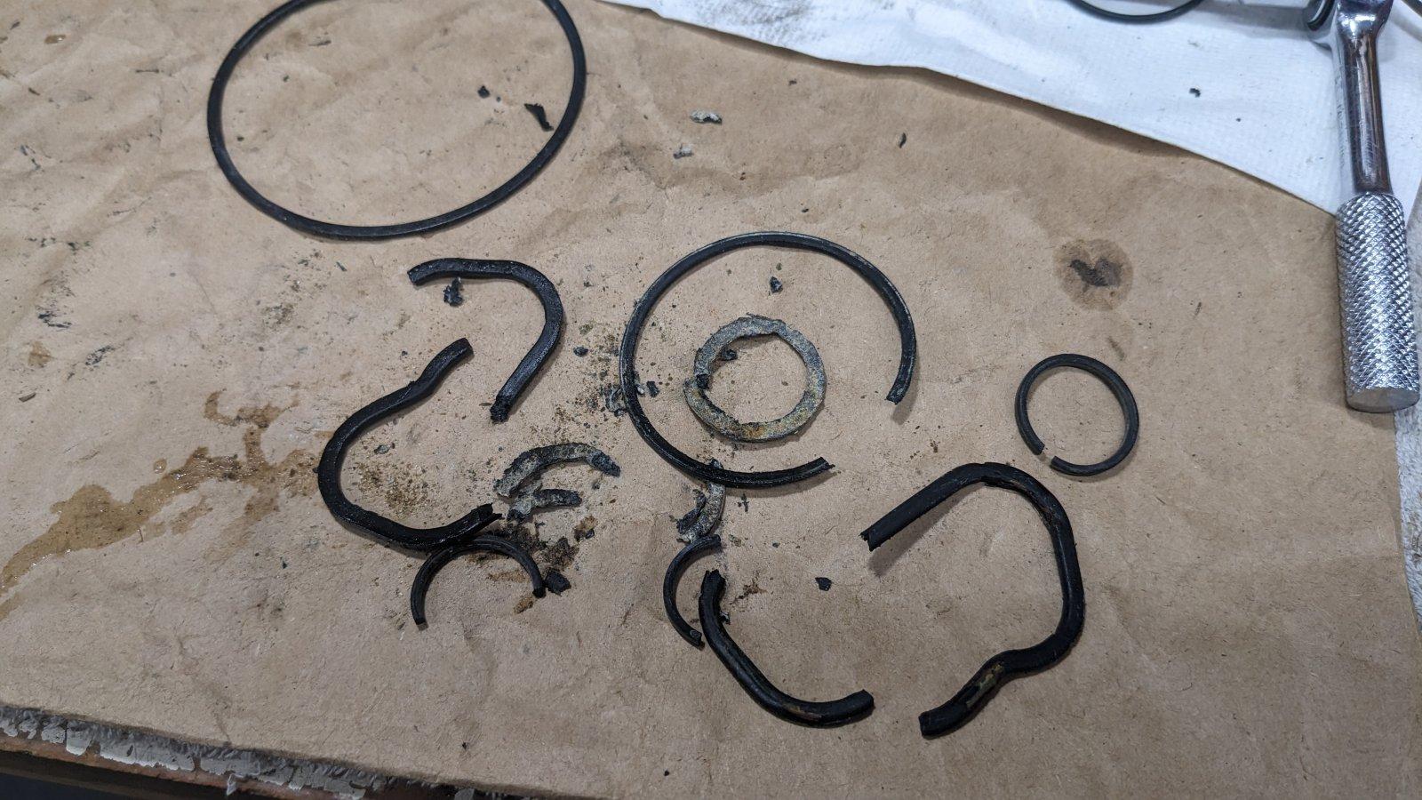

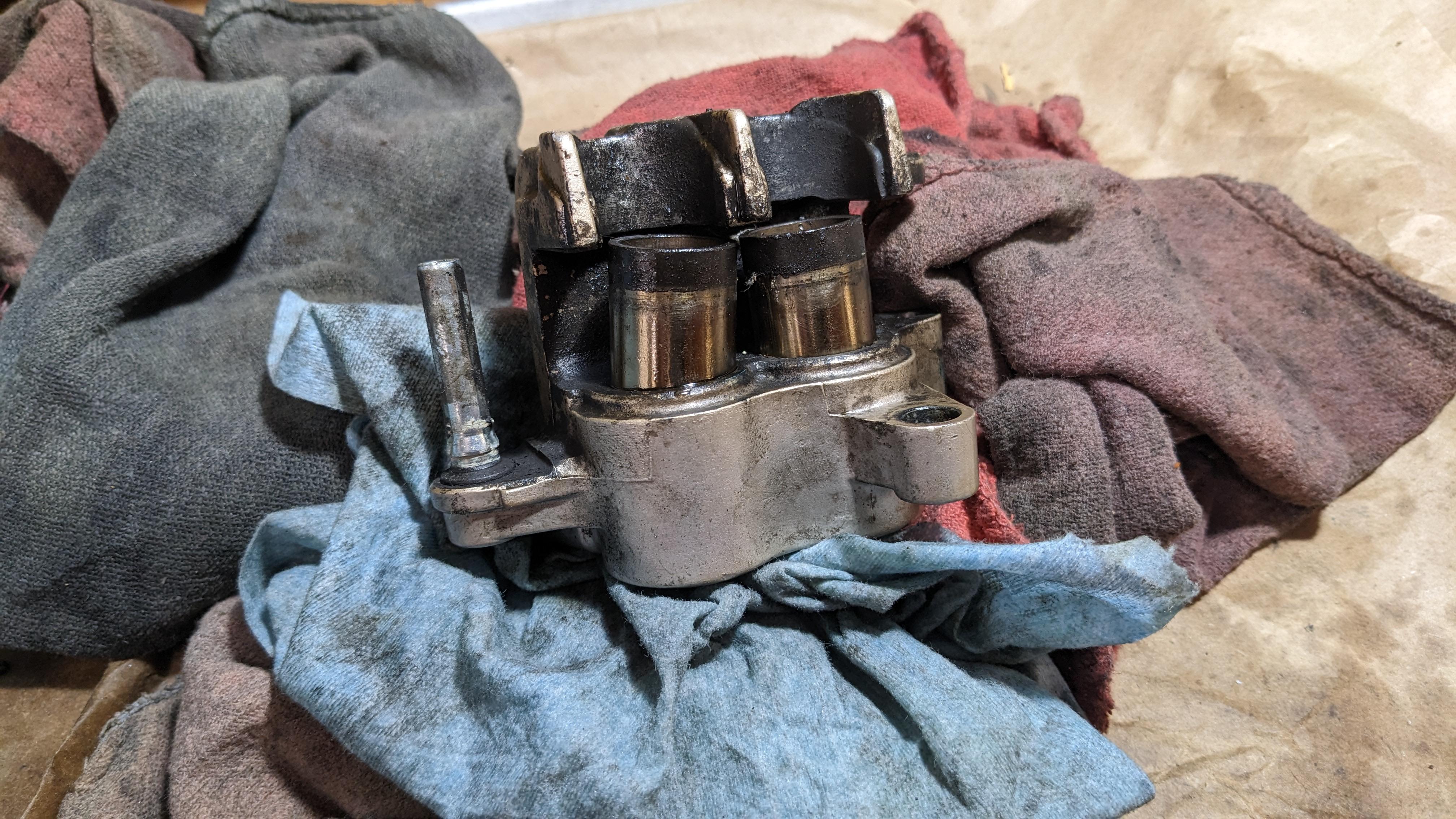

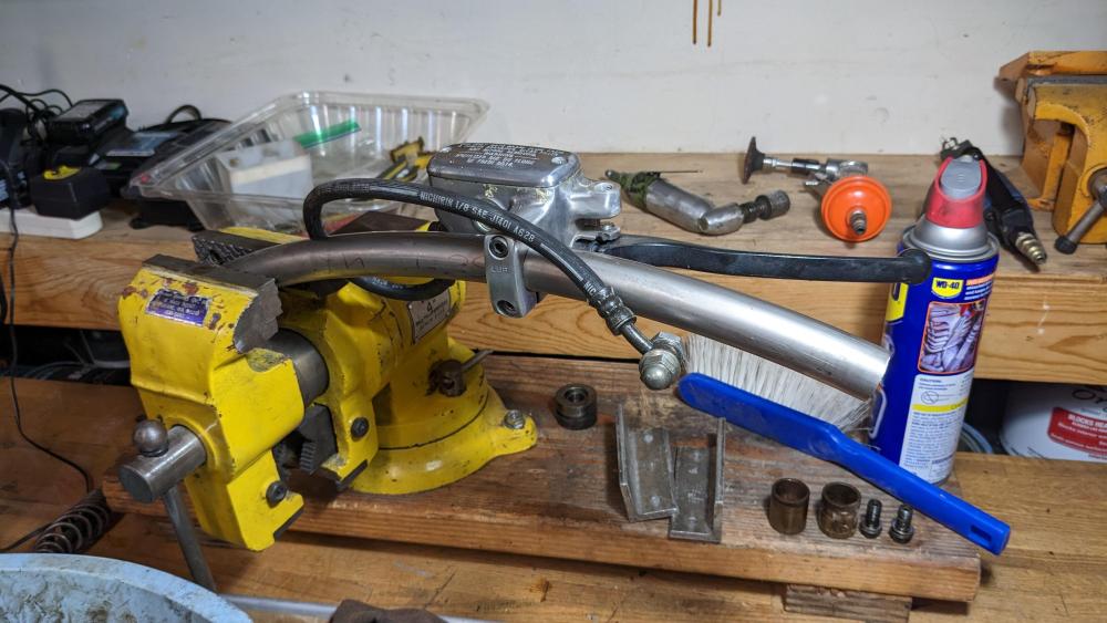

Brakes next.   Had to get out the special tool.
Shadow 1100 master cylinder I keep primed and capped.  Compressed air wasn't budging the pistons.  I forgot to pump them out most of the way before removing the lines.

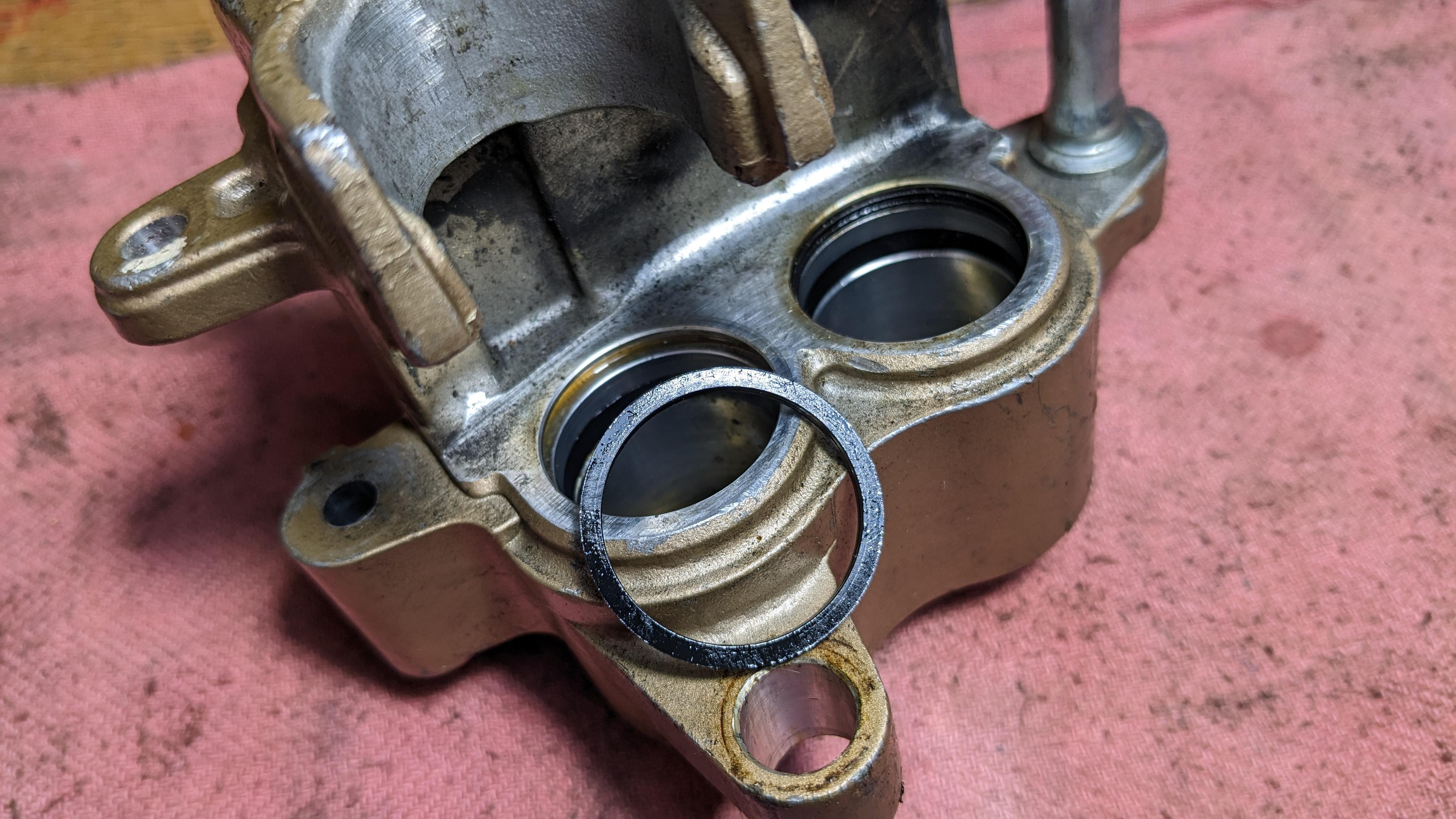

Pistons out.
Not great, but about what I was expecting.  So I had collected some parts in preparation.

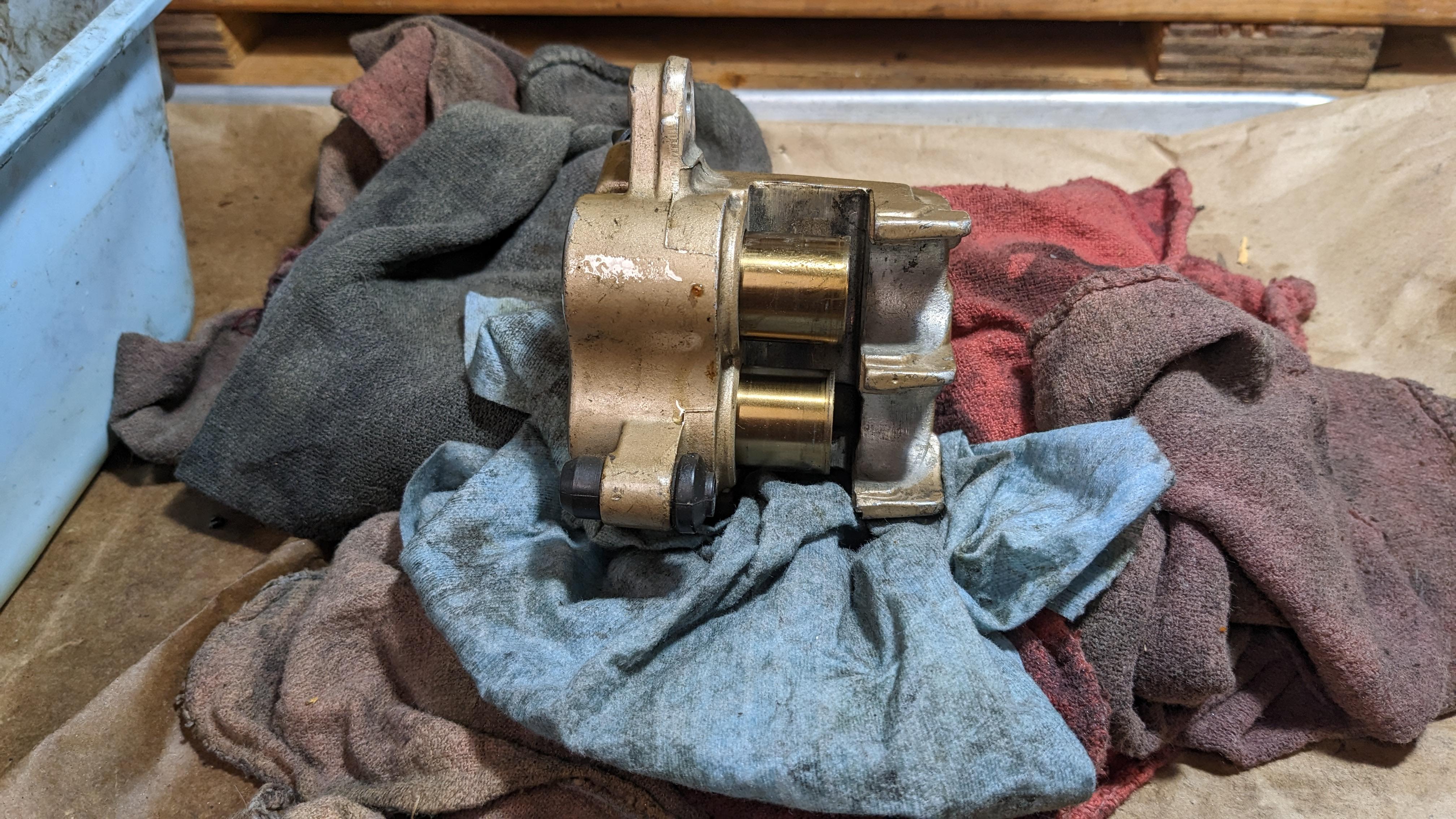

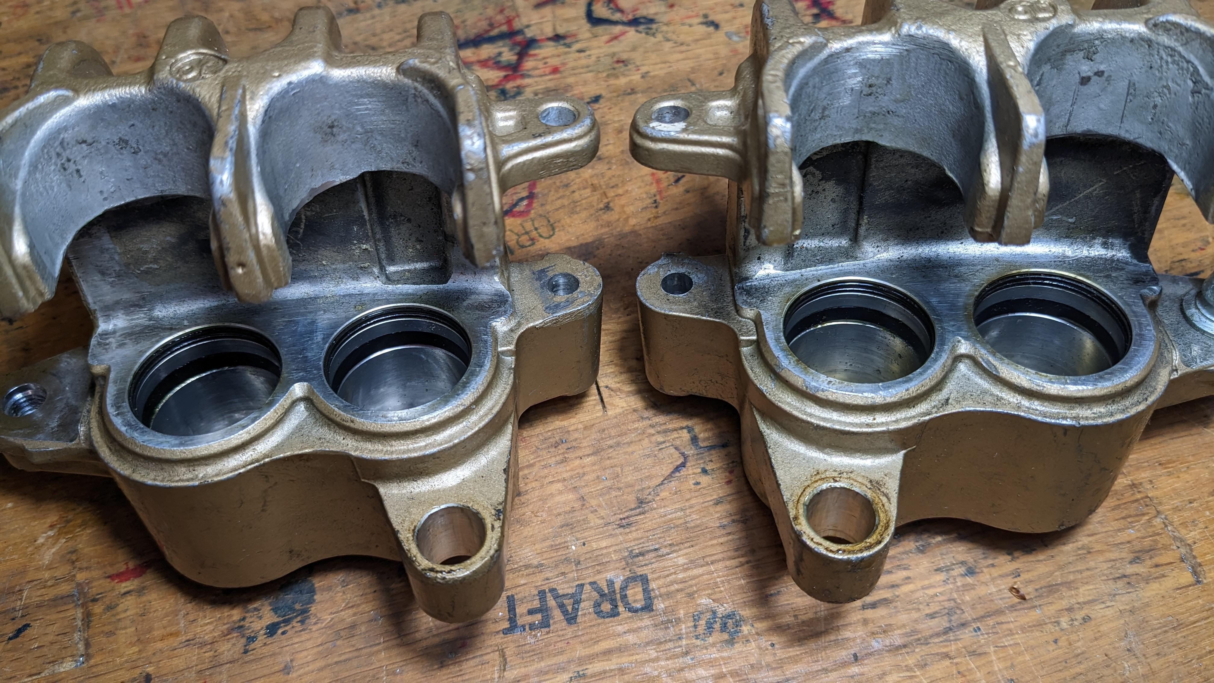

Here's the "new" calipers I sourced.
That's more like it.  Should be a simple clean, inspect, red rubber grease, assemble.
Bike had near new front and rear EBC pads in it, so that's nice.  Master cylinders were clean inside and worked perfectly.  I have a full set of stainless lines for the bike too; front, rear, clutch.

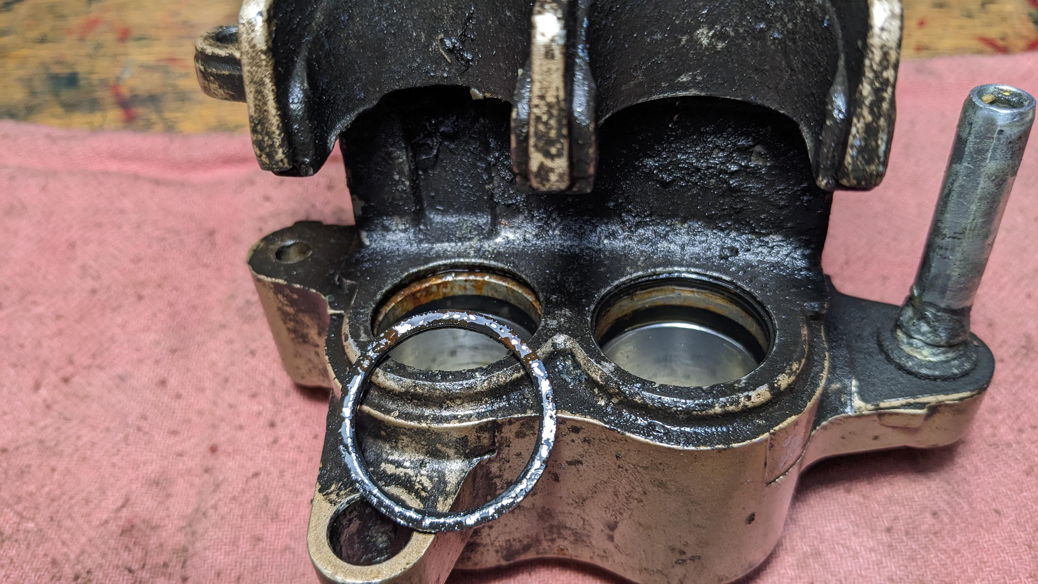

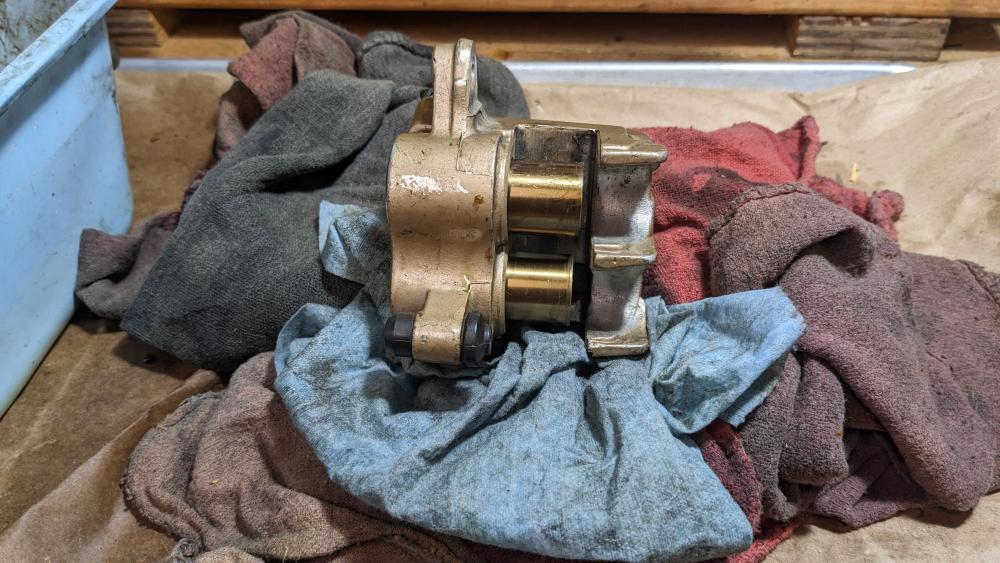

Any pics of the insides of the calipers?
I'll update later, but pretty decent I think.  The only thing really preventing the brakes from working properly was the ring of crud / corrosion on the pistons preventing them from retracting.  I'll clean up the pistons and see how bad the pitting is for possible use on another project, might be able to assemble one more "good" set out of all the left over parts.  I have a 3rd set that I threw together as some place holders on my Hawk project before finishing the F3 calipers.
Them pistons may buff out prettuy well on a polishing wheel
Thesedid
VF400F
The inside was yuck

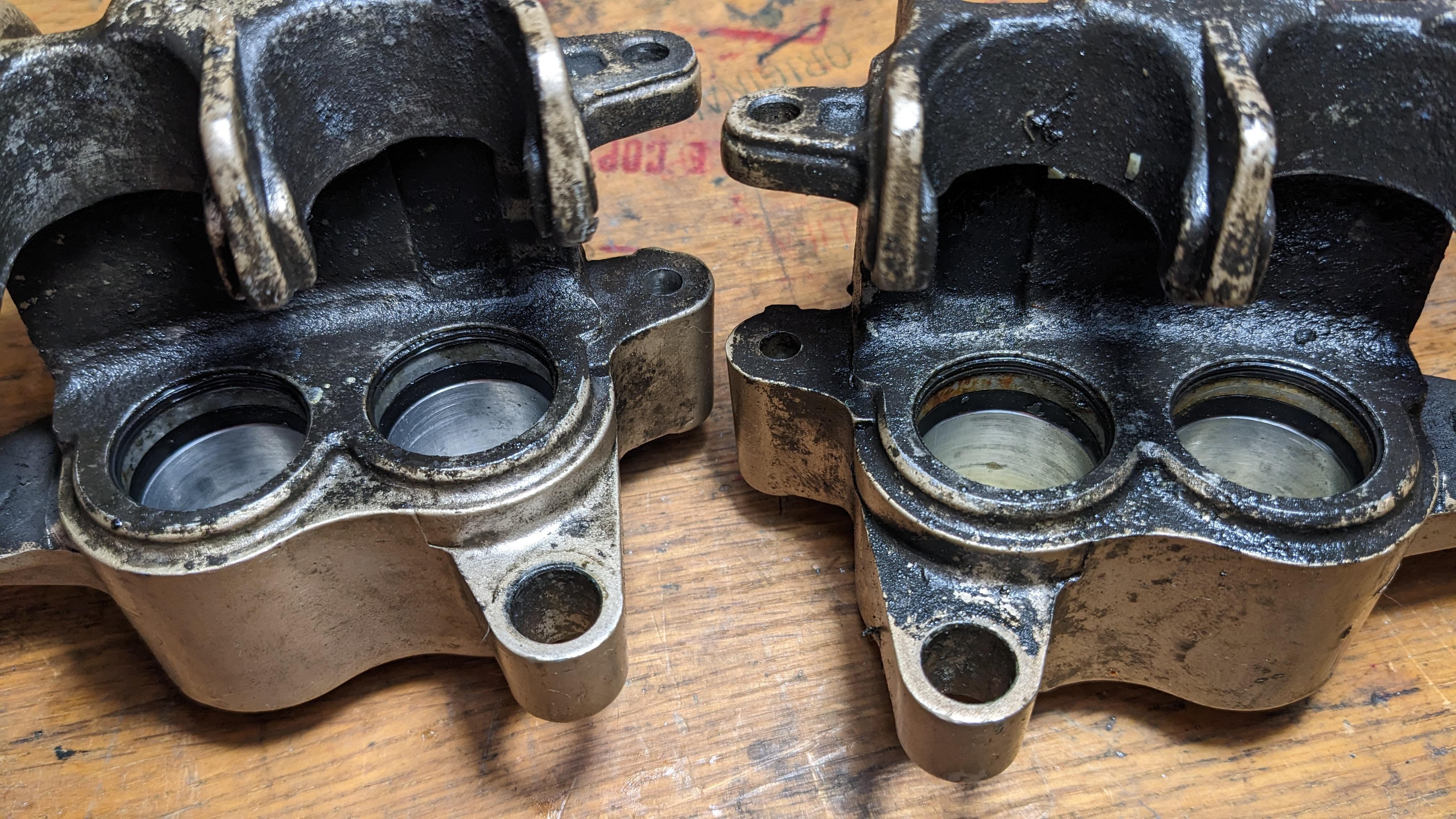

Here's the set off of the bike.  Not terrible, but pretty sure there's a fair amount of crud / corrosion under the dust seals that was contributing to the lack of proper action.
In contrast, here's the set that I sourced for this project...

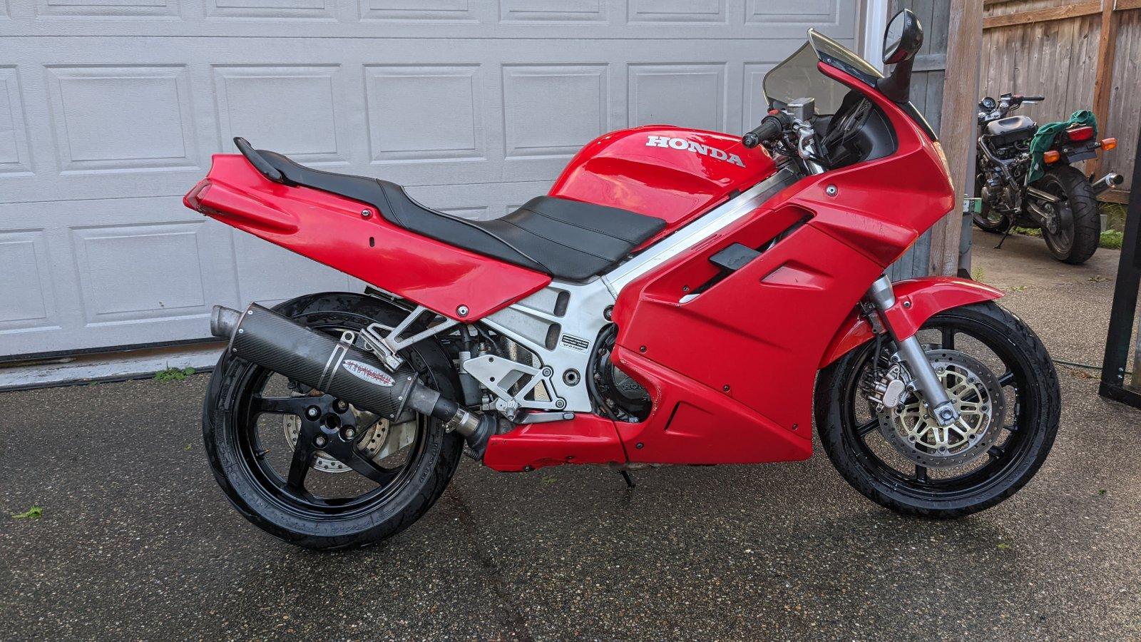

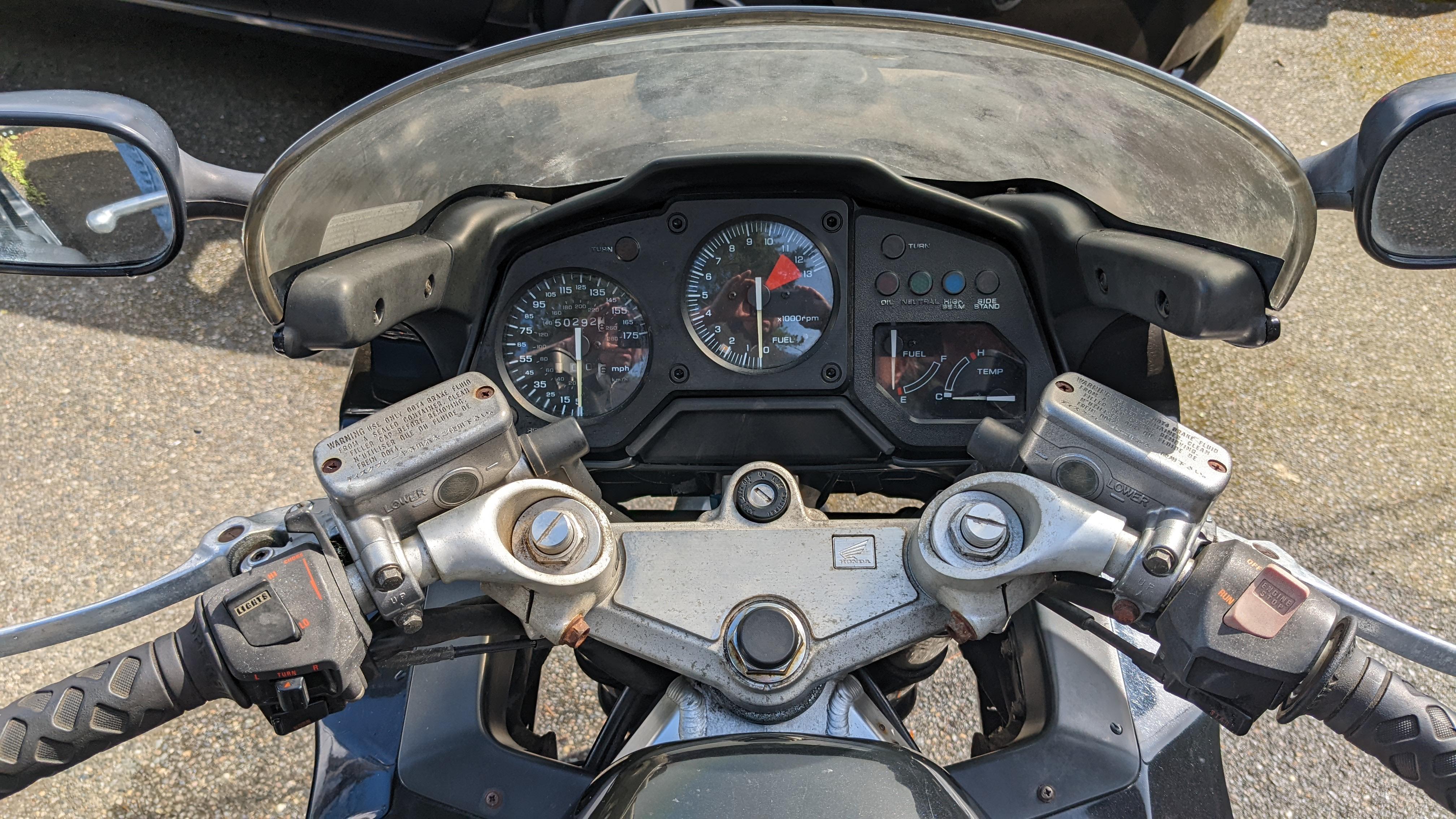

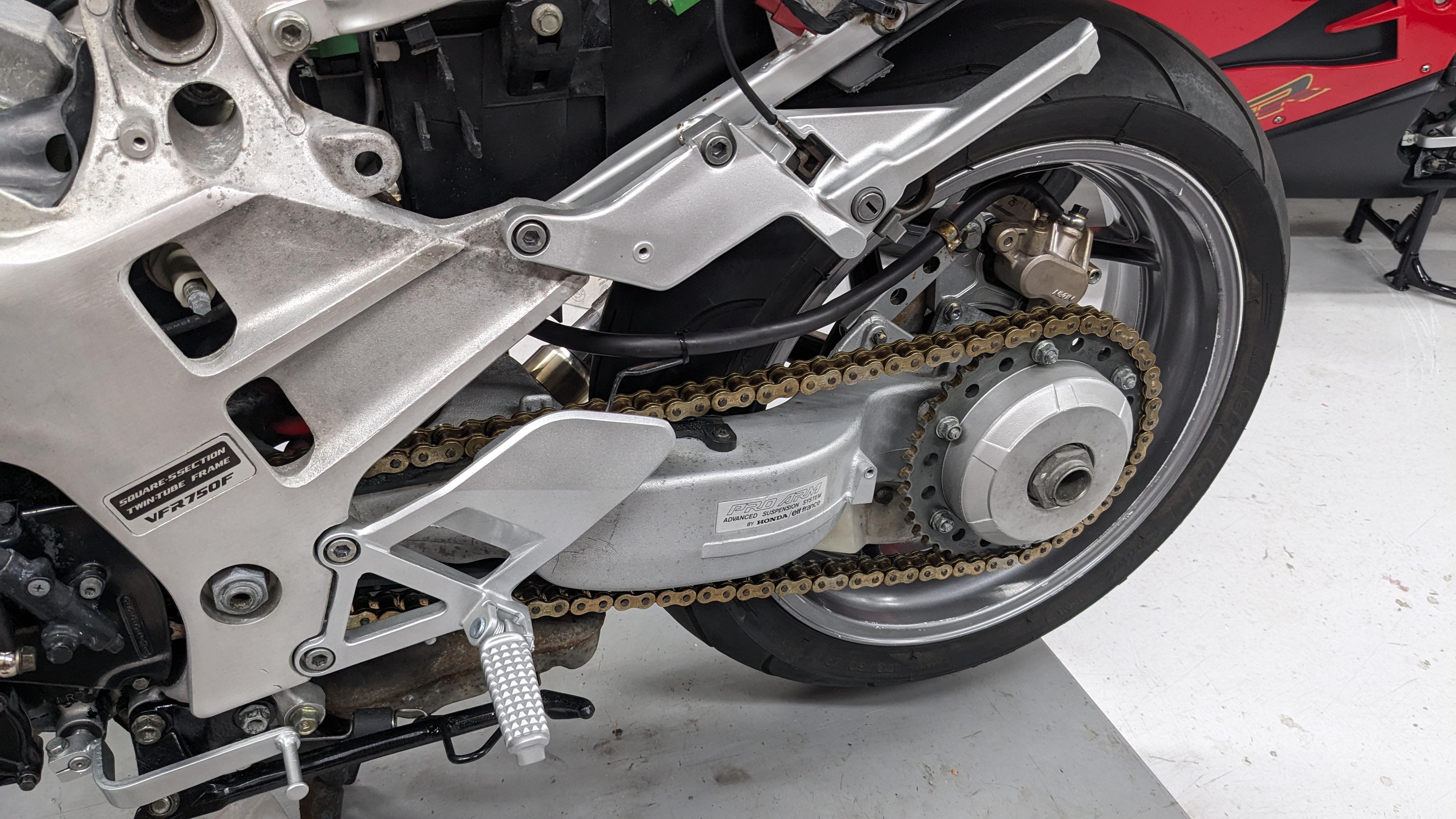

Restored triples (97 lower clamp) with new tapered bearings and 97 clip-ons.  Steel braided brake lines, FR & RR, and Clutch.

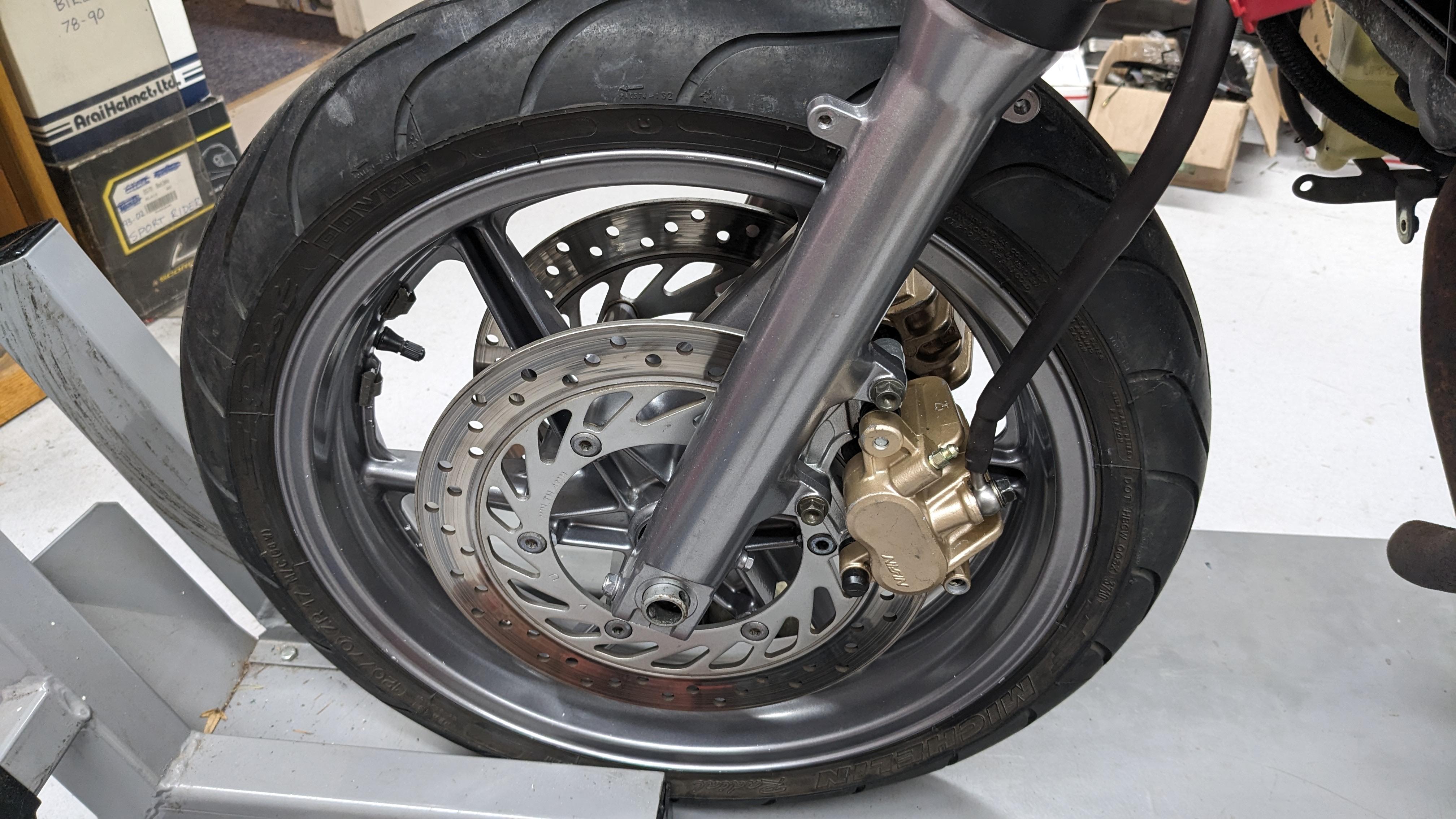

97 forks with RT .90 springs.  Stock front wheel has been hand polished and waxed with restored lower mile rotors.  Placeholders until I paint a 97 wheel with floating rotors.
Restored controls, custom D&D slip-on and hand polished / waxed stock rear wheel.
I left a good portion of the old RT passenger peg bracket for the rear cowl mount and I'm going to mount the FOX TC res off of it after it's rebuild.
Waiting for some shift rubbers to come in.  Brake line "stay" is temp so I can roll it around and take a test ride before I get decades of chain grime off of the chain guard.
Lots of stuff need more love, but not this round.  Bleed brakes and clutch and start polishing bodywork.

Your '92 is coming along nicely. A couple Q's about you progress:

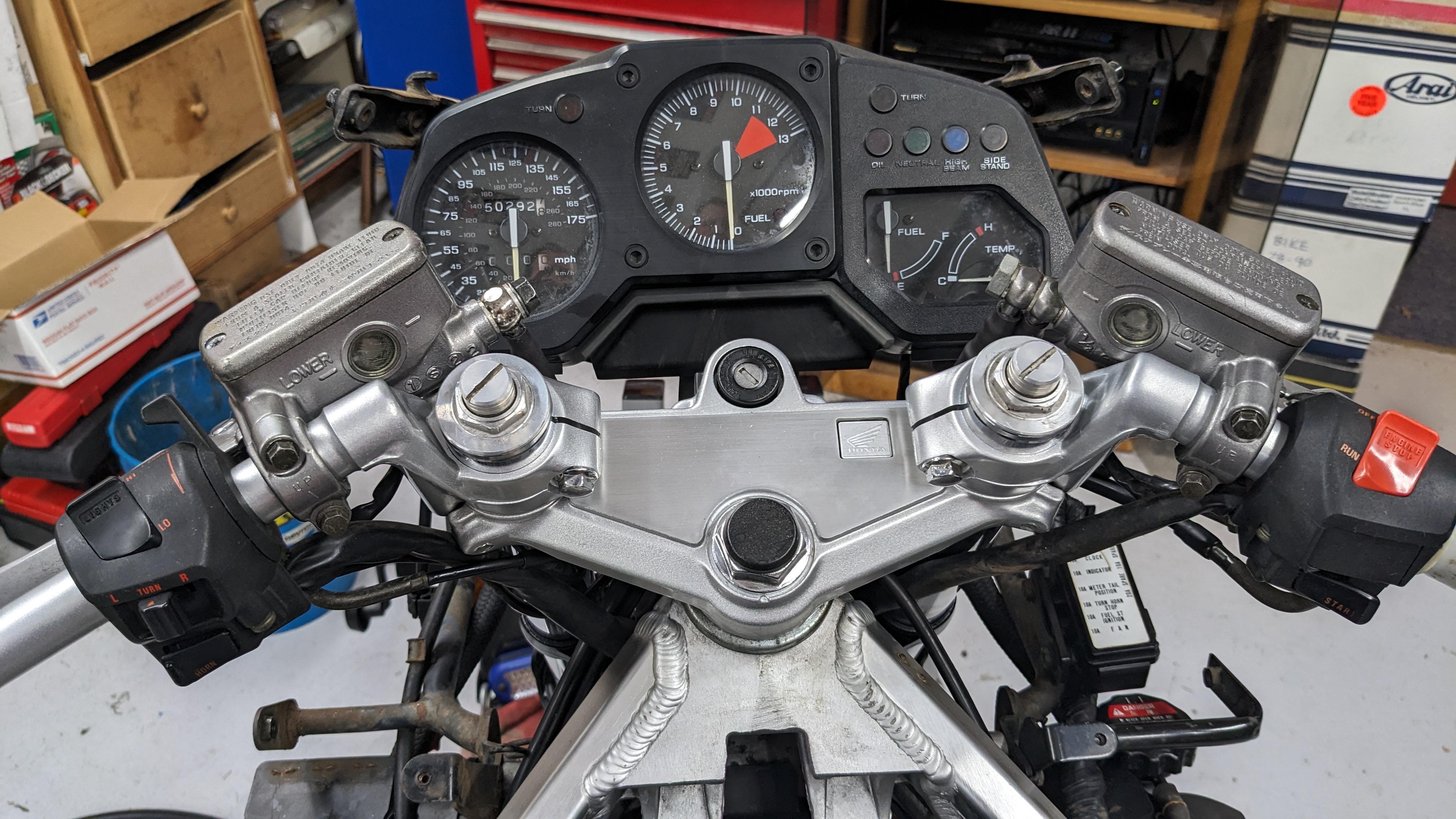

The top triple looks nearly scratch free. Did you refinish it or...
Are the wheels and fork legs painted, or polished ally?
Thank you!
I restored the top triple.  It looked like this...
Wheels are original 1992 painted finish, forks are original 1997 painted finish.  The wheels have quite a few imperfections that get lost after being polished and having everything bolted up.  The forks were some very nice low mile items I bought.

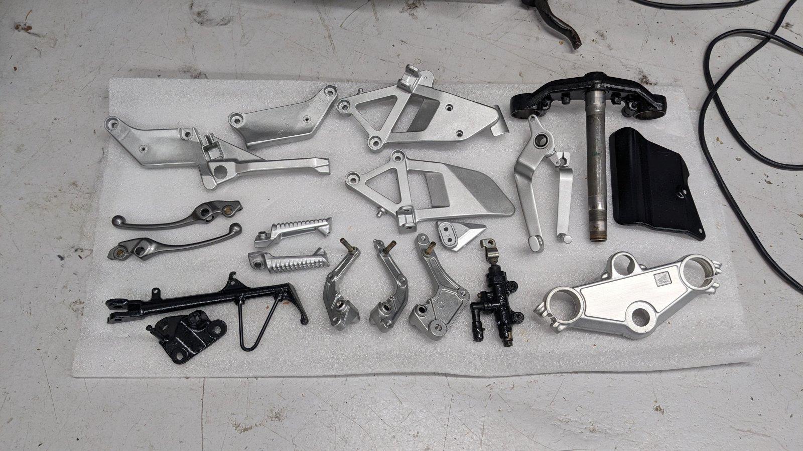

Here's some of the small items that were restored...
