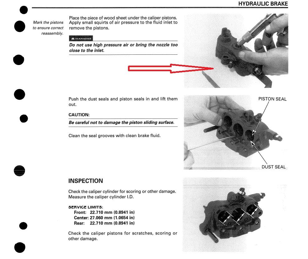

wawasonqo Posted March 17, 2023 Posted March 17, 2023 Hi Folks, Hoping I don't have to do this but ... Looking at the Parts Fiche diagram doesn't show any differences but the pictures of the Caliper Piston Seals, shown on the Online Stores and page 15-40 of the service manual, indicate they are. Just wish to confirm the difference is correct? https://www.davidsilverspares.co.uk/parts/by-part-number/partnumber_06451MZ2405/ https://www.davidsilverspares.co.uk/parts/by-part-number/partnumber_06431MA3405/ https://www.davidsilverspares.co.uk/parts/by-part-number/partnumber_06431MA3405P/ Is there another way to get the pistons out than the method described at the top of page 15-39 of the service manual? Thanks! Quote

Member Contributer Skids Posted March 17, 2023 Member Contributer Posted March 17, 2023 I assume you mean this method below using air pressure. Yes, there are tools you can get like pliers in reverse that you pull the piston out with. I'm sure someone has another method though. Quote
VeeEffArah Posted March 17, 2023 Posted March 17, 2023 Agree with Skids, but the air pressure method is the most direct and efficient. Some very old school guys use a grease gun, but is way too messy, IMO. Also, what "parts fische" are you using, as all the ones I see shows the piston sizes with the part numbers. So that would be confirmation of sizes for the corresponding seals for each. Quote
JimMoore Posted March 17, 2023 Posted March 17, 2023 Before using the compressed air you can remove the pads and pump the brakes to get the pistons started. When you use the compressed air, keep your fingers out of the way. The pistons will pop out with an alarming quickness! Quote
wawasonqo Posted March 17, 2023 Author Posted March 17, 2023 11 hours ago, Skids said: I assume you mean this method below using air pressure. Yes, there are tools you can get like pliers in reverse that you pull the piston out with. I'm sure someone has another method though. @VeeEffArah Yep. Could a wooden dowel and a rubber headed hammer be used do you think? Quote

Member Contributer Mohawk Posted March 18, 2023 Member Contributer Posted March 18, 2023 If you have a little tyre air pump, you can use it to pop the pistons out. As previously stated remove the pads & then place them both loose in the caliper. Then use brake M/C to pump pistons most of the way out. Then remove the pads & hose & drain the fluid. If you don't have a piston puller, clean & wrap the exposed piston ends with tape. Use small mole grips on the taped areas to wiggle them out the last bit. If you are replacing the pistons then you can forgo the tape. If they can't be wiggled out from there then move to next phase. Most pumps have a plastic tapered filler with a s schrader valve end, for what I don't know, but if you shorten it, it can be threaded into the banjo hole. Connect your pump & use something to keep the loosest piston from popping out. The pressure will then be applied to the tight one. Job jobbed. Quote

Member Contributer DannoXYZ Posted March 18, 2023 Member Contributer Posted March 18, 2023 What's wrong with using brake-fluid pressure to push piston out rest of way? As soon as piston clears end of bore, all pressure is released and it stops moving. Because fluid isn't compressed and there's little difference in volume between compressed and uncompressed fluid. Air-pressure on other hand, can build up quite high pressure depending upon how stuck piston is. It will continue to expand and push on piston even after it's out from caliper because compressed volume is so much smaller. Quite explosive and dangerous! 1 Quote

Member Contributer DannoXYZ Posted March 19, 2023 Member Contributer Posted March 19, 2023 7 hours ago, bmart said: How much do you enjoy being covered by brake fluid? Ask the other things nearby the same. Brake fluid doesn't come gushing out with explosive force! Watch the piston as you squeeze. As soon as piston leaves, you stop squeezing and get a tiny dribble, 1-2cc and that's it! Quote
Member Contributer Dutchy Posted March 19, 2023 Member Contributer Posted March 19, 2023 6 hours ago, DannoXYZ said: Brake fluid doesn't come gushing out with explosive force! Watch the piston as you squeeze. As soon as piston leaves, you stop squeezing and get a tiny dribble, 1-2cc and that's it! correct! Pay attention that both pistons come out equally. One may have to "block" one (with 2 pads packed together) to allow the other one to "catch up" 1 Quote
Member Contributer JZH Posted March 19, 2023 Member Contributer Posted March 19, 2023 8 hours ago, DannoXYZ said: Brake fluid doesn't come gushing out with explosive force! Watch the piston as you squeeze. As soon as piston leaves, you stop squeezing and get a tiny dribble, 1-2cc and that's it! Not using your method (which is what I do now), but if someone is using compressed air, it sure does! As I once sadly discovered, tiny droplets of brake fluid got everywhere in my garage--including on my other bikes' paintwork and windscreens. Some of those spots are still there to this day... Ciao, JZH 1 Quote
