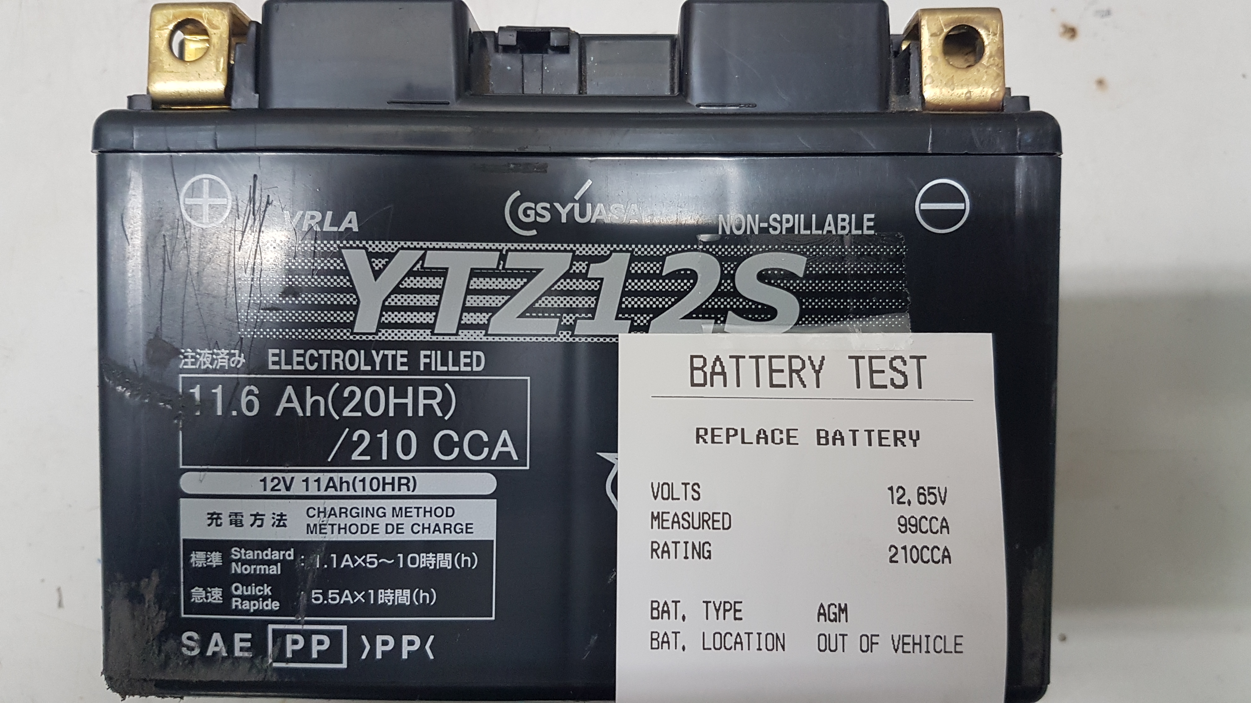

Member Contributer Grum Posted September 27, 2022 Member Contributer Posted September 27, 2022 Hi All. Sorry to post this info again. But seeing the OP is referring to his 2014 8gen exactly like mine, and he most likely appears to have battery issues. Thought I might once more add this valuable info. Battery terminal voltage does not represent the true health of the battery, its capacity to deliver plenty of cranking amps when needed. Here's the OEM battery from my 8gen. It would charge ok with no errors from my intelligent charger yet was reluctant to crank the Starter. As you can see its voltage was 12.65v but failed miserably when load checked. The Battery rated at 210 cranking amps could only deliver 99amps. A new battery solved my cranking issues. So the bottom line here is, any doubts about your battery, charge it, remove it, and take it along to any good Automotive Parts store where they will Load Check it for free. For the Aussies - I had this test done at both Autobahn and Supercheap Auto. Cheers 2 Quote
