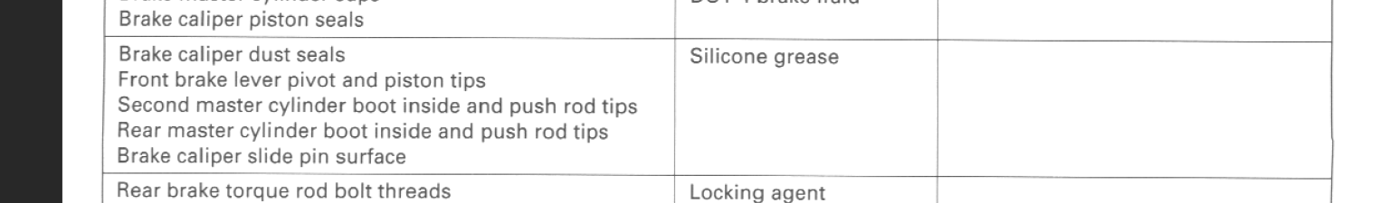

Member Contributer Terry Posted August 26, 2022 Member Contributer Posted August 26, 2022 I inject silicone grease using a syringe. Silcone grease is specified in the manual. Quote

Member Contributer Terry Posted August 29, 2022 Member Contributer Posted August 29, 2022 Not only is the manual old, but I am also old too. I've never even heard of ceramic grease. My 2017 Yamaha MT-10SP service manual also specifies silicone grease for brake slide pins. 1 1 Quote

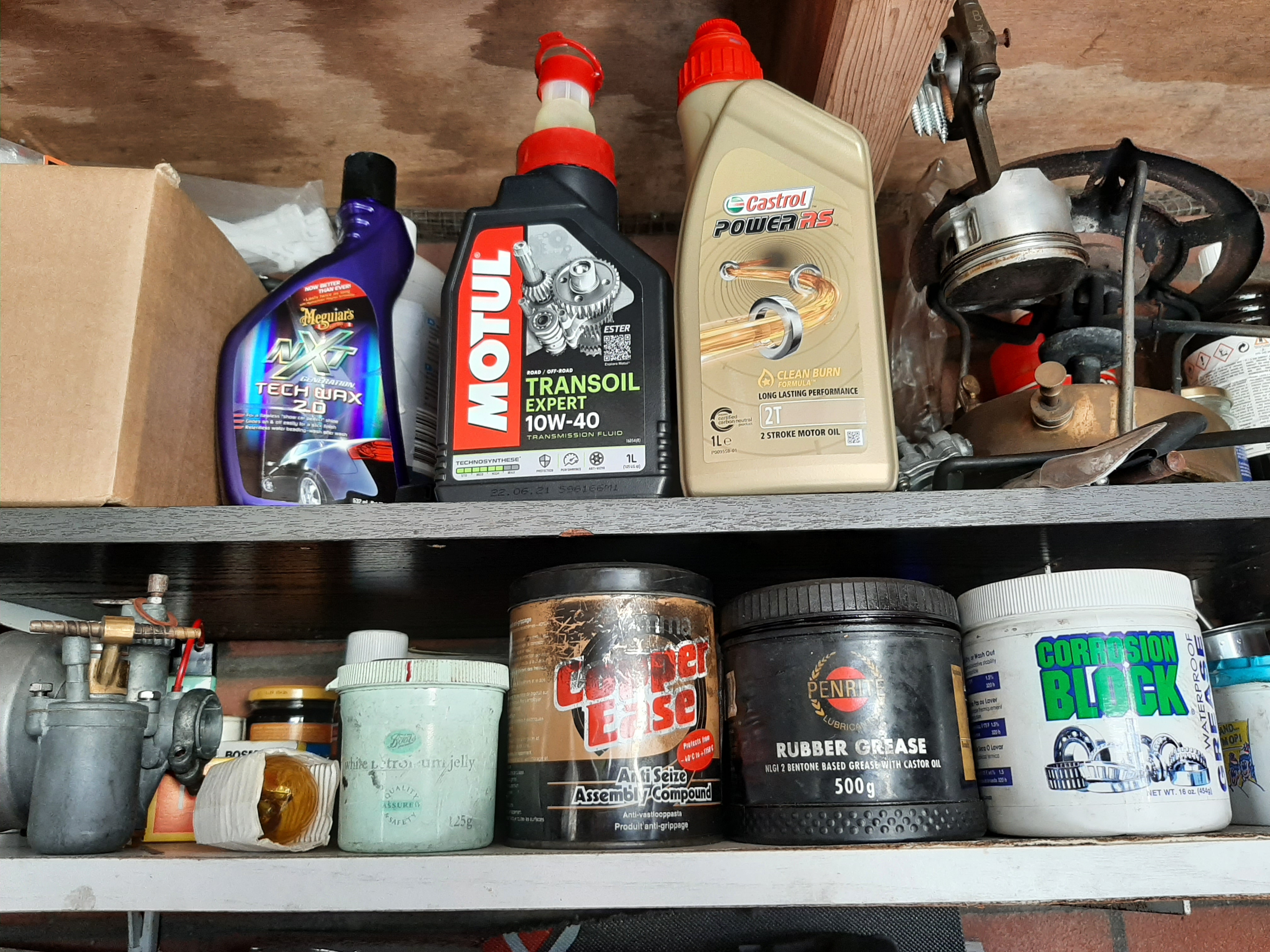

Member Contributer Dutchy Posted August 30, 2022 Member Contributer Posted August 30, 2022 The pot of general purpose grease and tube of MoS2 grease not here atm... The Copper Ease and BOOTS vaseline I bought in Scotland, back in 1989..... Quote
Member Contributer bmart Posted August 30, 2022 Member Contributer Posted August 30, 2022 I think that we need a new thread with pics of shelving and all of our stuff on it! 1 1 Quote
