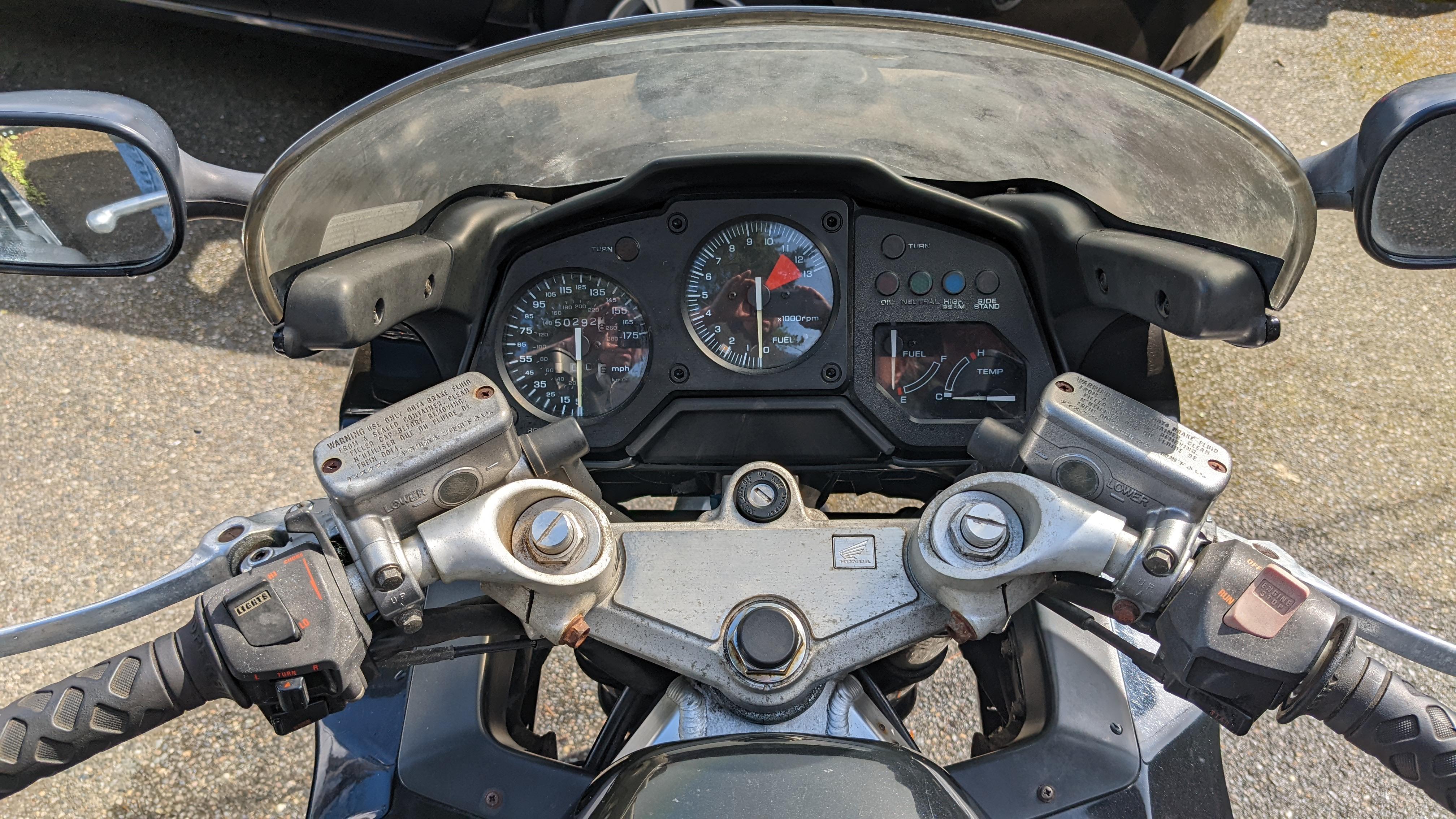

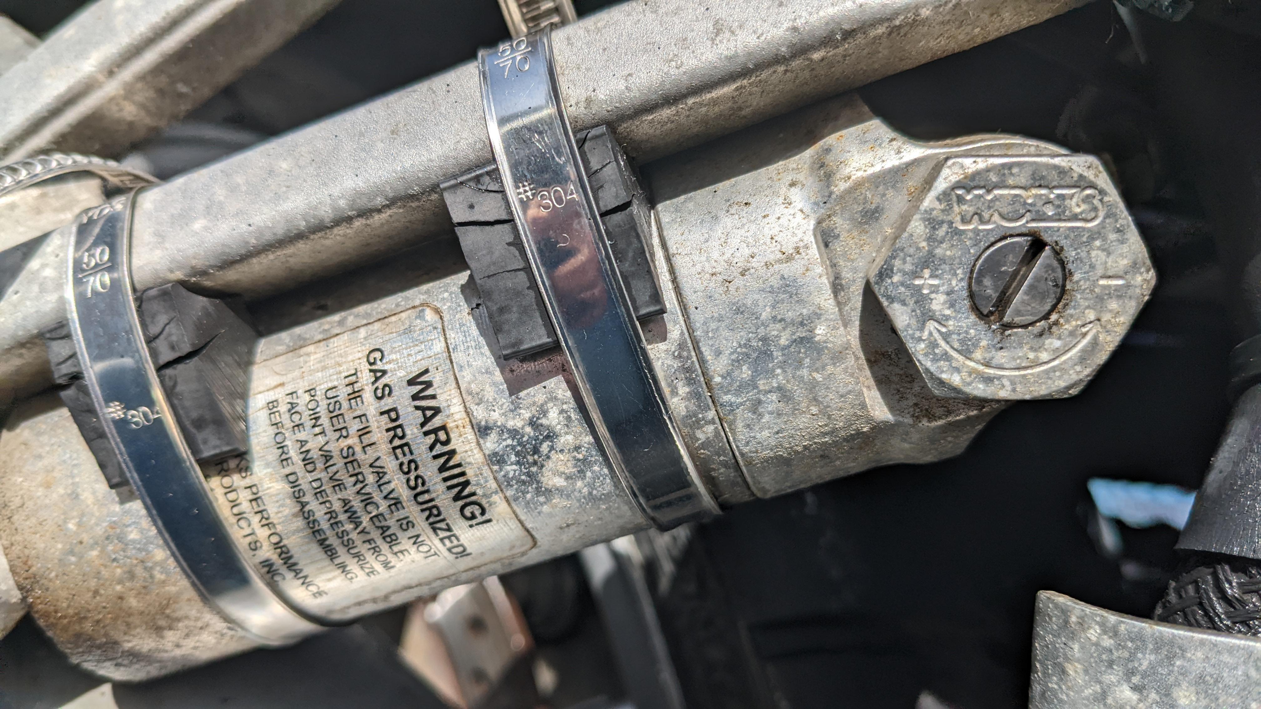

Member Contributer Captain 80s Posted April 11, 2022 Member Contributer Posted April 11, 2022 50K with Title. Tank is spotless inside. 2020 tabs, so not sitting forever. All trim pieces present, except for the side stand cowl... of course. Accessory center stand. No seat cowl. Been working on this deal for months. Helibar Clip ons, which were a surprise. They will be sold. The other surprise.... Works Performance Shock. They all can't be $400. Had to pay $500. They are getting hard to find in moderate, complete condition. This one is the keeper for Resto. 4 Quote

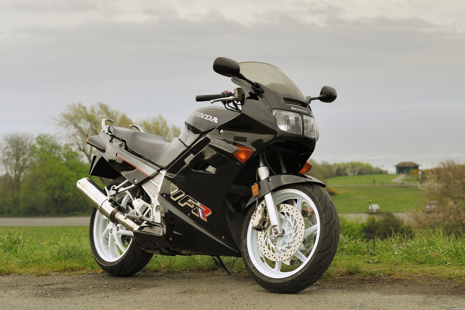

Member Contributer Lorne Posted April 12, 2022 Member Contributer Posted April 12, 2022 10 hours ago, Captain 80s said: ...if it is "black" (Granite Blue) it will get some graphics that do not incorporate purple. Graphics without the purple, eh? There are two other graphics that Honda used on black 3rd gens that both look better than the purple set you have. I changed to this VFR graphic on mine a few years ago, and have a spare set if you decide on black. then I used some red pinstripe tape to cover the purple on the swish stripe under the seat. I also painted the wheels pearl white, and stripped the fork lowers then polished 'em by hand with emery paper/scotchbrite & Solvol Autosol. Two years and 20K km later the forks still glistened. Swapped on an old Supertrapp muffler and a set of Y2K VFFR800 mirrors, too. I should have kept this VFR - ah the impatience of youth. 4 Quote

Member Contributer Lorne Posted April 12, 2022 Member Contributer Posted April 12, 2022 Forgot to note 2: if you want slightly higher handlebars but still want them to look factory and option is to fit a set of '98-'01 VFR800 'bars. They are about 16mm / ⅝ " taller, but require a little trimming as the locating pin is in a different location. The bars from VTec VFR800s can fit but require a 1mm shim as they use 43mm forks. Lastly, if you find that your gas tank makes a buzzing sound when the fuel level is low there is a way to fix that. There is a spot welded brace just ahead of the filler opening that can vibrate. If I find the Honda maintenance video I'll post a link. 1 Quote
Member Contributer Cogswell Posted April 12, 2022 Member Contributer Posted April 12, 2022 23 minutes ago, Lorne said: Graphics without the purple, eh? There are two other graphics that Honda used on black 3rd gens that both look better than the purple set you have. I changed to this VFR graphic on mine a few years ago, and have a spare set if you decide on black. then I used some red pinstripe tape to cover the purple on the swish stripe under the seat. I also painted the wheels pearl white, and stripped the fork lowers then polished 'em by hand with emery paper/scotchbrite & Solvol Autosol. Two years and 20K km later the forks still glistened. Swapped on an old Supertrapp muffler and a set of Y2K VFFR800 mirrors, too. I should have kept this VFR - ah the impatience of youth. That's it! Quote

Member Contributer Lorne Posted April 12, 2022 Member Contributer Posted April 12, 2022 1 hour ago, Cogswell said: That's it! You have good taste, mon ami. Quote

Member Contributer Captain 80s Posted April 12, 2022 Author Member Contributer Posted April 12, 2022 16 minutes ago, bmart said: I like the stock colors. Just clean and and don't paint it! That's what will happen initially. I'll go thru all the systems, remove the PAIR / CA bullshit, completely rebuild the carbs. Give it a few really good baths and a detail. Shock needs to be rebuilt, forks seals leak, and it needs tires. The Purple is gone at some point tho. Quote

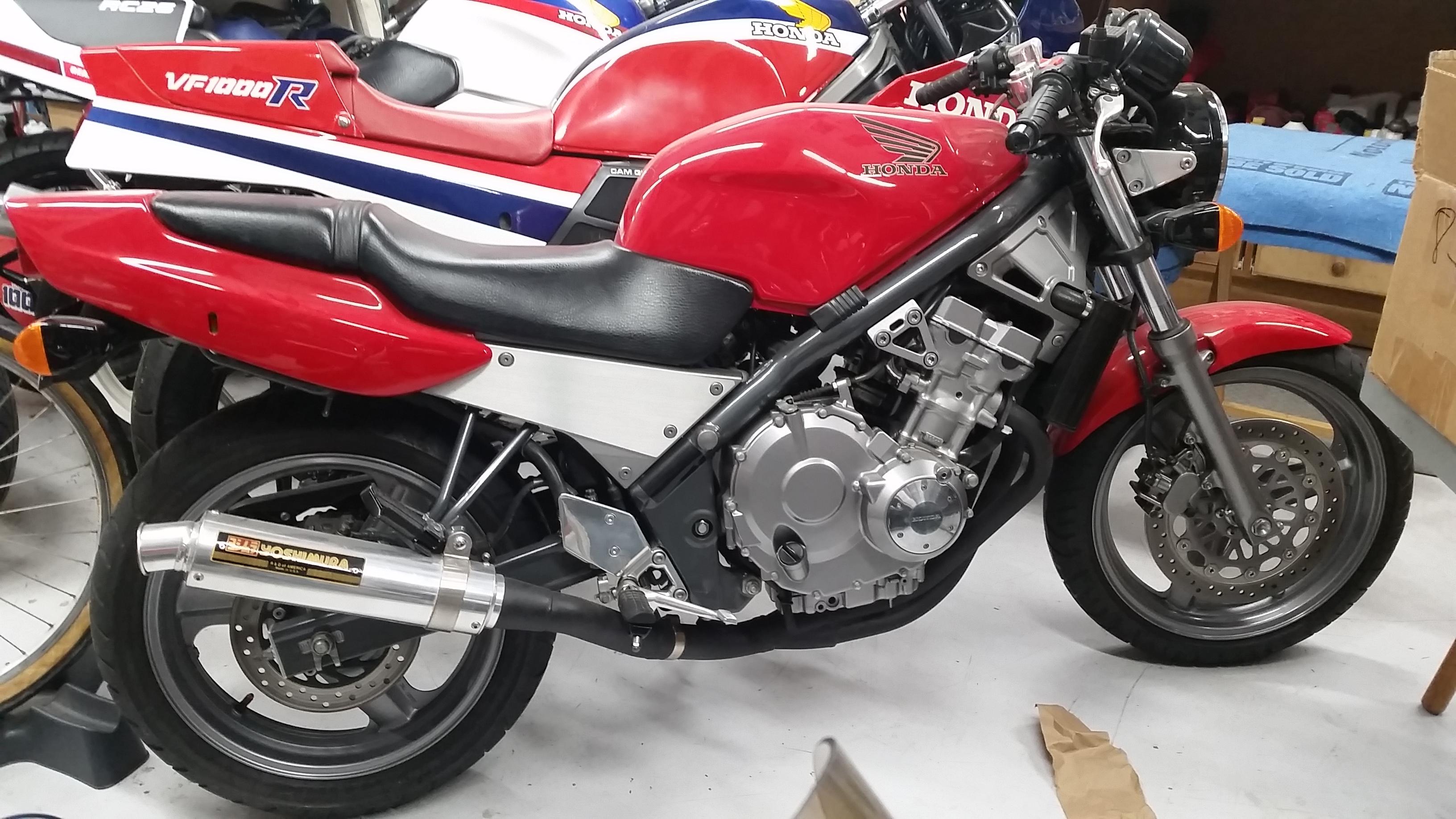

Member Contributer Captain 80s Posted April 12, 2022 Author Member Contributer Posted April 12, 2022 33 minutes ago, Hingley said: When the time comes I will be interested in seeing the final paint colours I have a 1992 VFR750 I bought as a spare, it was owned by a guy who was learning the art of powder coating, so my 91 has dark gray wheels like the 1992 ( Captain 80s has ) and the brake calipers were done in candy red. The previous owner did such a nice job I kind of hate to have the wheels and calipers redone, so I am keen to see what others have come up with for different color combinations Was never a fan of black but the 92 with white wheels from BC Canada looks great I see you have a CB-1. I restored one for my wife where I changed up the colors for something different, but so it still looked like Honda could have done it that way. I'll have a similar approach to the 92 VFR. 1 Quote
Member Contributer Hingley Posted April 12, 2022 Member Contributer Posted April 12, 2022 Very nice indeed, That CB1 looks far better in Red than the original Blue. I redid my CB1 years ago and I must see if I have a picture or two to share, I went with a bright silver with a seat cowling something like the RC30 with white painted number panels on the sides. You are making me want to get that old girl out into the daylight again. Quote
Member Contributer DannoXYZ Posted April 12, 2022 Member Contributer Posted April 12, 2022 Yeah! Red looks much better than original blue! Quote
Member Contributer Captain 80s Posted April 12, 2022 Author Member Contributer Posted April 12, 2022 4 hours ago, DannoXYZ said: Yeah! Red looks much better than original blue! 1994-97 VFR Red with a little extra gold metallic. It absolutely POPS outside. I was surprised how different it was sitting next to my 1995 VFR. Quote
Member Contributer tbzep Posted April 12, 2022 Member Contributer Posted April 12, 2022 1 hour ago, DannoXYZ said: Yeah! Red looks much better than original blue! I was thinking the CB-1 was available in red at one time. Maybe it was just the NT-650 Hawk, which has a similar silhouette. Quote
