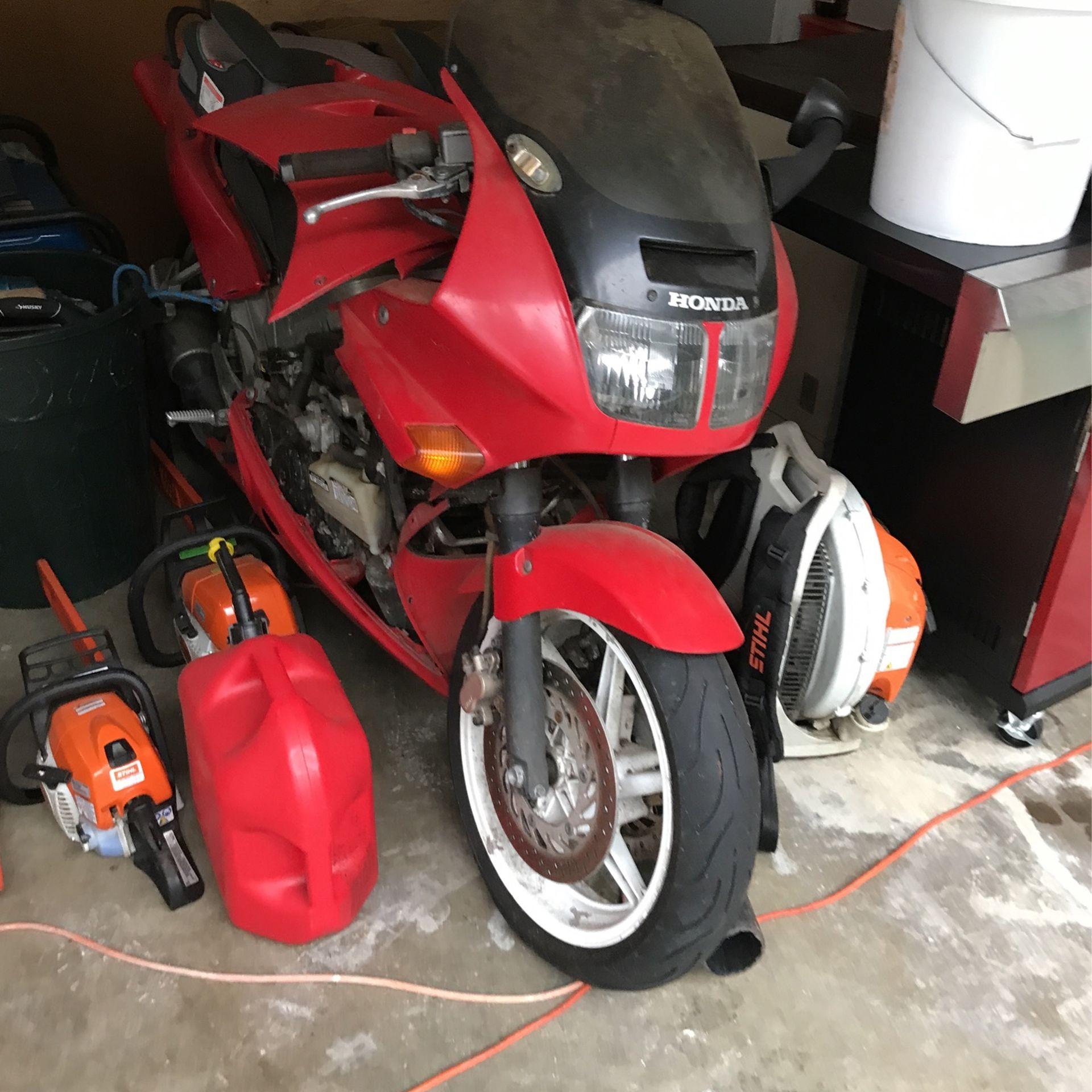

It's on. We make arrangements for DEC 23rd, my first day off for the Holidays. It's a ferry ride over to Kingston with a trailer, so a $30 tab there. Then down the peninsula to Port Orchard. Couple hours easy. Get there and it's a beauty day, so I'm able to roll it out of the spot you see in the above pic.
First thing... Fox Twin Clicker. Good start. The 8 spoke wheel is probably worth what I'm paying anyway, so no risk really. It's all there. Tank is off, but it is drained and 100% clean on the inside. Fuck yes. Original Honda key, owner's manual and tool kit. Asked about a seat cowl and he just looked puzzled... "never mind". New chain and sprockets (chain is pretty rusty). Essentially brand new (5 years ago) Michelin Pilot Power tires. Steel braided lines up front. 70K miles... doesn't really matter on these engines. Look down at the shiny oil filter and pop the dipstick. Oil looked like it just came of a bottle. Cool. It got ridden home from the shop and pretty much parked. Notice the drain plug and adjacent oil pan has been drilled... that actually makes me happy. It means somebody might have gone thru the front end to match the rear shock at some point for a track day or few. The forks feel like they have real springs in them and somebody updated to the later fork caps with pre-load adjustment.
He shows me the "one small part" it needs. "I think it's some kind of fuel separator or something". I am playing dumb. "yeah? huh." It's a plastic vacuum valve with a broken nipple for the emissions that is gonna end up in the trash anyway. "Fuel was coming out of that broken off part". I know it's just dirty carbs at this point.

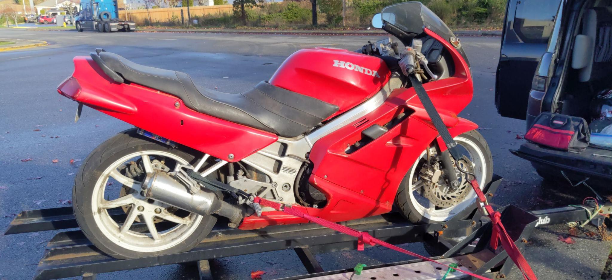

"you said you'd take $400?" "yep" Exchange money and title / bill of sale and load it up.
27991738_signal-2021-12-23-12-07-17-6481.thumb.jpg.1d85b9da08e23aa80fb332c488785f38.jpg
Not pretty but hey. Every piece of bodywork has issues, but that tank is really nice. Oh yeah, a Corbin... whatever. Decide to make it a big round trip and drive around thru Tacoma (over a toll bridge) and back up thru Seattle. I left around 9am and got home around 3pm. Pretty good day. At least it was a beautiful day for driving.

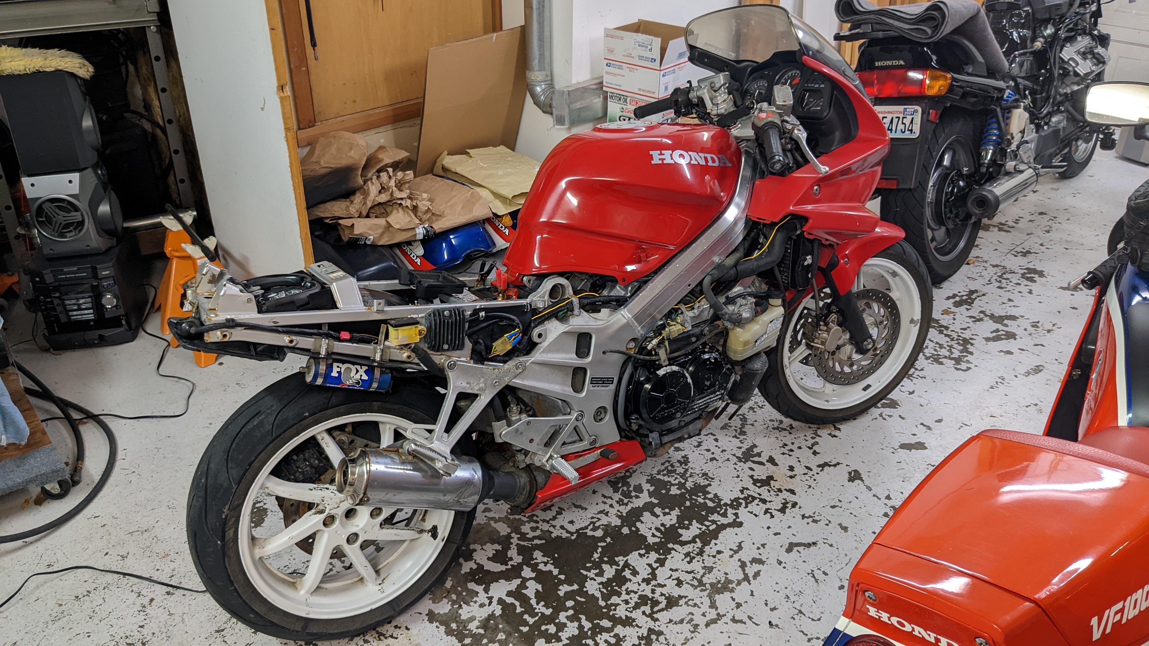

Here's back home after a quick strip.
So the winter plan is to clean the carbs and get her running. The carbs are already out and while not great they are not terrible. Very doable. I already have the PAIR system and emission crap eliminated. I bought a 2003 rear wheel to replace the 8 spoke for personal use on my 95 (likely). Then go thru the systems and make it ride-able.
Brakes front and rear are sticking and need to be serviced. Hopefully the pistons aren't pitted.
Flush the coolant system.
I'm sure the fork seals are gonna start leaking the next time I just look at them.
I have a plan for adapting a slip-on (D&D), I think it's gonna work perfect.
Stock 1993 shock on the way (w/ rebound damping) so I can remove the Fox for rebuild (it still passes the critical seat-bounce test we all learned on showroom floors).
New inner / rear fender to replace this hacked unit.
Try and go thru the bodywork to make it mount better and look more presentable.
Gonna modify the passenger peg brackets to remove the peg portions.

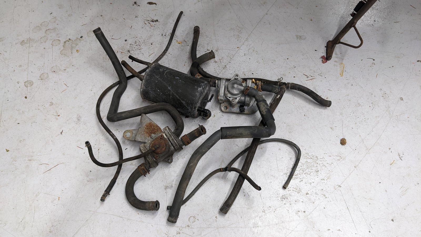

Goodbye 5 pounds of bullshit.

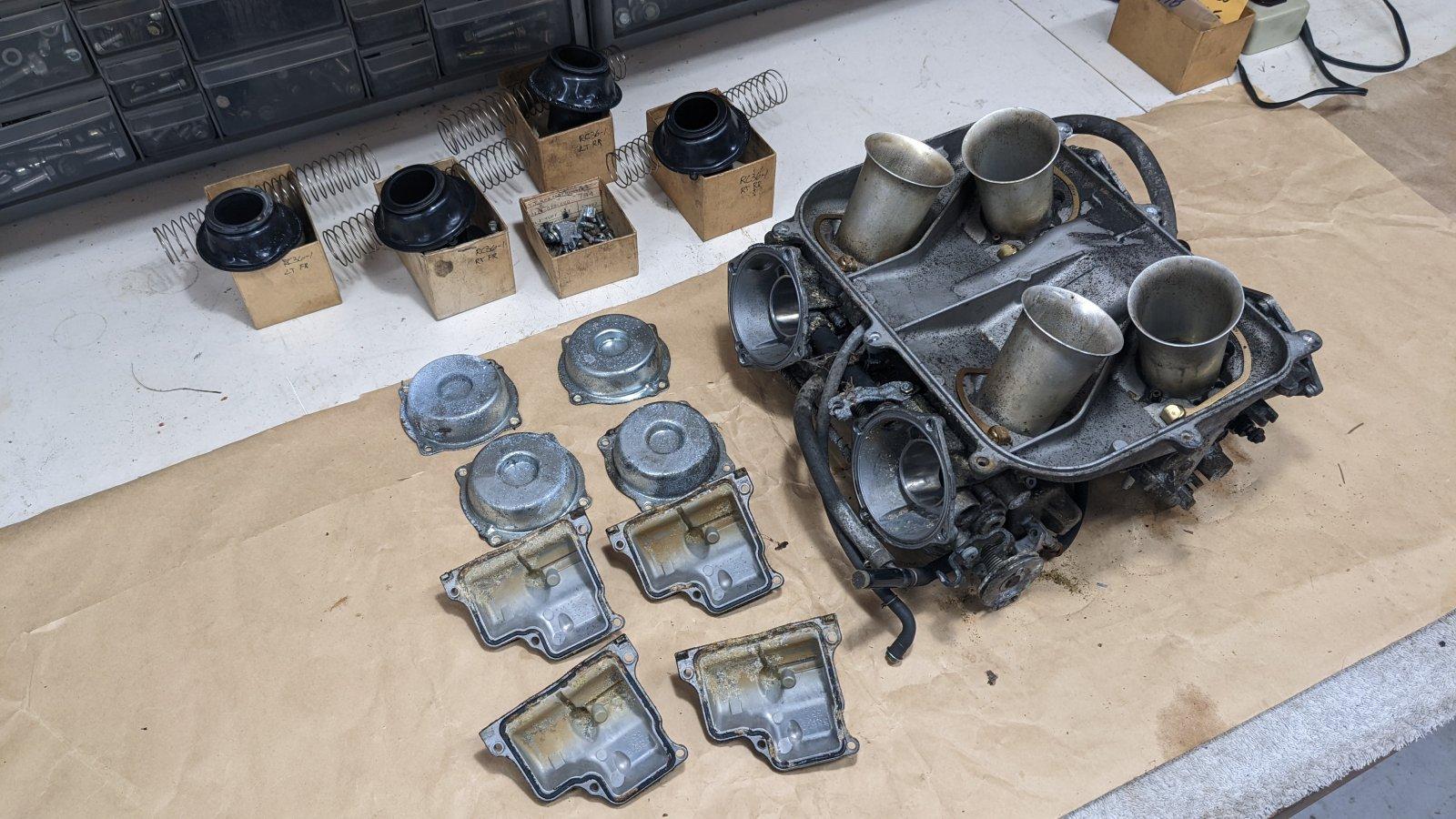

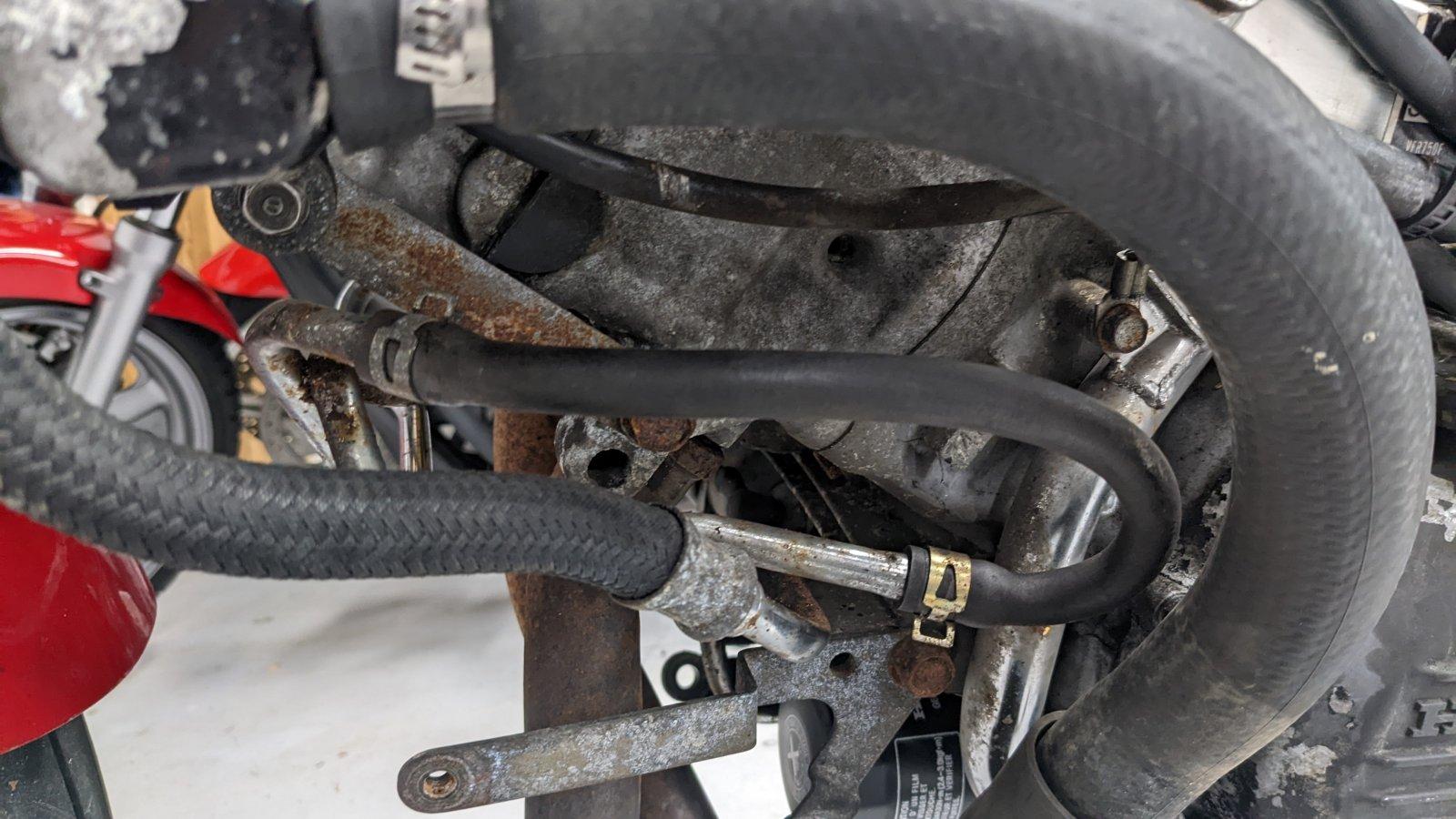

Pulled the carbs and removed the emissions / PAIR CRAP. Later I will remove the hard lines from the heads and use the fittings to create block off plates. Since I can't get to the rear right now I just decided to loop back on themselves, which I've done before.

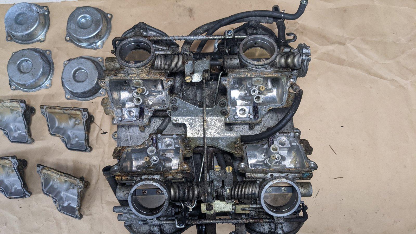

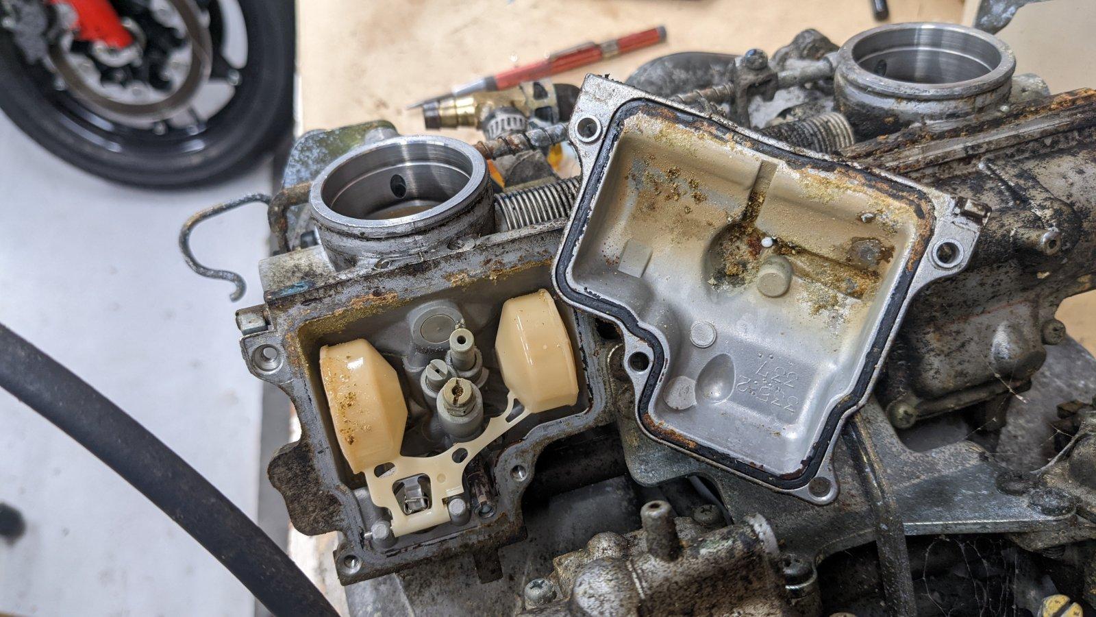

I've dealt with worse. This is the left rear carb.
Carbs are apart. The outside is pretty nasty, but the insides all look pretty damn good.
I'm not going to break the carbs apart right now. They will get a full cleaning and bench synch only. The needles were shimmed, pilots are stock at 38 (for CA) and the mains are still #130 (49 & CA). I think the boots will be supple enough with some heat to re-install just to verify how the engine sounds. Then some decisions will be made, like coolant o-rings and alternative jetting. With all the extraneous shit removed around the carbs, they come out pretty easy.

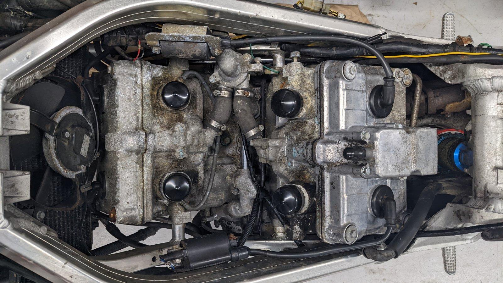

V of the motor with 70K miles and then sitting in some weather for a few years. Not pretty.

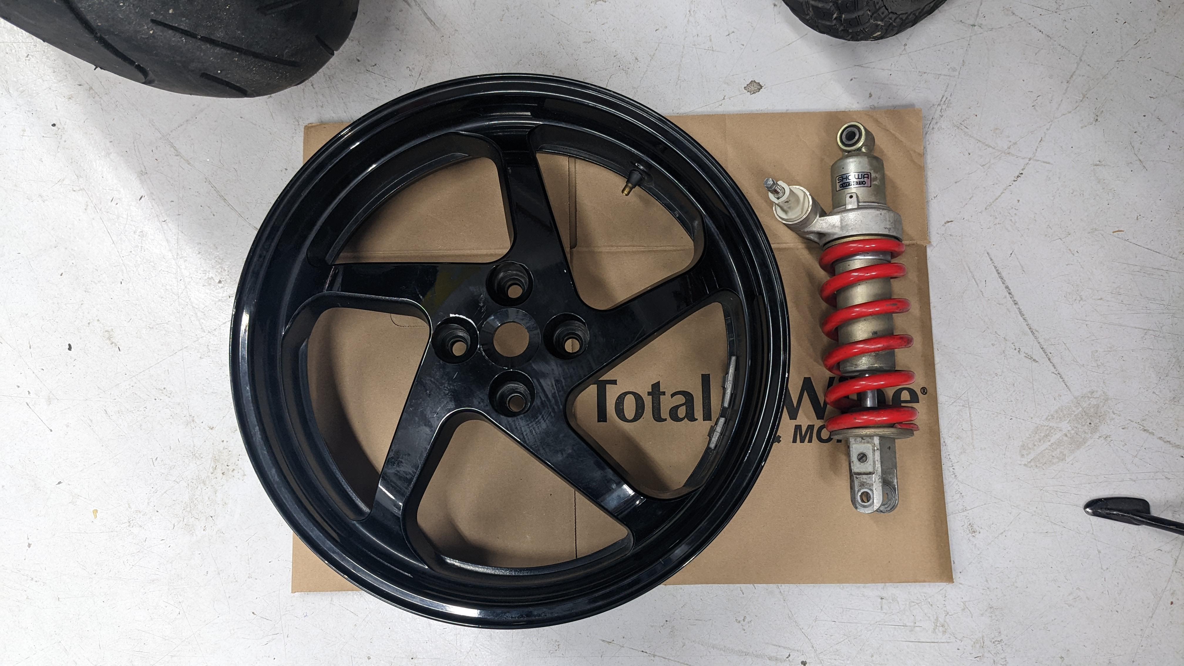

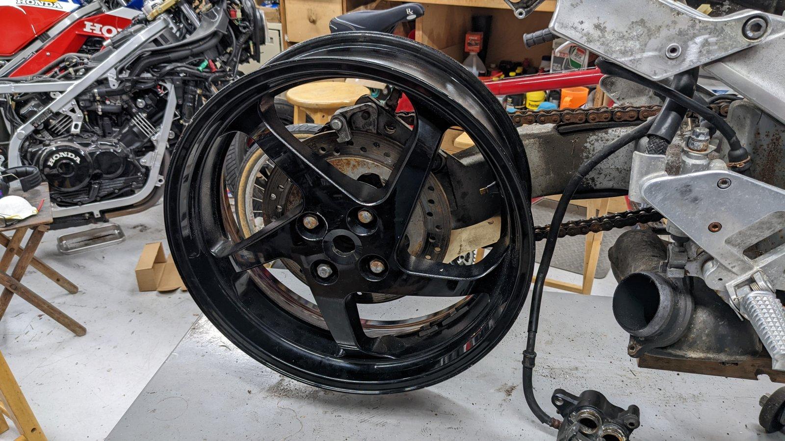

New wheel to replace the 8 spoke. 2002 5.5". Pretty sure I will need to machine some reliefs for the rotor nuts, no big deal. Regardless if I keep this bike or not, the 8 spoke wheel will likely not be staying on it. Low mile 1993 shock so I can remove the Fox TC. 1992-93 shocks got aluminum lower clevises with rebound adjustment. The Fox shock will likely not be returning either, I have other plans maybe. In any case it needs to come out for a cleaning and service.
I am on the fence with removing mine. It looks a lot more complicated than the ones I removed from my Kawasakis. How easy is it to source the blocking plates?
You can get them on eBay for about $30 if you don't wanna make your own from the hard lines fittings you are removing.
6-Sigma Block Plates - eBay
It's not complicated at all.  Just plugging any EXTRA vent or vacuum ports / lines that are left over.  Seeing the pile of junk on the floor when you're done is very gratifying.
The biggest problem people have is not being able to identify what is a vent or vacuum and what is supposed to remain routed or what is extraneous from the PAIR and/or CA emissions.  A methodical, logical approach makes it easy.  At least in my experience, but I've probably done more than 10 now, easy.

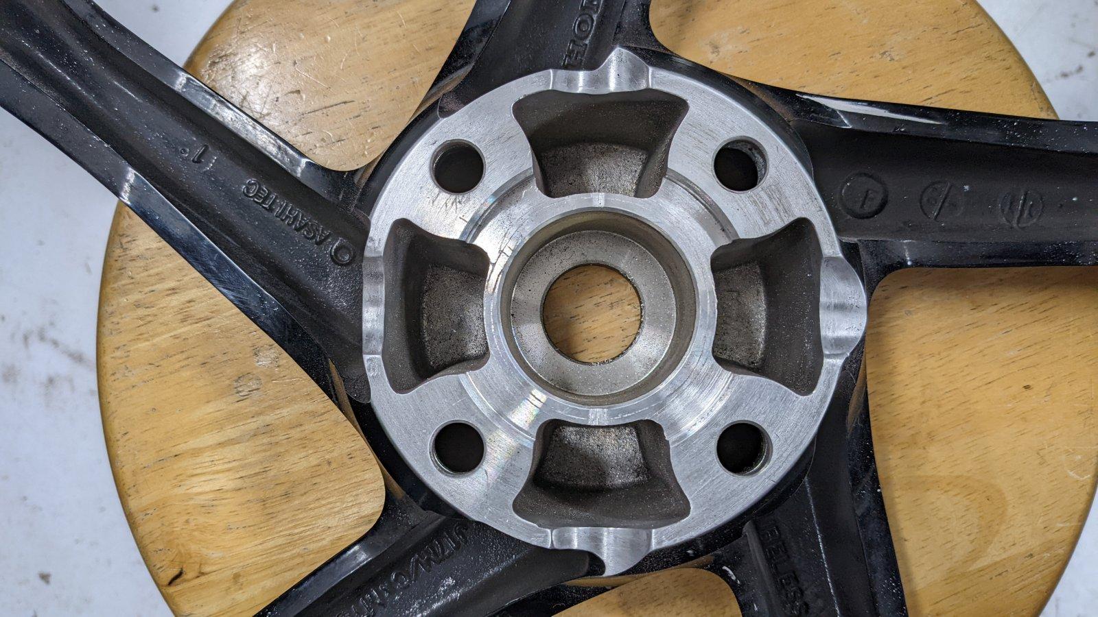

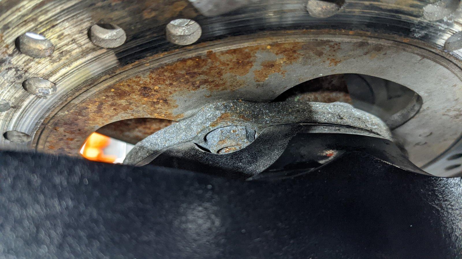

Rear wheel machined for rotor hardware clearance.

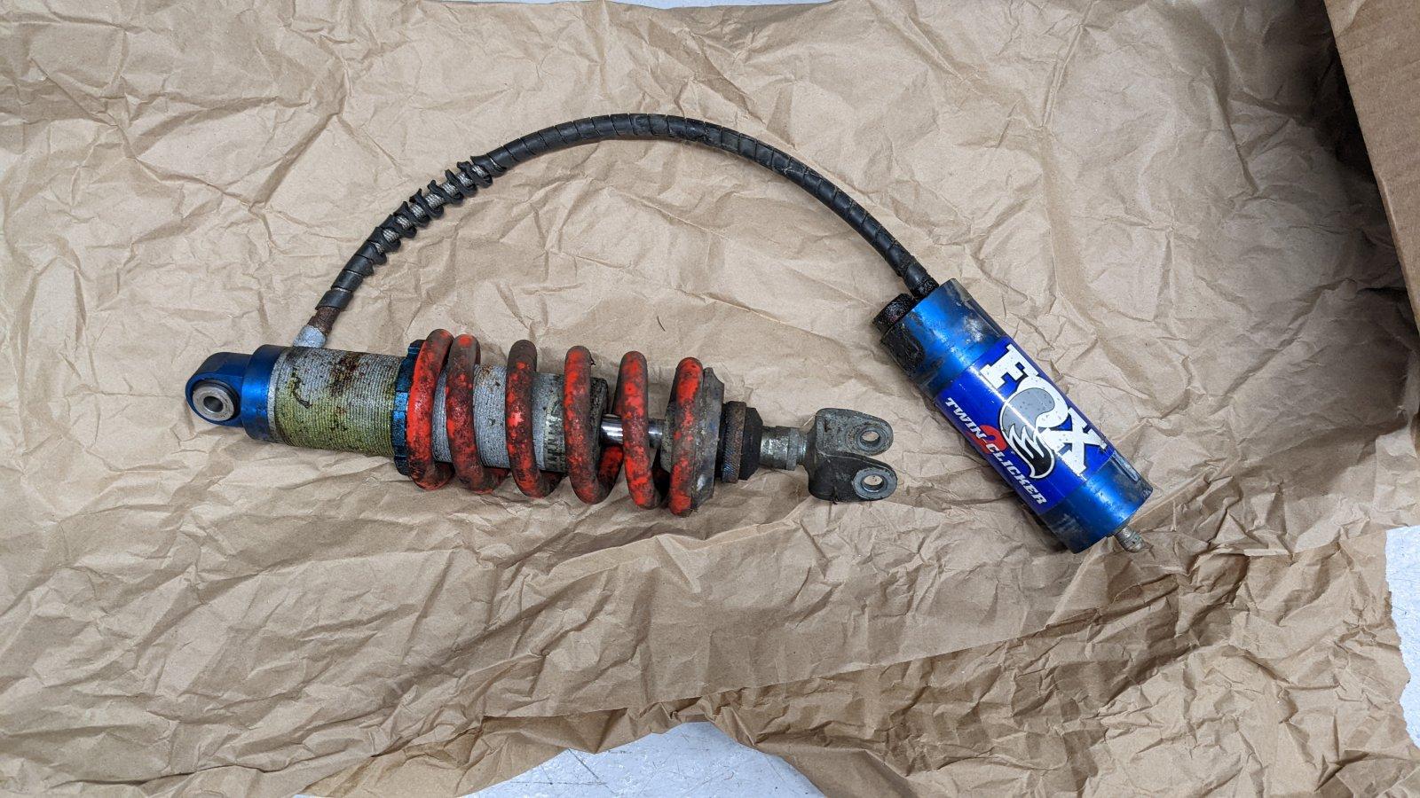

Fox Shock out.  It looks corroded, but it's really just mostly dirty.  The green is shock fluid...  bleh.

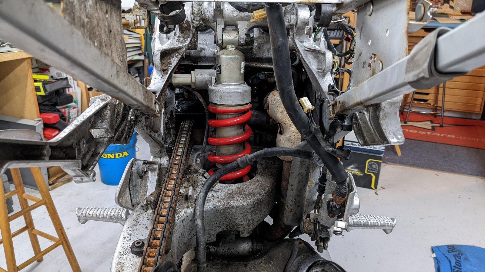

Low mile 93 shock in.  It responds to damping adjustments, so that's cool.
