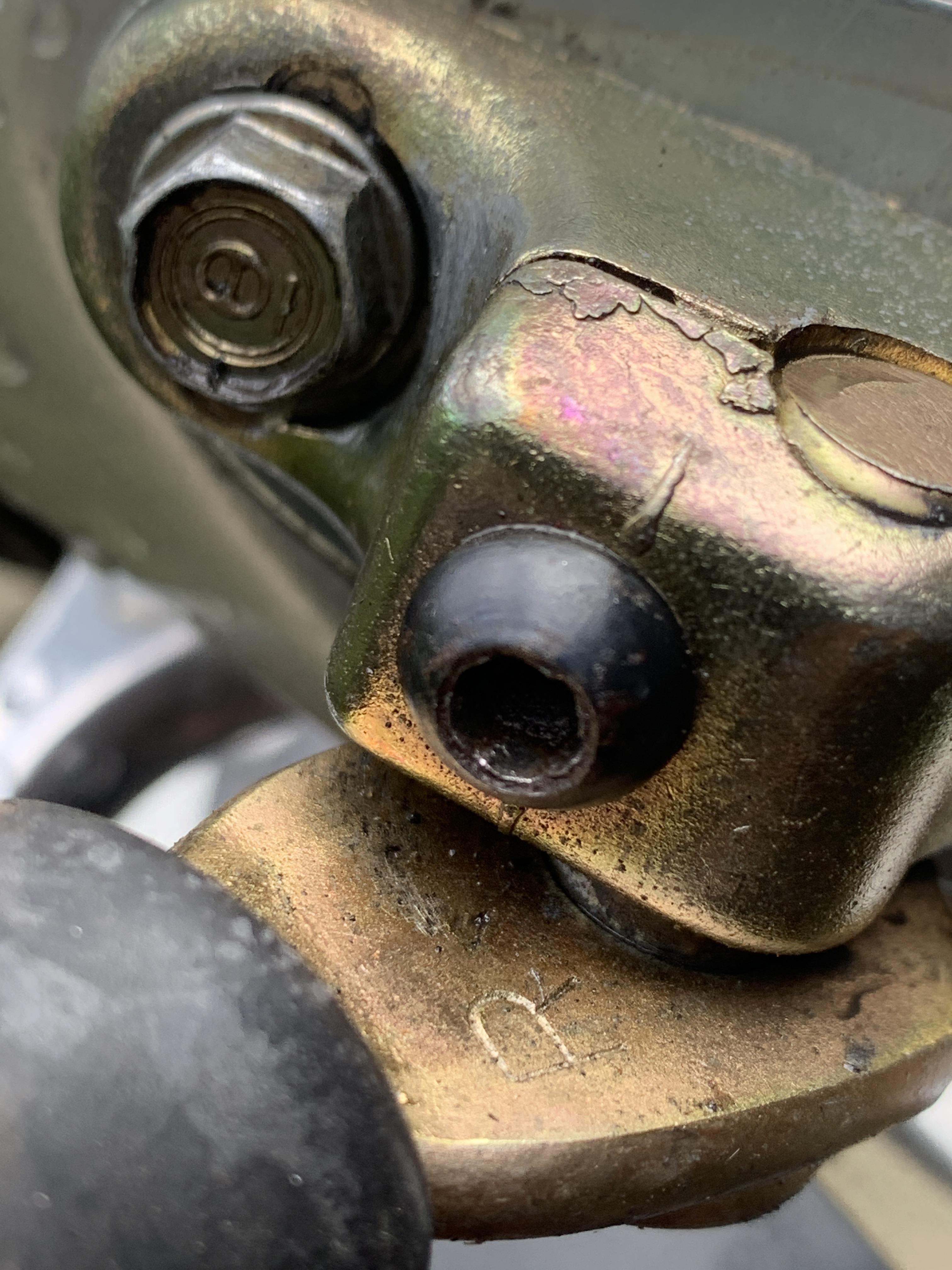

zanshen Posted September 19, 2021 Author Posted September 19, 2021 Hi all hope you’re well . Got bike back and all is running well. They replaced the wiring loom and that seems to have been the problem. On another note does anyone know where I can source this Allen bolt for my 1998 mirror. Thanks again. Paul Quote
Member Contributer DannoXYZ Posted September 19, 2021 Member Contributer Posted September 19, 2021 any corner hardware store should have them. Also bicycle shoppe Can also order them from here: https://www.mcmaster.com/screws/rounded-head-screws/hex-drive-rounded-head-screws/metric-alloy-steel-button-head-hex-drive-screws/ 1 Quote
zanshen Posted September 19, 2021 Author Posted September 19, 2021 4 hours ago, DannoXYZ said: any corner hardware store should have them. Also bicycle shoppe Can also order them from here: https://www.mcmaster.com/screws/rounded-head-screws/hex-drive-rounded-head-screws/metric-alloy-steel-button-head-hex-drive-screws/ Thanks mate Quote

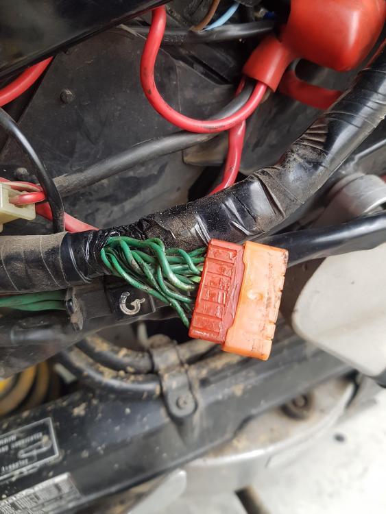

Member Contributer ducnut Posted September 20, 2021 Member Contributer Posted September 20, 2021 If anybody is wondering where to find the ground block, it is here, wrapped in black tape from the factory. 2 Quote

Member Contributer JZH Posted September 21, 2021 Member Contributer Posted September 21, 2021 On 9/19/2021 at 1:48 PM, zanshen said: Hi all hope you’re well . Got bike back and all is running well. They replaced the wiring loom and that seems to have been the problem. On another note does anyone know where I can source this Allen bolt for my 1998 mirror. Thanks again. Paul The problem is probably more than the rounded bolt head. It probably got rounded because someone was trying to tighten it around an increasingly slipping mirror shaft. FYI, you can directly swap the mirrors from the Y2k-01 model onto your '98; those mirrors don't have the "condoms" and generally work better. You can also get aftermarket Y2k mirrors, but I've never found any non-OEM versions with the same quality as OEM. Ciao, JZH Quote
zanshen Posted September 21, 2021 Author Posted September 21, 2021 1 hour ago, JZH said: The problem is probably more than the rounded bolt head. It probably got rounded because someone was trying to tighten it around an increasingly slipping mirror shaft. FYI, you can directly swap the mirrors from the Y2k-01 model onto your '98; those mirrors don't have the "condoms" and generally work better. You can also get aftermarket Y2k mirrors, but I've never found any non-OEM versions with the same quality as OEM. Ciao, JZH Thanks again mate. So the Yk2 bolt straight on then. Quote

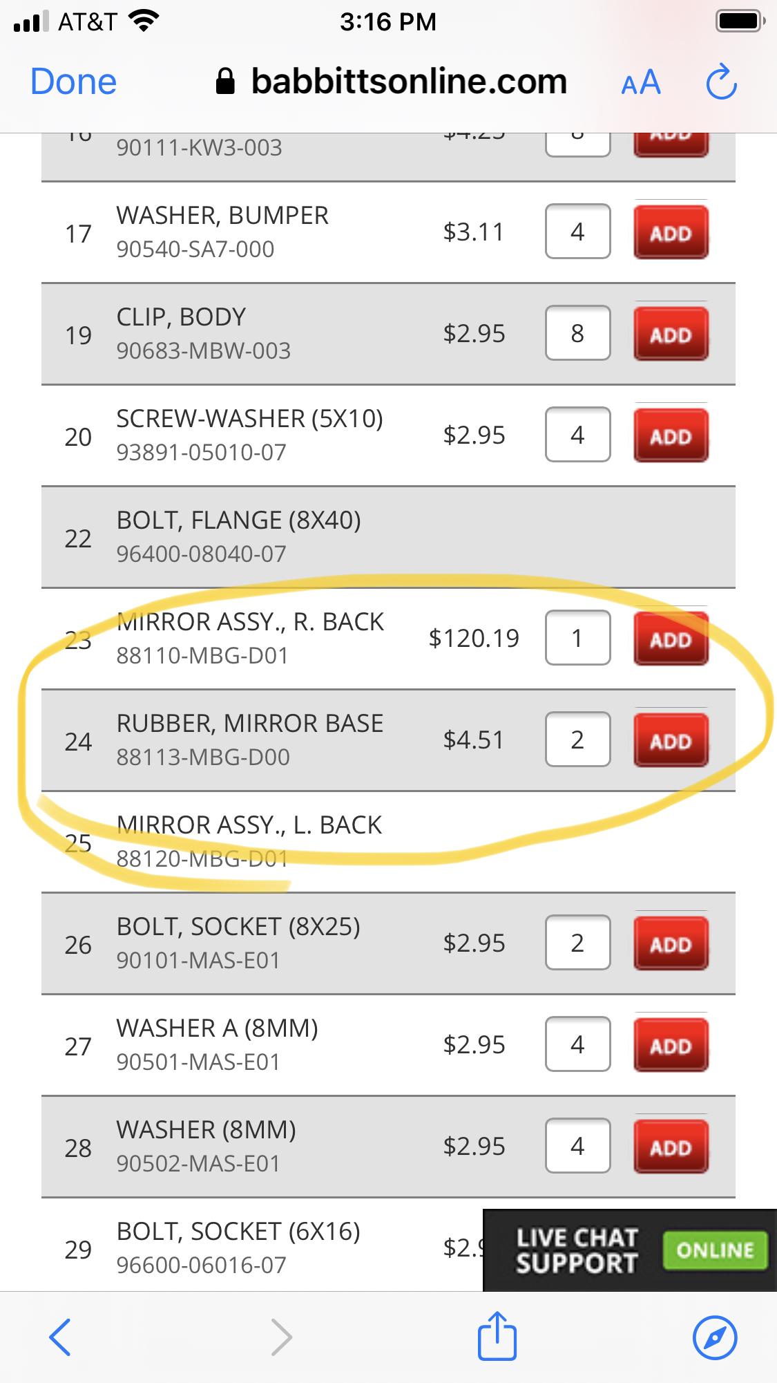

Member Contributer ducnut Posted September 21, 2021 Member Contributer Posted September 21, 2021 37 minutes ago, zanshen said: Thanks again mate. So the Yk2 bolt straight on then. You’ll need 2 of these, as the ‘98-‘99 base is a different shape from the ‘00-‘01. 1 Quote
Member Contributer Grum Posted September 21, 2021 Member Contributer Posted September 21, 2021 On 9/20/2021 at 11:49 PM, ducnut said: If anybody is wondering where to find the ground block, it is here, wrapped in black tape from the factory. +1 And on a 5gen its located just above the chain guard. 2 Quote
