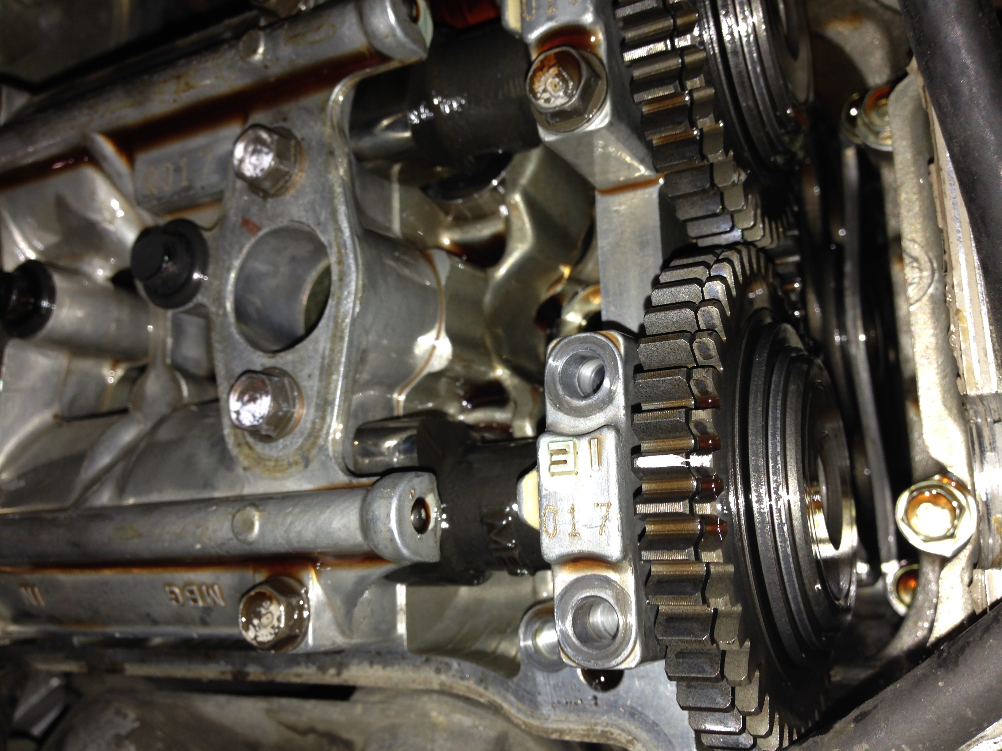

Member Contributer Terry Posted December 12, 2020 Member Contributer Posted December 12, 2020 On 12/11/2020 at 1:48 AM, JimMoore said: That's interesting. I may have to give it a try. That job is so hard on my CBR600 that I've just about convinced myself that shops never do it. They just take the money and tell you it's good-to-go. The VFR is an easy starter bike to learn on when it comes to the valves. The rear cylinder head is easy to get to so you can easily see what you are doing. The picture below shows a marked gear tooth sitting next to a reference point on the cam saddle. The only slightly offputting thing is the split gears are sprung apart and don't look to be exactly right until you tighten the cam saddles down and pull the teeth into alignment. I usually only work on one cam at a time and don't touch the crank so as not to mess up. I bought a Hotcams shim kit a few years ago, so I don't need to wait on any parts from a dealer once I start. A small 1/4" torque wrench is a good investment for peace of mind and avoidance of breaking things! 2 Quote
JimMoore Posted December 12, 2020 Posted December 12, 2020 Cool. Thanks. Why are the gears split like that? Any idea? Quote
Member Contributer Grum Posted December 12, 2020 Member Contributer Posted December 12, 2020 1 hour ago, JimMoore said: Cool. Thanks. Why are the gears split like that? Any idea? From what i can remember. The split spring loaded gears create a constant positive mesh so there is never any buildup of backlash or gear wear as the years go by. Quote
Member Contributer Skids Posted December 12, 2020 Member Contributer Posted December 12, 2020 Just read this thread. To the OP, I rode a 5th Gen for 130k miles and managed virtually all the servicing myself (with a little help) including the 16k valve check and if I can do it, anyone can! Once the plastics and tank are out of the way, it's simply do A, then B, then C and as long as you follow the manual, it really is easy. Likewise the starter valve check/adjust - it is imperative that it is regularly done. I did it every 4k miles which seemed to work fine for me. Again, it is simple enough. As to the 5th vs 6th vs 8th debate, there will never be a consensus, there are those that love the whine, the lack of VTEC and the seamless torque, there are those that love the better fuel economy, brakes and handling of the 6th and those that have ridden the 8th and realise that with everything else that has been improved, it is the best combination (actually, the best is the 8th Gen with an upright seating position.....I think they call it the VFR800X 😜). JMHO 1 Quote
Member Contributer DannoXYZ Posted December 12, 2020 Member Contributer Posted December 12, 2020 7 hours ago, JimMoore said: Cool. Thanks. Why are the gears split like that? Any idea? also reduces noise. Quote
Member Contributer Cogswell Posted December 12, 2020 Member Contributer Posted December 12, 2020 7 hours ago, JimMoore said: Cool. Thanks. Why are the gears split like that? Any idea? It's common - my 4 cyl Camry's intake cam drives the exhaust cam (tho with a spiral cut gear) and has the same split gear setup on the driven gear. Quote
