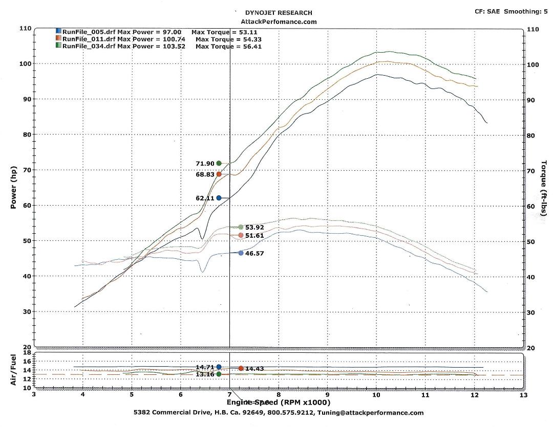

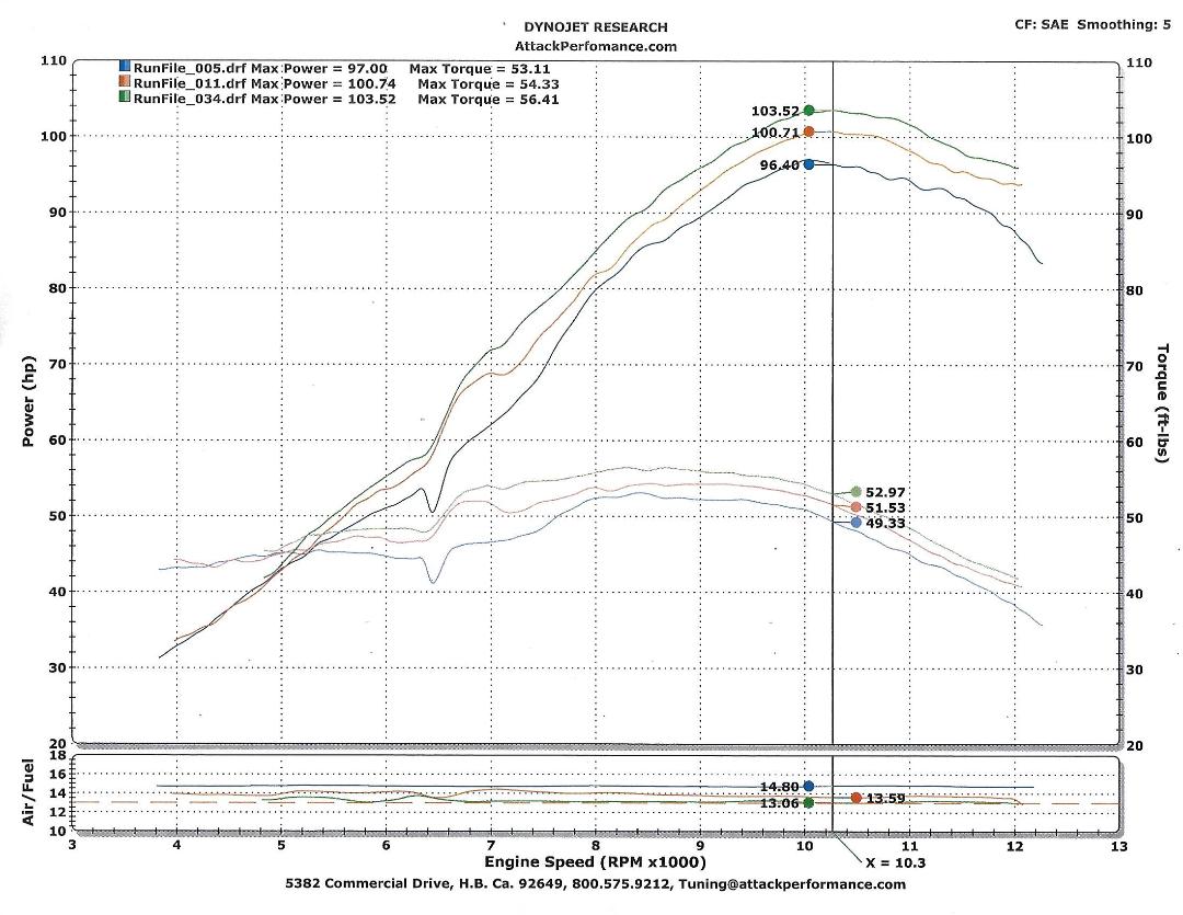

Member Contributer sfdownhill Posted October 20, 2020 Member Contributer Posted October 20, 2020 8 hours ago, fink said: Any chance of putting up the Dyno charts for the headers please fink - later tonight, when back to my laptop, I’ll post the 8 gen before-and-after dyno sheets here so you won’t have to sift through the behemoth header thread to find them. Quote
Member Contributer sfdownhill Posted October 21, 2020 Member Contributer Posted October 21, 2020 Here are two versions of the 8 gen dyno chart. The graphs were both generated on the same day, on the same dyno, by the same dyno tech. The professional VFRD crew did the exhaust swap in the Attack parking lot, and the dyno work was all done by Jozef at Attack Performance in Huntington Beach CA. Attack is the top race shop in California - they run the Attack Performance Yamaha factory superbike race team, with riders Cameron Beaubier [2020 MotoAmerica superbike champion] and Jake Gagne [2nd in the 2020 MotoAmercia superbike championship]. Each dyno chart has three graph lines: - the bottom line is torque and horsepower with stock headers and no tuning - the middle line is with the new headers installed but before any tuning had been done - the top line is after the dyno tech tuned the Power Commander V to the new headers *Side note - check out how the headers smoothed out the VTECH transition dip in the graph at 6500rpm. This chart's vertical line ~ 10,250rpm shows improvement in peak torque and horsepower: This second chart has a vertical line at 7000rpm to delineate improvements in midrange. If you do the math, you'll see that at 7000rpm the tuned headers kicked the torque up over 15% [from 46.97 ft/lbs to 53.92 ft/lbs]. Horsepower also went up over 15% [from 62.11 hp to 71.90 hp]: 2 Quote

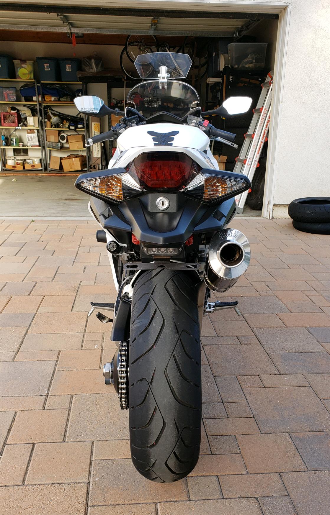

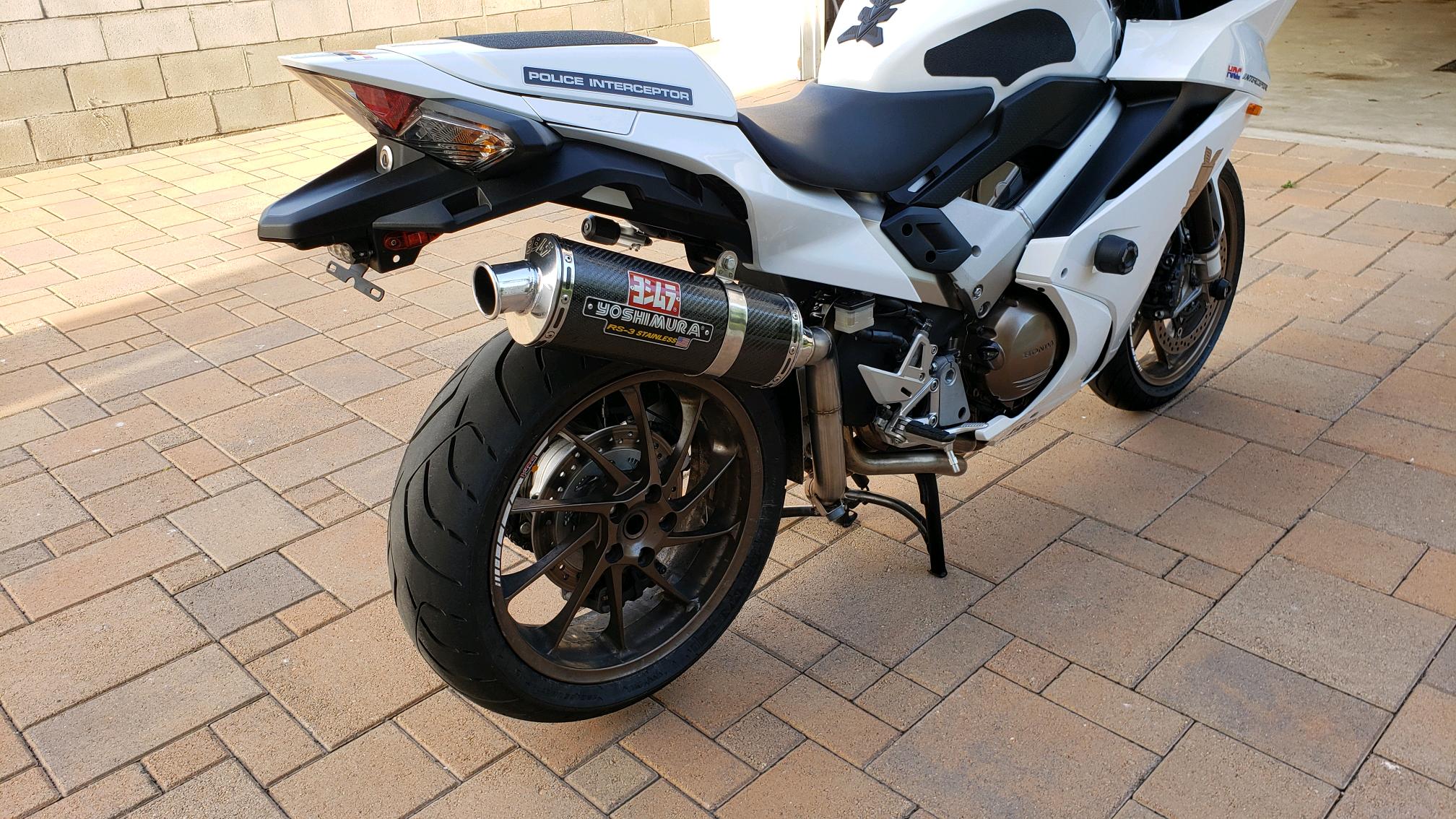

Member Contributer sfdownhill Posted October 22, 2020 Member Contributer Posted October 22, 2020 7 hours ago, Sparkie said: I ride 1100+ miles in a day, and several thousand miles on multi week trips. Often to places where gas is unavailable. No way could I take that kind of hit to mileage. Glad you like it, but it is a no go for me. Wow Sparkie - that’s an impressive number of miles. As detailed in his post above, Flya750 makes use of Power Commander’s map switching option - a simple handlebar-mounted switch changes between two fueling maps. In Flya750’s case he toggles at will between the stock fueling map and a performance-tuned map; between effiency and performance. Badger1 below you can see a full system: WiLD headers (WiLD is a nickname donated by a VFRD member) and a high mount muffler. In this case, we used an existing Yoshimura canister, but cut it down a few inches shorter than it came from Yosh. Fitting a high mount onto the 8 gen requires removing the passenger footpegs and installing a custom support bracket from which to hang the pipe. Note: removing 8 gen passenger footpegs requires significant disassembly of the motorcycle’s hindquarters. Here is the 8 gen in the shop while the midpipe was under construction: A much simpler approach for the 8 gen is a full system with a 4” diameter muffler/canister located in the same position as the stock muffler. The full system’s muffler can be constructed of carbon fiber tube or aluminium, in a length selected by the purchaser. The VFR800 power plant prefers a 16” long muffler, but some owners select shorter lengths for aesthetics reasons. 4 Quote
