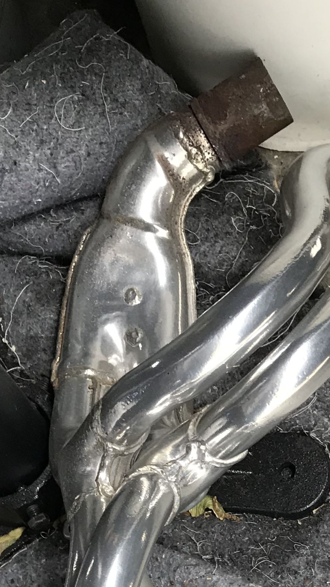

Member Contributer adkfinn Posted September 2, 2020 Member Contributer Posted September 2, 2020 20 hours ago, ducnut said: Electrolysis is probably a good idea, provided it’s left in for an adequate time. Evaporust is a bio-degradable product that works great, but, isn’t cheap. Oxalic acid (wood bleach in the deck refinishing dept) works on the cheap. I had my header blasted and ceramic coated by a pretty well known shop, in the USA. Within a year, the rust started coming back through. The bike was stored in my shop and never saw rain. It was a wasted $280USD. I gave it to a 6th Gen owner to do whatever with. I deleted pics I had of it, but, was able to retrieve this one, which shows a bit of the rust popping through. Ducnut that pic is nuts, I'd be steaming if I paid full boat for a professional coating and it failed in that amount of time. Yikes, that is too bad. Also - I second the rec. for Evaporust! I have a few gallons of it kicking around and it is good stuff. I haven't used it on anything as large as a header, but I've had great success with it on smaller parts / hand-me-down old tools / etc... The fact that it is less caustic and non-toxic makes it much nicer to use also. 1 Quote

Member Contributer ducnut Posted September 2, 2020 Member Contributer Posted September 2, 2020 2 hours ago, adkfinn said: Ducnut that pic is nuts, I'd be steaming if I paid full boat for a professional coating and it failed in that amount of time. Yikes, that is too bad. The header issue just pushed me into getting the VFRD header, which I really wanted, anyway, so I could polish it out to match my Staintune. The pics speak for themselves. 2 Quote

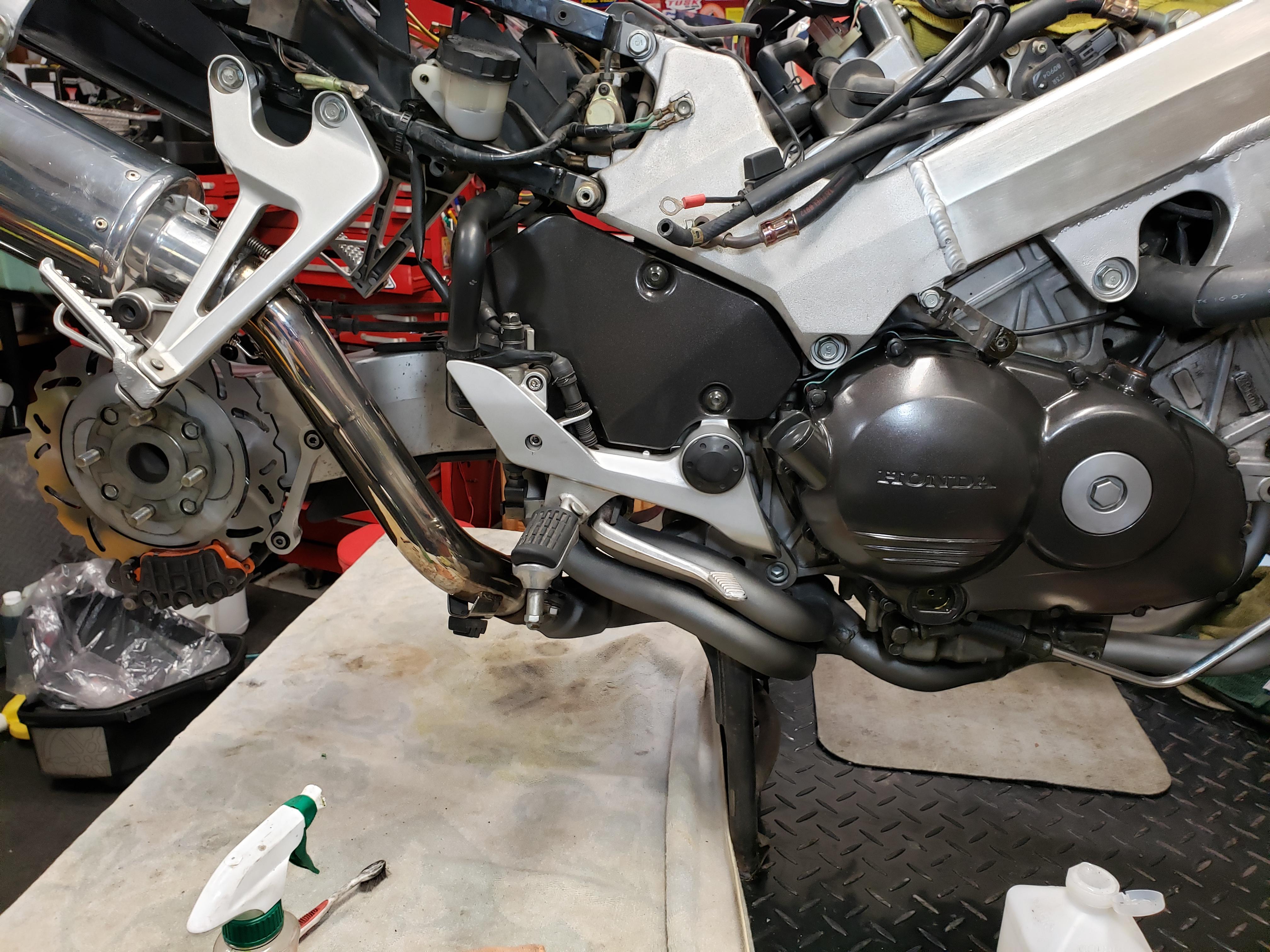

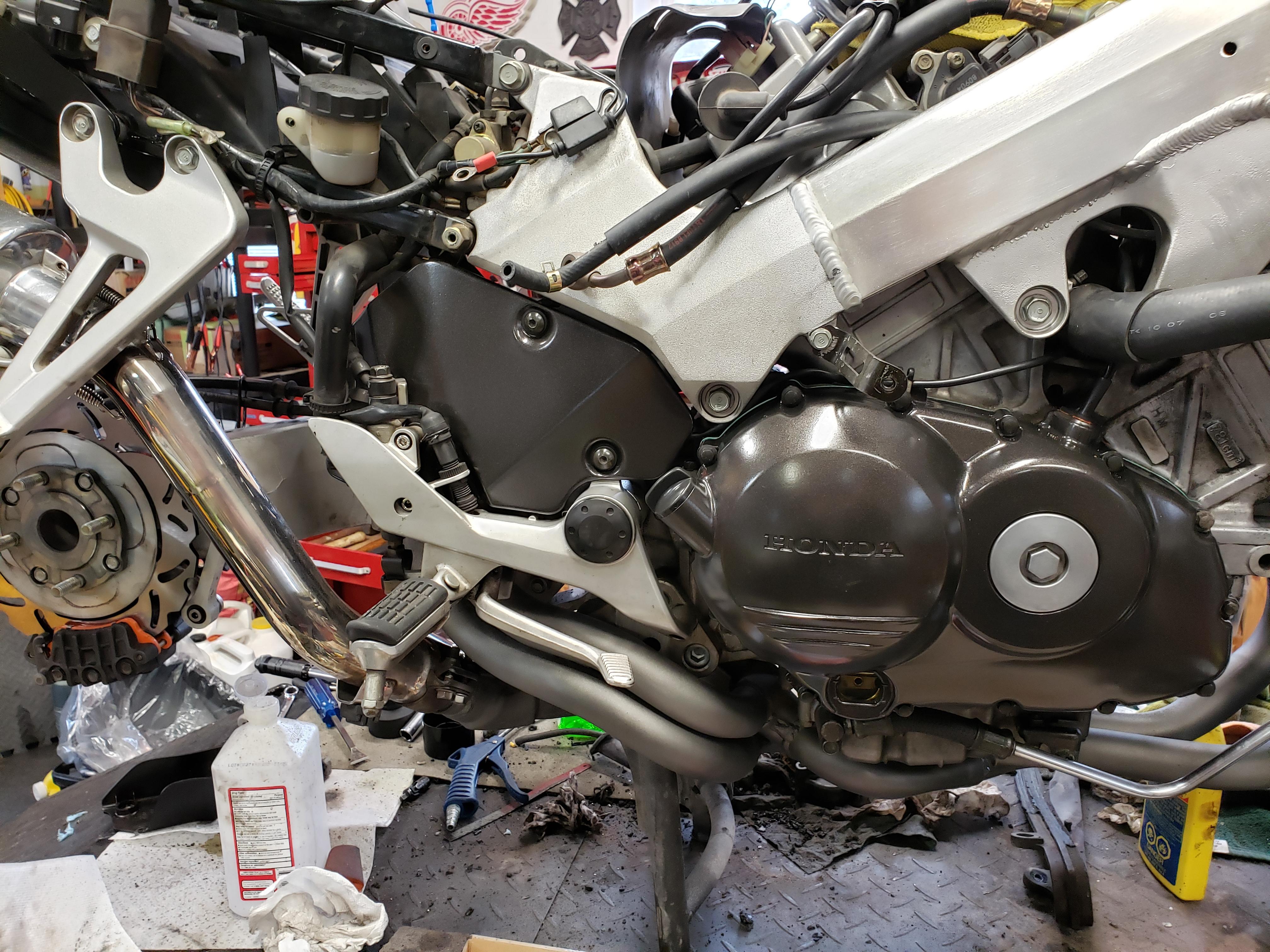

Member Contributer raYzerman Posted September 7, 2020 Member Contributer Posted September 7, 2020 I did my 5th Gen (65k miles) headers with VHT in a Cast Iron colour (gray-ish). Black or some other colours may show light rust eventually but gray less so. I left the headers on the bike, fine wire brushed everything I could get at, wiped with naptha to dissolve any oily residues, and finished with isopropanol so it was clean. Worst spot of brown was at the front fairing vents, more weather exposure there, but all of it cleaned up surprisingly well. The trick is not to apply a heavy coating... first a light primer coat and let dry overnight, then follow with a second light coat. I used tinfoil to mask off anything I didn't want paint on. The other key is to let this stuff air dry for at least a day. Curing with a hot exhaust is just way too hot for paint and you wouldn't do that with any other paint. Ideally I'd bake it at 250-300F. It is holding up very well, no flaking as it is a thin coating. Perfect, no but plenty good. Much of it is covered up but I wanted to improve the look while on the side stand. 3 Quote
Member Contributer MaxSwell Posted September 7, 2020 Member Contributer Posted September 7, 2020 That looks really great! Is it sprayed or brushed on? Quote
Member Contributer RossR Posted September 7, 2020 Author Member Contributer Posted September 7, 2020 6 hours ago, raYzerman said: I did my 5th Gen (65k miles) headers with VHT in a Cast Iron colour (gray-ish). Black or some other colours may show light rust eventually but gray less so. I left the headers on the bike, fine wire brushed everything I could get at, wiped with naptha to dissolve any oily residues, and finished with isopropanol so it was clean. Worst spot of brown was at the front fairing vents, more weather exposure there, but all of it cleaned up surprisingly well. The trick is not to apply a heavy coating... first a light primer coat and let dry overnight, then follow with a second light coat. I used tinfoil to mask off anything I didn't want paint on. The other key is to let this stuff air dry for at least a day. Curing with a hot exhaust is just way too hot for paint and you wouldn't do that with any other paint. Ideally I'd bake it at 250-300F. It is holding up very well, no flaking as it is a thin coating. Perfect, no but plenty good. Much of it is covered up but I wanted to improve the look while on the side stand. What paint did you use.? Has anyone on the forum measured the temperature of the headers? 1 Quote
Member Contributer raYzerman Posted September 8, 2020 Member Contributer Posted September 8, 2020 Brand was VHT in Cast Iron, spray can. Anything brushed on would be way too thick. Quote
