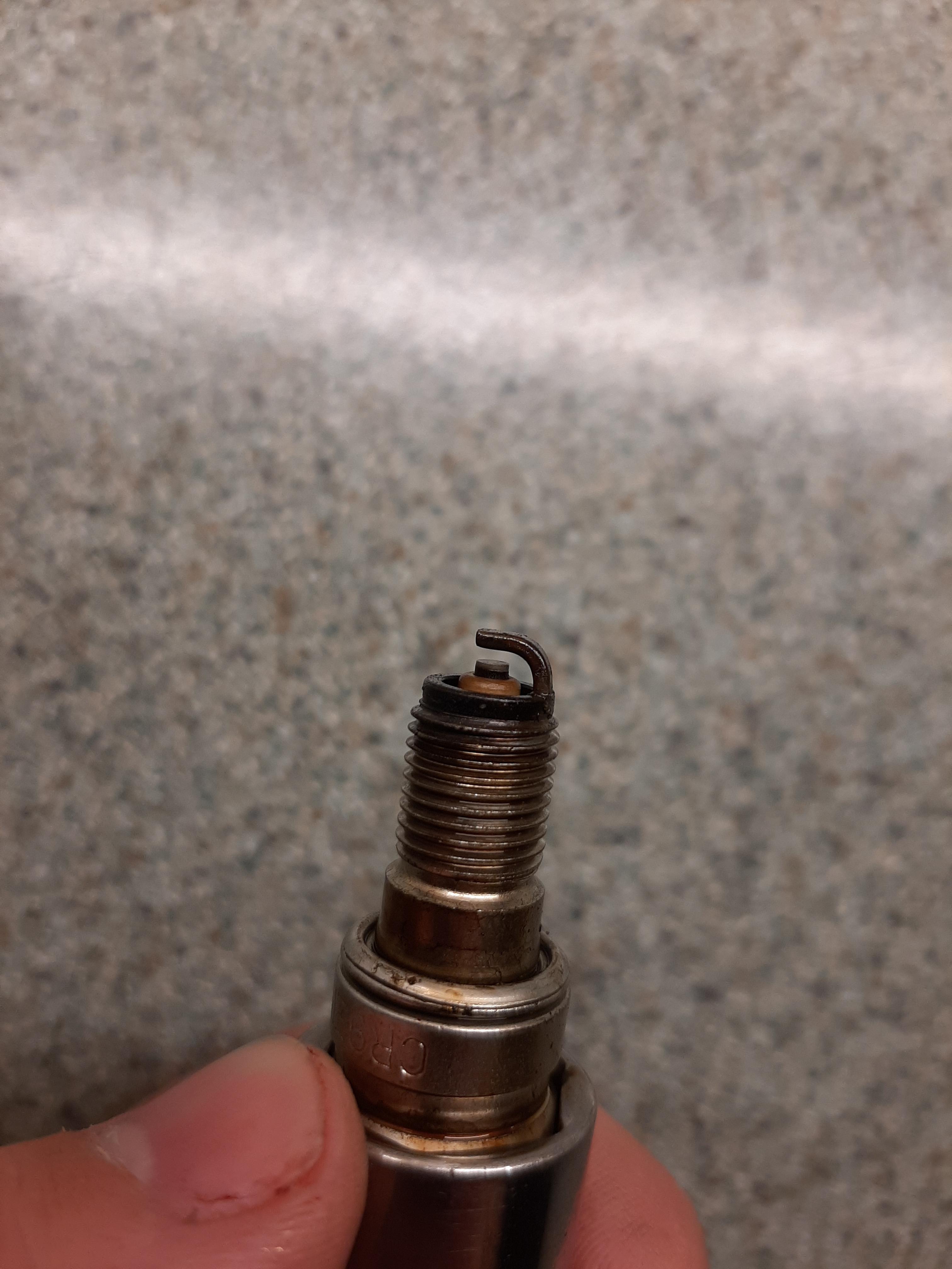

I pulled a spark plug and my spark plug is not burning off the fuel.
So some electrical testing needs done.
Wondering if the kill switch went bad.
Got it running, after some extensive testing I couldn't figure it out. I was getting ready to call my dealer and give them my kidney. I called my local parts store and ordered spark plugs and tried to order a fuel filter, and the parts guy said "I can't find the fuel filter let me make some calls". So I looked in the repair manual and the fuel filter is in the gas tank, I pulled off the metal "directional" fuel filter. Started right up no problems, now I have to find an oil leak somewhere near the rear exhaust.
The thing that gets me is that the fuel bowls were getting fuel and the fuel line was spraying gas (not super hard) so I guess there has to be enough fuel to the bowls.
