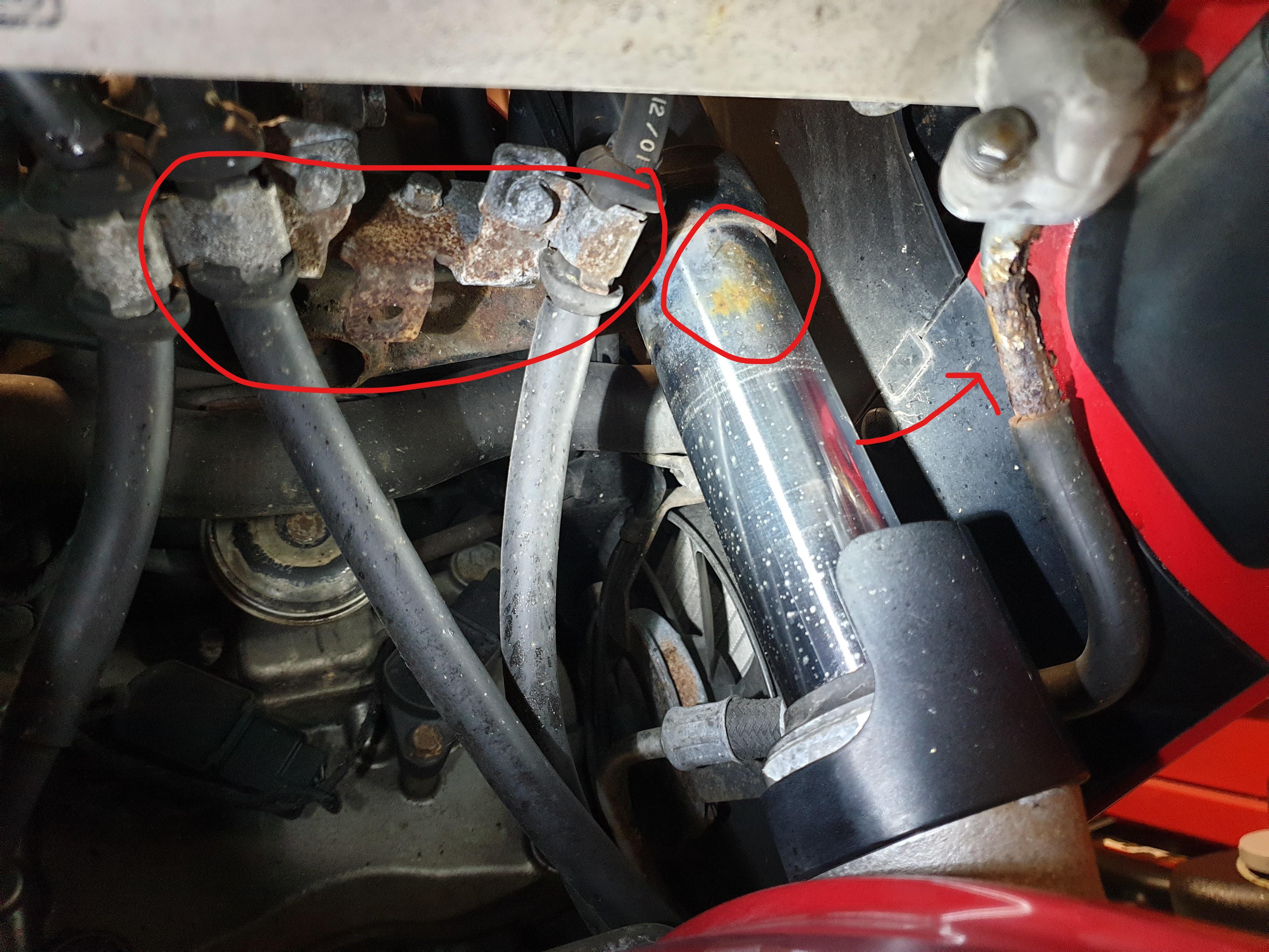

The metal fittings on my oil cooler lines on my 02 are corroded and rusting.  I think the metal is intact but it just looks bad.  Ordered some replacements on ebay and was wondering what steps I need to take to get it done properly.  I know nothing of V4 motors.  But I used to do mild wrenching on my old Yammie I-4 and mild stuff on my cages.
I did try to search, but came up short as my search-fu is weak today.
Also, got a little rust on the forks and some corrosion on some of the fittings/cooler mounts? (sorry I don't know the names yet)
Thanks for any tips you might have.
Dang, do you park in the Bay (as opposed to the Bay Area)?  I love the salty air (I grew up next to the Pacific), but that's not looking good, is it?
Anyway, the corroded brackets on the left of your picture are for the gazillion OEM brake lines on your bike.  Spray some WD40 on them, but replacing them would probably be rather expensive.
The rust on your fork stanchions is also not good, but it looks like its above the max line where the seals travel; if not, that kind of damage will destroy seals in short order, and there's no cheap solution.  Get into the habit of spraying your bike's metal bits with WD40 or something else like ACF-50.
As for the topic of your post, the oil cooler lines, again, there is no cheap solution.  Getting some un-corroded lines from another bike (hello, eBay) would be the cheapest.  Having looked into this before, I can tell you I've never found a cheap and easy aftermarket replacement for Honda oil cooler lines.  No one seems to make adapters which would allow you to use standard AN hoses and fittings on the engine side or the cooler side.  I have some on my 5th gen, but they were made by A&A Performance for their supercharger kit, and A&A is no more.  Should be simple enough to CNC mill some adapters if you had either the opportunity or the means, however.

Looking at those oil line fittings it certainly seems like it was parked in the bay! LOL!  I don't know too much about the previous history of this bike.  I just picked her up a week ago so I'm in the process of going through and getting her more road worthy.  The previous owner had her for 2 years and it was a 3rd bike for him.  Fortunately it was garaged when he had it.  He did mentioned that the owner before him had it in Berkeley and it was stored outdoors.  The paint on the fairings is slightly faded, lots of the aluminum bits have mild surface corrosion.  Not sure why the oil cooler lines were so bad though.
I'll deal with the brackets as best I can.  Spraying them with WD40 is a start.
I'll be taking the forks off and dealing with the surface rust as best I can.  I don't see any rust along the areas where the suspension travels so I think I'll be ok.
I was able to get left and right used OEM lines on ebay for $25/each so I'm good to go there. They are in great shape considering they are around the same age as my 02 and they even came with o-rings (I think I'll get new ones though)
My main question was whether or not I need to totally drain the oil first or scan I just swap out the lines knowing that some oil will come out.
Thinking about it now I think it will be easier if I just drain the oil and swap out the lines.

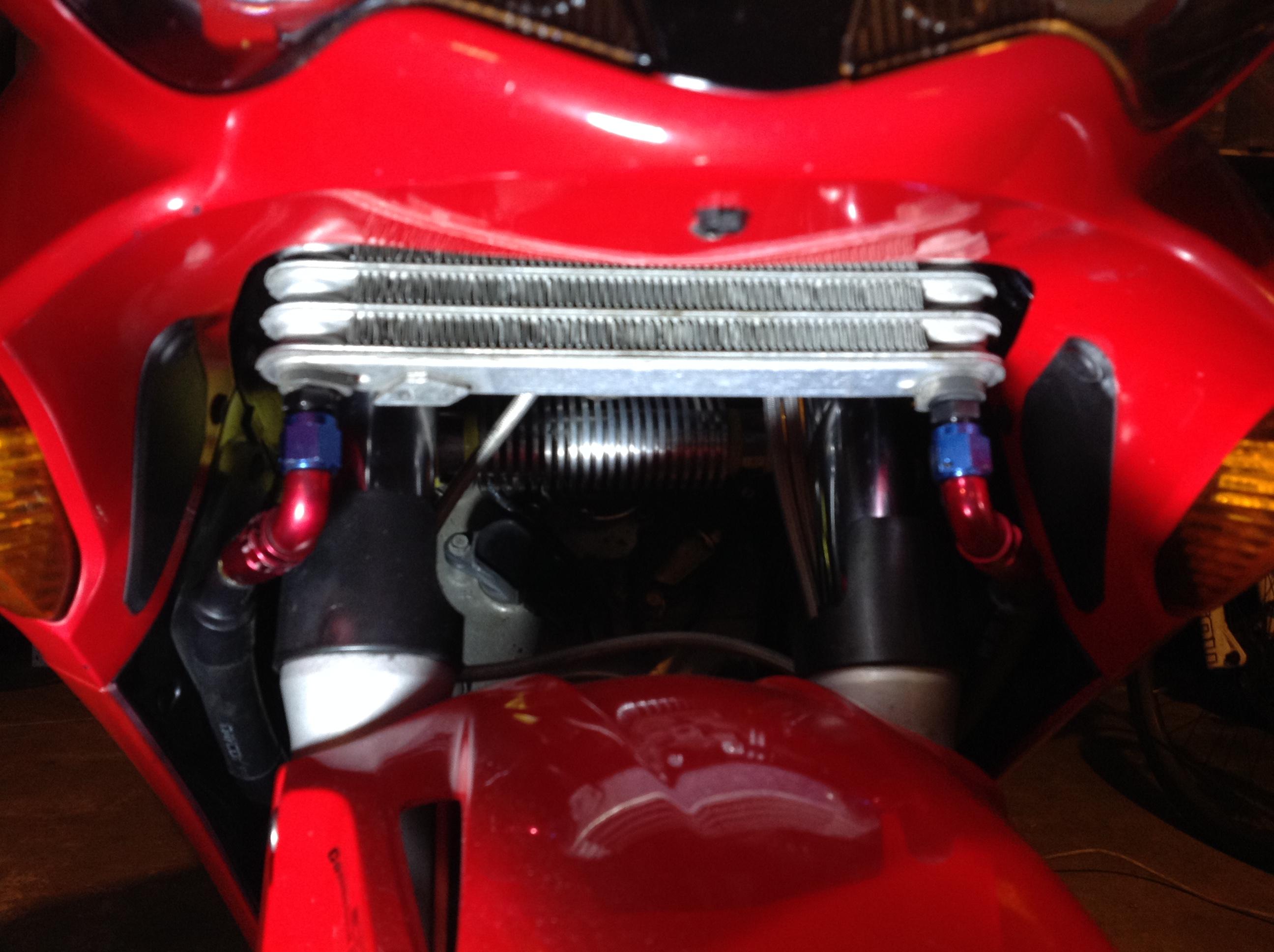

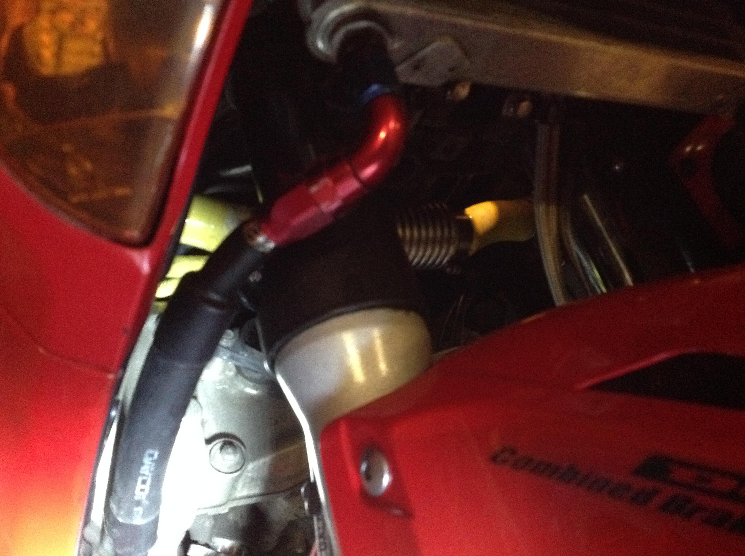

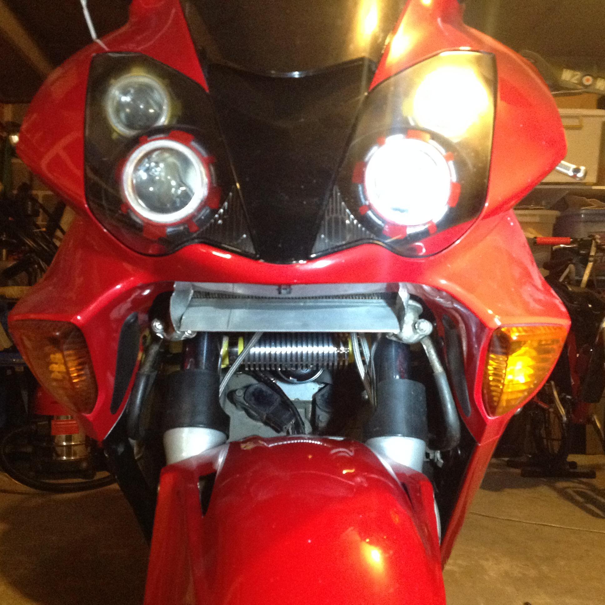

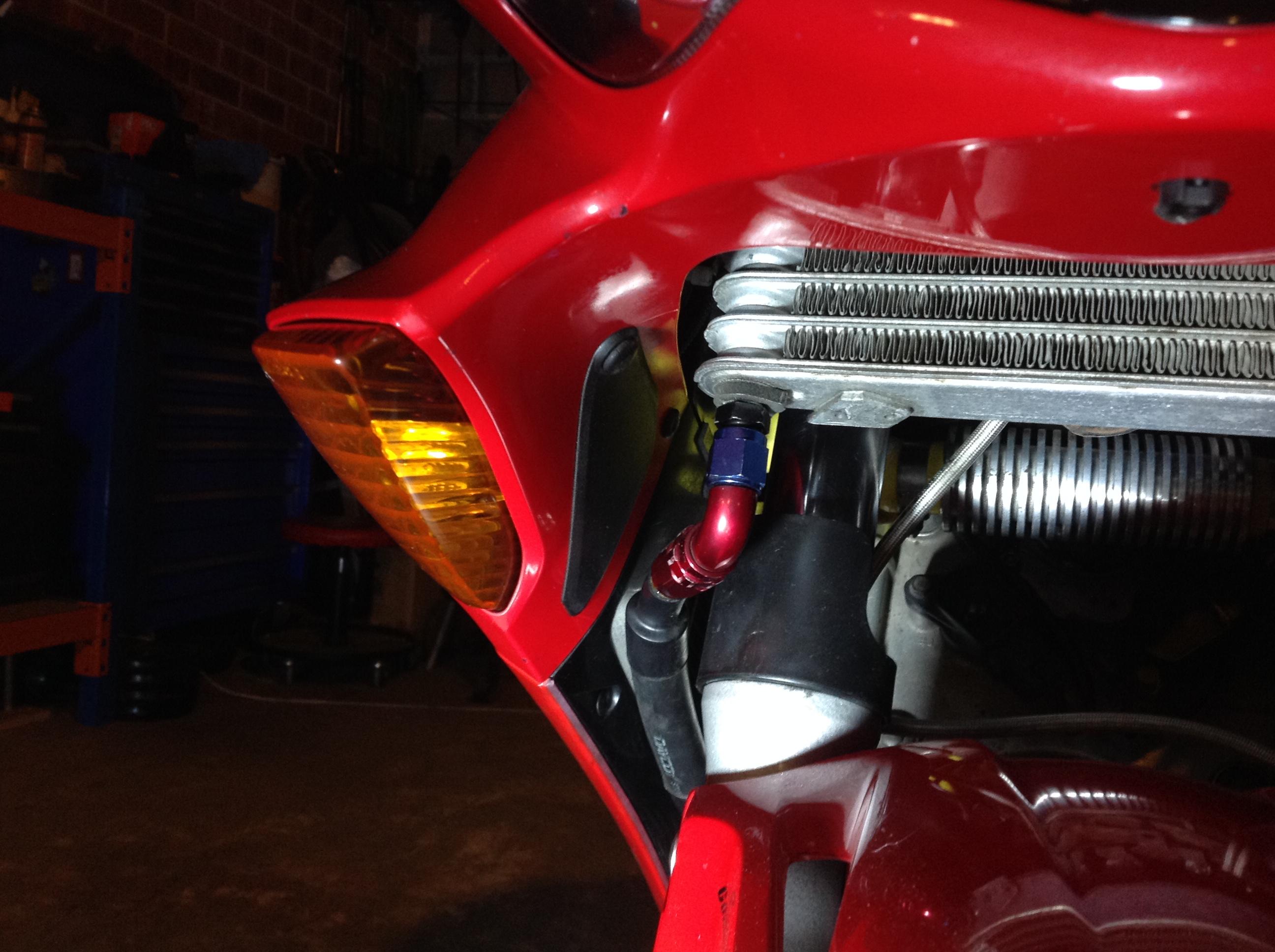

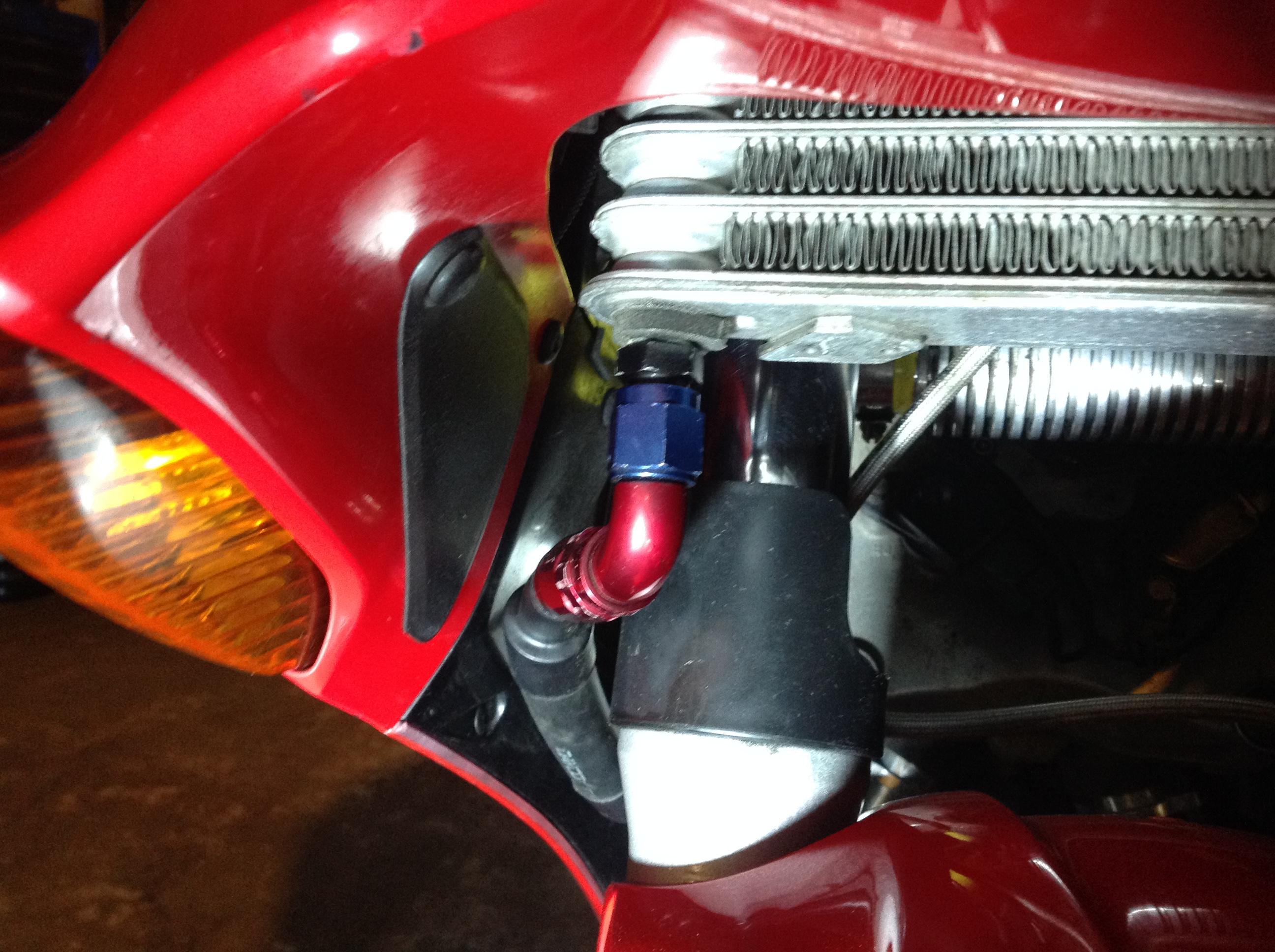

My oil cooler lines were bad so I replaced them with stainless steel braided hoses and at the same time upgraded to an RC51 cooler. If you go down this line you will need to remove your exhaust to remove the sump and tap a thread into the inlet and outlet ports where the oil cooler lines connect to the sump using AN fittings. You will also need to to cut off the block connectors on your oil cooler and tap two threads so the new braided lines can connect using AN fittings. I also feed the braided lines in rubber hose And heat shrinked the ends to protect the fairing from vibration associated rasping from the braided hoseS.
The last photo was my initial attempt to increase the air flow over my oil cooler to help with cooling through making a ducted aluminium scoop. When I upgraded to the RC51 oil cooler and braided lines I ditched the ducted attachment.
I'd forgotten that you could simply drill and tap the oil cooler for AN fittings, but I would be very uncomfortable drilling and tapping the engine case in situ.

Also you'll notice that the fairing sags in the centre at the back just in front of the oil cooler.
I managed to make a bracket that hooks onto the light and put a screw thru the saggy section to lift it.
Every little bit of air flow

By using the RC51 oil cooler more fins are exposed hence why I removed the scoop. I also found on very hard breaking that the scoop would bottom out on the front fender, track days only.

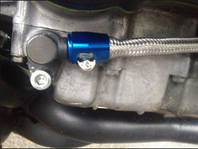

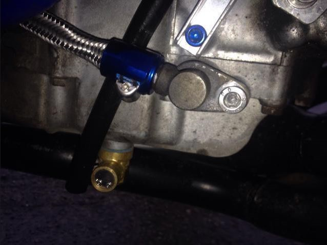

IIRC, in Mohawk's thread the hose was somehow attached to the OEM fitting to the pan, so no need to tap it.  I could be wrong -  I may have pics of that saved somewhere,  I'll see if I can find them.  He did a really good write up on it.
Here we are . . . these pics were from Mohawk's thread on doing cooler line conversion.  I'm not sure how it was accomplished to attach the hoses to the OEM oil pan fittings, but for my $.02, it sure beats removing the pan and tapping the opening.
The original oil lines fit to the pan fittings via a couple of inches of flexible hose, my guess if for vibration isolation & easy alignment. On the old lines, just use some tin snips to cut through the hose to separate the pan fitting. Then carefully use a helical cut wiTh a hacksaw or dremel cutting blade through the crimped on furrule, then peel it off & remove the hose stub.
You now have a connector ready for a new hose. You can either do what I did & use a metal screw hose clamp to hold the new hose, the blue fitting is just a shield to cover the clamp, or take it to a hydraulic hose shop & have a new furrule clamped on.

Marooncobra, that looks very nice.  Thanks for the pics and the information.  Looks like the RC51 cooler is a bit bigger than the stock VFR?   How has it been working for you?  Can the oil cooler be too efficient?
