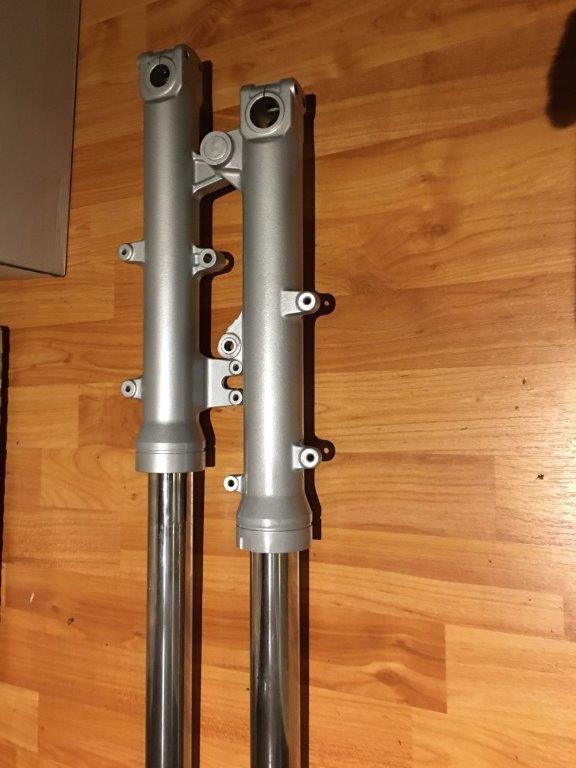

Member Contributer Dutchy Posted November 22, 2019 Author Member Contributer Posted November 22, 2019 16 hours ago, Captain 80s said: With that flag in the background, "White love" has another meaning. Now you have me hoping the suspension is not White Power (WP)........ PS: WP is now Austrian KTM owned but was founded in the Netherlands. The springs were white, not because white is better; simply because they could have them coated economically.... Via a company that made hospital beds... 1 Quote

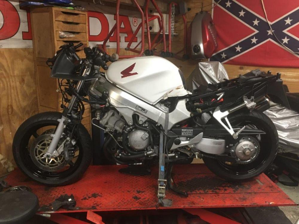

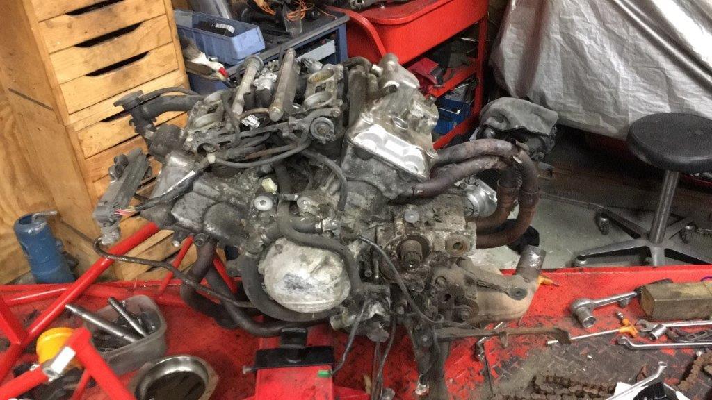

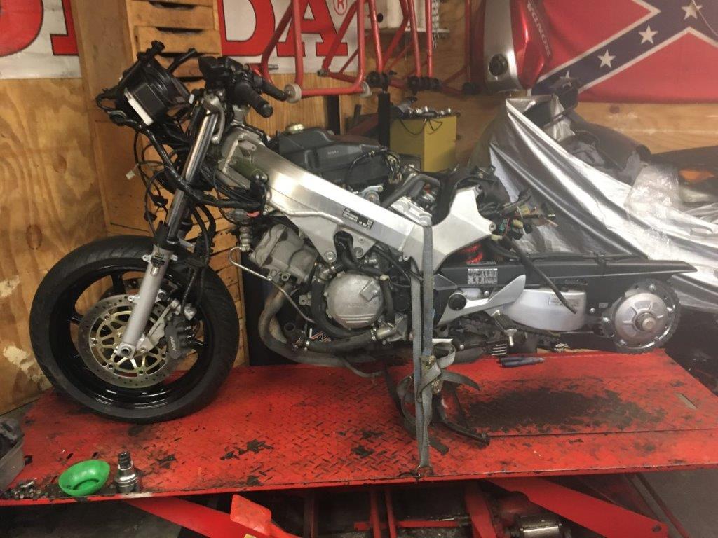

TheDutchy Posted February 1, 2020 Posted February 1, 2020 The bike has been stripped down to the bone… It's engine.. Quote

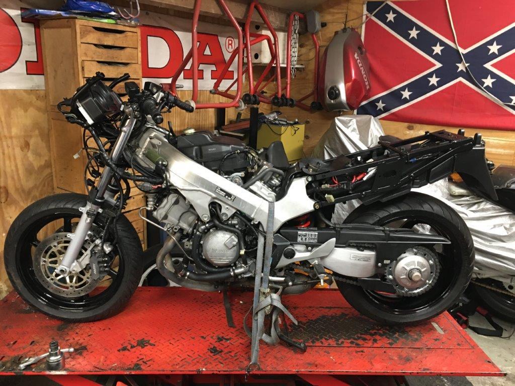

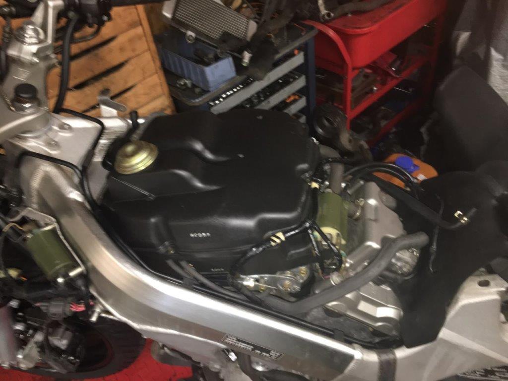

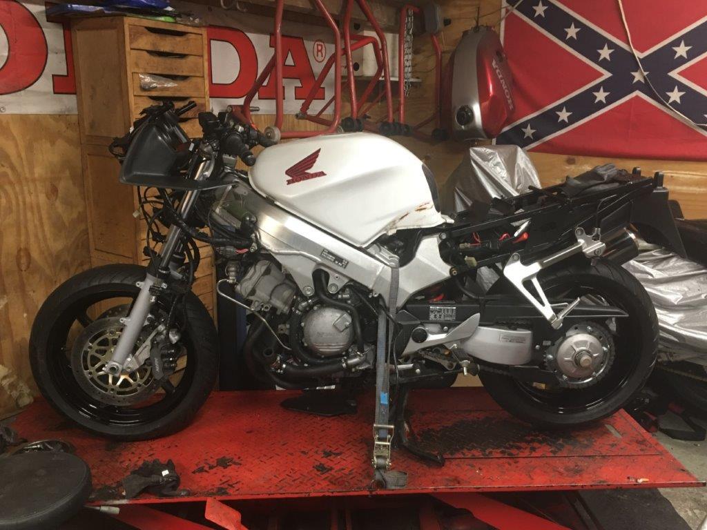

TheDutchy Posted February 1, 2020 Posted February 1, 2020 Starting to put items back on how they should be,. 1 Quote

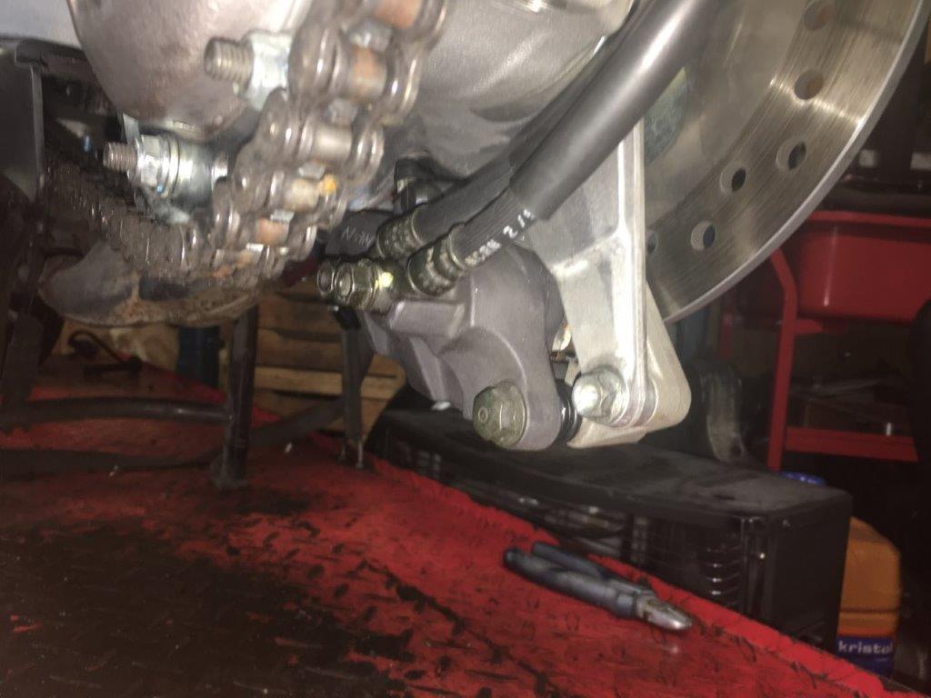

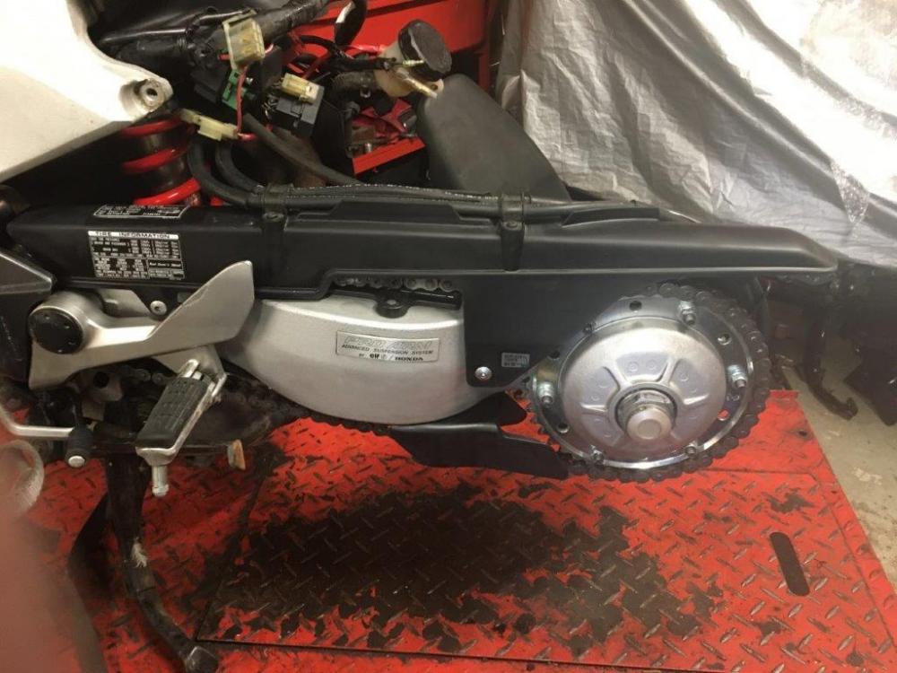

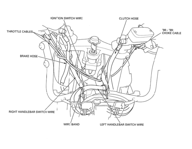

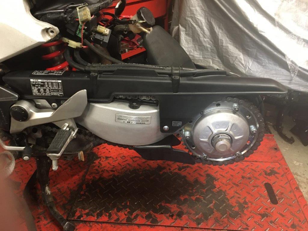

TheDutchy Posted February 3, 2020 Posted February 3, 2020 Rear wheel finished and installed.. Subframe got a new coat of black. Routed the wirring loom throughout the tail and installed all the electrics.. One question, does the wiring loom on the handlebar controls pass in front or go behind the front fork leg ??? Quote

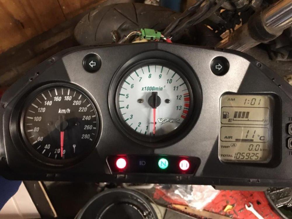

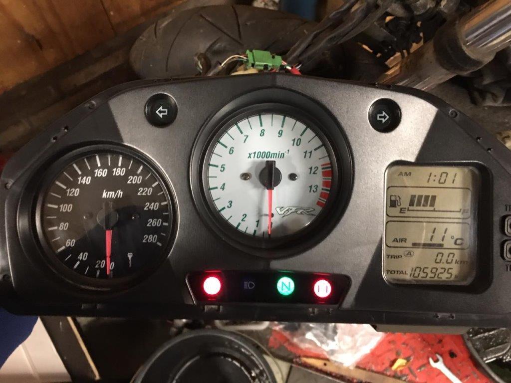

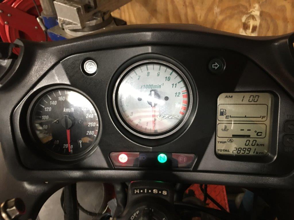

TheDutchy Posted February 9, 2020 Posted February 9, 2020 The trick with the lcd swap withen the cluster did the trick. Allthough the donor bikes cluster was trashed, the lcd was still in good condition. Swapped the LCD's out en presto, the mileage went down from 106,000 kilometers to 29,000 kilometers. I never owned a bike with that a low odo reading. Quote

Member Contributer RC36B Posted February 9, 2020 Member Contributer Posted February 9, 2020 On 2/3/2020 at 11:19 PM, TheDutchy said: One question, does the wiring loom on the handlebar controls pass in front or go behind the front fork leg ??? Same "sewing" as with the VFR 750 🙂 wire looms goes behind - see illustration from the shop manual Quote
TheDutchy Posted February 9, 2020 Posted February 9, 2020 7 minutes ago, RC36B said: Same "sewing" as with the VFR 750 🙂 wire looms goes behind - see illustration from the shop manual Thanks,RC36B my manual wasn't as clear as your pic.. I did install them behind the legs, so I am assured it is good.. Also the bands on the cluster / frame stay wiring make sense now.. They are welded upward, like (to me) Honda installed them wrong way around.. You have to fold them down against it's welding position to hold the wiring.. Weird.. Quote
Member Contributer RC36B Posted February 9, 2020 Member Contributer Posted February 9, 2020 1 hour ago, TheDutchy said: Thanks,RC36B my manual wasn't as clear as your pic.. I did install them behind the legs, so I am assured it is good.. Also the bands on the cluster / frame stay wiring make sense now.. They are welded upward, like (to me) Honda installed them wrong way around.. You have to fold them down against it's welding position to hold the wiring.. Weird.. "Ours not to reason why..." I guess the wires moves more controlled/predictable with this setup. Nice project... 🙂 Quote
TheDutchy Posted February 9, 2020 Posted February 9, 2020 22 minutes ago, RC36B said: "Ours not to reason why..." I guess the wires moves more controlled/predictable with this setup. Nice project... 🙂 Thanks, The reason why I got puzzled, was that the 2000 onward model has a different top mount and handlebars. The locking bolts are in a different position. The handlebars between the pre 2000 model without HISS and the 2000 onward models with HISS are different, and not exchangeable. Quote
Member Contributer YoshiHNS Posted February 10, 2020 Member Contributer Posted February 10, 2020 On 2/1/2020 at 4:52 PM, TheDutchy said: The bike has been stripped down to the bone… It's engine.. That is absolutely horrendous. What a labor of love to clean that up. 1 Quote

Member Contributer RC36B Posted February 12, 2020 Member Contributer Posted February 12, 2020 13 hours ago, TheDutchy said: Also it requires the coolant recirculation, so different waterpipes and thermostat housing Yeah... the ECU is kind of primitive - the "choke" lever or the later vax-unit is ridiculous. Should have been a servo controlled by the ECU. The ECU already have sensors (coolant temp, crank sensor, MAP etc) to decide on idle. I never understood why Honda chose a solution which didn't use components already there. The doner engine looks like a nightmare you fished out of the harbour - how did you win the battle getting the engine to look that good? Quote
