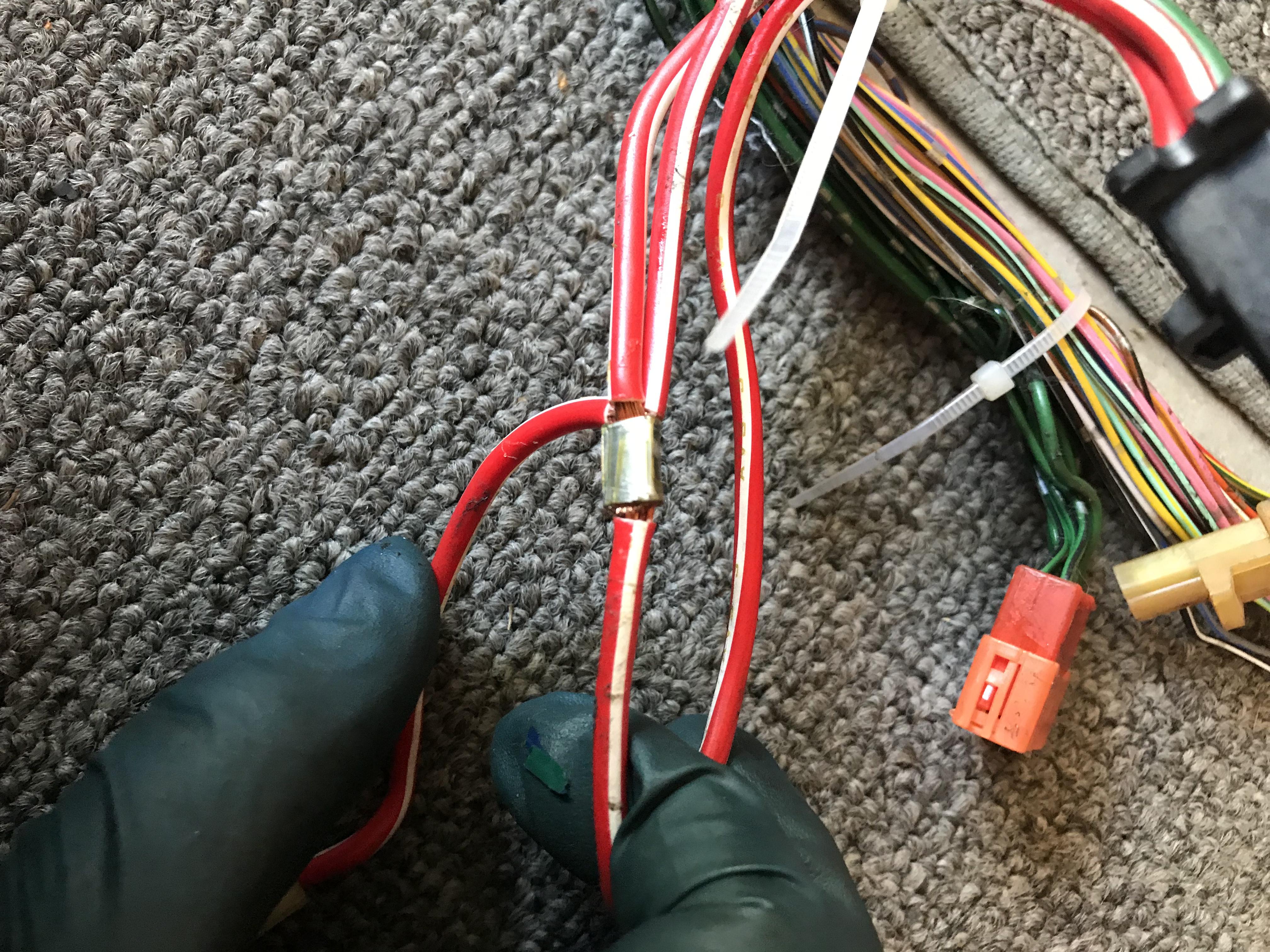

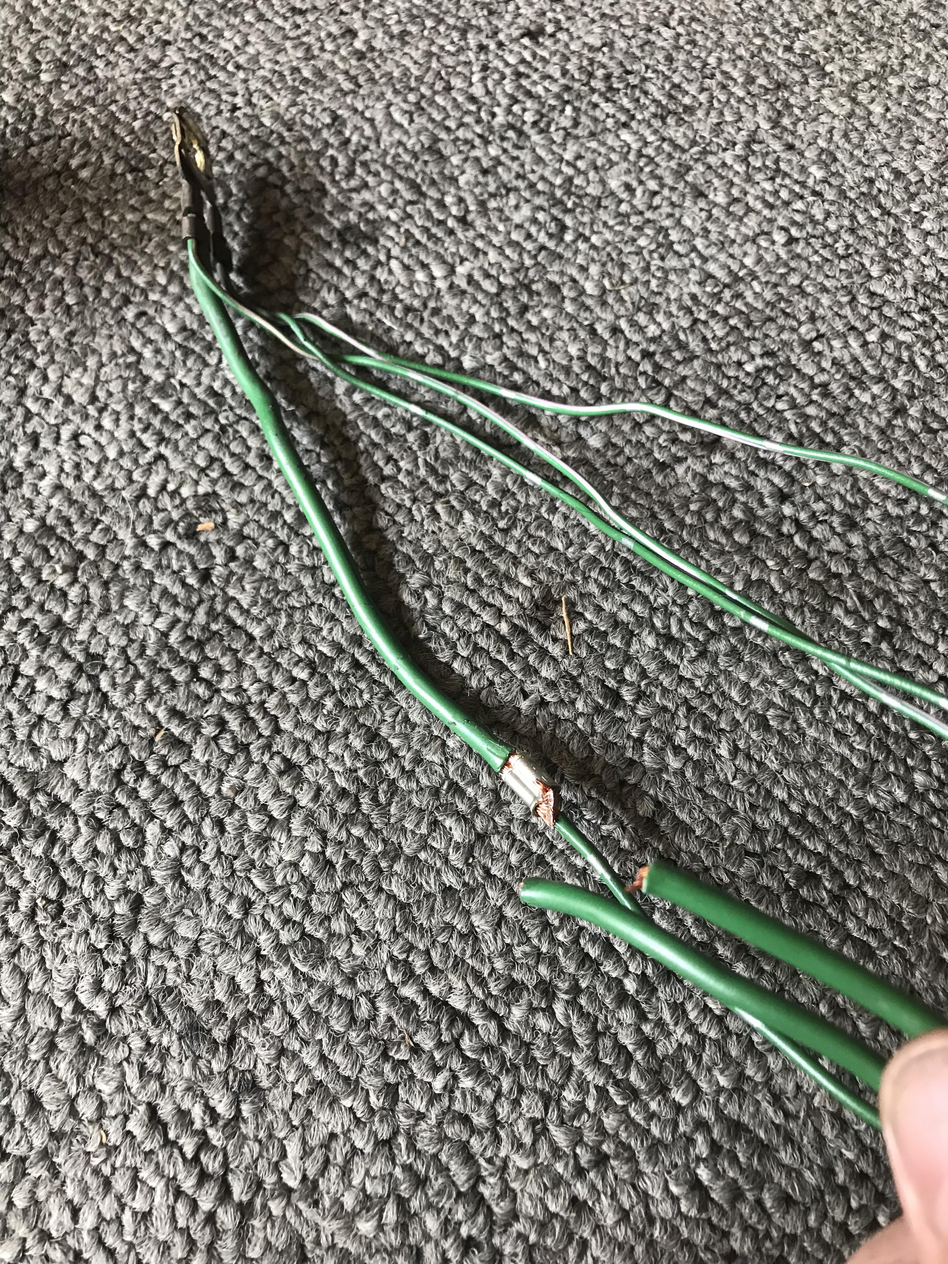

zx9vfr800 Posted April 26, 2019 Author Posted April 26, 2019 I have to say I am really confused why the stock R/R has 5 wires going to the power side of it and the new one only has 2... Quote
Member Contributer Grum Posted April 27, 2019 Member Contributer Posted April 27, 2019 3 hours ago, zx9vfr800 said: I have to say I am really confused why the stock R/R has 5 wires going to the power side of it and the new one only has 2... The original has a double up of the Red (positive output wire) and Greens (negative ground wires) probably to maximise the output power without going to heavier gauge wire, it would also greatly lessen the chances of burnt out high resistance joints by having the Positive and Negative power going through two spade type connection each at the main plug. As to the black wire, previous ohmic checks I've done on the R/R showed this wire appeared to have no connection to any other wire, as to its purpose I don't know, other than when it was used it was wired to the ignition switched main positive. So yes, the only real requirement out of the R/R is two wires, Pos and Neg. Quote
Member Contributer ducnut Posted April 27, 2019 Member Contributer Posted April 27, 2019 Inside the harness, the double wires are crimped onto single wires of the same gauge. Why? I have no idea. Quote
