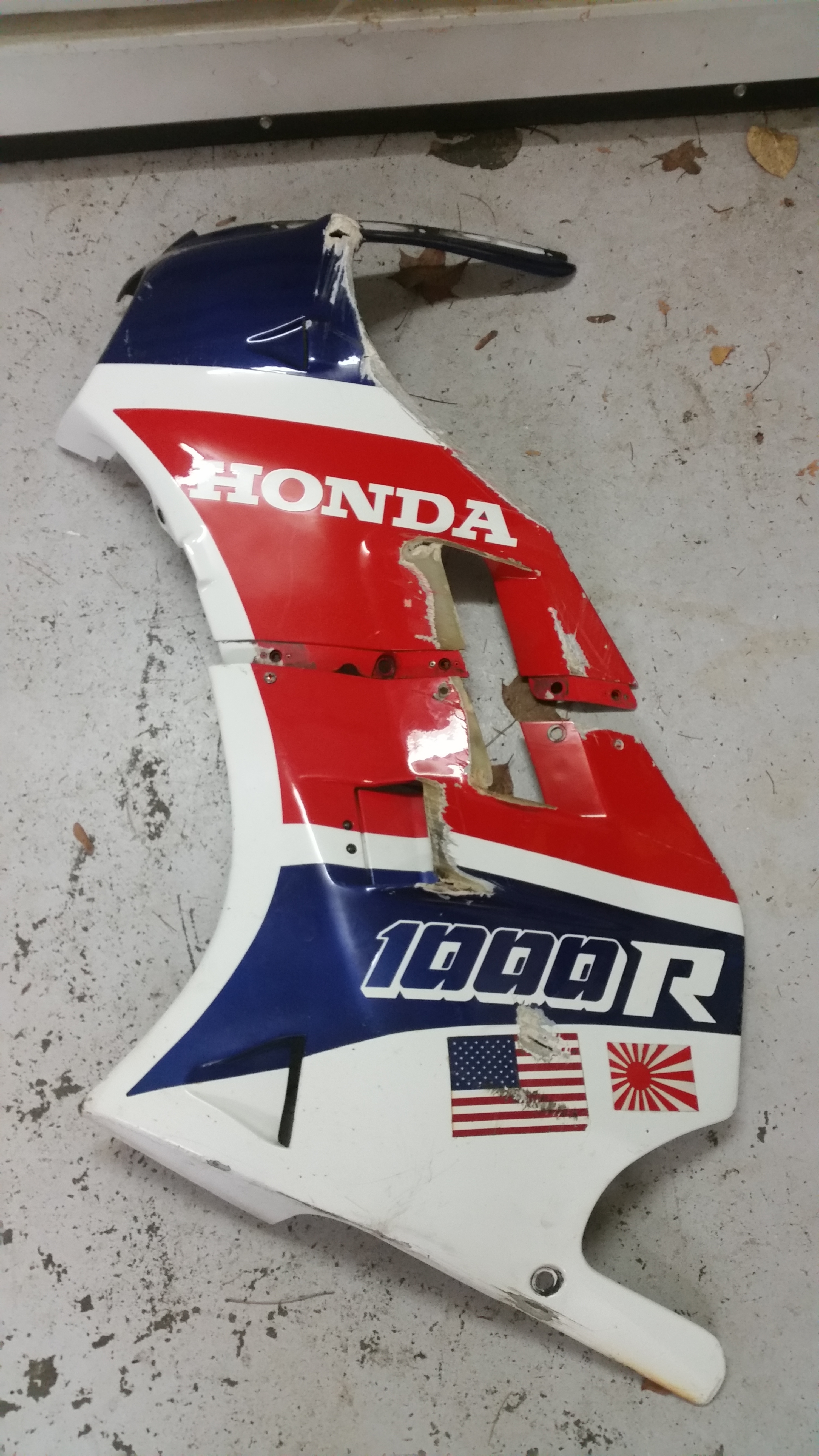

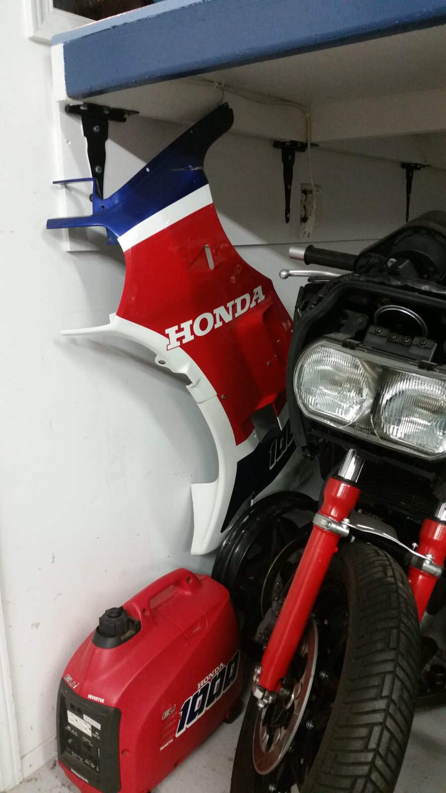

Member Contributer Captain 80s Posted February 19, 2019 Member Contributer Posted February 19, 2019 Well my starter thread got archived. New Addition So here's where I'm at. Upper cowl stay is now straight. Here it has a set of 85 bodywork to make sure I got it back to where it needs to be. That was tough. Lots of heating and pulling and heating and smacking. But it looks really good. And this 85 half: And the "good" half from the original 86 set (here's the remnants). Now make this 85 left, 86 right. Fuck it. Quote

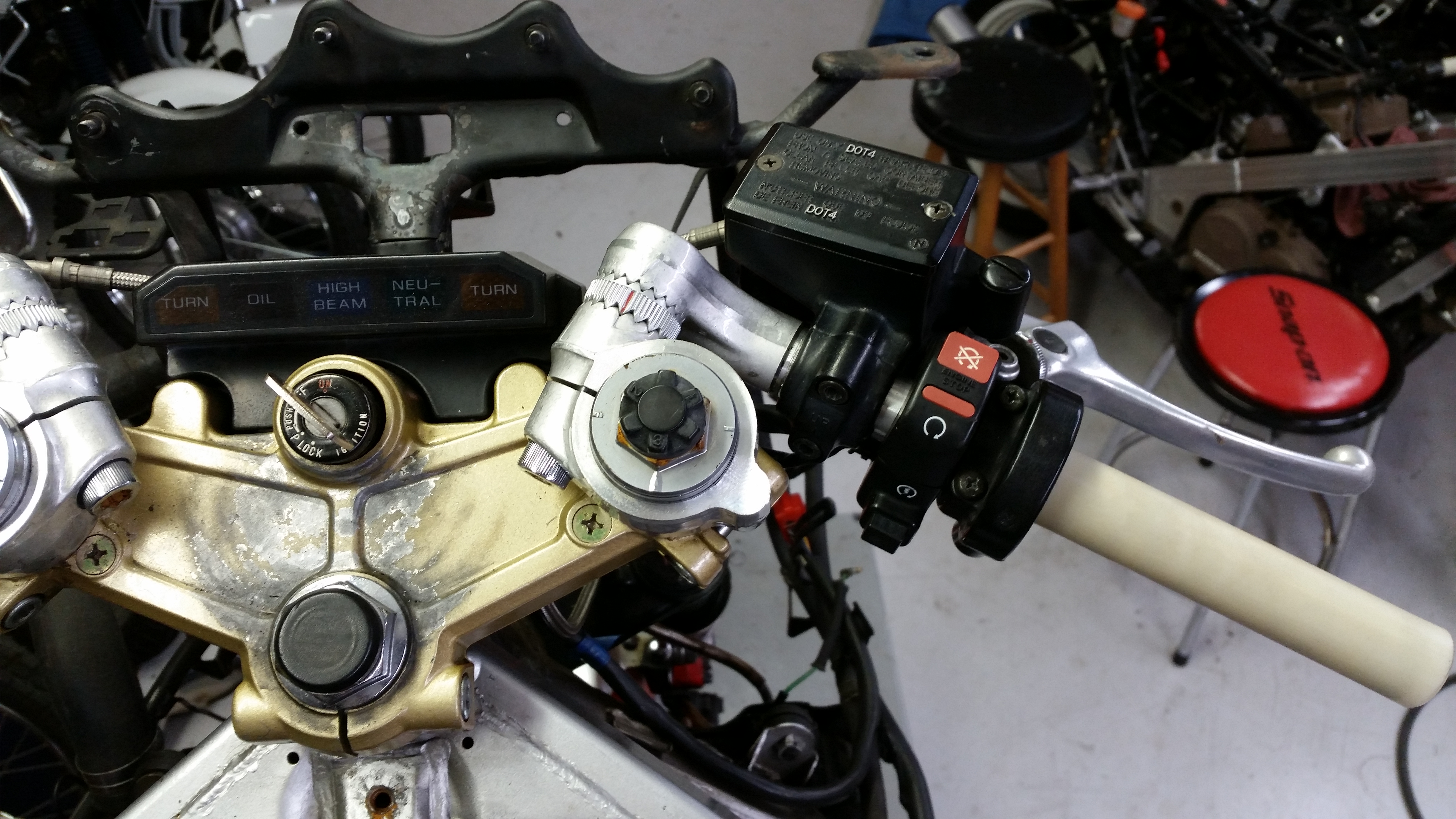

Member Contributer Captain 80s Posted February 19, 2019 Author Member Contributer Posted February 19, 2019 The left bar is now straight, I extracted the stuck fr brake master cyl cap screw, and it is getting "new" switch gear to get rid of the shitty early switch assemblies. RC51 throttle housing and a CBR1000RR starter switch. The RC51 starter switch has the correct plug, but the lead is too short to make it to it's location on the wire harness side. So, original lead made to be connected the the "new" RR switch. These lengths put the mid connectors right behind the right frame cover for easy replacement if needed. Quote

Member Contributer FromMaine Posted February 19, 2019 Member Contributer Posted February 19, 2019 Nice work. Good to know about the RR starter switch, I'll keep that filed away for the future. Quote
Member Contributer Captain 80s Posted February 19, 2019 Author Member Contributer Posted February 19, 2019 3 minutes ago, FromMaine said: Nice work. Good to know about the RR starter switch, I'll keep that filed away for the future. And like I said, the RC51 has the correct plug if you are missing everything. Just need to lengthen the leads and relocate the terminals withing the plug the match the wire harness side. Quote

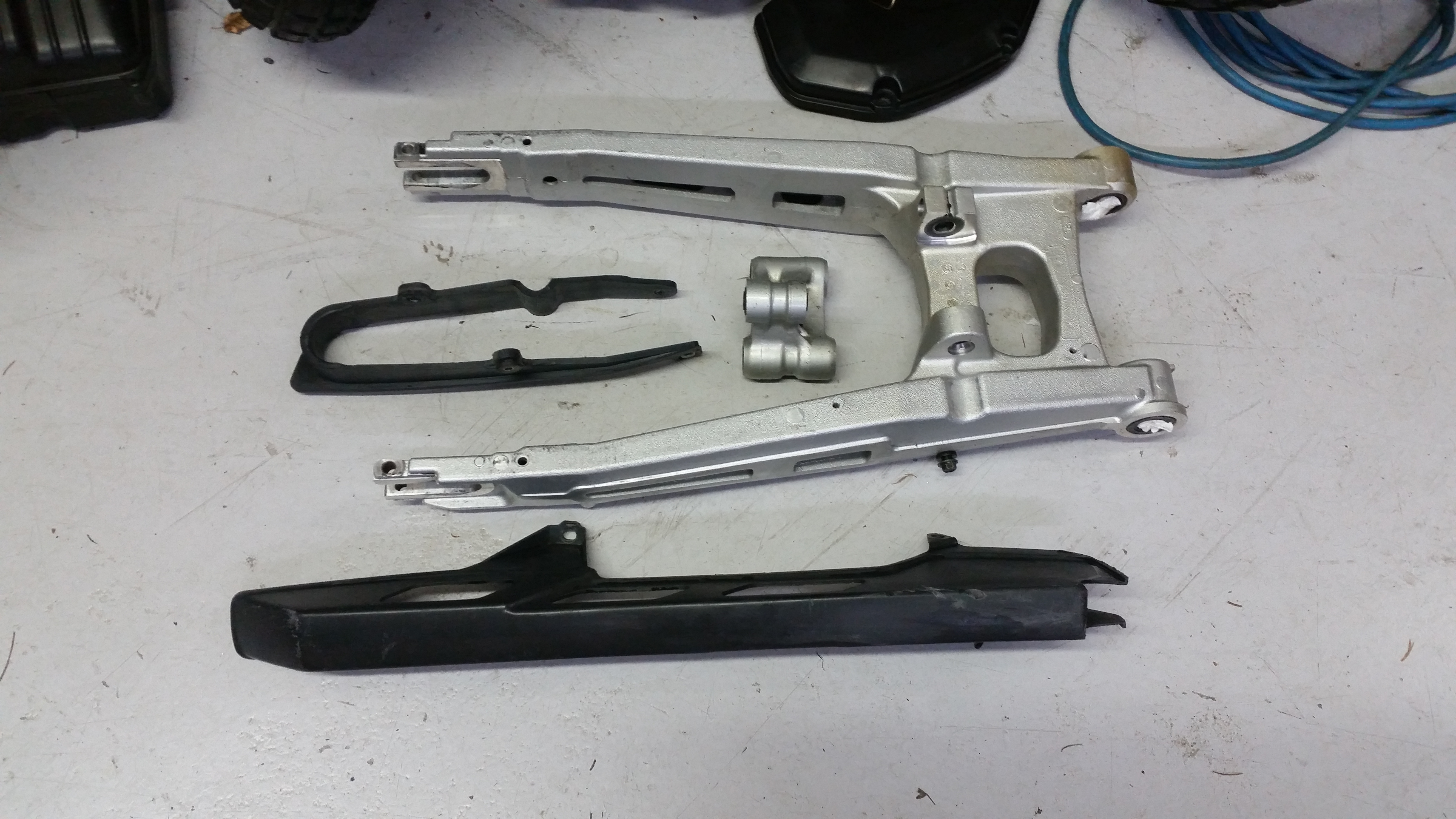

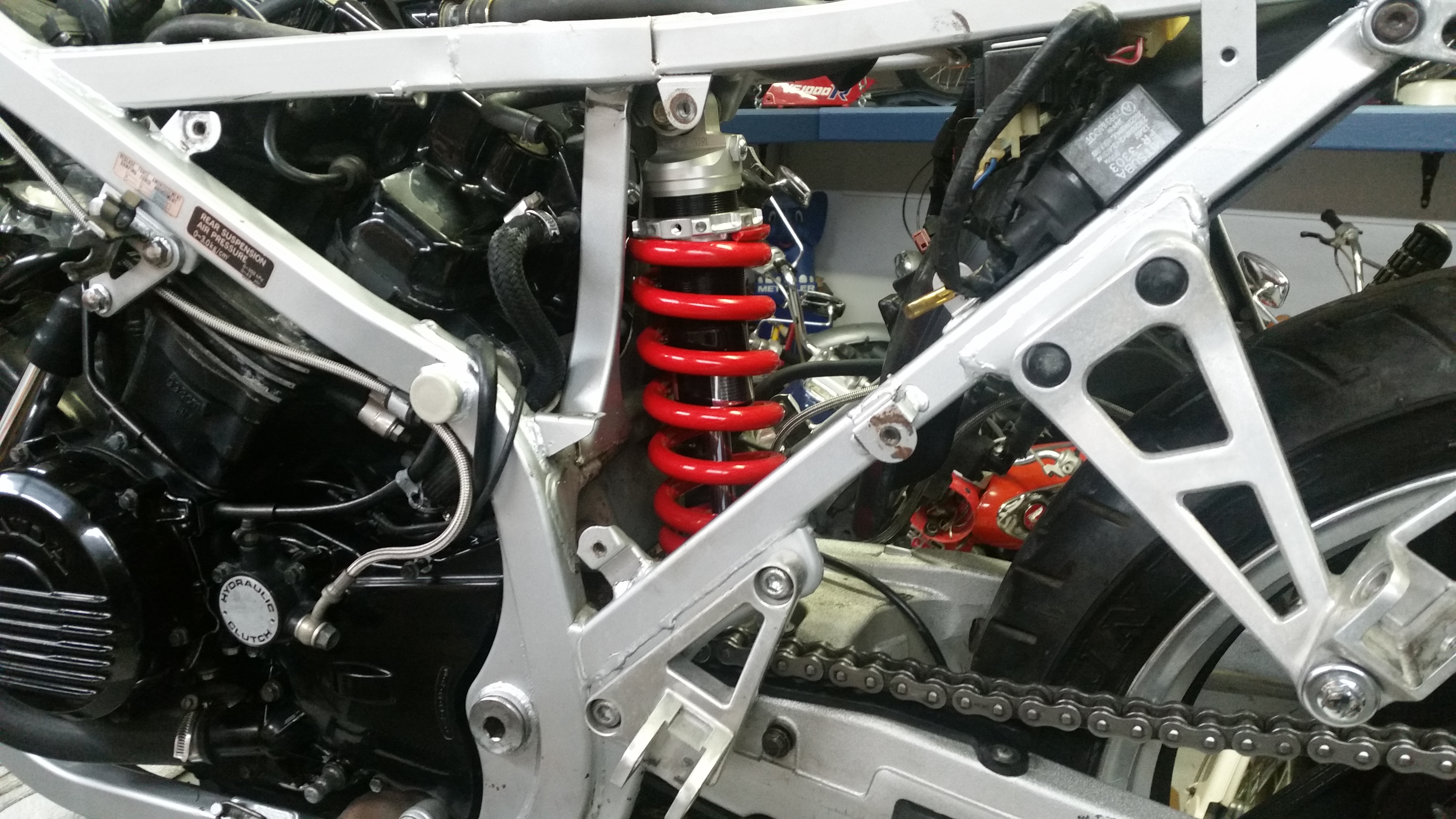

Member Contributer Captain 80s Posted February 28, 2019 Author Member Contributer Posted February 28, 2019 Swingarm and linkage now free of 30+ years of chain grime. That was not fun. Bearings all clean and repacked with Bel-Ray water proof grease, and everything assembled and torqued. New shock fit perfectly. +5mm ride height. 3 1 Quote
Member Contributer FromMaine Posted March 1, 2019 Member Contributer Posted March 1, 2019 On 2/27/2019 at 9:28 PM, Captain 80s said: Swingarm and linkage now free of 30+ years of chain grime. That was not fun. Bearings all clean and repacked with Bel-Ray water proof grease, and everything assembled and torqued. New shock fit perfectly. +5mm ride height. What shock did you use? Nice looking ss line on the clutch slave. That's going to be a pretty unique daily rider when done. Quote
Member Contributer Dutchy Posted March 1, 2019 Member Contributer Posted March 1, 2019 Looks like an YSS.,.... 1 Quote
Member Contributer Captain 80s Posted March 3, 2019 Author Member Contributer Posted March 3, 2019 On 3/1/2019 at 1:04 PM, Dutchy said: Looks like an YSS.,.... Correct! 1 Quote

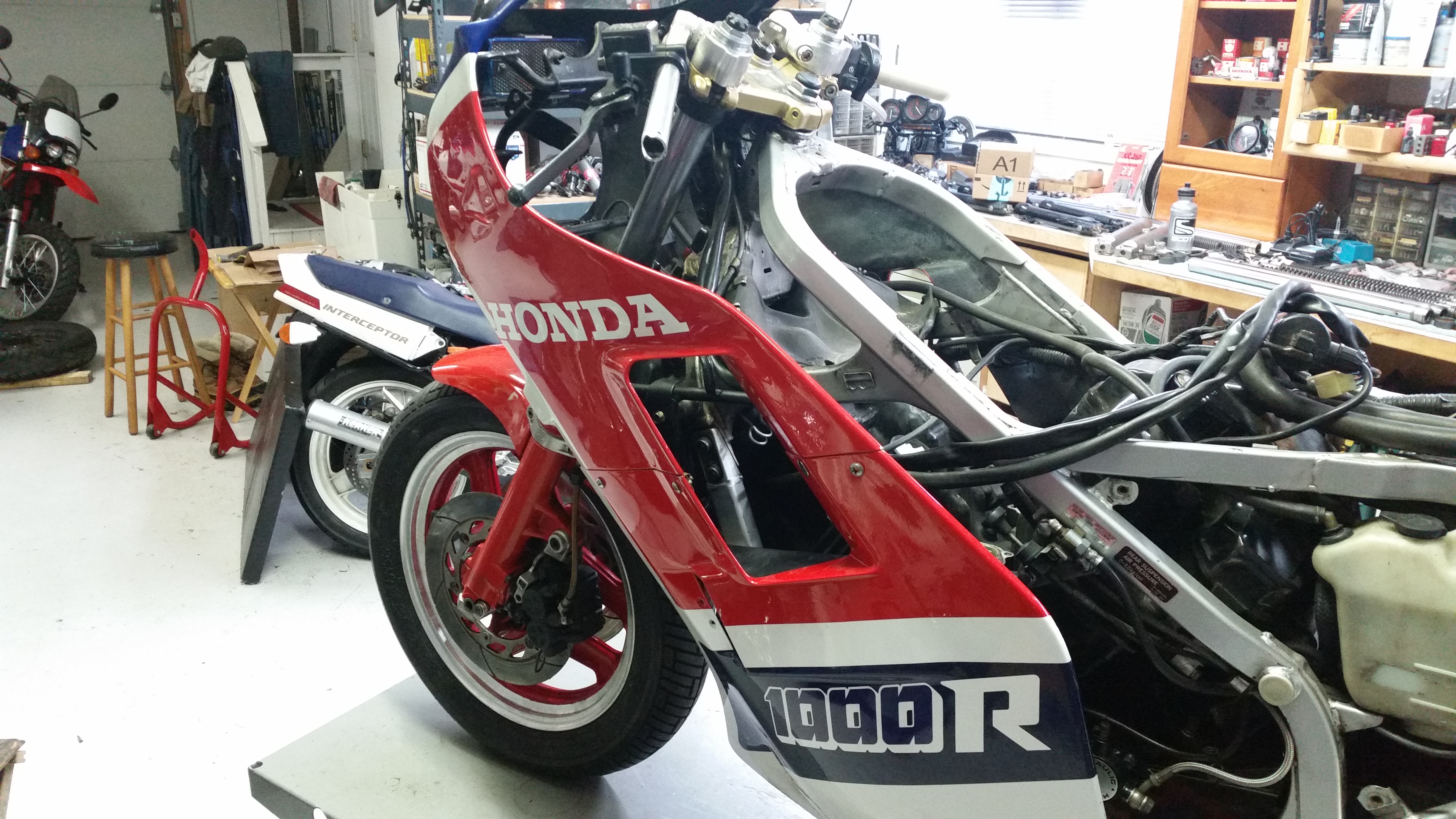

Member Contributer Captain 80s Posted June 11, 2019 Author Member Contributer Posted June 11, 2019 More progress. Rebuilt brakes are assembled. Trimmed the rear turn signal mounts and reshaped the fender. Cockpit is looking pretty good. Switched to a CBR1000F master cyl so the double banjo bolt on the individual lines could clear the dash. I have a CBR1000 clutch master on the way so they will match. Need to solder in the reg/rect and install a fuel cut relay switch and a fan switch. I removed the casting for the side stand rubber so my boot can fit under the shift pedal easier too. I also installed a 1000F left engine mount since I'm not using the stock shock (where the damping cable and air hose normally mount). Quote

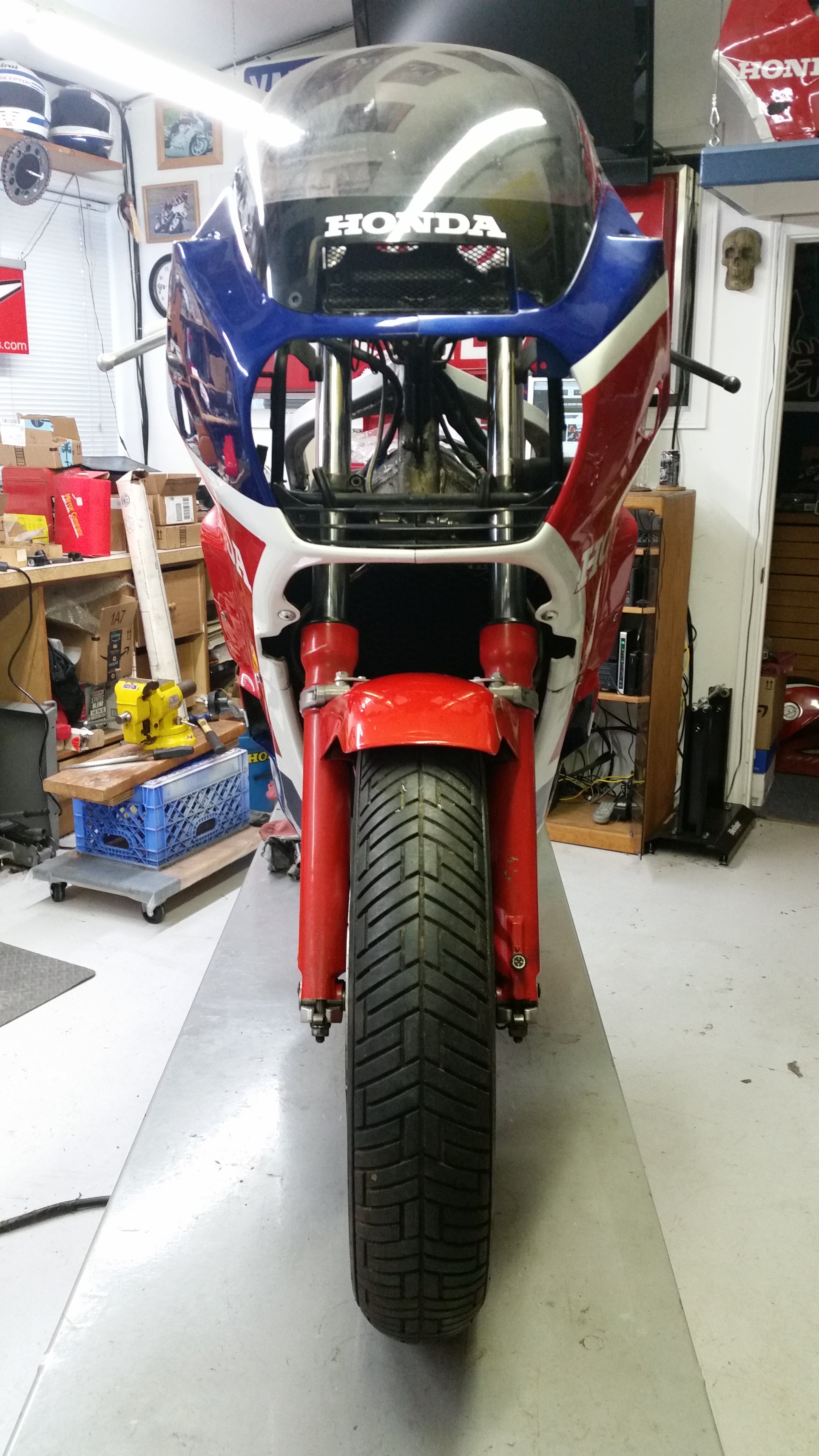

Member Contributer Captain 80s Posted July 2, 2019 Author Member Contributer Posted July 2, 2019 Before: After: I still need to give everything a fine cut / polish and do a bunch of touch up. The white fender is very hard to get used to, but after spinning around for just one evening it already seems OK. The wide wheels and radials, new suspension and brakes feel amazing. 2 Quote
