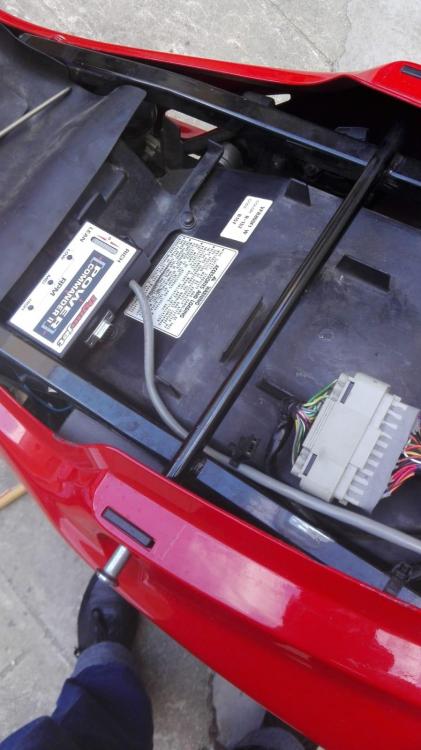

cuoccimix Posted March 11, 2019 Author Posted March 11, 2019 I have installed a Power Commander unit on my bike....but it's not a modern one. It's quite a old piece of vintage electronic, being a PC II, made in 1999-2000 (found a new old stock one, still with sealed box, for one hundreds euros). The box itself is quite self-explaining about the age of the item: The installation is very easy - just unplug the original harness, and plug the PC II betweem ECU and original connector (no additional plugs are present on this old device). It sits quite well under the seat, but it was not possible to hide the connectors in a less invasive position. The plastic hooks under the seat are perfect to fit the wire properly. After a bit of struggling with adapters (the thing has a serial port!) and with unusable software, i finally managed to install the proper files and to connect the PC II to my notebook. I have installed a map previously tested by a member of the Italian VFR club, and now the bike can run for almost 280 km until the res light - that's a gain of 40 km. Performances are almost unchanged, just a slight loss of stamina and smoothness at low rpm. Now the bike stays in the range of 16 km/l (almost 38 mpg), and that's an acceptable mileage, albeit not impressive for sure. Now it's a VFR-BNSO (Very Frequent refuelling, But Not So Often). Quote
