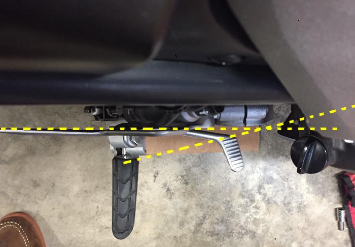

I bought my 2005 used in 2014. It had suffered a couple driveway tip-overs and had the scratched bodywork to prove it. No big deal.
The other day, I was installing a set of BLS lowering blocks and the brake pedal alignment caught my untrained eyeball. I had always thought of the VFR's rear brake pedal placement as somewhat  "discreet" as in "tucked out of the way", but now I was wondering if my bike was something of a sad outlier and rather than having a "discreetly positioned" pedal, maybe the pedal was just "bent".
Here is a photo:
Is my brake pedal bent in toward the bike, or is the misalignment between the plane of the footpeg bracket and the tread lines of the pedal normal?

I would like to be able to answer with certainty but mine has been bent in towards the bike for so long, I don't remember what the positioning actually was.  But it does look to be bent inwards a bit

normal, i thought the same thing with mine, and has never been dropped. "on that side anyway"

Mine is the same but I have heated it with a torch and bent it out for a more 90 degree angle

FWIW my '99 is much straighter than that. It is almost perpendicular to the foot peg.

Definitely it should be parallel, not on that angle.  I have an '07.
