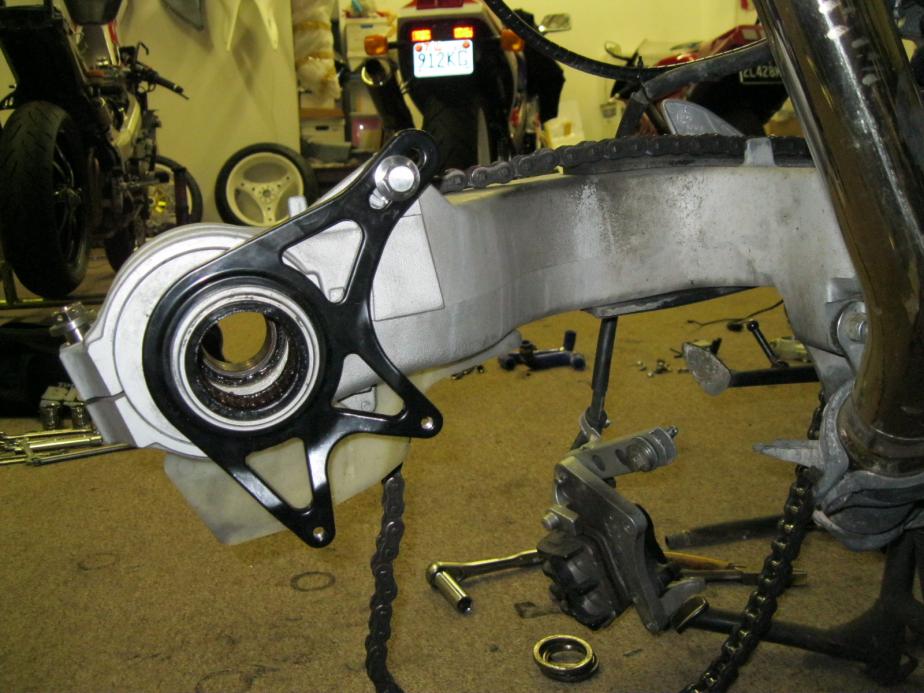

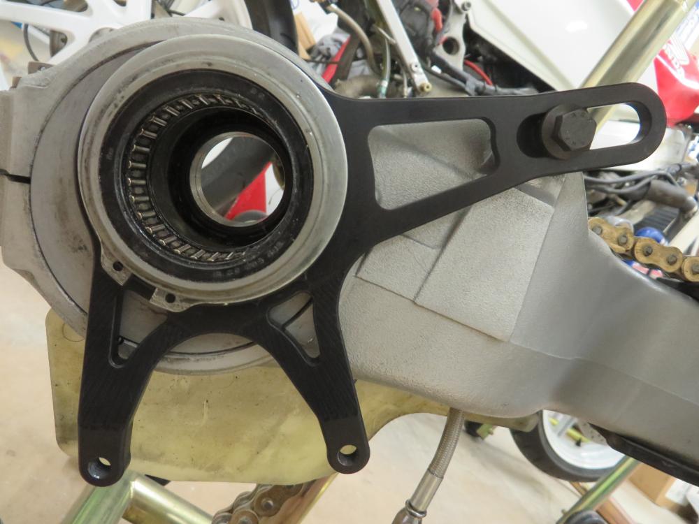

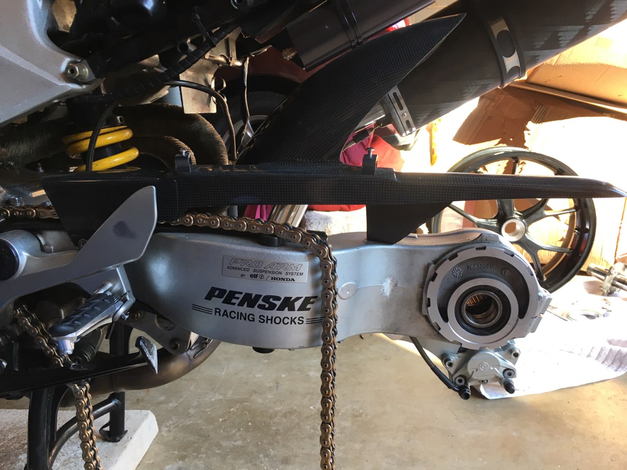

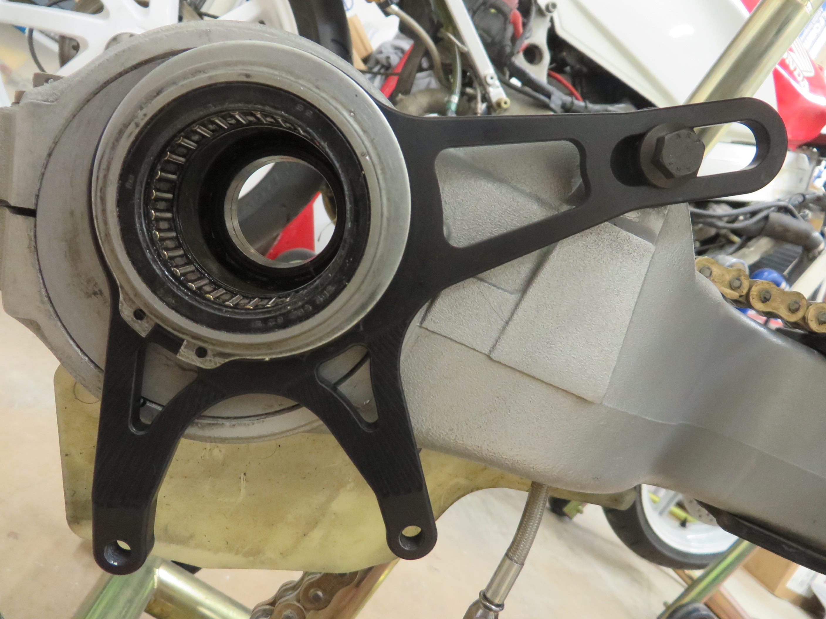

checking if there is any interest in custom rear brake hangers for 4th and 5th gen's. On 4th gen it's pretty much just cool, maybe save afew pounds, but on 5th gen it will make DeLink way easier.

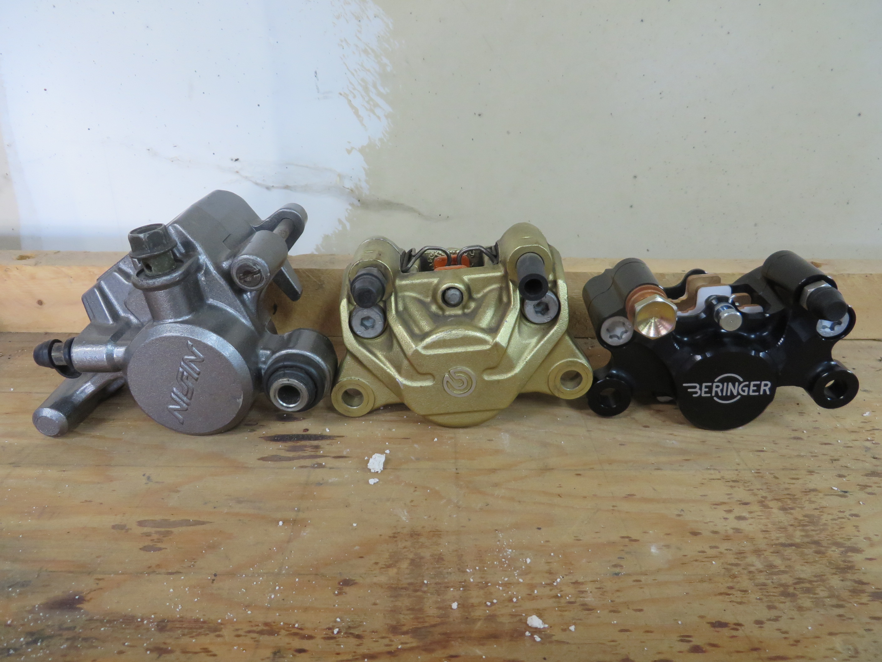

The hangers are made to use Brembo 84mm calipers, which are relatively cheap. Also good for the Beringer Mini ($$$). Possibly over slung, but primarily under.
Price would be dependent on how many we can get to commit. 150-200 is my guess.

I do have an 8th gen caliper already, not sure the size.
Might be more economical to make it fit a readily available CBR or similar caliper.

15 hours ago, VFROZ said:
I'd be very interested in this.
Brembo P32 or P34 are small and plentiful. they are used on Ducati/Aprillia/etc. New with pads about $130, used as little as $50...

ill bet there is a way to use the 848 hanger on the vfr. it would only be a $25 investment to try. The brembo caliper and master have more then adequate stoping power if able to get them bled properly which is a task. Much better and 8 lbs lighter the the vfr rear set up
  • 0
1 hour ago, mello dude said:
Anybody just try out a 8th gen hanger and caliper? Parts wise that would run about $300 (new)  total on Partzilla...
https://www.partzilla.com/catalog/honda/motorcycle/2014/vfr800f-ac-interceptor/rear-brake-caliper
I've got a caliper, but not sure if hanger will reach the stay bolt.
I'll have a closer look next time I see an 8G.
